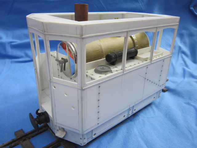

Peter Butler wrote: Sat Aug 15, 2015 2:46 pm Continuing with the chassis build mentioned above, the reason for the construction was to get a battery powered, steam outline locomotive out on the line.
This is yet another project which I have been sitting on for far too many years.... something like 30 years in fact!
It came about during the exhibition years when a locomotive body shell was made by a good friend and colleague at the time. It just sat on a plinth, static with plastic disc wheels and covered in rust effect powder. It represented a forthcoming restoration project for the fictional preservation railway and was never intended to be completed.
During the installation of the model railway into my shed, certain items had to be removed and this was one! Although not intended to work it was too good to scrap so I set about it with determination and an assortment of tools!
Much alteration was needed to make the body look the part and hold all of the necessary equipment inside the shell. A lot of cutting and reinforcing was required and new access made for the battery pack and receiver to live.
I am happy with the overall impression and here she is just leaving the workshop......
I wanted to fit an on/off switch where it wasn't visible so bought a rotary switch to fit underneath here....
Just needs the receiver to be wired in and off we go...
I think she looks quite happy to be paired up with the 'Lady'

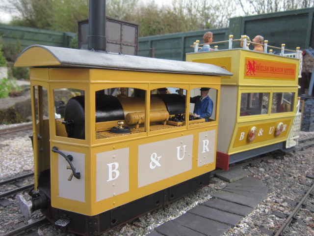

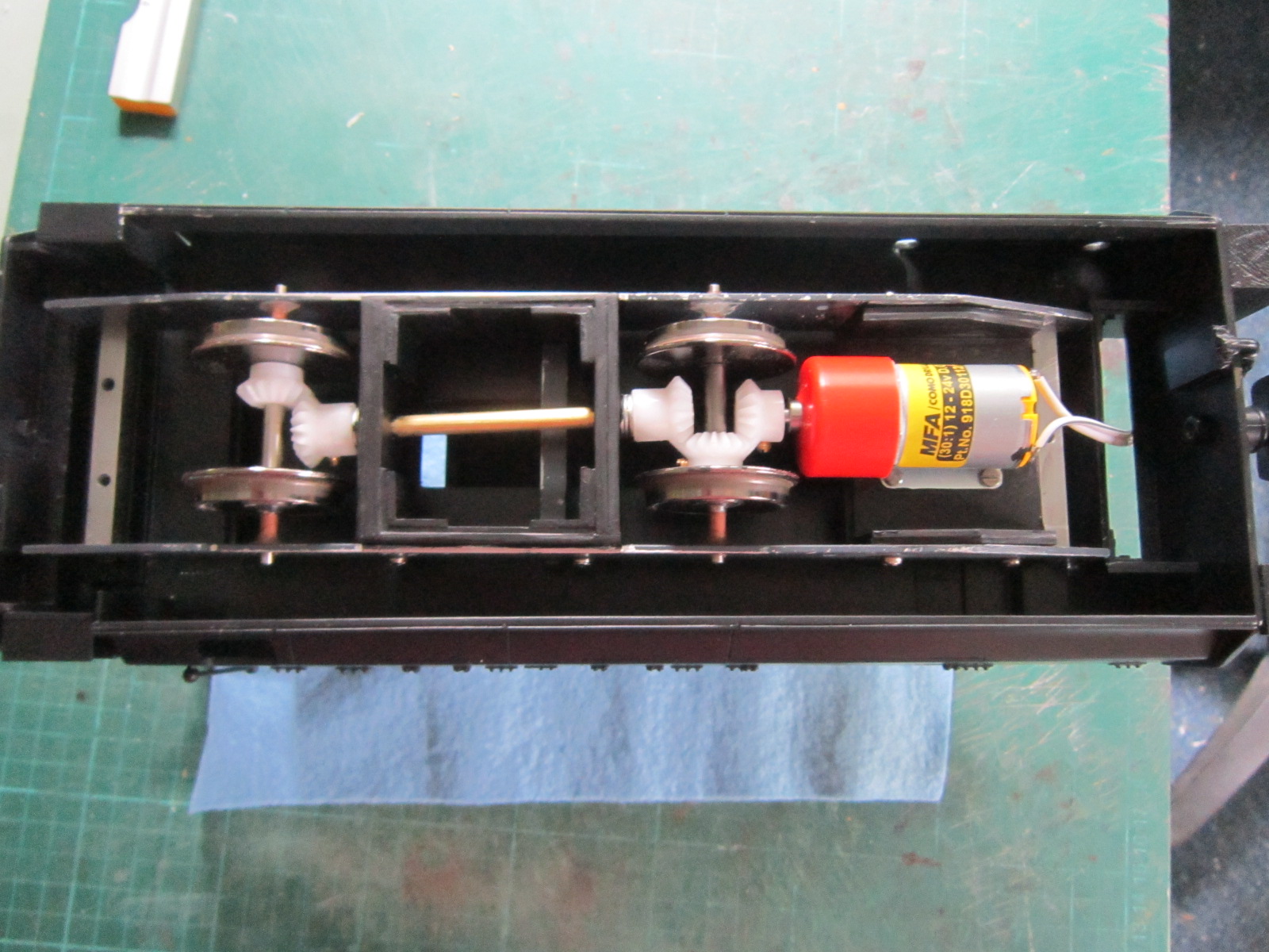

The model was originally built to represent a small standard gauge locomotive (not by me so don't ask why) and was static as previously described. I really liked it far too much to junk it so decided to narrow gauge it. Yes, it is a large loco, but looks OK alongside other stock. It is also heavy so has great pulling power. Dimensions are as follows.
Length over buffers... 330mm.
Width... 115mm
Height... 160mm +/- (cab and chimney)
The distance between the frames and skirts can be seen here, it is a GRS chassis with cylinders and cranks removed and new bevel gears installed (engineers look away now!)

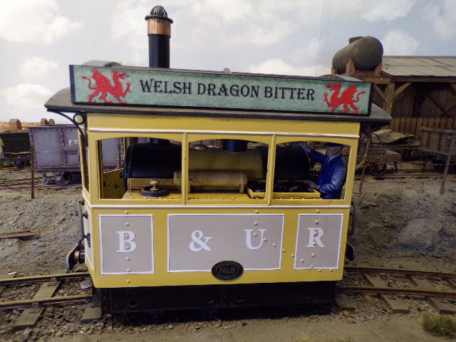

Thanks Aaron, I built the tram in 2017 and it made an appearance in the video which Rik produced and is still available on YouTube. It is a great runner and looks the part but I have been reading the thread on vinyl cut lining (which I have used on other locomotives in the past) and thought I could make the tram a little prettier.
I have a sheet of straight, plain white lines cut about 0.5mm and surrounded the existing panels with them...
After a spray coat of matt lacquer they are firmly attached and improve the appearance, I think.
Just scroll up for direct comparison.

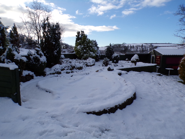

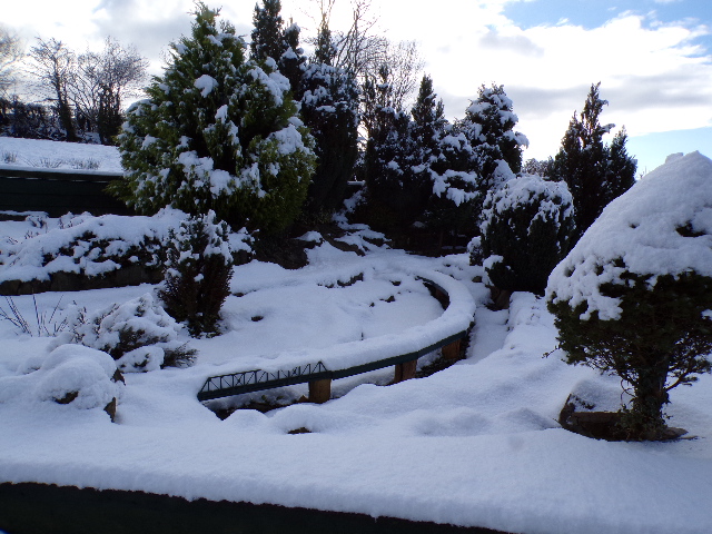

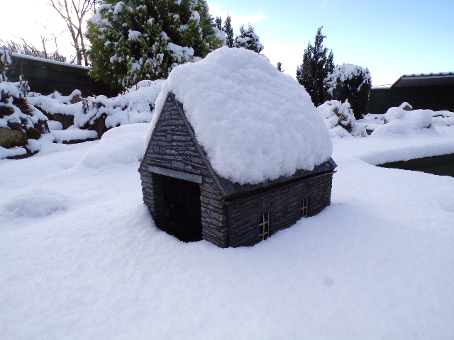

A little catching-up is in order I think... firstly, the snow has been gone for some time now and the railway appears to have survived intact. It has been too cold to be outdoors for any length of time, other than walking the dogs, so the workbench called and naturally I answered!

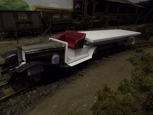

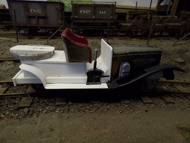

A while back I showed a picture of an early articulated road vehicle...
Now that would make an interesting model, I thought, so with more recent purchases of Japanese radios in the form of cars I had the basic ingredients to hand...
The motor is fitted to the rear wheels of the 'tractor unit' allowing it to operate independently of its removable trailer...
Looking good so far and I'm pleased with progress. More detailing to follow and then a splash of paint.
