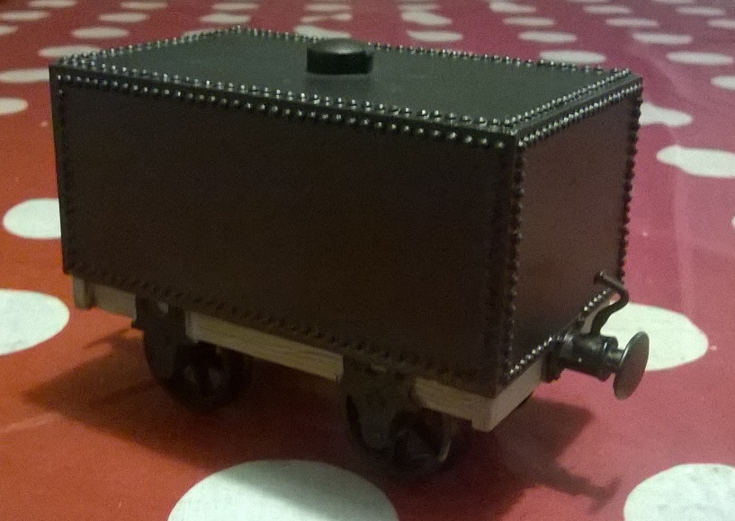

Thanks Rod! One of the reasons I'm doing this one now is to assess the suitability of the method for other projects, including my proposed Kerr Stuart diesel. The jury's still out - it works quite well, but foamboard seem to bring out my slapdash side, I had to use a fair bit of filler!
Unfortunately for me, one of the main characteristics of the brine tank is the rivets all the way round the edge of each side. Here's the progress so far - it'll use up most of my nail gems... It'll be a shame to paint it really, it's going to look like something out of a circus train when it's done!

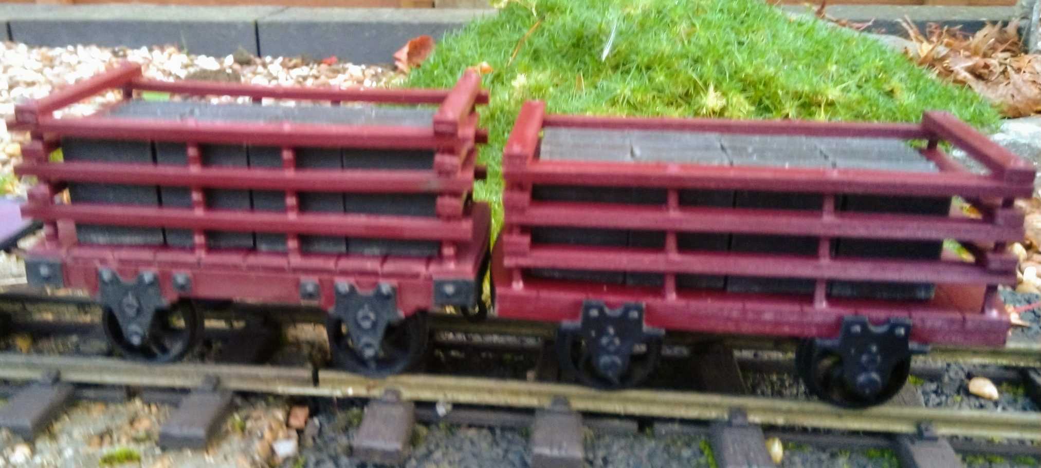

As requested. The two slate waggons are a Lineside Hut followed by a Binnie. These are representing the NWNGR first generation slate waggons (apparently "almost identical to the FR type"). The bolster set are modified from a Lineside Hut kit to represent the NWNGR bolster waggons.
All the Lineside Hut kits have white metal axle boxes instead of the MDF(!) ones. This does involve grinding at the floor of the waggon with a Dremel and sanding mop. They ride much better than with the MDF boxes. The brake van is also progressing, gaining most of the "fiddly" bits like handles.

Nice! I particularly like the bolster set - that's on my list too. MDF is an add choice for axleboxes, isn't it?! Lovely cheap kits, but less of a bargain when you've bought new axleboxes! I've got two Binnie slate wagons in their FR guise and another one awaiting construction which will represent the NWNGR variant - I'll probably add brakes, as per the one in the maker's works photo.

Hi all,
Apparently, today is "Black Friday"... According to some sources this is some sort of celebration of impending armageddon fuelled by rampant consumerism, but this seemed such an unlikely thing to celebrate that I decided to investigate further and am pleased to report that I've discovered the True Meaning of Black Friday... It's all about giving adequate recognition to the most important colour in any railway modeller's paint collection, but one that's often overlooked - matt black.
And so, to celebrate Black Friday, here's a grainy photo of the latest progress on my brine tank wagon, taken this morning before I left for work, when the sun still hadn't risen properly:
It's nearly finished now, just brake gear and some weathering to add, which I might do this weekend. Another job for the weekend is the application of more matt black paint, this time to the ironwork of the second small WHR open wagon. Most of that's been ready for painting for a while, but I still hadn't made the axleboxes - that changed on Wednesday evening, in a Cardiff hotel room on a rare work trip away!
Spare time is likely to be limited as Christmas approaches, but it will be nice to get these two finished soon, if possible...

Love the tank wagon.... the rivets look perfectly aligned, which I know isn't easy. Nice matt surface too.
Re: (WH)WHR Rolling Stock
Poundland spray - as you know, it's wonderful stuff! Goodness knows what they put in it though, or what it's doing to the inside of my lungs, it smells far worse than usual spray cans...

I think my eyes would have a bit of a twich after assembling that many rivets on the Brine Tank though.
