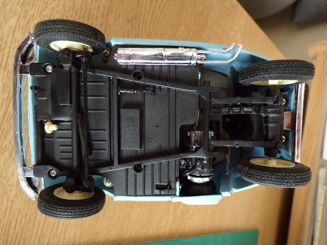

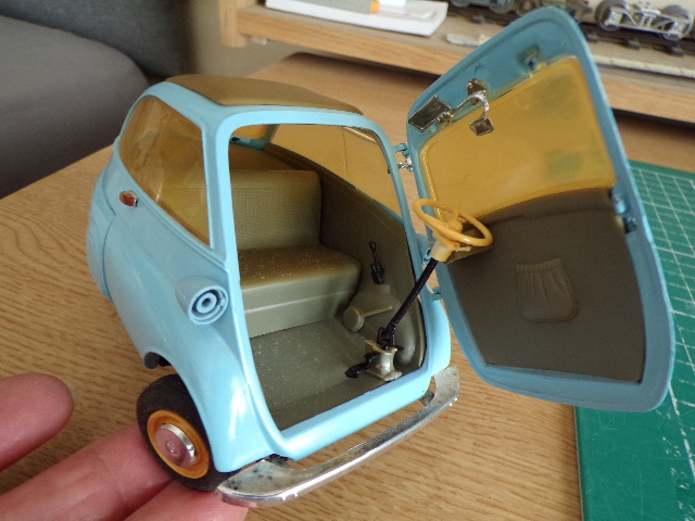

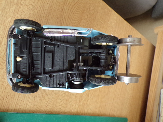

Although I recently posted pictures and description of my Fairground Organ build, I had by-passed another of my road to rail conversions.
Attached are a couple of images showing the 'before' view of the donor vehicle's chassis and, despite it appearing to show a perspective difference in wheel gauge, it is in fact dual gauge as built!
Can you guess what it is yet?.... I'm looking at you, Drew!

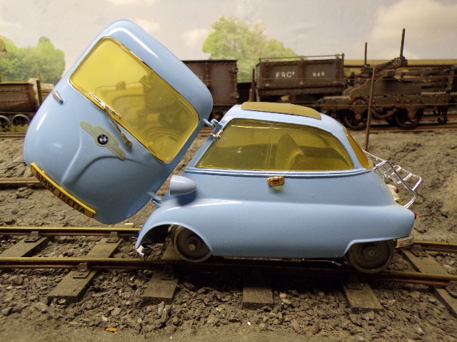

That's an easy one. Its a BMW Isetta. The four wheeled version . What is intriguing is how will you fit a motor gearbox into a very small space . You must have a mini motor setup ,or the car is the Isetta Tardis variant.
Chtis
Posted: Mon Jul 14, 2025 11:02 am
Too easy Chris, must try harder!

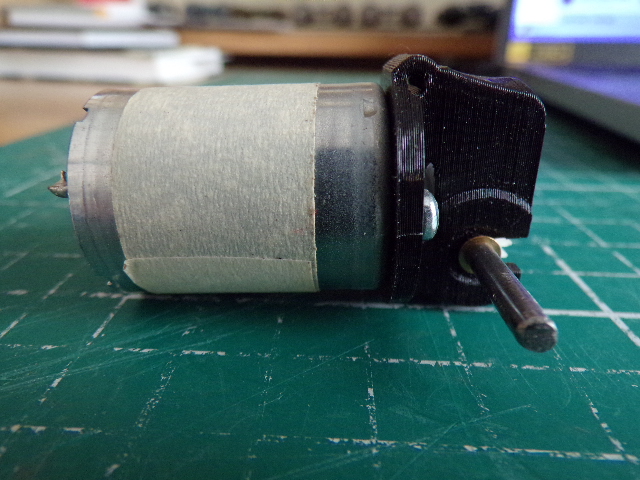

It is a very small vehicle to fit everything in but I have managed to put a standard 6v motor and gearbox driving the front wheels and five AAA batteries at the rear underneath the engine cover. It looks tidy but I can only fit a driver figure by major surgery to his lower parts so he straddles the motor. So far I haven't done so, and with the tinted windows it is less important, but will get done soon....
Being a die-cast model it is quite heavy so runs very smoothly with Phil P's R/C installed.

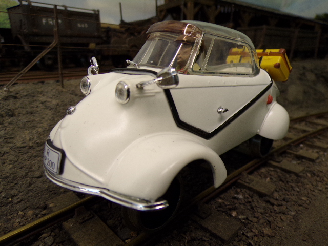

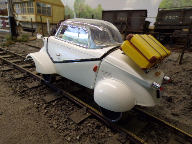

Whilst browsing for something else I stumbled upon this comment from dudeface and Aaron. I had completely forgotten about it, despite reading, and usually commenting, on all your messages.
The reason I'm replying after all this time (Feb 2024) is because I have recently completed my latest build and was about to add it to my thread anyway.
What a coincidence....

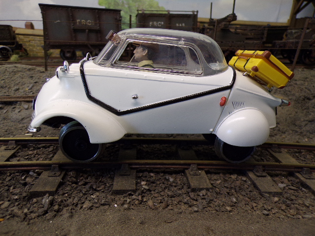

The original is a three wheeler, as shown on the original picture, so the rear end is too narrow to take the 32mm wheel gauge. To accommodate this I had to take an angle grinder to the side of the die-cast model and add extended wheel arches (quartered round top from cosmetic bottle) which don't look at all out of place.
Driven by a tiny motor with axles either side through a built-in reduction gearbox. Rechargeable batteries, RC Trains Rx, 2 way switch and charge point. And why not???
Do you think it's time I sought professional help?
Posted: Fri Jul 25, 2025 2:06 am
by FWLR
Well I think it looks brilliant Peter. You have somehow brought it to life onto a 16mm garden railway that for me doesn't look out of place.

Peter Butler wrote: Thu Jul 24, 2025 10:17 pm The original is a three wheeler, as shown on the original picture, so the rear end is too narrow to take the 32mm wheel gauge.
Neat work on the rear end conversion. No idea if anyone does a diecast model, but the real contraption came in a 4 wheel 'sports' version as well. It was the hoon's version, with a 2 cylinder motor and about the same horsepower as a ride-on mower (20hp).
