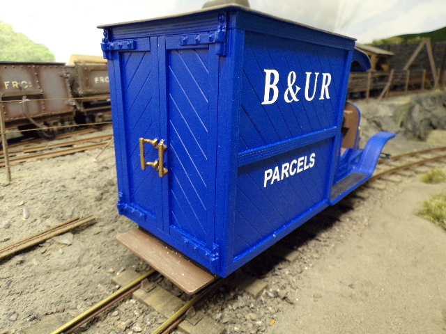

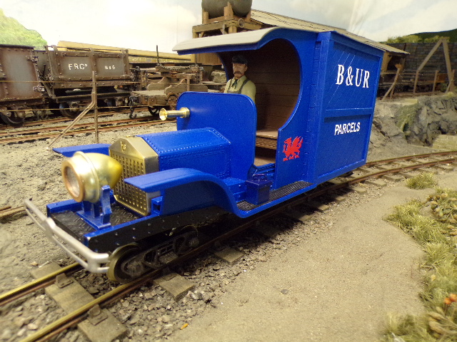

Interesting comment there about blue light Rod, in fact one of my friends has made a rail-mounted 'Black Maria' police van with a shifty looking character peering through bars in the rear window and rotating blue light on the roof. I dare not copy or compete with his wonderful van.
My own van has been given a more peaceable purpose....
I do seem to have a subconscious attraction to the colour blue. It is only when I put out a selection of models I notice they are in the majority.
In this case the strong colour certainly makes the diagonal planking stand out and enhances the white lettering...

I was going to ask about the finish on the radiator, but assume that came from a novelty radio?
I am trying to build an arsenal of metallic paints, but many are not particularly effective.
That is 'metallic' as in imitating metal.
Posted: Sun May 04, 2025 5:33 pm
Phil.P wrote: Sun May 04, 2025 2:44 pm I was going to ask about the finish on the radiator, but assume that came from a novelty radio?
Yes, Phil... the radiator is from a novelty radio and comes in a very shiny gold finish. I have lightly sprayed this with Hycote matt lacquer to flatten it slightly and it is much better.
To imitate metallic finish, e.g. brass pipework etc. I use 'Citadel Layer paint, Brass Scorpion with a touch of Citadel Layer paint,
Auric Armour Gold . Clear lacquer to finish.
I think it looks OK and was commended by an engineering friend saying it was the best paint imitation he had seen.

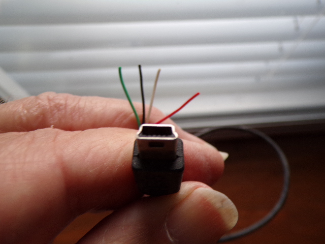

Can someone please identify this computer connection? I have been looking for a small, four pin, plug and socket to install in my Garratt loco to replace the ones I originally fitted which have proved to be unreliable.
Names of any suppliers of such items would be useful too.
I need both male and female so the two motor bogies can be separated if required....
If anyone can suggest an alternative I would be happy to follow any suggestions.
The female socket can be permanently sunk into the chassis and the male part remains on a four core flexible lead.

That is a mini USB connector, Peter..
I think you may have difficulty finding what I think you are calling the 'male' connector, without a fairly bulky housing or strain relief..
We are resting, post Llangollen, but I will have a ponder, and see what I can come up with.
Four connections? - Track Pickup and Motor, I assume?

Thanks Phil, I have searched for small four pin connectors with little success and this is the only one I could imagine might be suitable.

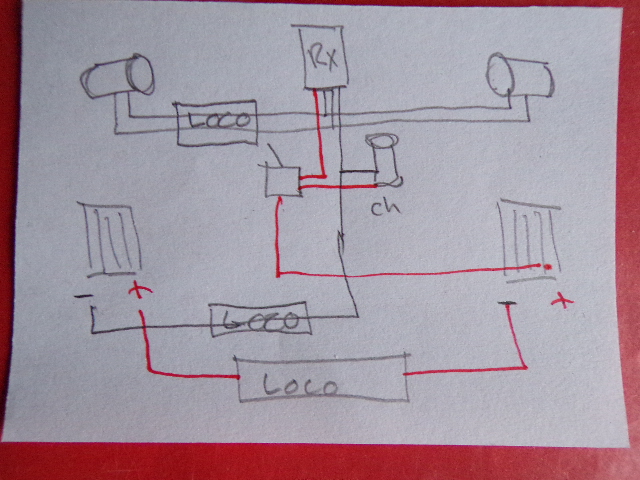

The diagram shown is how I think it could be done... The boxes marked 'LOCO' are where the wires need to pass through the main body of the Garratt from batteries located at either end on the motor bogies, which need to be detachable.

Peter Butler wrote: Sun Jun 08, 2025 12:32 am I have searched for small four pin connectors with little success and this is the only one I could imagine might be suitable.
I use JST-RCY connectors for the higher current wiring in my locos, as they are rated for 3 amps. (a mini-USB connector is rated for only 1.5 amp.) They are only 2 pin connectors though. If I use more than 1 pair I label them to reduce the risk of connecting them up wrong sometime later, when I've forgotten how I connected things.
Some of the JST range of connector types are commonly used in R/C models for connecting batteries etc and are easily found in shops catering to the R/C enthusiasts. My local one carries pre-wired JST-RCY lead pairs as well as y cables for connecting two lines into one, which are useful for bendy locos.
I use the RC hobby shop range of connectors mainly because there is one 10 min away down the freeway, instead of the fortnight to get anything by mail order....
If there aren't any RC hobby shops in the wilds of Wales, Phil P lists suitable connectors on his website for wiring RC battery locos, as does Micron Radio.
ps. Just saw Jerry's suggestion of JST-SM connectors. They are rated at 3 amp so would do the same job as a couple of JST-RCY connectors, but may need a larger hole to pass through.
