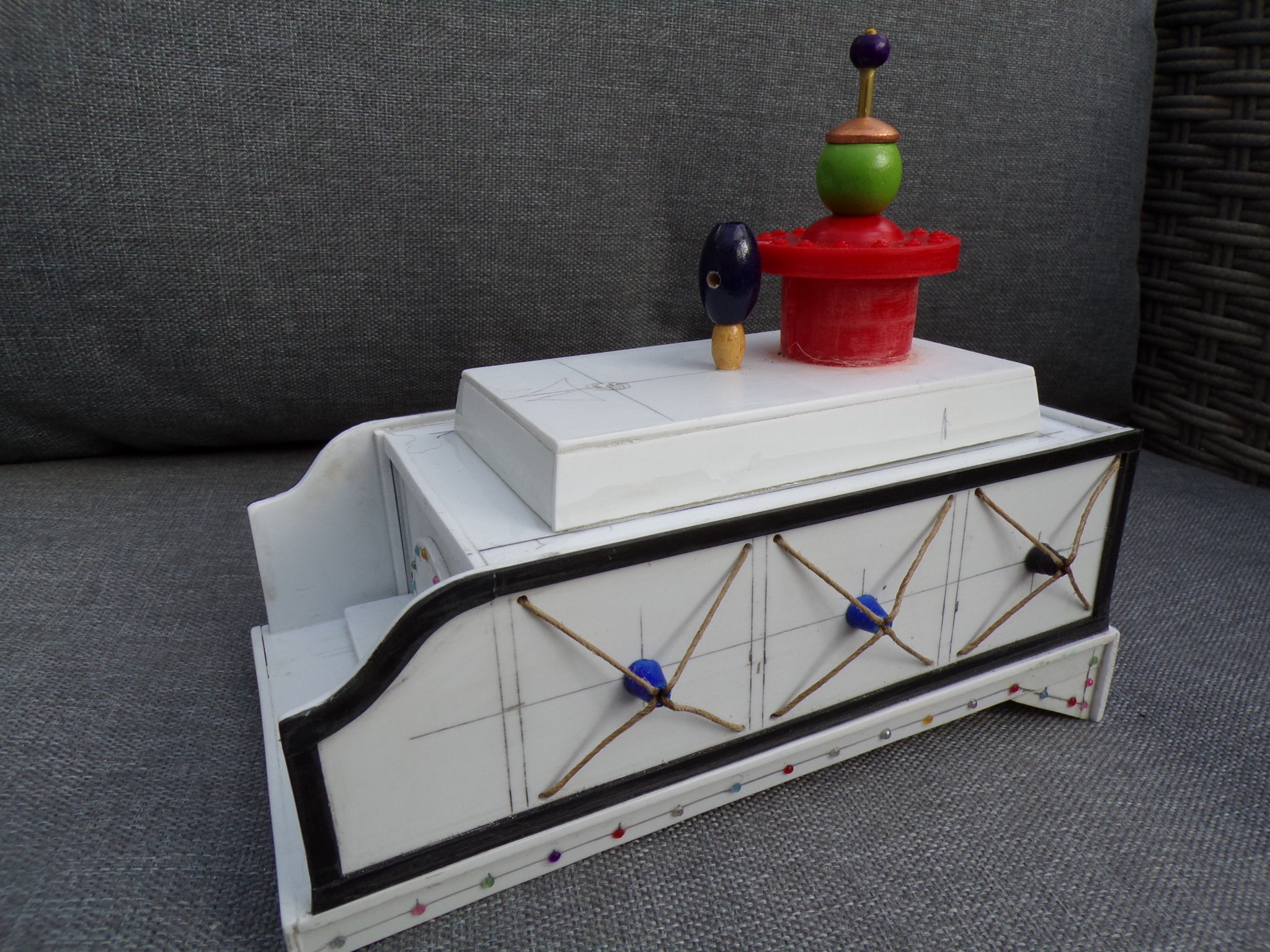

During the build there were several structural issues to resolve, which I find the most interesting part. The wicker basket appearance of the tender was the very first thing I had concerns about, even before I started. I thought of table mats, other decorative utensils etc. but discovered the image on Google which I printed and pasted onto the HIP tender sides.... simple!
Towards the end of the build I had to face the construction of the support for the canopy above the driver. This could easily have been its downfall as I struggled to find a way of soft soldering brass rod in such a way it remained strong enough to withstand handling. Bear in mind this 'thing' stands about 11 inches tall and is no lightweight!
Eventually I came up with using electrical cable crimps, the ones with screw holes for securing to contacts. Having stripped off the plastic covering, these can be soldered to brass rod and hooped around uprights at various joints and soldered solid.... very strong.
A jig support was constructed away from the model and the whole framework made....
The canopy itself is a thin HIP 'kite' with plastic rods attached as ribs, filler applied to show material undulations (waves) on the top and then painted
as the coloured postcard image shows. Rigging twine around the edges and final details added as required...
Look out 'Tate Modern', here I come!

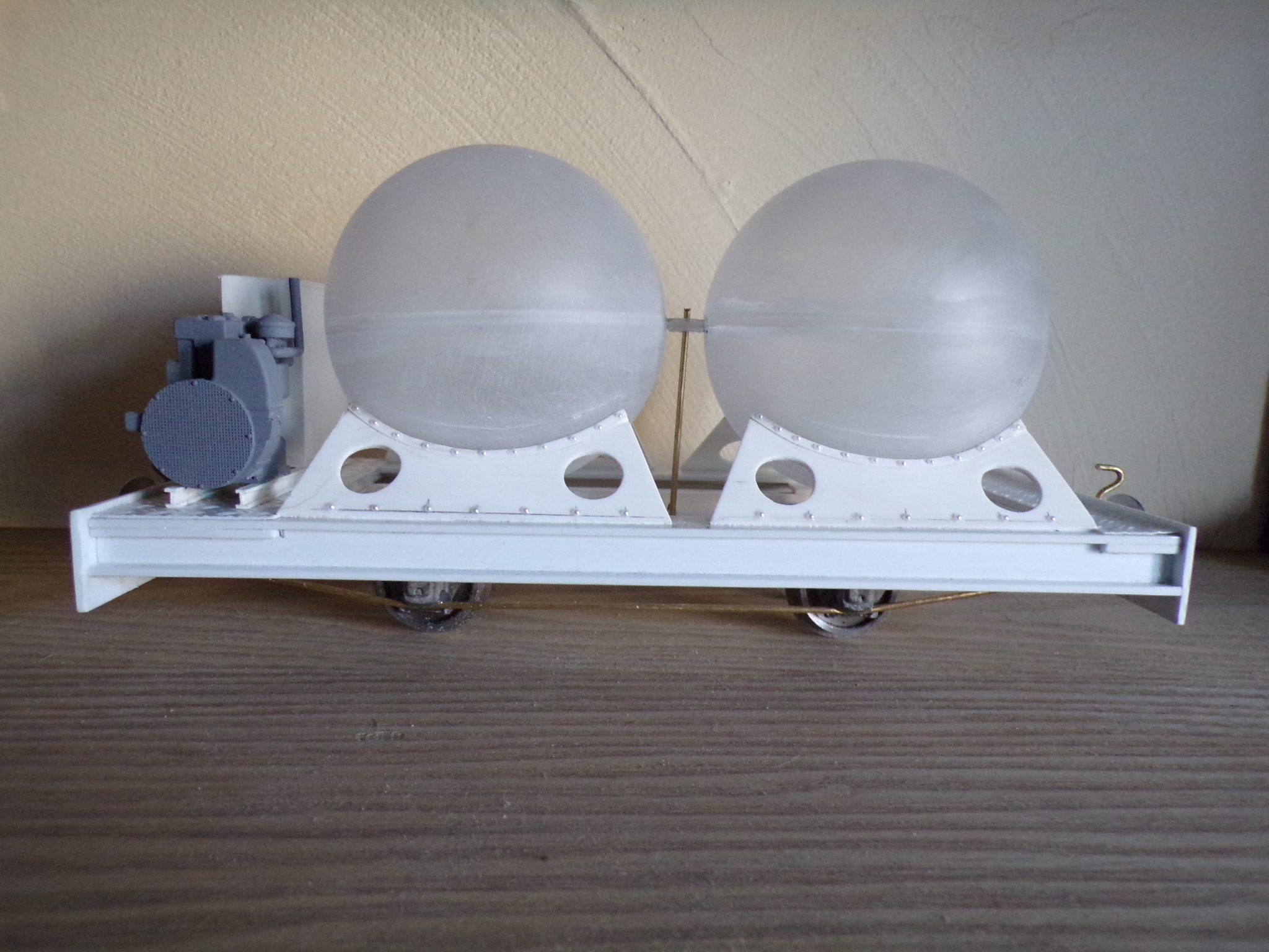

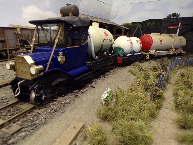

During my on-line search for the egg shape for 'Wild Goose' I stumbled across another useful (for me) item, this time Christmas baubles in clear plastic and various sizes. I selected 80mm diam. which were sold in packs of five. Now what could I do with those I wondered?
First thing was to design and construct a chassis from HIP ....
Already you can see the idea forming...

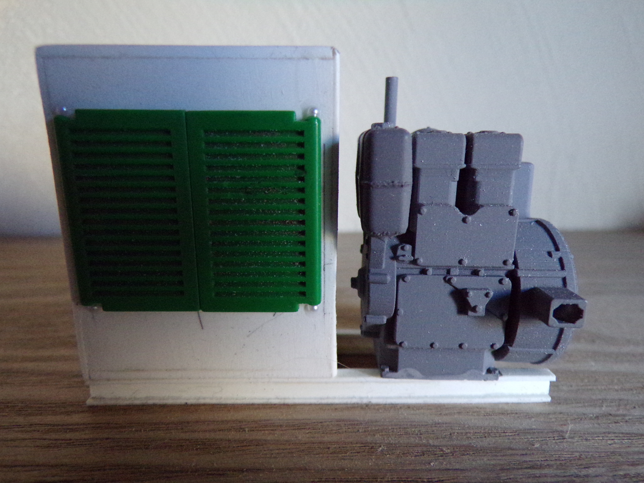

It is another gas container to add to my fleet of fuel delivery wagons, this time LPG, so a chiller plant was required to add to the wagon...

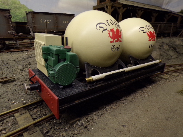

The wagon has been finished with rattle-can cream colour and lightly weathered to match existing wagons on the fleet, also Welsh Dragon logo and cut vinyl lettering to advertise and promote the supply company....
When assembled together the train now consists of three fuel options....

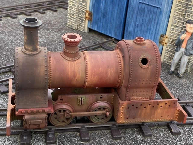

After separating the Jerry Irwin kit I'm left with just the smokebox and firebox. A new plastic tube with real timber slats attached, which were dyed and French polished, was made to suit the diameter and length required and placed over flanges (not stuck) between them. The reason for that will be made clear later. Some base trimming was necessary for both firebox and smokebox as they were standing too tall on the chassis, but soon looked better proportioned.
The Boot Lane chassis includes a well tank (which appears to be similar to the prototype) but is too short overall. An extension to each end provides sufficient space to fit the smokebox and cab floor....
Due to widening of the tank top it became necessary to relocate the tank fillers in front of the cylinders.
The bunker was cut in sections from the Bachmann 'G' scale tender. It had to be reduced in width by removing a centre section at the rear but keeping the rounded corners on either side. The semi circular fronts of the bunkers were cut away and fitted to shortened side panels. A new section with coal door then made to suit the remaining gap at the front. A lot of careful cutting, filing and fitting was involved, but it looks well suited as a result....

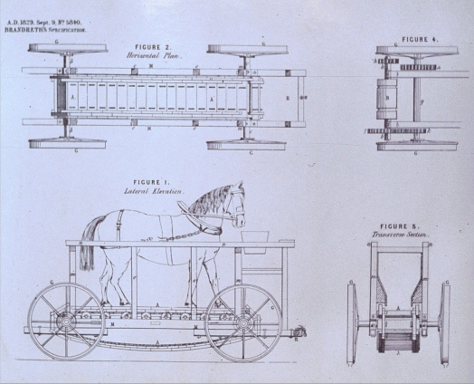

https://en.m.wikipedia.org/wiki/Cycloped
An entrant in the Rainhill Trials which used a horse walking on a treadmill to power the wheels. I can't imagine why it didn't catch on. :dontknow:
