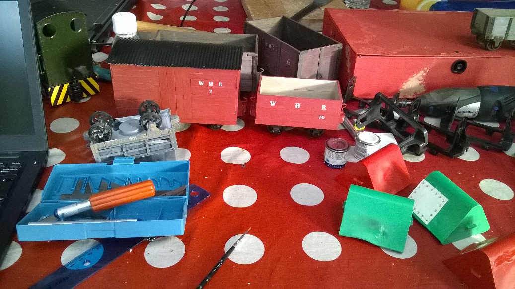

Morning all,
My wife's away for a few days, which has had the usual result - the kitchen table's covered in rolling stock projects:
Messy table.jpg (320.85 KiB) Viewed 13119 times
The WHR van and small open have received stenciled letters, and this evening I hope to start on strapping etc. Four more Big Big skips are underway, the troublesome coal trucks may receive attention (see Help and Advice!), and a slate wagon has come in to have its running gear re-stuck... Plenty to be getting on with...

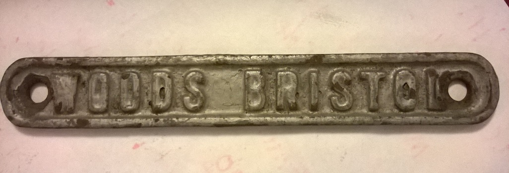

My WHR Summer Car left the works a couple of years, but was almost immediately withdrawn from traffic because it couldn't survive a trip up the line without being dragged over sideways by the "bowstring effect" on the sharper curves. This weekend I've set about trying to cure that, starting with moving the bogies further towards the end of the vehicle to reduce the swing on the couplings. Then I added some weight underneath in the form of this 6" long, err, thing:
Summer Car 2.jpg (156.14 KiB) Viewed 13652 times
I don't know what it was attached to, where I found it, or who "Woods" were, but the carriage was made in Bristol (my version that is, not the Mancunian original), so it seemed appropriate.

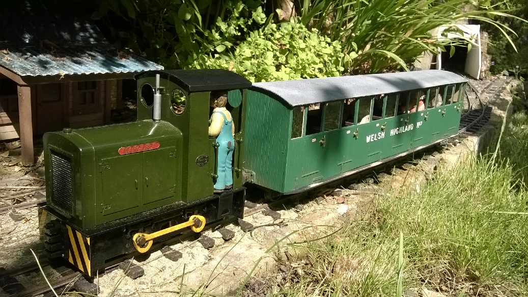

Here it is on test an hour or two ago:
Summer Car 1.jpg (382.5 KiB) Viewed 13652 times
I added some wagons to the back of the carriage and trundled it round a couple of curves, and it's looking good so far, no bowstring, although a full rake of carriages at a slightly higher speed might be a stiffer test. It still needs its couplings lowering, they're a little on the high side, but that's probably going to mess up the ends of the carriage, so if I can I'll enjoy running it for a while before undertaking that work.
Testing revealed a further problem with derailment, most unusual for my stock with Big Big Train running gear, such as this one. The cause turned out to be a non-standard wheelset which had been switched for one of the originals before I acquired the donor (BR Mk2) carriage. That's been cured for now by swapping it with one from the Gladstone Car, but I'll need to get hold of another. Fortunately, they crop up fairly frequently on eBay, even if they are horribly over-priced.

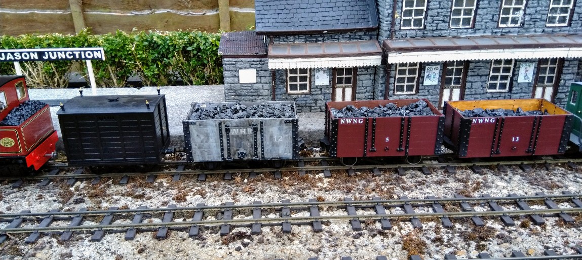

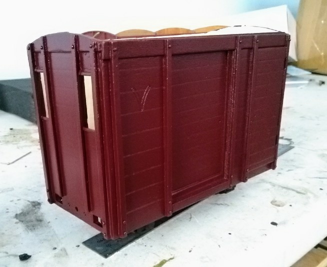

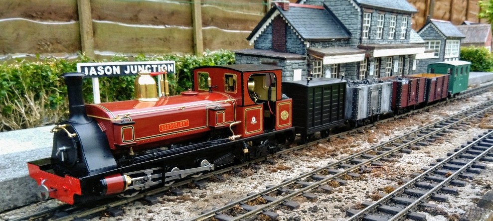

My 23 has the opposite problem; tips over everything in front of it (annoyingly including the Toastrack).
As promised, pictures of some of the freight wagons:

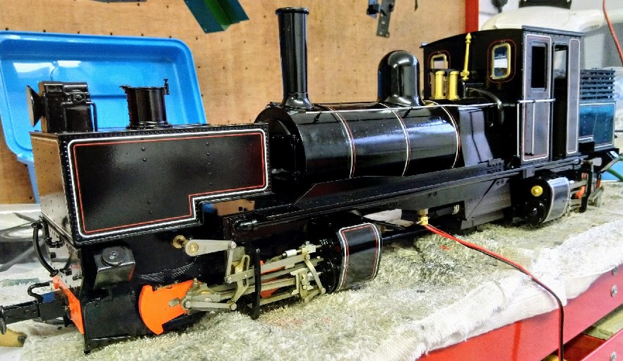

Yes Beddgelert has arrived! The overhang is incredible, no bogie carriages can be run immediately behind this locomotive!

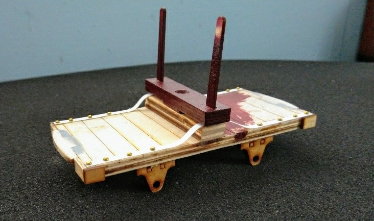

Not seen on this forum before are the two NWNGR coal wagons; modified IP (front) followed by the first Jurassic. Another is currently unmade, will likely be finished as a NWNGR wagon.
The Hearse is a standard Timpton with IP buffers.
One of two bolsters, as seen at Dinas. Modified Lineside Hut.
Jurassic NWNGR brake van. This one became the unumbered WHR van and differed to number 2 in lots of details.
Lots of slate and flat wagons (The Lineside Hut) to be started.
Also for modern WHR:
K1 will compliment the 138 and the rest of the LVLR Garratt's nicely.

Thats a great photo Andrew, it does blend in with the scenery. I have a coach that does the exact same thing, it does not like curves one bit..

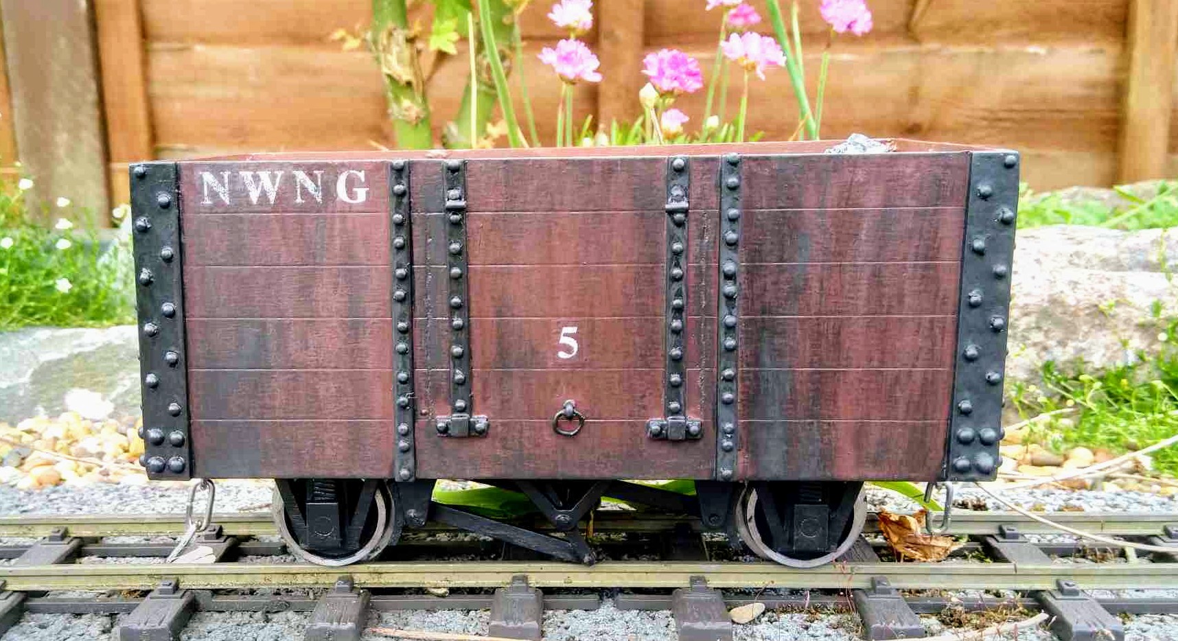

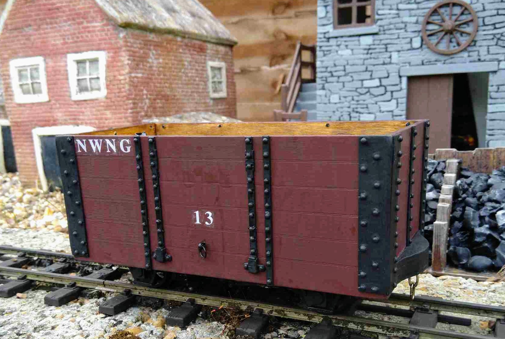

Weatherinng attempts...
IP wagon. Modified by removing a plank from the top...
Jurassic. This one has been recently overhauled hence the cleaner body.

The wheel rims painted black would finish it off nicely.
Re: (WH)WHR Rolling Stock
Posted: Sun Jun 30, 2019 4:59 pm
Lovely looking wagons, nicely weathered. The brake gear looks good too. Does that actuating arm make contact with the rail? If so, it's very nifty - double-acting :)

Nice wagons! I particularly like the brake van, I must crack on with building one of those. Good idea for the timber bolsters too...
"Beddgelert"'s a beauty. Shame about the overhang thing though, which must be a pain - you need some NWNGR 4 wheelers to run directly behind her. I might cut some more parts for some at some point, I'll let you know if I do...

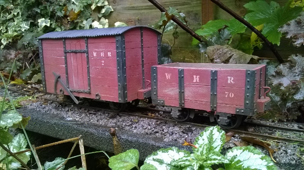

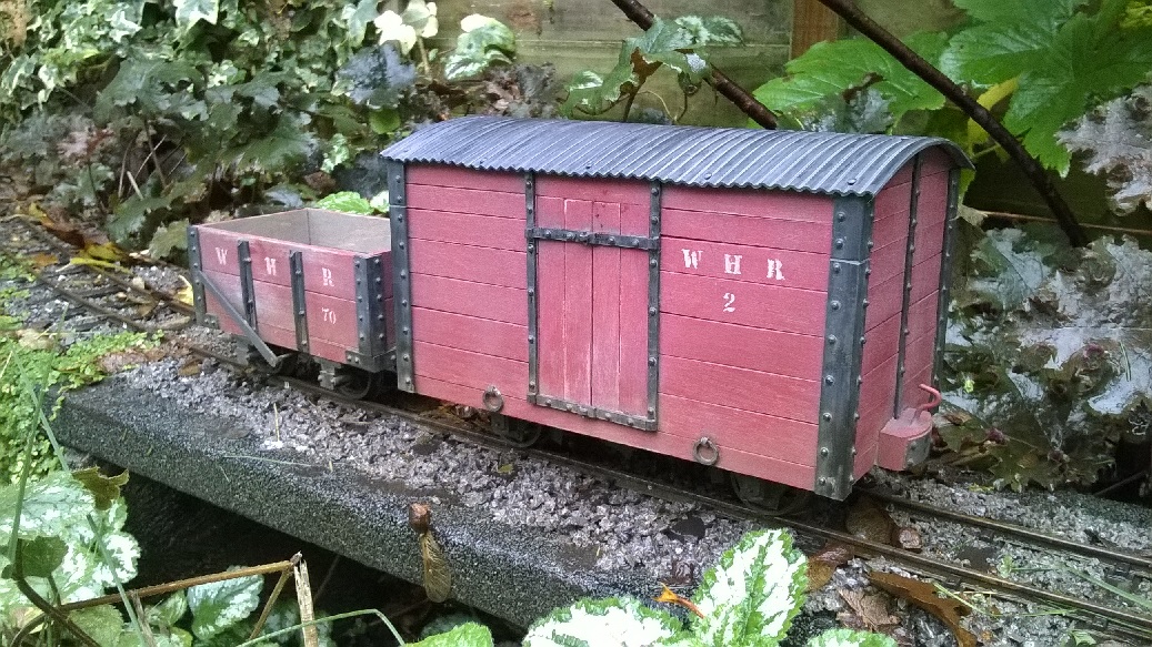

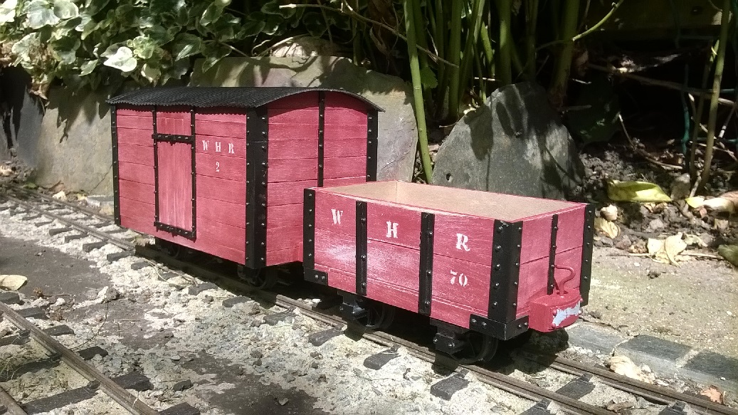

Afternoon all,
The two current wagon projects, the WHR van and open, have almost reached the finish line this week. Having received final details, including brake gear, they've now been weathered too, apart from a few rust streaks and patches here and there. I don't seem to have the right colours of paint for that at the moment, but they've entered service anyway - the rust will catch up with them at some point. Here they are posing in the garden earlier today:
Van and open 1.jpg (382.31 KiB) Viewed 12438 times
Van and open 2.jpg (358.03 KiB) Viewed 12438 times
The open's a rather nice size, fitting nicely between a two-ton slate wagon and the larger WHR vehicles.
The brake handle on the van's made up. Until recently it was thought that there were only doors on one side of these vans, but analysis of photos now suggests otherwise, so I've adapted the brake gear to fit...

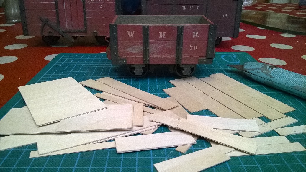

I'm not at work today and had planned to run a goods train with the new wagons this afternoon, but the weather's not really obliging, so I started work on the next open instead, cutting out all the various planks and other parts:
New open.jpg (293.97 KiB) Viewed 12438 times
I like the effect of individual planks, but it is tempting to glue together 5 bits of ply and be done with it! I've painted the parts that will form the interior with the usual vinegar and wire wool solution and am currently waiting for them to dry.
The weather's looking up little now, so I might just get outside later - everything's looking awfully wet out there though...

Hi Andrew,
Andrew wrote: Thu Oct 31, 2019 12:47 pm I like the effect of individual planks,
Individual planks do look good, but you could try putting a piece of thin card under the end of a few planks so they sit at a different level, or even between the edge of one or two to accentuate the gap. The van and open certainly look good to me, I always think that as far as weathering goes "Less is often Best".
PS hope the weather does allow you to get a run.

Great looking wagons. At least you (and we) will know the planks are individual!

Andrew, I love them. Just such brilliant builds. The corrugated roof on the van is perfect. Is it metal .... :thumbright: :thumbright:
Where do you source your ironwork from please.
