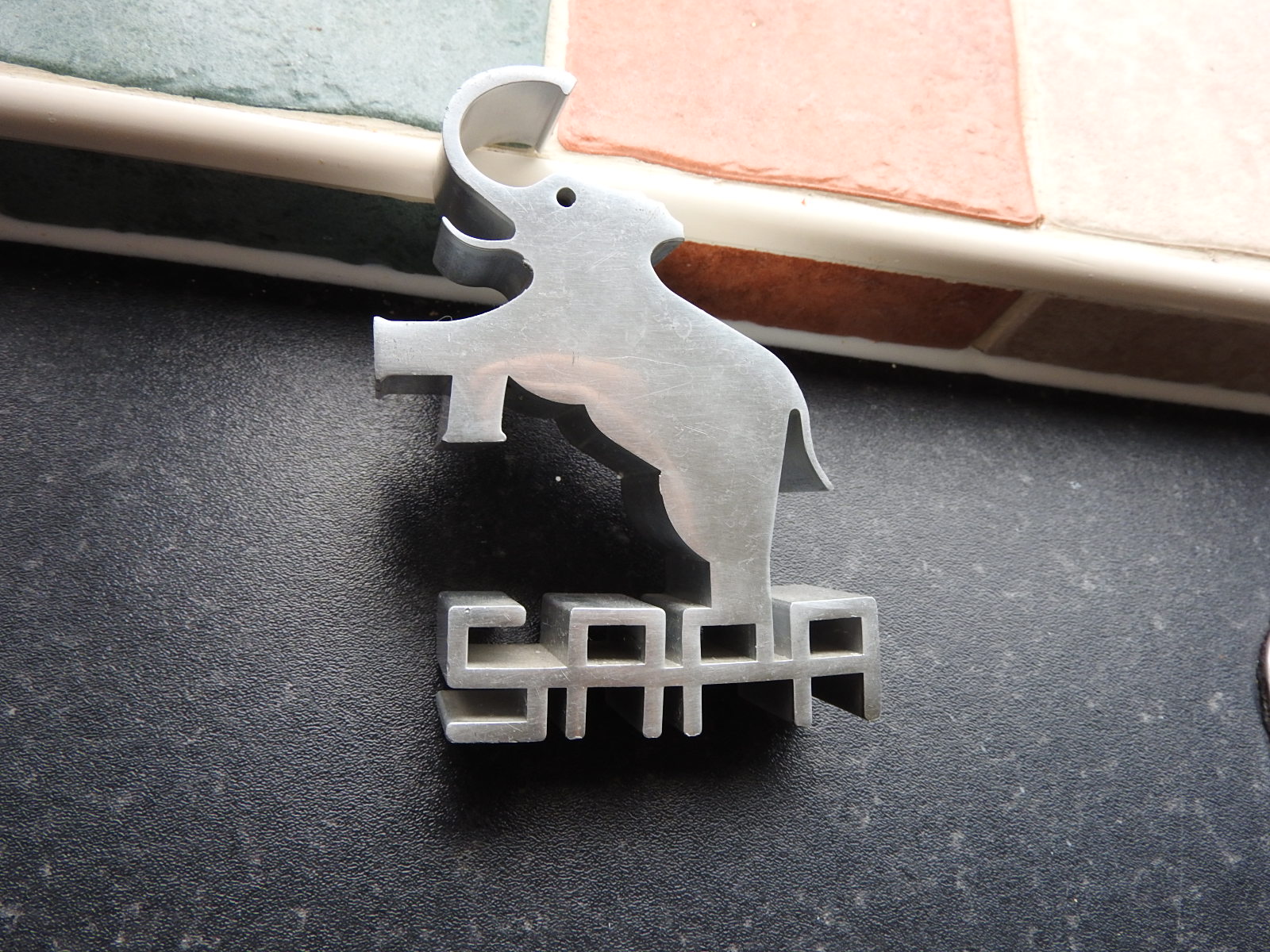

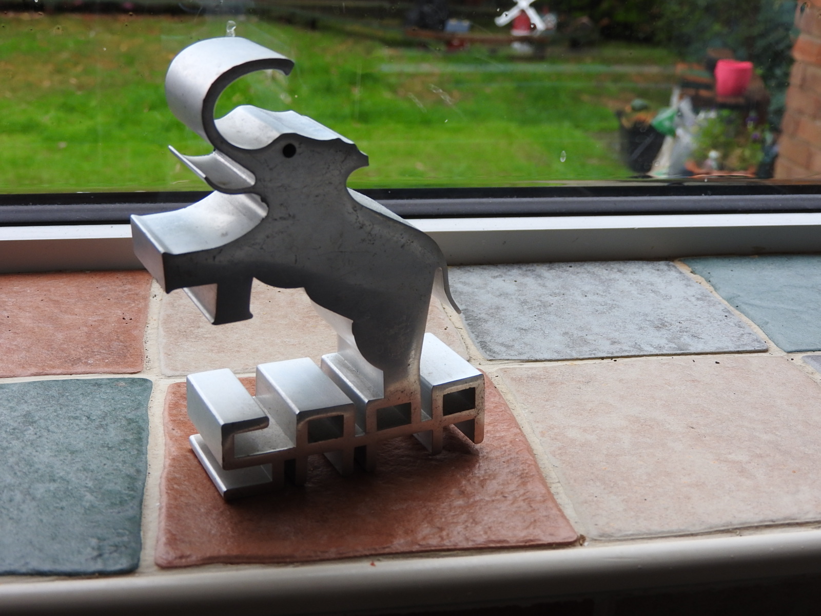

The CNC wire cutting is a good bit of technology, I used to run a wire cutter and other such types of CNC. It would make the making of your boilers and any other work you would need to do a lot more of a less stressful task.
I made this has an exercise for a course I did in programming and operating a CNC Wire Cutter.
I honestly can’t remember why the SAPA was used for it, but it was a brilliant exercise to do because of the different radius needed to complete it.
