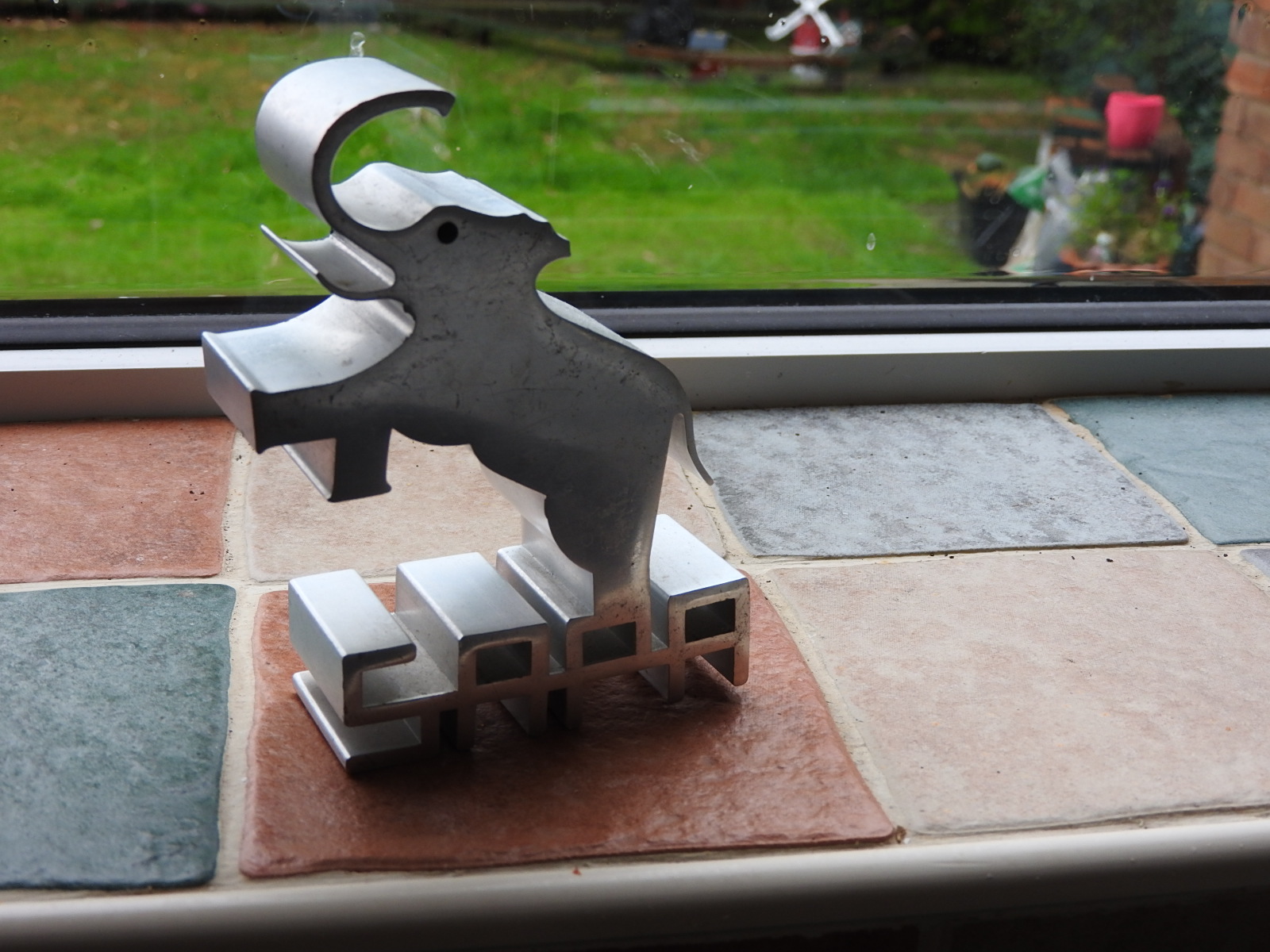

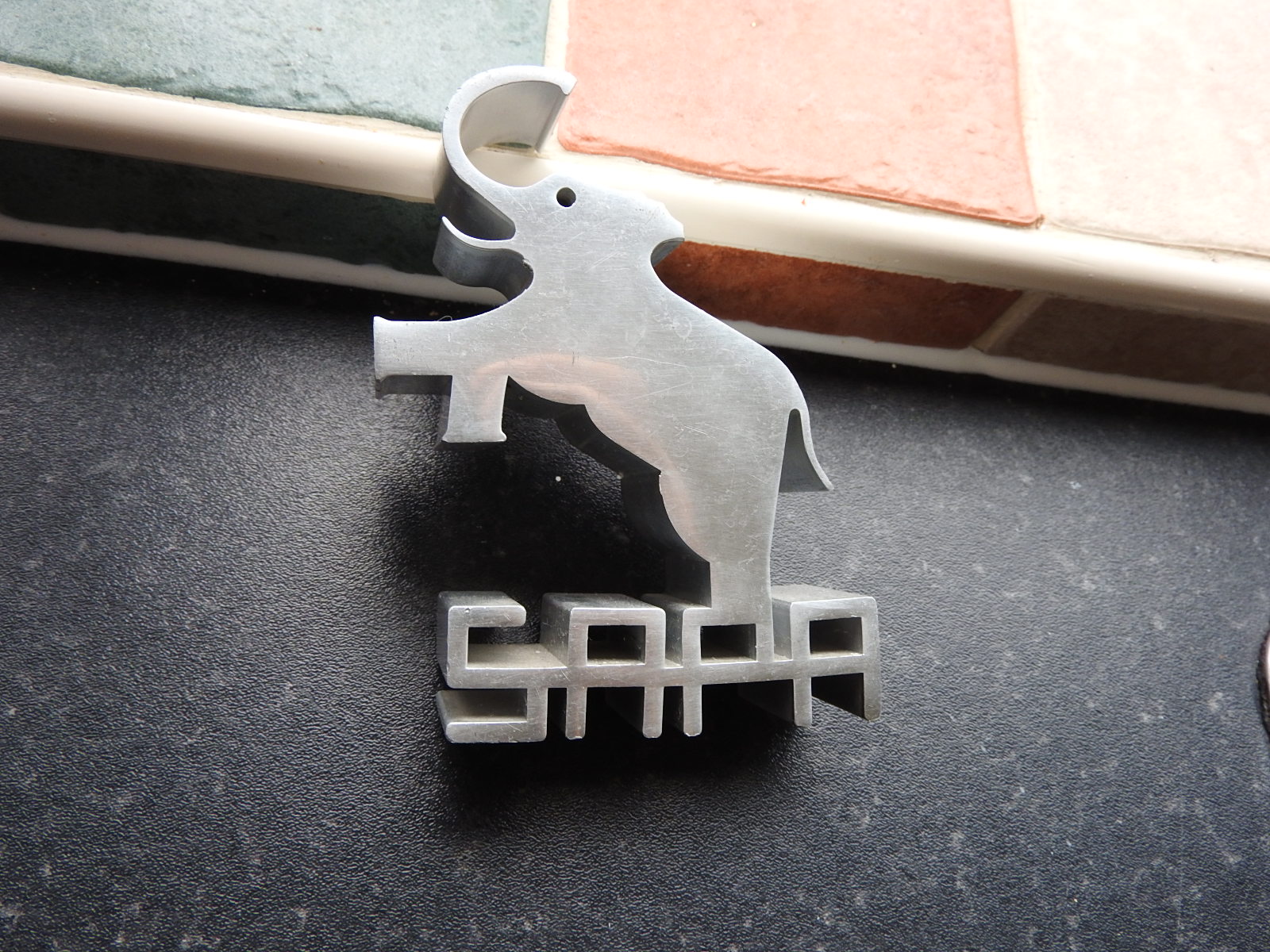

Re: Llewellyn Loco Works #1
Post by FWLR » Mon Aug 13, 2018 11:39 am
It’s all very well saying that we are only playing and we are, but it’s the snobbery with other people who run/play with steam or battery locos that get my goat, even those who work/play on heritage/preservation lines I have met who won’t have anything to do with others who run the smaller scales. It’s the point of fact that we are keeping the rich history that is associated with Steam or Diesel locos that we are helping to not just educate, but also enjoy running what ever scale we use.
I for one don’t have a great deal of knowledge about the way the Railway industry ran, but since coming into the hobby at one of the smallest scales ( N Gauge ) I have now more insight into how trains changed the world all around us.
The CNC wire cutting is a good bit of technology, I used to run a wire cutter and other such types of CNC. It would make the making of your boilers and any other work you would need to do a lot more of a less stressful task.
I made this has an exercise for a course I did in programming and operating a CNC Wire Cutter.
I honestly can’t remember why the SAPA was used for it, but it was a brilliant exercise to do because of the different radius needed to complete it.
