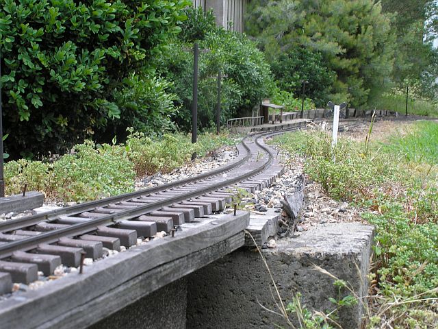

Grant, I am very impressed by the detail and realism that you have achieved here. A question I have, are the bell crank mounting plates fixed to your sub base or are they in some way attached to the track?
I ask because I am proposing a rodded operation of points to my line's extension and I have been thinking that if the crank plates are attached to the sub base, I believe that any movement of the track (eg temperature) is going to result in a partial movement of the points.
Maybe I'm just being over cautious but would appreciate your views.
Posted: Sat Dec 09, 2017 11:35 am
by LNR
Hi Phil,
Yes the base plates are fixed to the sub base, but as the two in the pic. are controlling dwarf ground signals it isn't a problem. However due to the heat of our summers I have found that as in real practice the cables do expand and for that reason I've incorporated short springs (visible on the right hand bell crank). These allow me to over pull the lever if necessary, and that combined with the McKenzie Holland feature of three notches on the quadrant plates for the reverse position, gives me much come and go.
PS The lever on the ground frame for the main line signal requires all three notches in summer, only one in winter, but the distance is about 3.5 mtrs.

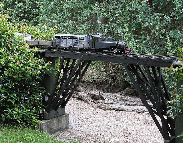

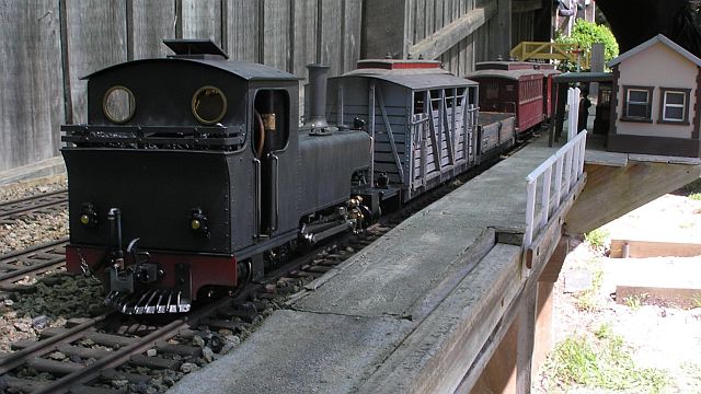

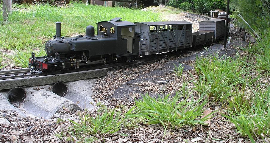

Well I did get to boil some water today, so some more pics. of the same scenes you've surely seen before.
Raising steam in the workshops.
Passengers boarding and staff looking impatient.
Rounding the curve before plunging into the tunnel
Scene 4.JPG (117.78 KiB) Viewed 7644 times
Things are looking greener after winter, won't stay that way for long.
Warringine Creek from the other side.
Bridge over the Warringine valley
Level Crossing into Nayook.
