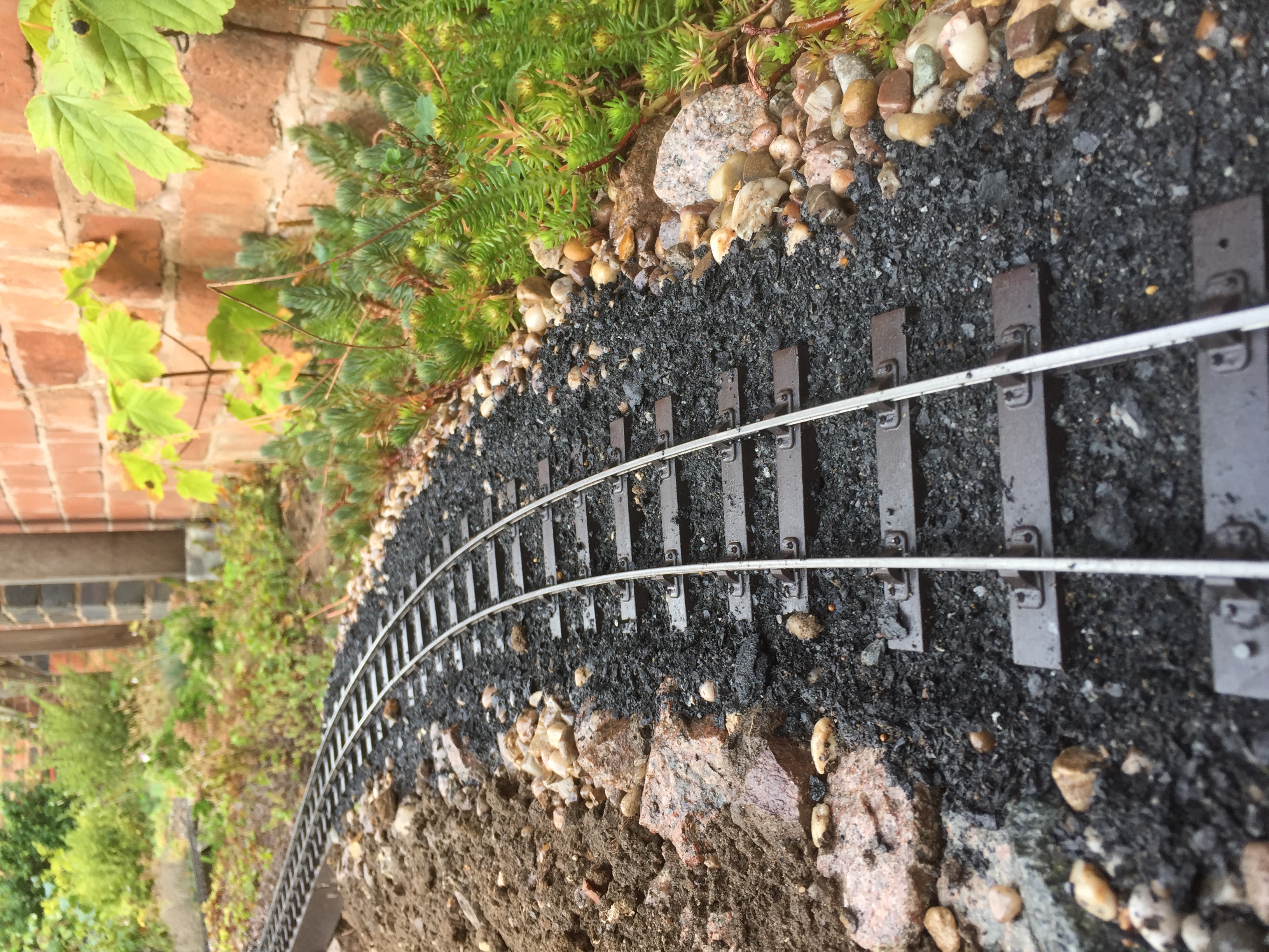

Well, it's been a whole summer since my last update! I'd like to say a lot has been happening - but it hasn't, not on the CFLR at least. Despite good intentions I've not run a single train all summer. I was full of good intentions but you know how it is. On two occasions I've hacked back the vegetation to make sure the track is still there underneath it! On the second occasion last week it was so bad that it actually disturbed the track getting it all clear.
A trip down the garden a couple of weeks ago, to escape from the 'home office' on a particularly bad day and to drink a cup of tea in the peace of the 'well' at the bottom of the path (looking back through the early photos on this thread will illustrate the location) put me at eye level with that really bad spot I've mentioned before. For the first time I noticed that both rails 'sank' into the joint over about four inches either side. Closer inspection (well, it was better than getting back to work!) revealed that the Filcriss itself was causing the dip, I presume as a result of it settling previously. What I have noticed this year is that the ground I built up during construction has shrunk away dramatically over the last two or three years, not just round the Filcriss supports but generally. This, I imagine (and hope) is some of the final settlement from construction. I know ground will shrink and swell but what I've experience so far has been far greater that that normally experience in our soil (and I've done a lot of other building up work around the garden and in the near by allotment). Others, here and elsewhere, have previously suggested that I may have the track too tightly pinned, or that there may be 'too much iron in the road'. Bearing in mind my profession, I thought I'd got the expansion gaps right. Full sized track is held in position by the ballast (in most cases) however in our scale the track is too stiff and the ballast too light to do this. Some degree of fixity is essential. After a lot of further consideration I've come to the conclusion that my joints might be a bit on the tight side. I still don't think the track is too tightly pinned but it's made me wonder.
So, having found this significant dip I considered how best to cure it. Re-setting the Filcriss would mean massive upheaval of an established part of the garden. I had my little cross-level out to check the track around the whole curve where the fault lay (only about 3 feet long) and found it was all over the show. I considered ringing Alton Towers again to see if they would be interested in acquiring it as a new ride, then decided it was probably too extreme! Bearing in mind the considerations in the previous paragraph I eased out a lot of the pins holding the track down. This was one of the sections I ballasted in ash last year so when I eased the track up to correct the dip and faults a fair bit of the ballast came with it. I decided that working more ballast in between and under the sleepers and then flooding it with SBR again, would be worth a try. This form of ballasting seems to give the track some stiffness but also allows it to move slightly, hopefully enough to take up any sideways movement due to heat without it settling vertically. Well that's my hope anyway. It's what I've done so we'll see what happens over the next twelve months.
Before I started this work I realised I was out of ash ballast. I took the chance whilst on duty at Loughborough to visit the loco ash pile with the intention of picking up a bag of ash to grind down for this experiment. When I got to the ash pile I discovered a heap of smokebox char dumped in one corner. This is much, much finer and is absolutely ideal for 16mm ash ballast! I made the repairs as described above and was so impressed with the appearance that I then embarked on a 'ballasting frenzy' which has seen half the lower section of the railway looking much, much more like a proper railway and less like something buried in boulders from the beach! I've taken a few photos so you can judge for yourself whether you agree with me about it being a success. All the best,
SVLR Andrew

I do agree Andrew, it is much more in scale than fine gravel and looks just right. I fell into the same trap by neglecting my railway for the whole season so far and had so much clearing up to do. It is now presentable again and I hope to share some running time soon.
Re: The Charnwood Forest Light Railway
That's looking great - crying out to be tested, in fact!
- Posts: 6033
Yep, I agree with Peter and Andrew, although to my eye it looks a bit too 'black' but I guess time and weather will ease that. Certainly the texture looks much better.
- Posts: 7971
Good to hear from you Andrew.
The texture of that ballast is spot on. As Philip says, it will tone down in time but to my mind it looks perfect as is for station areas.

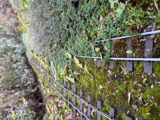

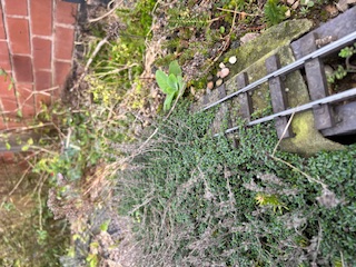

Having recently hung up my track gauge and joined the ranks of the pensioners I have more time to contemplate the future of the CFLR. I'm shocked to find that the last update was just over three years ago! Nothing has been done since mind you so there's been nothing to share. I still have locos in need of repair and maintenance, there are two part finished 'Slo-mo brake vans buried somewhere on the workbench and no more track has been laid. The vegetation has, however, had three splendid seasons of vigorous growth!
I can't see a great deal of further settlement in the Filcris foundation but the track is badly out of line in places (far worse than the photos show). I used half inch brass pins to fix it to the plastic runners and this was done with a 1/16th inch layer of geotextile between the track and the base. These pins don't seem to have done the job. I now have to decide how to move forward as I don't want to abandon the whole idea of a garden railway. I was considering lifting most of the track structure and replacing it with a concrete block foundation. I've been slowly building a stock of concrete blocks and had about a dozen and a half on hand, not enough to to the job with though, but then, one of my allotment neighbours decided to give up half his plot this year. The half coming vacant has hardly been touched since he took it over about ten years ago so the vegetation is worse than that in my garden! He does have a greenhouse on it though and wants to move that up to the bit he's keeping. I offered to help with that and whilst sizing the job up noticed some blocks had been used to edge part of the overgrown plot. He had no use for them so I began to lift them. What I thought was a single edge turnout out to go almost right round that end of the plot. I have about thirty blocks stacked ready for transport! That IS enough to rebuild with so one option is to do what I was considering. All that said, having looked at the existing line and levels again recently I am also wondering if the track could be returned to useable condition by replacing the pins with small screws. Using screws would also make it much easier to correct any minor cross level errors by allowing a bit of shimming to be slipped under the sleeper bases. This would require any ballast to be removed to allow access but one of the disappointments of the track has been the inability to stick the ballast down, despite copious use of SBR. Between the frost and the jackdaws it seems to flake off the geotextile completely. I might get away with leaving it loose if the track was in a cutting but most of it is on embankment so it would wash off down the slope if I tried that one. All that said, simply refixing the track could be an option to creating a useable railway
There's always a but though, isn't there? A review of the back garden this year led me to a decision to drastically reduce the lavender forest that is fast developing but more importantly (for railway plans) to abandon the short row of raspberries that I left in during the original 'terraforming' for the railway. This would allow me to extend the track layout footprint by maybe an extra five feet. I'd need to weave through the gooseberry bushes a bit but it would extend operations. The other benefit of tweaking the alignment would be the chance to move one side of the line further away from the fenceposts that hold up the four foot high fence that stands above the wall between the garden and the street to give a bit more privacy. I'd only gain a couple of feet but it would be enough to allow post replacement without railway devastation. That was always a concern but what I thought was enough clearance at the planning stage doesn't look adequate in reality. Another thing this that this would allow is the reduction in height of the bottom end of the line. When I built it all sources of info I consulted contained dire warnings about gradients steeper than 1 in 100. I couldn't stick to that and ended up with a long stretch of 1 in 50 on the branch up to the house. Experience showed that that this was no obstacle to operation though, so I am much less worried about putting some gradient into the main running loop that I kept almost level. That might help with ballast retention too.
So, it's decision time. I need to devote some more time to the thought process before I decide a final plan of action and I need to think how any extension might fit. but I'd like to have started work by Spring if possible ( and yes, I do mean Spring 2025!). Expressions like 'The best laid plans of mice and men' spring to mind but watch this space and I hope some sort of renovated and useable railway may rise from the remains of the current roller coaster in the not too distant future - although I have no doubt I shall be using you all as a sounding board to develop my plans along the way!
SVLR Andrew
