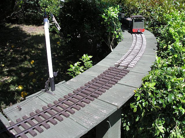

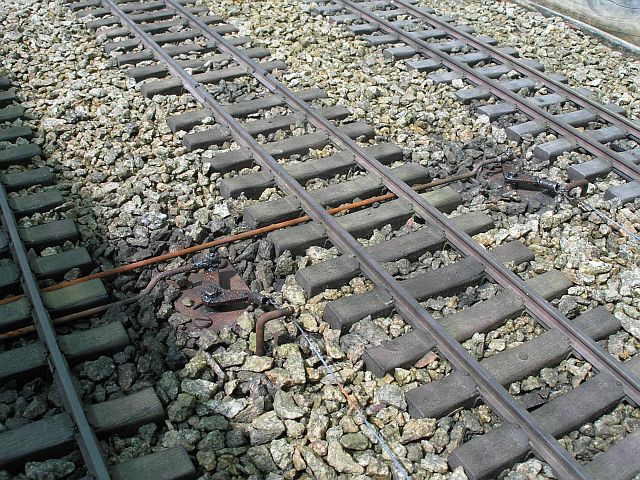

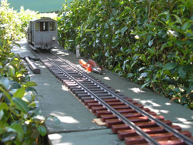

After clearing some winter growth, the track repair gang was out replacing sleepers in some places. Unfortunately due to Chinese Quality control (or complete lack of it) when I purchased my bulk track for the layout it transpired that it was of the batch that had very poor UV resistance (all may be like this, nobody seems to know) so after 10 years in Australian UV it was time to replace the badly affected areas.
Sleeper replacement 1.JPG (190.81 KiB) Viewed 7874 times
The works train with full occupation of the line proceeding to the job site with new sleeper panels.

The first section showing a sleeper panel that was undercoated and painted as an experiment.
Don't think I will continue with this, if the new sleepers last another 10 years I'll be happy.

This shows the new sleepers on the left, and the degraded ones to the right.
They don't need to be replaced as they are still keeping the track in gauge, but if touched
or moved they tend to break. It's only happened where they are in full sunlight, something we have quite a bit of down here.

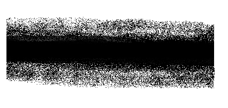

Point 2. This one is a little hard to explain, but any spray gun puts out a pattern consisting of a wet central pattern of full colour surrounded by a larger area of paint that although colouring the surface has not wet out. The following might explain.
It is the dense centre section that the next pass of the gun must come up to, and overlap slightly. failing to do this results in a pinholed finish that gets imbedded with dirt and looks blotchy. Taking ones head slightly to the side will generally show this fully wetted area and where the next pass will be.
