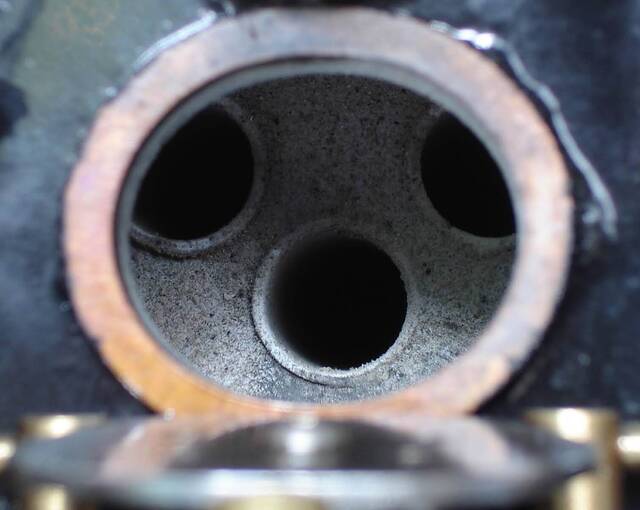

Re: Wild Rose ~ Quarry Hunslet
Thank you Rod!
This fuel is lovely and clean burning, no need for tube sweeping, just a puff of air will do

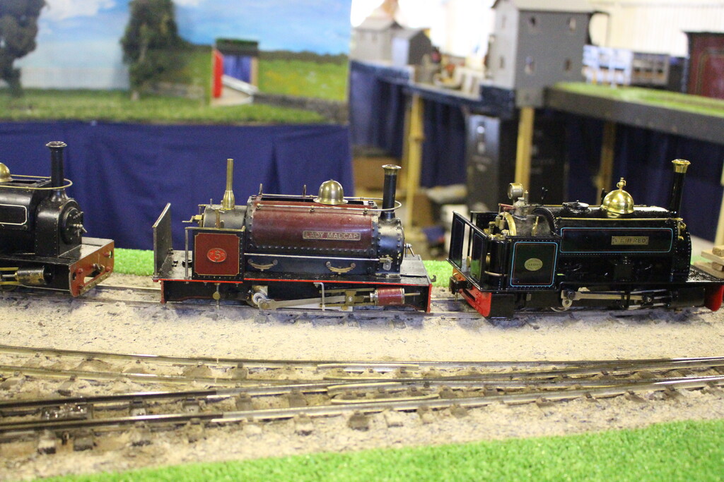

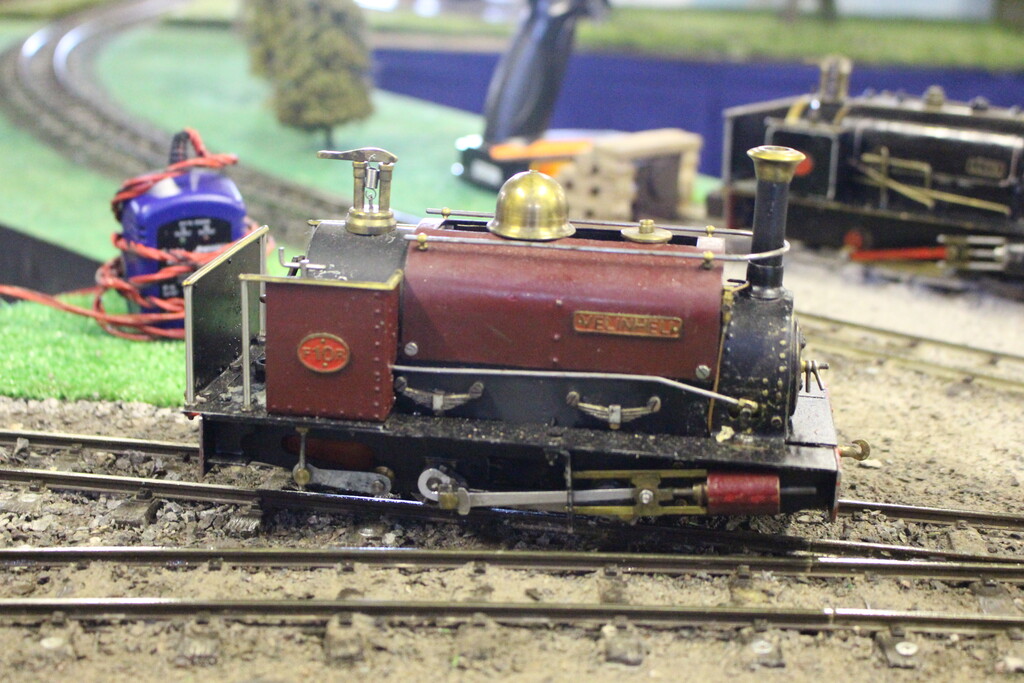

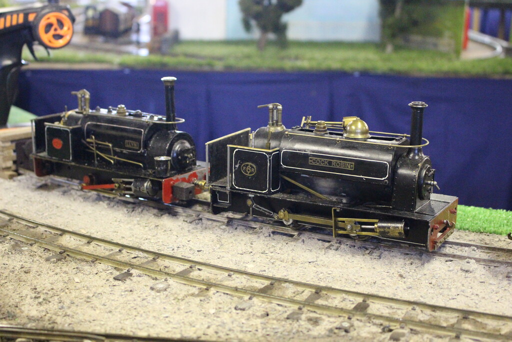

- ax1709cjm
- Posts: 11
- Joined: Mon Mar 07, 2011 6:21 pm

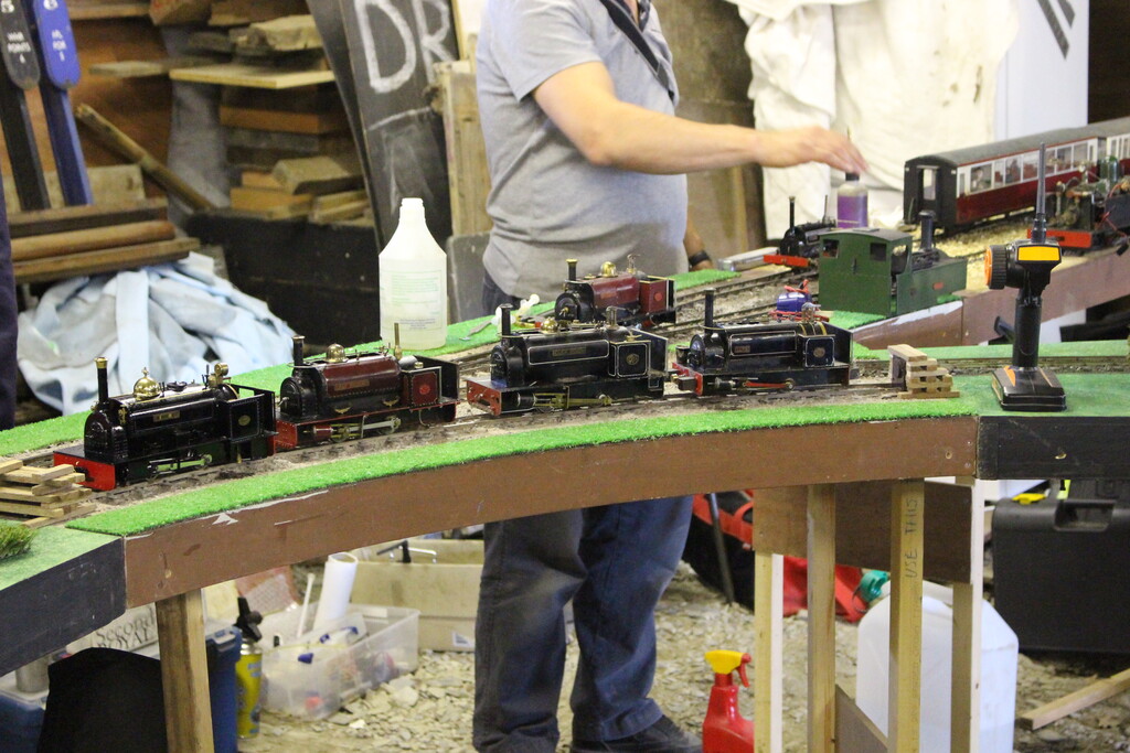

John Foulds hunslets were a bit of a legend apparently. I remember at the Ffestiniog's Hunslet 125 event in 2018 someone (I think one of John Fould's relatives) brought a box load to display on the 16mm layout we were running on. Gareth even steamed one up - 'Tizzy' was a model of Louisa (an early small quarry hunslet) - it ran superbly....
I've managed to find a few pictures - not sure of the drive train in these examples - they look direct drive but maybe they had oscillating cyclinders between the frames?
Four Foulds Hunslets (the front one is a Finescale I think).
Winifred is a Finescale Hunslet I think, Lady Madcap is the Foulds hunslet.

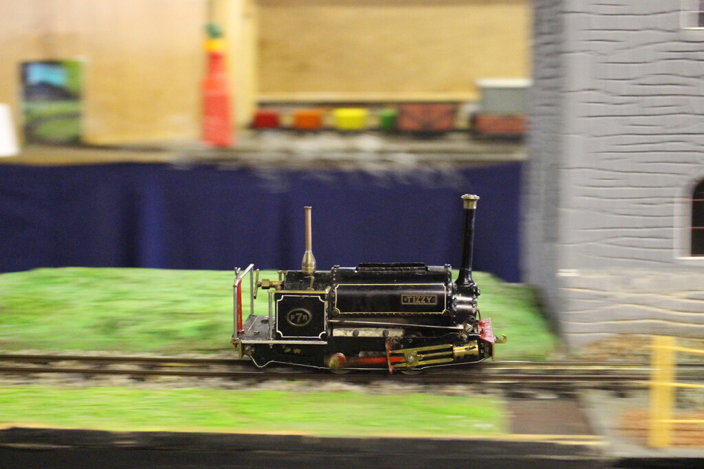

- ax1709cjm
- Posts: 11
Tizzy at speed:
