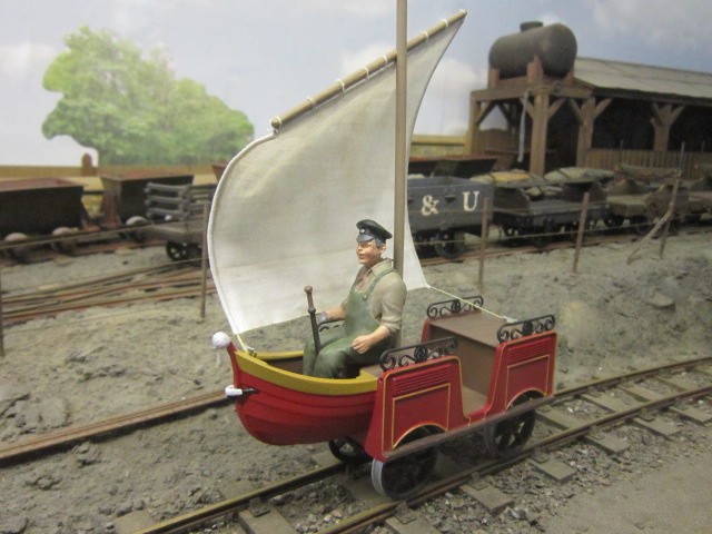

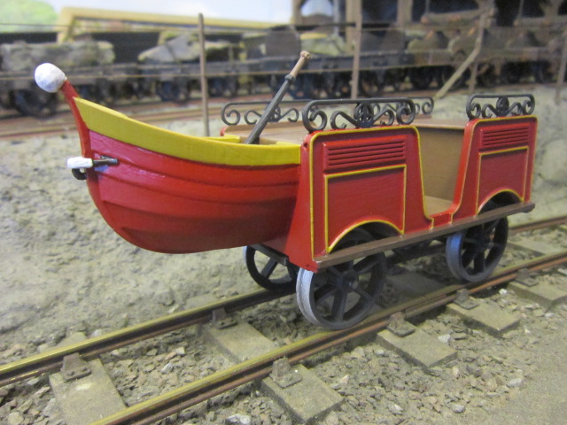

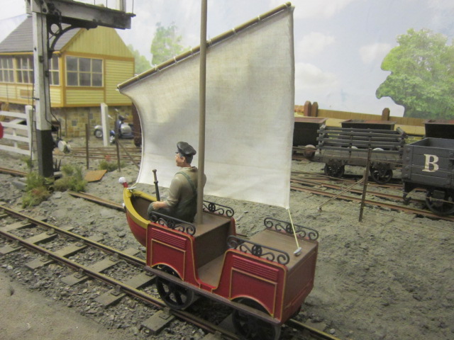

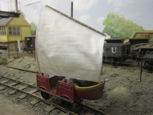

This is the wonderful 'Spooner's Boat' model from Porterhouse Models, which I showed on Dec. 26th 2022. It was originally intended for use on the Ffestiniog Railway and ran downhill by gravity. It then operated across the Cobb with the aid of a sail, fitted at Boston Lodge, to complete the journey into Porthmadog. This model is motorised, although an un-motorised option is also available ....
Here it is today, this time complete with driver figure (from David Clavey) and sail, which now makes it possible to use on my level track and still look correct as I don't have inclines on my line....
- Posts: 7986
That does look good, Peter. Of course, you could always add RC to the sail's mainsheet so you can have it properly wind powered and tack into the wind.
- Posts: 5714
Why stop there Rik? With just a little careful planning I might be able to install a sound system with whistling wjnds, flapping sails and cries of 'Thar she blows' !!!ge_rik wrote: Sat Feb 11, 2023 6:19 pm That does look good, Peter. Of course, you could always add RC to the sail's mainsheet so you can have it properly wind powered and tack into the wind.
- Posts: 7986
Now you're talking .......Peter Butler wrote: Sat Feb 11, 2023 7:16 pmWhy stop there Rik? With just a little careful planning I might be able to install a sound system with whistling wjnds, flapping sails and cries of 'Thar she blows' !!!ge_rik wrote: Sat Feb 11, 2023 6:19 pm That does look good, Peter. Of course, you could always add RC to the sail's mainsheet so you can have it properly wind powered and tack into the wind.

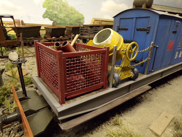

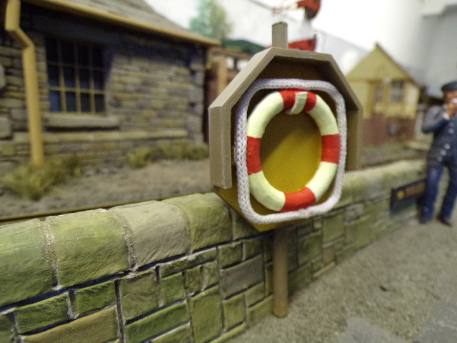

A number of things have been added to the BURPS collection during that time, including some 3D printed bits from a friend.
A life-belt and stand for my harbour scene.... A cement mixer to fix on the stores van of the Drain Train... Some bespoke lettering (vinyl) to add to my fuel oil tanker... and a very sorry looking GRS locomotive... The latter will be the subject of a restore and re-build story.

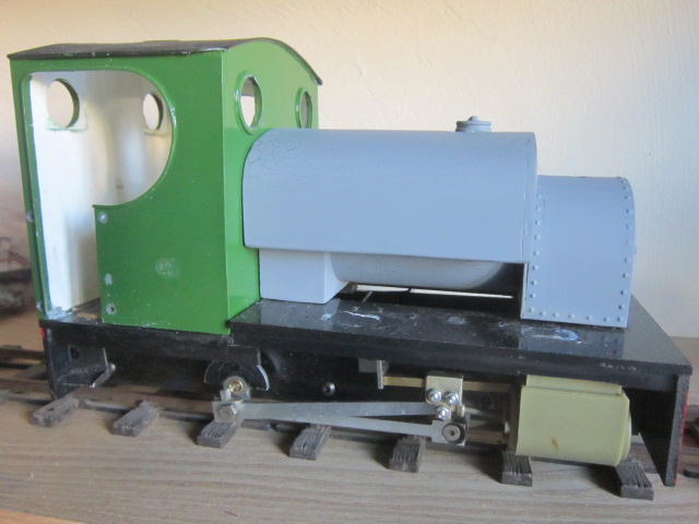

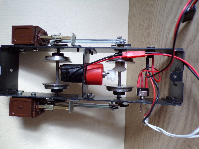

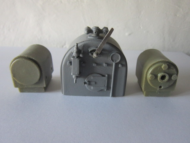

This is to trace the re-build of the saddle tank loco, which was a GRS kit assembled by some unknown builder and handed down to me by my good friend Brian.

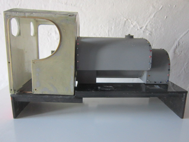

As can be seen from the following picture, the foot-plate had been cut and dropped at the front of the cab.... very strange as the step wasn't included in the metal chassis frame, resulting in the whole length of the locomotive gently sloping down towards the front!
The original green paint wouldn't accept grey primer, even after sanding, so it all had to be removed. Nitromors would barely touch it, so scraping and rubbing with wire-wool was the only way forward. Eventually it was clean enough to start all over again....

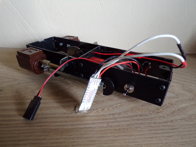

A complete new footplate was cut and assembled with the firebox attached and a wooden effect floor installed... The electronics came with the model but had to be re-sited...

Don't you just love modern paints? It looks like the solvent in the primer attacked the existing paint, you'd pay a fortune for that finish on furniture.Peter Butler wrote: Sat Mar 25, 2023 8:56 pm The original green paint wouldn't accept grey primer, even after sanding, so it all had to be removed. Nitromors would barely touch it, so scraping and rubbing with wire-wool was the only way forward. Eventually it was clean enough to start all over again....
Nitromors was never sold here in Oz, but I think it was reformulated due to EC paranoia about Dichloromethane. 'Safe' replacements never work as well as the original in my experience. All part of life's rich tapestry......... Sigh!!!
I can still get automotive grade paint stripper locally, that will strip two pack acrylic back to bare metal, but it attacks plastic, including resins. On plastic models I use caustic soda (oven cleaner) to remove old paint. It's slow to lift acrylic paints and works better on enamels, but it won't attack plastics.
The new footplate looks much better than the original and the loco won't look like a rack loco now. I'm sure the model will be as well finished as your other models when complete.

The RC included everything, battery pack, Deltang receiver etc. as it was already a fully operational loco, just not a pretty sight! Some modifications were necessary to make items fit and have accessible wiring, including plugs and sockets for removal if required....
The cylinders had never been painted (?) so gave little trouble. Firebox needed some cleaning and painting too...

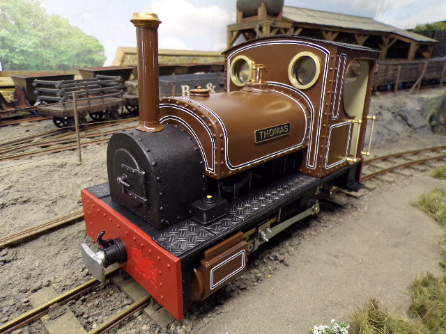

The original cab had pre-cast (raised) spectacle rings and were of quite small diameter, so I filed them flat, drilled them out and searched for replacement brass rings in my spares box. Unfortunately, I could only find one pair so e-mailed my colleagues in the local area garden railway group for advice on suppliers. Straight away I had two replies to offer to make a pair to match them. One of which came from someone I had never met. He asked for details and within about three days they were delivered to me FOC! Wonderful to have such supportive friends in the hobby!
After spraying and reassembly I thought something was missing.... lining! So, another very kind friend offered to cut some from self adhesive vinyl using her cutting machine. I took the loco for measuring and colour selection and decided to have a three-line, white-black-white pattern. This is achieved by cutting a broad white background then overlaying a thin black line in the centre, amazing!...
She was even able to follow the curves of the cab roof and saddle tank...
A final coat of clear satin lacquer and a much improved locomotive joined the fleet!
