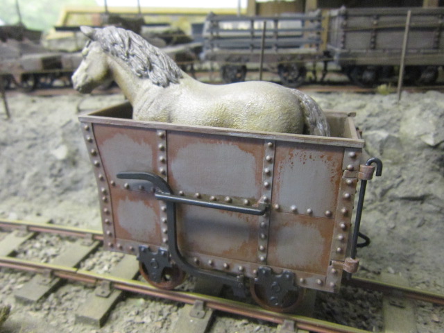

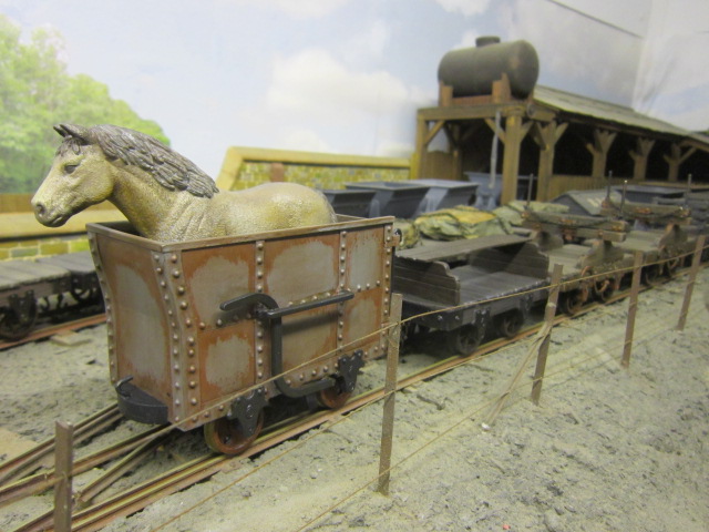

The Dandy wagon is now complete and ready for work, although the pony isn't so keen.....
- Posts: 6034
looks good, Peter. I do like the discolouration around the panels, very realistic.
Looking fine and dandy!
Sorry, someone had to... And it does look very good!
Nice that Peter. Looks like the pony has had enough...

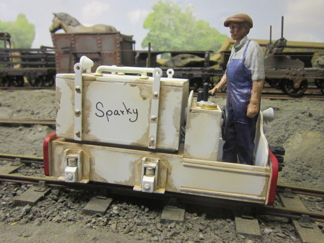

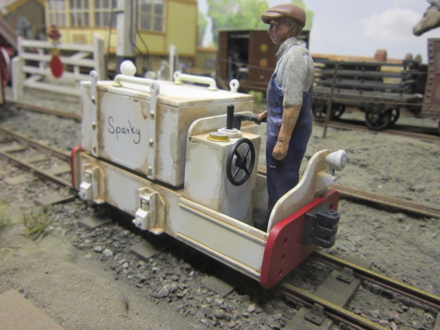

As discussed elsewhere on the Forum, I have no intention of joining the EV market. I do, however, acknowledge the use of electric traction in specific industries, for example, milk floats, waste collection vehicles and mine locomotives. My latest loco build falls into that category, simply because I thought it the best way to solve a dilemma.
The Slater's 'Simplex', shown in previous posts, is designed to be track powered with no space whatsoever for batteries. I initially thought about attaching a small waste wagon, but that proved to be too small to carry the ten AAA batteries (12v) plus the receiver, switch and charge socket with all the spaghetti involved too! It would always be connected whichever way the loco was working, so would look out of place.
My solution was to have another loco to double-head with it, thereby looking good whichever way it/they faced. What better to carry all those batteries than a battery powered loco?....
Meet... Sparky!
. The battery loco is not self propelled, just the power supply to the Simplex, but makes much more sense as a working pair. With Dave Clavey's driver figures, which have poseable heads, they can each look where they are going to complete the picture.

What a novel and elegant solution Peter. Very well done.
Brilliant again Peter. You do have a way with solving problems and still look fantastic at the end.

A neat and very apt solution.
- Posts: 5713
Not quite sure I understand the question Rod.... The loco model didn't just arrive that way; when I built it I painted it white, just as they are usually shown. I guess it was to enable them to be seen in underground locations where dark colours might not have been appropriate? My railway represents a preservation line, so, as an industrial loco, it is preserved as it would have been when in use. I hope that answers your question.FWLR wrote: Wed Nov 02, 2022 7:11 am

I meant 'Sparky' Peter. But I do see your point on the colour.
I like that Peter!

Brilliant modelling as usual Peter.
Very smart to think of a permanently coupled pair.

Thanks Greg, a different approach to the normal, I think, and plenty of scope to make alternative small locomotives which can be paired with 'Sparky'.gregh wrote: Mon Nov 07, 2022 9:51 pm Brilliant modelling as usual Peter.
(I can just see them running around my new indoor layout)
A tiny two-pin plug is all that connects the two, so easily swapped over.

An even smarter idea.Peter Butler wrote: Mon Nov 07, 2022 10:00 pm
