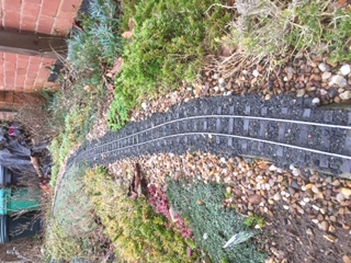

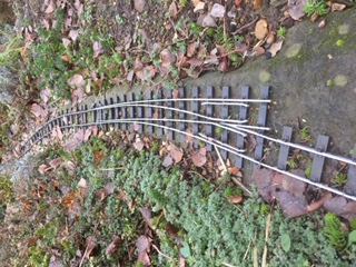

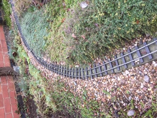

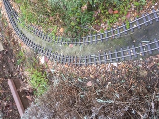

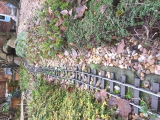

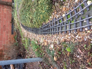

Hello Readers,
I mentioned my 'wandering' track alignment in my New Year post, I have an update.
One advantage of having the railway is that the garden is much lower maintenance, thanks to plenty of ground cover plants and a reduction in 'crop' plants. Most of the growing is done on the allotment these days but I still have a few fruit bushes and a row of raspberries. The raspberries are old now and and some of the canes died off last year, however, there are plenty of healthy roots pushing out from the canes, some came up very close to the railway and needed moving to avoid some incongruously giant foliage beside the track. This afternoon seemed like a good opportunity so I set too and removed the strays to the proper run of canes. This job took me into places I don't often get and thus gave views along the railway I don't normally see. To my horror the alignment problems mentioned are, in places, far worse than I thought. In fact, the kinks are so severe that I'm pretty sure they are bad enough to fetch anything I ran at the moment off the road. I can't pin-point the cause but the problems all see to exist where the maximum amount of 'terra forming' took place to create the railway. I thought I'd thoroughly compacted the ground as it went back in, ramming it with a punner in thin layers, but nevertheless it can only be ground movement which has done this. Many of the 'kinks' are outward, so if it was thermal movement of the track it would need hot weather to cause it - this has been noticeably absent in North West Leicestershire of late! No matter what the cause, I can see no option but to unpin the track and ease out the alignment to something trains can run over smoothly. If it happens again I'm going to seriously consider reconstructing the formation. That would be a nightmare but better than having this palaver every year!
This may not look bad but it's far worse than the alignment I originally layed. This curve is on an embankment between 6" and 12" high on about 2' of filled ground (I was mining sand and gravel from a natural deposit I found!) It was a really sweet, regular curve when layed and has survived for several years without movement. This turnout was built and layed as a straight turnout, it's developed a distinct curve over the last 18 months, the mainline is actually the curved leg and the regular curve that was laid now has 'lumps' in it! There was almost no filling of the ground in this area. The next two photo's are on an even higher embankment than the one previously mentioned, just over 12" of fill and right on the edge of the sunken path. The ground is supported on concrete troughing units laid on their sides on top of each other. I expected this might move as compacting soil into the open troughs wasn't easy. There was some movement two years ago but I adjusted the alignment last year. This is also the stretch I ballast up in ash, held with building glue. It's not a soild bond as there is little other than the Terram under the track for it to bond to but it seems to have held last year (I'm hoping these aren't 'famous last words'!). The next shot is of the loop point at the end of the first embankment mentioned. They were part of the regular curve when laid. The final shot is of the loop at Woodhouse, immediately behind the points, the loops were laid with regular curves and with a constant interval between them, as you can see, that is no longer the case. The cross level has also gone way off here too. I didn't get the bubble out to check - I didn't need to!
It's all very frustrating but, as the old saying goes, 'if at first you don't succeed try, try again' (but after the second try, do something different!)
SVLR Andrew

- Posts: 6033
Re: The Charnwood Forest Light Railway
Andrew,
That all doesn't look good at all. Forgive me but I can't remember if/how your track is fixed down?
- Soar Valley Light
- Posts: 1490
Hi Philip,
It's not good at all.
The foundation is two 2x1 Filcriss strips spaced apart with 2x2 Filcriss blocks alternating with 2x2x18 to 24" Filcriss posts at 18" centres. The space between the Filcriss strips is filled with pea gravel before being covered in Terram (off cuts from the real thing picked up at work), the ground is made up around the filcriss and well rammed to support it. The track is layed on top of this, tacked into the Filcriss around every six sleepers (but up to every other sleeper on curves). The pinning seems to be holding so it's the Filcriss that's moving in the ground. It occurs to me that frost heave may be a factor but there is one short spot (not pictured) between two turnouts where the Filcriss is stiffly braced and well supported by the ground where there is a misalignment normally associated with the worst of the hot weather. I'm really at a loss to explain it. It defies everything I've ever learnt about managing track - and I do that for a living!
SVLR Andrew
SVLR Andrew
Last edited by Soar Valley Light on Wed Feb 03, 2021 7:27 pm, edited 1 time in total.
- Posts: 6033
It's surprising how much stuff moves around, however well tamped, once water gets involved. I suspect that because your Filcris is a rigid construction ( Without expansion gaps, presumably?), once one section moves, it puts undesigned strains on everything else, and that then continues to "wriggle" as it tries to regain its built-in angles and curves every time it rains, dries or freezes.
- Posts: 5713
If so, could that be described as 'not fit for purpose?' I thought Filcris was manufactured and promoted for this job.philipy wrote: Sun Jan 10, 2021 9:16 pm It's surprising how much stuff moves around, however well tamped, once water gets involved. I suspect that because your Filcris is a rigid construction ( Without expansion gaps, presumably?), once one section moves, it puts undesigned strains on everything else, and that then continues to "wriggle" as it tries to regain its built-in angles and curves every time it rains, dries or freezes.

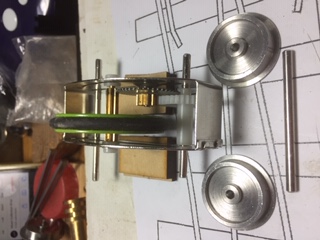

In other news I have made a start on my momentum van. I began by stripping down the Zeecar mechanism. That was more of a challenge than I expected because I've only got a very small vice and there wasn't really room to position the mechanism between the jaws. I found centre punching the axles out from the wheels most successful. At this point I thought the axles were off centre on the mechanism body but on reflexion I now wonder if punching the wheels off may have shifted it even further. The picture clearly shows (on the uncut axle) that they were off centre. It was clear that the body is quite flimsy and the axles are, indeed, free to move laterally by a small amount. Care, in fact great care is needed. The CFLR is a 1'-11 1/2"gauge railway and so I run on 32mm track, my Zeecar axles were about 10mm longer than the IP engineering wheelset axles and so needed cutting down. With the wheels off I did manage to grip them in the vice. When I had finished I fancied I might have kinked the axle slightly, it had certainly shifted in the bearing again but once adjusted looked ok. The IP wheels were easy to 'de-axle'. They were an easy fit on the Zeecar axles, possibly a little too easy. The photo below shows the trimmed axles and the stripped down IP wheelsets.
On fitting the wheels to the Zeecar axles I detected a slight looseness but convinced myself that it would be ok once there was some glue on the axle. When trimmed for 32mm use there isn't a lot of axle poking out of the mechanism, great care is needed to make sure the wheel doesn't carry any glue back along the axle as far as the body. When positioning the wheels to make sure everything is equally spaced around the centre of the body there was a certain amount of shuffling of the wheels, double so when I realised there was still a very slight looseness, enough to risk a 'wobble'. Whilst juggling all these aspects of positioning I realised that glue had migrated a long way towards the body. I gave it a scrape with a blade and thought I'd got away with it. I now left well alone for 12 hours until the two part epoxy had properly hardened.
After an impatient wait my first concern was to see if there was any 'wobble' of the wheels on the axles. I gripped the body and a wheel with a view to 'giving it a spin', to my horror nothing moved, the glue had caught the axle in the body! I ran the blade around the axle where it entered the body and gave the axle a gentle tap and to my relief movement returned! My joy was short lived as both wheels were out of true, the one on the end of the axle I suspected may have been bent was about 3mm out, the other about half that. Clearly this would not do. Some gentle manipulation with pliers had no effect. Leaning back on all my permanent way experience, I picked up a hammer! it was only a small tack hammer and (for a pway man) I wielded it very gently. Some carefully aimed taps to the outer side of the wheel rims followed. This really was a case of 'slowly, slowly, catchy monkey'. Taking it a little bit at a time I managed to get things back into true. I'm satisfied there is no more than 0.25mm of wobble on either wheel now. As the axle also still runs pretty true I am more inclined to think that there was some deformation of the axle during the shortening process and that the movement of the wheels on the axle was a very minor component of the problem.
I had toyed with the idea of mounting the mech on the van floor with a chain drive to the IP wheelset, however, when I looked at the van assembly it looked feasible to use the Zeecar axle so I thought I'd give it a try. A hole was cut in the floor to accept the mechanism before construction started. The build of the body has been progressing all week. My kit building experience in this scale is virtually non existent, this is only my second one. I'm 90% of the way through building a Brandbright hopper wagon. I was thoroughly impressed with this kit, the standard of the components, the clarity of the instructions and the way the kit went together. I like my vans and coaches to be as tall as my (Accucraft) locos so I am always looking for the taller items of rolling stock. The Brandbright brake van looked good but the IP version had an extra 10mm of height so I went with that. It's a nice kit. Subtly different in all aspects mentioned to the Brandbright kit. I fancy there might be slightly less detail but without comparing the two it can be no more than a gut feeling. I may see if I can persuade someone to buy me a Brandbright van for my birthday to have a go with. I certainly want a second momentum van so this may be the second project. I'd like to try a floor mounted, chain driven version of the Zeecar mech and I also have a smaller and slightly less resistant mech out of a Glendale Express toy that I'd like to try - all in good time though! The final body assembly stage of the IP van is sitting on the bench gluing as I type. I'm hoping I might get down to the actual installation of the 'momentum' into the 'van' over the weekend. I'll keep you all posted of course.
SVLR Andrew
SVLR Andrew

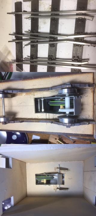

So, what was I banging on about? Well, progress on the momentum van has continued this week, albeit at, well ….. momentum van pace (Sorry!). I assembled the mechanism into the van with the ‘driven’ axles running in the axle boxes on the van. The ‘idle’ axle was mounted above van floor level using scrap plywood fret for brackets. Two of the photos in this post illustrate this. I was quite pleased with this arrangement – right up to the point where I gave it a try. I achieved motion in one direction but in the other there was a tight spot in the rotation of the ‘drive’ axle that stopped the mechanism dead, resulting in the wheels just skating along the rail head. Even 4½lb of steel didn’t provide enough traction to overcome the ‘bind’. I can only presume from this that I did manage to put a kink in the axle during the dismantling process of the original mechanism. I’m surprised by this as, for me, I was being particularly careful. I managed to spring the W irons out far enough to expose the axle stubs and set to with a file to reduce their diameter, the theory being that, with some play between the axle and the bearing, any ‘wobble’ in the axle should be able to occur without binding (but hopefully without the van ‘wagging it’s tail’ like an over excited puppy!). This took several goes but eventually satisfactorily smooth motion seemed to be achieved in both directions, I’ve also added a dab of copper grease in the axle bearings to aid future revolutions. How successful this has all been will only become clear with time. The next step is to road test the thing, but the weather here today is hardly conducive to that (it’s snowing!) so will have to wait for another day. The build has convinced me enough to want to have a second go, this time with the mechanism mounted on the van floor and driving onto the vans own axle using a chain drive. I’m already on the lookout for a Zeecar mechanism at the right price.
The third photo in this post is of the crossing nose on the turnout that came off the works assembly line this week. All my turnouts are built using Cliff Barker components, so I start with some lengths of rail, some plastic ‘timbering’ and a pile of chairs. Cliff’s chairs are designed for Gauge 1 turnouts, they are a pretty good match in size for 16mm chairs but the ‘common’ or S1 chairs I find a little small, so I use what Cliff markets as ‘Bridge’ chairs for my commons. These are accurate representations of a prototype L1 chair, used mainly in turnouts where clearances prevent the use of S1’s. (There is an even smaller M1 chair for similar purposes – both L1’s and M1’s are also used on ‘Way Beam’ bridges, hence the term ‘bridge chair’). Even with these reduced footprint chairs, the prototype still requires the use of ‘special’ chairs in the tightest locations. These are very specifically manufactured for locations on particular angle crossings or particular sized switches (also angle related). These locations are the ‘tricky’ areas for building turnouts in the way I do – fortunately, for my standard 8’ loose heeled switch turnouts with a 1 in 6 crossing nose there are only three such specials (if you discount the switch heel ‘hinge’ assembly). Getting these right in the crossing nose is particularly important as they also partially hold the vee and the wing rails together (although in the prototype bolted blocks form the main assembly connections). Over my various builds (this is turnout 11) I have tried various methods, some have been retained some have been ditched. Most recently I’ve been trying to improve the manufacture of the point and splice rails which form the vee. I file these up from plain rail, I’m no machinist or mechanical engineer, so forming these is one of my weaker areas of expertise. The greater area of experimentation has been in the means of assembling the vee and the wing rails. My early attempts attempted to araldite spacing blocks between the wings and vee then, once firmly held, using cut down slide chairs to support them and hold the complete assembly in place. The blocks were necessarily small and fiddly, so achieving an accurate and consistent size and shape was not easy. The flangeway dimension is critically important and there also needs to be sufficient clearance for the flange above the block. These factors made the procedure time consuming, fiddly and at risk of disastrous inaccuracies. More recent builds began to experiment with the use of ‘cut and pasted’ chairs to form the gap. This latest version uses cut down check chairs in both the A and B positions (crossing nose and first after the crossing nose) and appears to have been the most successful yet. Time will tell how this arrangement stands up to life in the great outdoors! For the time being the CFLR engineer is satisfied with the result.
Once the weather improves enough to get out for a test run (probably about June!) I’ll update you all on how I get on with the van.
SVLR Andrew
I seem to have to re-learn some lessons over and over again. I’ve just spent the better part of an hour composing a post, only for it to vanish into the ether again when I came to post it! Only then did I remember that when writing a post, particularly longer posts or ones that will be written with interruptions, the safest way is to write them in Word and copy and paste into the post when ready. Hey ho!

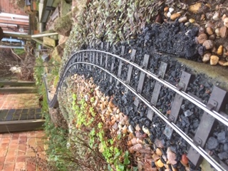

Greetings dear readers,
Having picked up a new loco just over a week ago I was very keen to give her a try. It was something I've been after for ages, the final one of the pair that will be the CFLR's loco fleet. I'm now working on an excuse to keep by rebodied Edrig (complete with tender) and Excelsior, both of which are beautiful loco's. My line is starting to have more than one parallel with the Cambleton & Machrihanish - and I'm not sure whether that's a good thing or not! There would have been no good reason for the CFLR to have more than two locos but I suppose they may have picked up a quarry loco or two.... but I digress (how unlike me!)
The first problem with having a run was whether the road was in a fit state to run on (a sad dilemma for a permanent way man!). Some brutal 'shuffling' of the worst sections of misalignment eased most of the problems. I had to set to with some pruning equipment and beat the undergrowth back but having done all this I decided it was worth a try. All this was very much a spur of the moment decision with a spare hour I had on Sunday when the weather took a turn for the better. By the time I'd complete my preparations it was spotting with rain again but nothing was going to deter me now! I was pleased with the loco, although the valve setting on the reverser seemed slightly out. I had the momentum van rigged up with a temporarily fitted coupling so I decided to give it a go. On the last light engine run back to collect the van the loco stopped responding to the R/C. Of course, not having planned the run I hadn't charged the loco up! I tried a couple of trips in manual but that seemed to be the end of reverse gear. I decided there was just enough steam left to give the momentum van a try so I hooked the engine on but as I did so the gas ran out! The bad luck continued as the clouds thickened and the rain began to fall, so I was officially put off a further steaming and retired indoors to seek for a solution in my best mates rhubarb vodka!
My permanent way had performed reasonably well under the light engine running. There was one spot where she persistently ventured onto Olde England but a little bit of extra ‘manipulation’ seemed to cure the problem. Whilst recognising that a light engine is far better at getting across the ‘lumps’ than a complete train, I was encouraged that the problems I’d spotted after the Winter may yet be redeemable. The wetter parts of Sunday had seen me sorting the chaos that passes for a cellar in our house. My workbench (such as it is) is down there too and I was running out of elbow room, so a sort out was inevitable. During my rummaging I came across a couple of vans I’d picked up amongst some other bits but which I never really intended keeping. The sun came out briefly on Monday so I dashed outside with them to get a couple of photo’s with which to advertise them for sale. The best spot for this was on the ballasted section of track which has remained stable since the ballasting work was completed. In the process of rolling them up and down to get the pictures I discovered a massive twist fault had developed. Correcting this would mean clearing away all the glued ballast to shim up under the sleepers. Some further investigations a little further along revealed that the ground had heaved substantially under one side of the loop points causing further significant twist problems. I’m coming to the conclusion that I’m left with little option but to go for full on reconstruction. If this ends up being the case I’m wondering whether to start completely from scratch or try and re-use those sections which have remained stable throughout this sorry story. I’m talking about maybe a third of the track that might be safe enough to leave. Once the weather is a little better I think a much closer study is required – and then it will be make your mind up time for yours truly!
SVLR Andrew
SVLR Andrew
