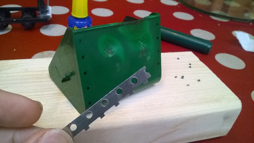

I'd decided that I wanted to add some "nail art" rivet detail to my wagons before painting them - and that a template would be required to make sure that all the rivets ended up roughly correctly-spaced and more-or-less in a straight line. I must confess that I was very pleased with the solution I came up with - the little strip of perforated metal that holds Peco rail-joiners! Here it is, with a skip marked up and ready to go...
Tipper marked for rivets.jpg (260.82 KiB) Viewed 12200 times

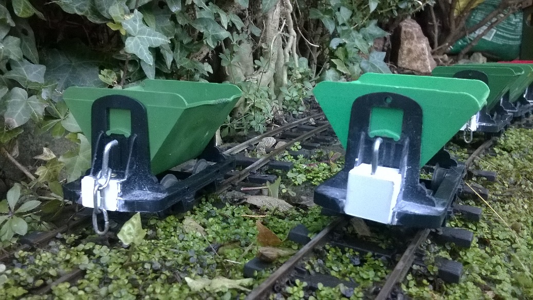

I've now added rivets to all five wagons in the initial rake, which are dismantled ready for painting next time some time off coincides with some relatively good weather. I'm going to attempt to simulate rust using fine iron filings, and I think getting that in the right places in the right amounts is going to be tricky so I definitely want to make sure I've got enough time and space to do the job as well as I can...
Here are the wagons awaiting a visit from the spray can...
Tippers ready for painting.jpg (288.41 KiB) Viewed 12200 times
Cheers all,

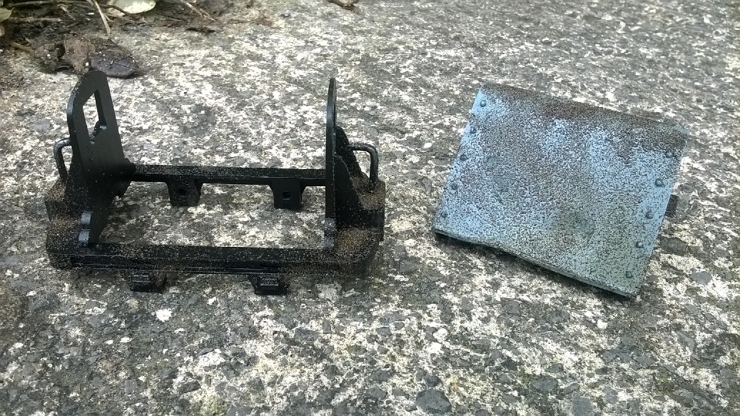

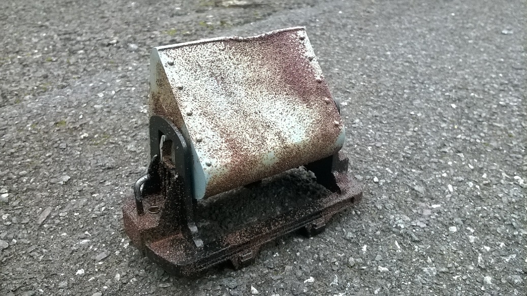

I've started with just one tipper to see how I get on with a rusting technique involving vinegar and fine iron filings - I've used it before but never been entirely satisfied with the results, we'll see how it goes this time... Here's where I was at yesterday afternoon, with the skip and chassis painted, sprinkled in filings and sprayed with vinegar:
Painted skip with rust powder.jpg (457.96 KiB) Viewed 12830 times
At that stage it just looked like someone had tipped sand over it, but this morning most of the grey filings had gone brown, with some orange appearing in places - promising... I sprayed with more vinegar and we'll see how it looks tonight... By the way, if it's successful this is how I plan to finish the roof of your station building Tom - a little dilapidated rather than completely derelict, but it wouldn't be right if a RWLR building didn't feature at least a little rust!

I tried this technique on some scrap plastic a while ago. I got some lovely orange/brown rust, but I'd used "medium" filings and the texture was too coarse. If gone for "fine" this time - there's still some discernible texture, but I'm hoping that will look like pitted metal.
Yes, I'm applying direct to wet paint, doing the inside of the skip first, then turning it over to do the outside without covering the filings on the inside. I'm using a Lidl peppercorn refill pot as a shaker to apply the stuff, I think I might add some finer mesh for future applications, so I can get the stuff where I want it better. I'm diluting the vinegar, c50/50 with water - not quite sure why, I think I read it somewhere!
I'll keep you posted. I'm relatively optimistic but think I'll still want to apply some paint washes/weathering to finish the thing off - the bits that aren't rusty look too clean! Possibly I should have weathered with paint first, then sprinkled the filings over a coat of matt varnish...

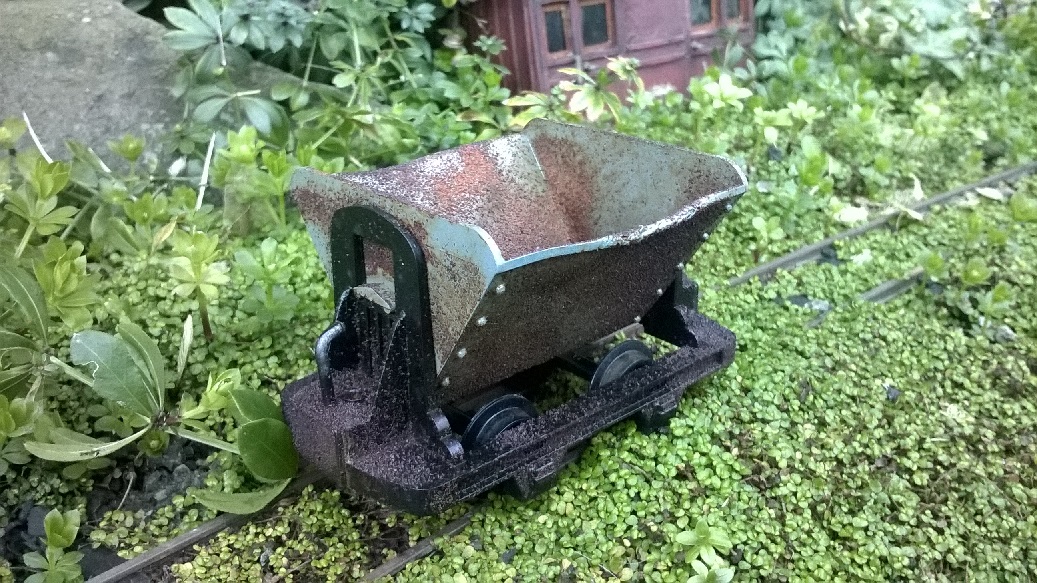

I seem to have reached "peak vinegar" with this, in that no matter how much I spray on the result doesn't really change. The tipper currently looks like this:
Rusty skip 3.jpg (382.83 KiB) Viewed 12463 times
I'm fairly pleased with it, but would still like a bit more orange in the rust, so it's currently parked in the damp and dingy tunnel to see what that does... Another option is a light rubbing with fine wire wool - I've just read Rob Bennet's article on rusting skips in the Association Leighton Buzzard guide, and that's what he recommends...
Even if I can't get the colour to change any more, it'll do - this rake was only every supposed to be a quick job. I'll get the rest of 'em done over the coming weeks...

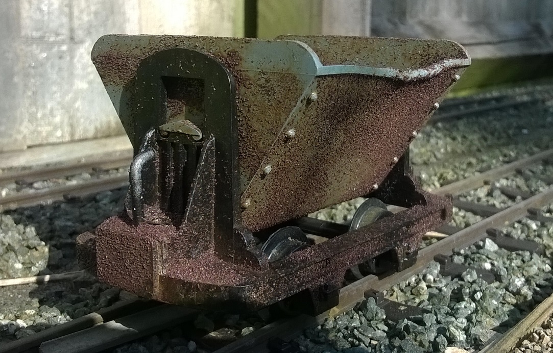

Thanks George! Yes, I think I'll add a wash to some of the bits that are still too clean - I'll probably roughly stencil some numbers on too. Glad you like the track - it's got a little too overgrown, I'll have to trim it before the main running season starts...
I got the first wagon out in the sunshine for a proper look today, and I reckon it's looking alright - the rust tones look really different depending on the light. I think the wire wool rub had some impact too, although I couldn't swear to it...

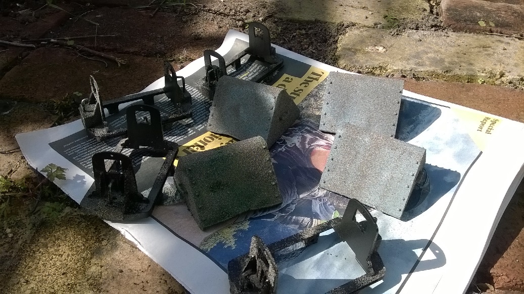

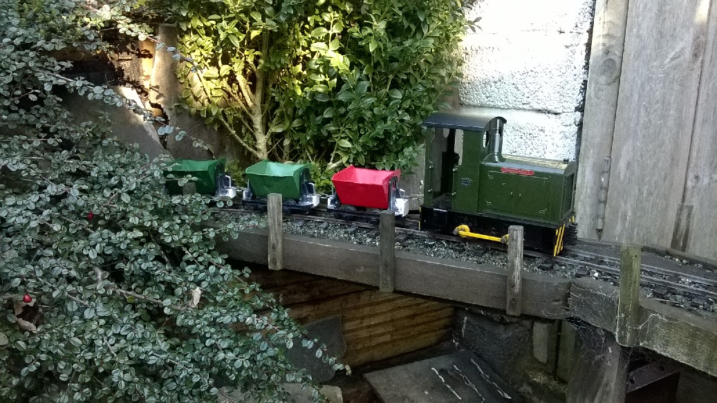

Is anyone getting fed up of looking at this little skip yet? I am, so I decided I'd done enough deliberating and got stuck into the rest of the rake. Here they are, painted (three more grey, one green for a little variety) and sprinkled and awaiting a spray of vinegar...
More skips 1.jpg (342.06 KiB) Viewed 12407 times
Cheers all,

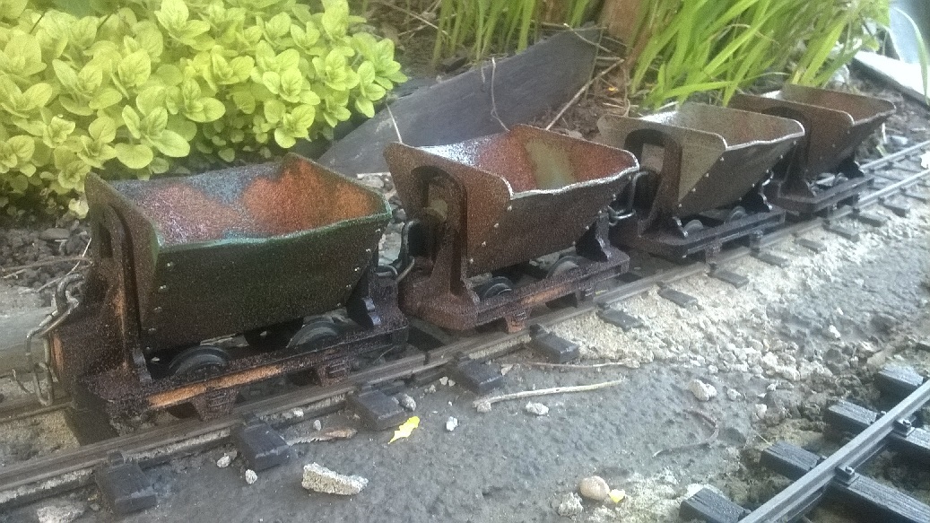

by Andrew
Hello again,

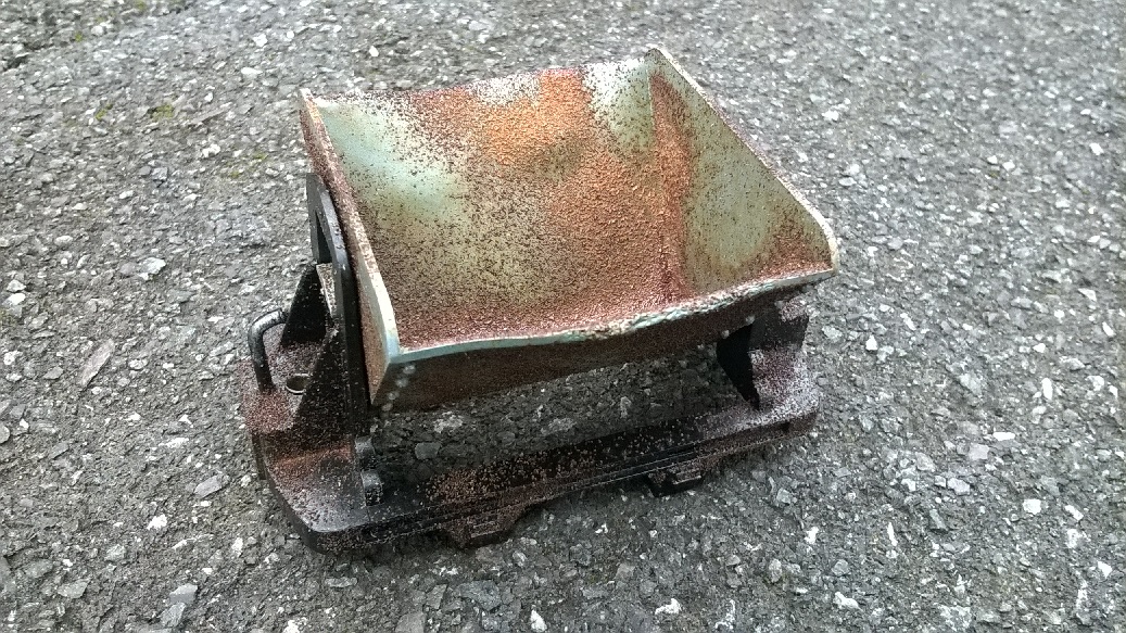

The tippers continue to progress... The first coat of vinegar dried very quickly due to a combination of sunshine and breeze, leaving slightly odd "tide mark" patterns in places. I remembered that Rob Bennet had suggested letting the vinegar dry in a damp environment, so yesterday evening I reapplied the vinegar, put the wagons on the top shelf in the bathroom, and had a hot shower with the windows closed. As you'd expect, I removed my clothes before undertaking this activity - I believe that's known as "glamour modelling"???
Any way. here's a photo - just of the wagons, you'll be pleased to hear, not the process!
More rusty tippers 2.jpg (332.88 KiB) Viewed 12338 times
They certainly look as grotty as I'd wanted - with a little more work I hope I can refine the finish a little...
Re: (WH)WHR Rolling Stock
Posted: Wed Mar 27, 2019 11:37 am
Andrew, they are looking well, I like the rust effect, particularly on the green one.
Please don't think I'm being critical but all the way along I've thought the grey ones seem to have a sort of pale metallic green sheen to them. Is that just a photographic artefact?
