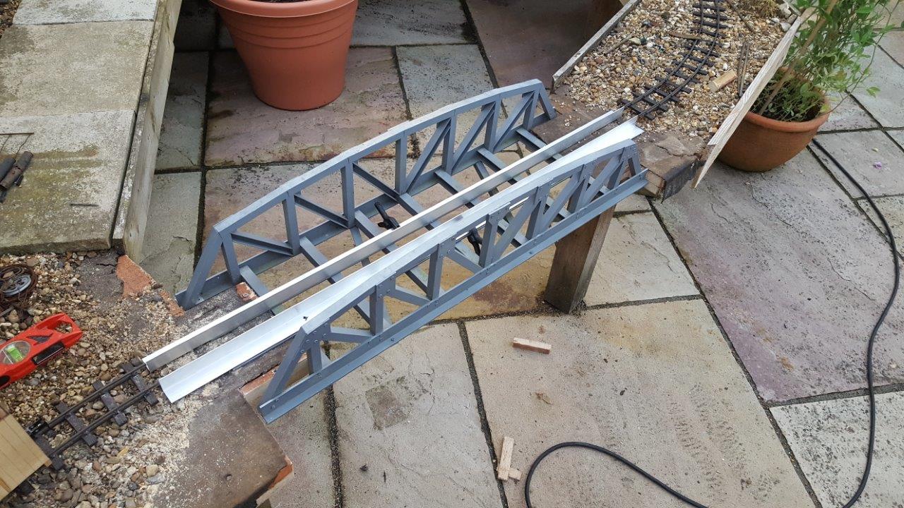

Although the wood decked option looked brilliant for under £20 I went for more iron work:
The additional angle needs more adjustment and attaching permanently to the bridge but it's looking promising!

Should I be pop riveting the new aluminium angle to the bridge base or can I just use nuts/bolts?
I don't have a pop rivet gun but they are cheap enough if needed.
Re: RWLR - Robin Wood Light Railway
Posted: Tue Aug 15, 2017 11:23 pm
Pop-rivet guns are incredibly useful things to have around the house for all manner of jobs, it would handle this perfectly.
Posted: Wed Aug 16, 2017 6:22 am
tom_tom_go wrote: Tue Aug 15, 2017 10:33 pm Should I be pop riveting the new aluminium angle to the bridge base or can I just use nuts/bolts?
I can't see why either wouldn't be perfectly Ok. I agree with Peter, though a pop rivetter can be very useful and its the sort of thing you don't know you are going to need until the need arises, as in this case. So I'd suggest getting one anyway, as you say, they are cheap enough.
It's a lot easier to dismantle a bolted joint and they can be adjusted if necessary.
The 'pop' rivet was developed to fit two parts together where there is no access to the back of the joint, hence the name blind rivet.
I do note though that the bridge appears to have been assembled with blind rivets as well as screws, so using either for the added parts would blend in.
I can't remember when I last used blind rivets and I don't own a rivet gun. I seem to get by though.......

Thanks guys. I ordered one anyway but may bolt it together first to make sure it all works before riveting.
At least it will be another new skill I have learned since playing trains (stuff I should of been taught in school).

One thing to remember with pop rivets is that although the rivet is ally, the stem is steel. In an outside environment this will soon rust and cause unsightly stains, although I do appreciate that this is something that you might want.
The heads on these rivets do sometimes fall out of the rivet as the stem breaks off and sometimes it is possible to drive the head of the stem out if you so wish.
