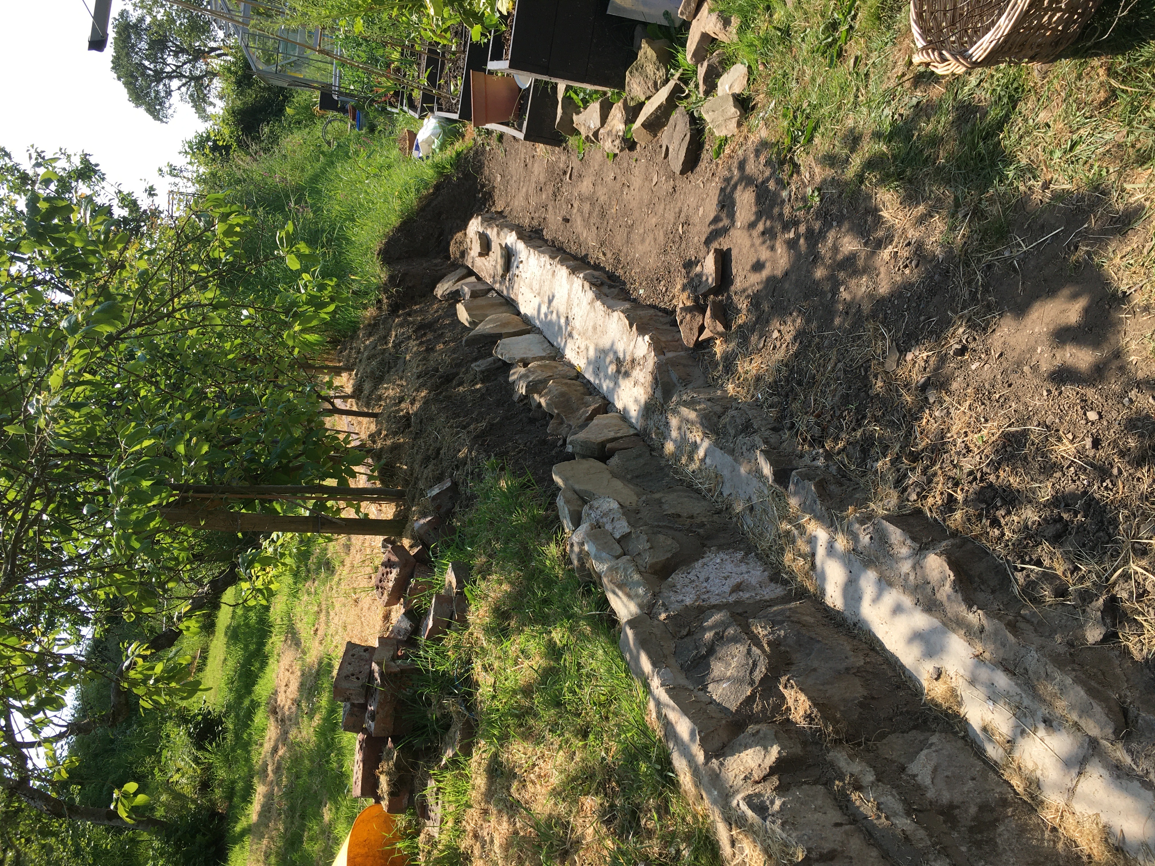

Posted: Sat May 06, 2023 1:21 pm
by Trevor Thompson

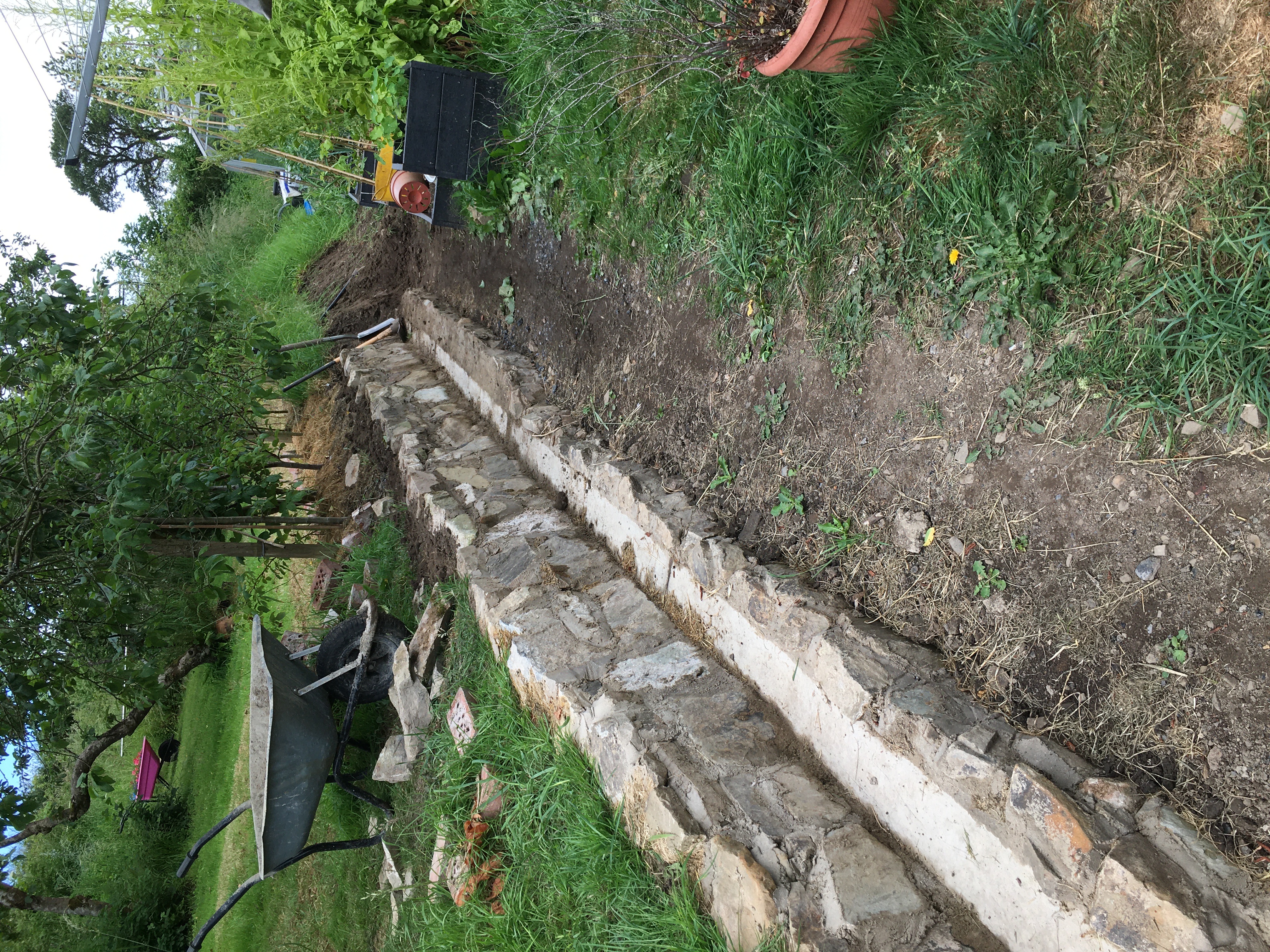

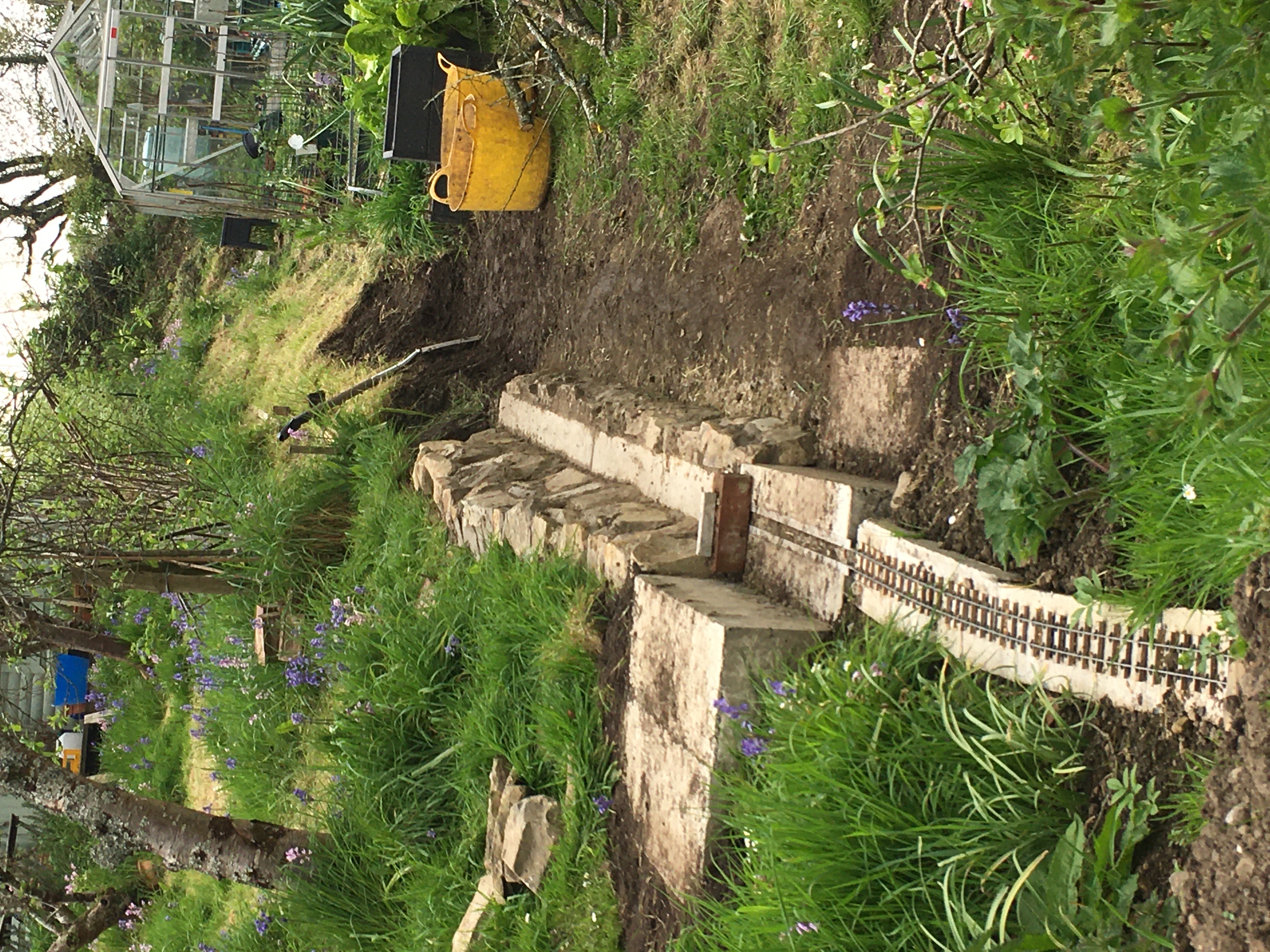

The first section of wall - and track bed - is complete, and I have started to dig out the second section:
The camera foreshortens the distance. Each of the concrete gravel boards for the track are 6 ft long - which makes that short section of wall 12 ft long.
It is a bit of effort - but I am on schedule!

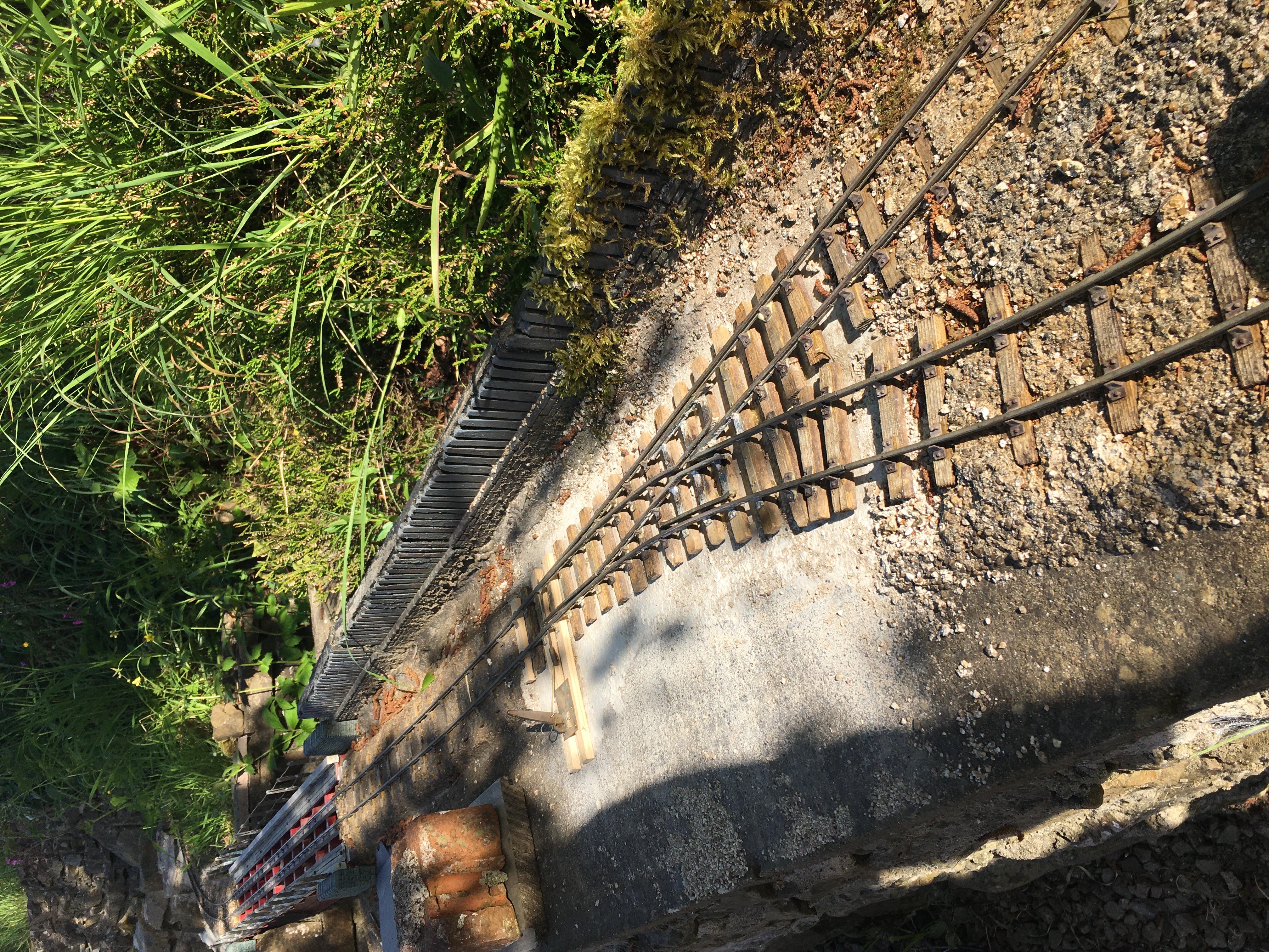

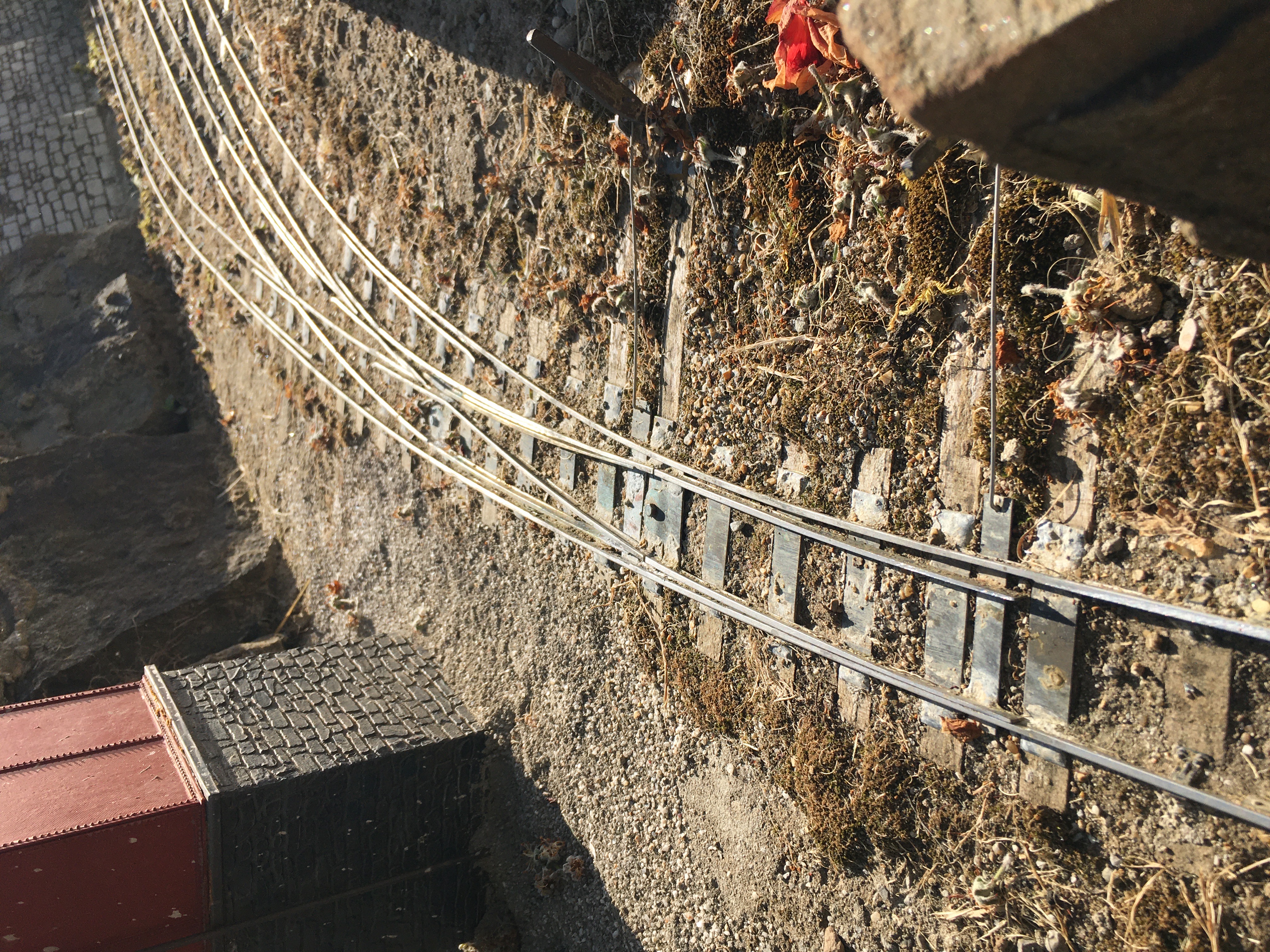

Firstly one of the first set of points I made (10 years ago?) was a problem. The frog was lower than the wing rails - and the gap between them was too narrow. The chairs which have a pin fitting into a hole in the wooden sleepers were coming out of the holes as well. Most things seemed to cope with it but not everything. So I removed it and rebuilt it:
It just needs ballasting when we get some damper weather.
The curved 3 way point at Tan - y - Bwlch also caused derailments. The outer set of point blades were too high at their inner end where they pivot. It was just ballast stuck under the rail where it moves causing it to rise a mm above the rail level - enough to cause some things to derail when going downhill (particularly my Cleminson 6 wheel coal wagon). Easily fixed:

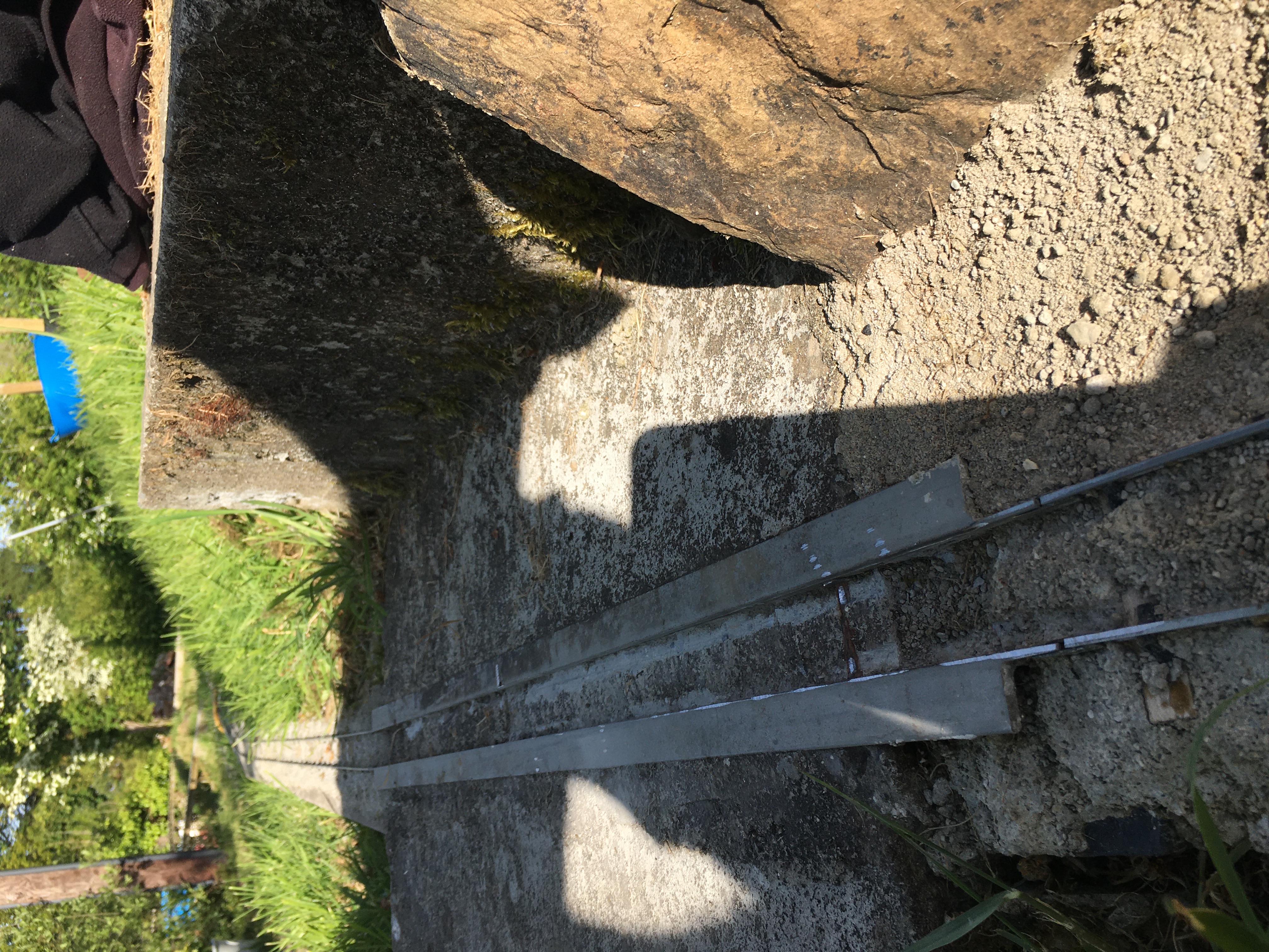

One of the path crossings where the track is actually stainless angle set into the concrete turned out to have the angles set too close together at one end. 31.5mm apart instead of 32mm apart. Perhaps the more significant problem was that this led to the fish plates narrowing the gap even further, where my attempt to create the rail profile had not been quite good enough. Fixed with some judicious grinding of the angle and then very gently on the fishplates:

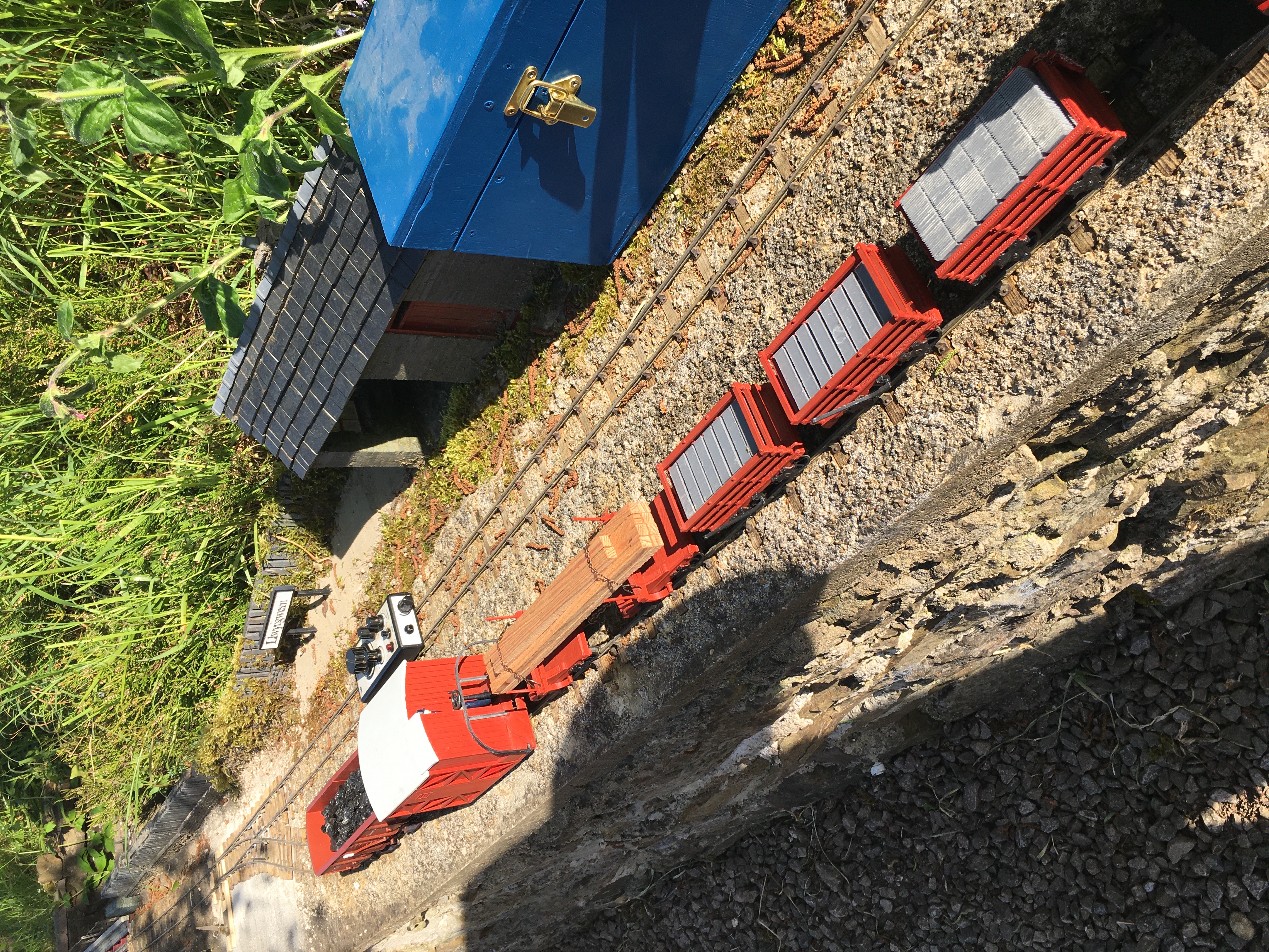

And finally a test train consisting of all those things which seem to like derailing. The Cleminson 6 wheeler, the bolster wagons, a brake van and some slate wagons for the sake of it:
And it all ran up to the head of rail and back without anything coming off! Very pleasing.

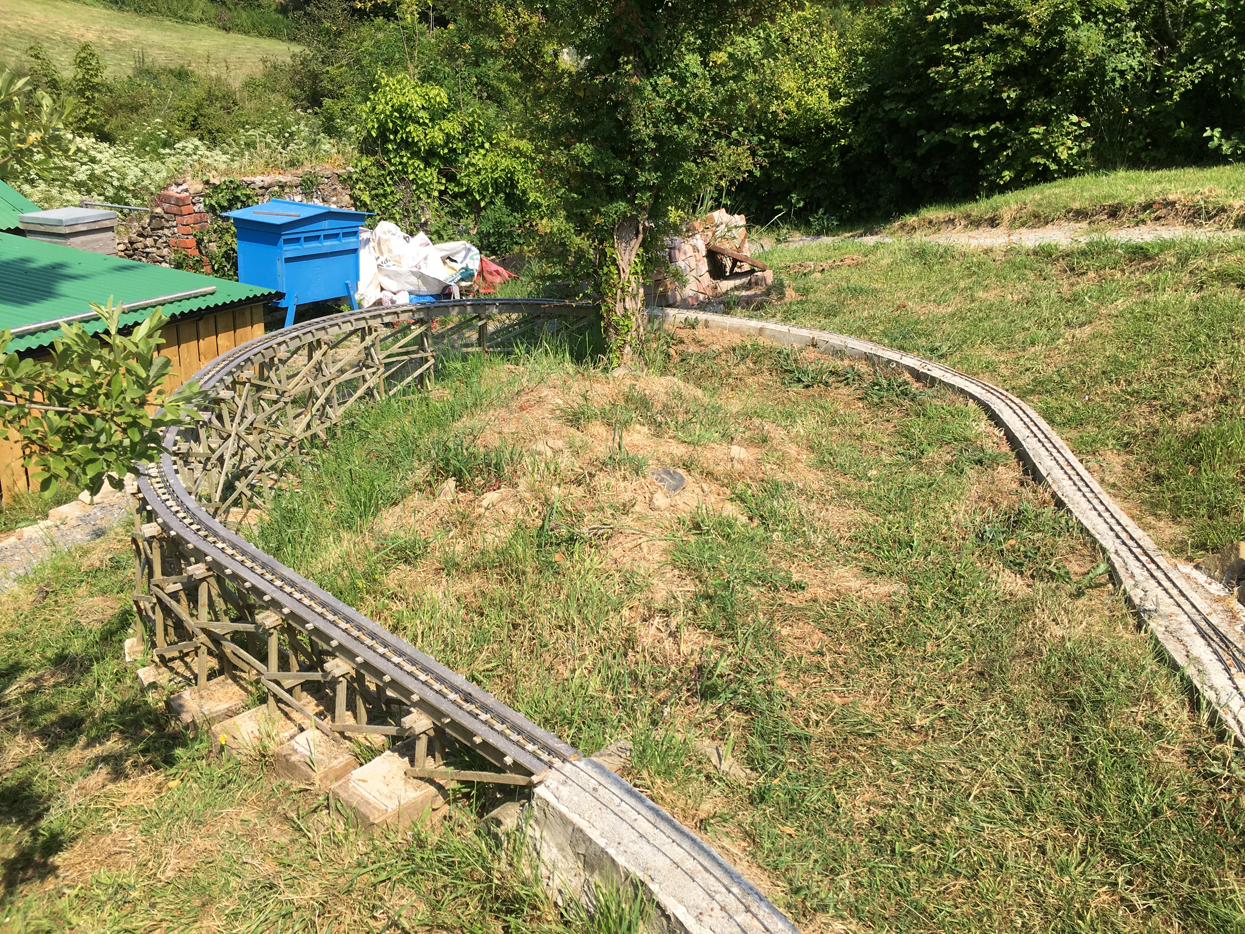

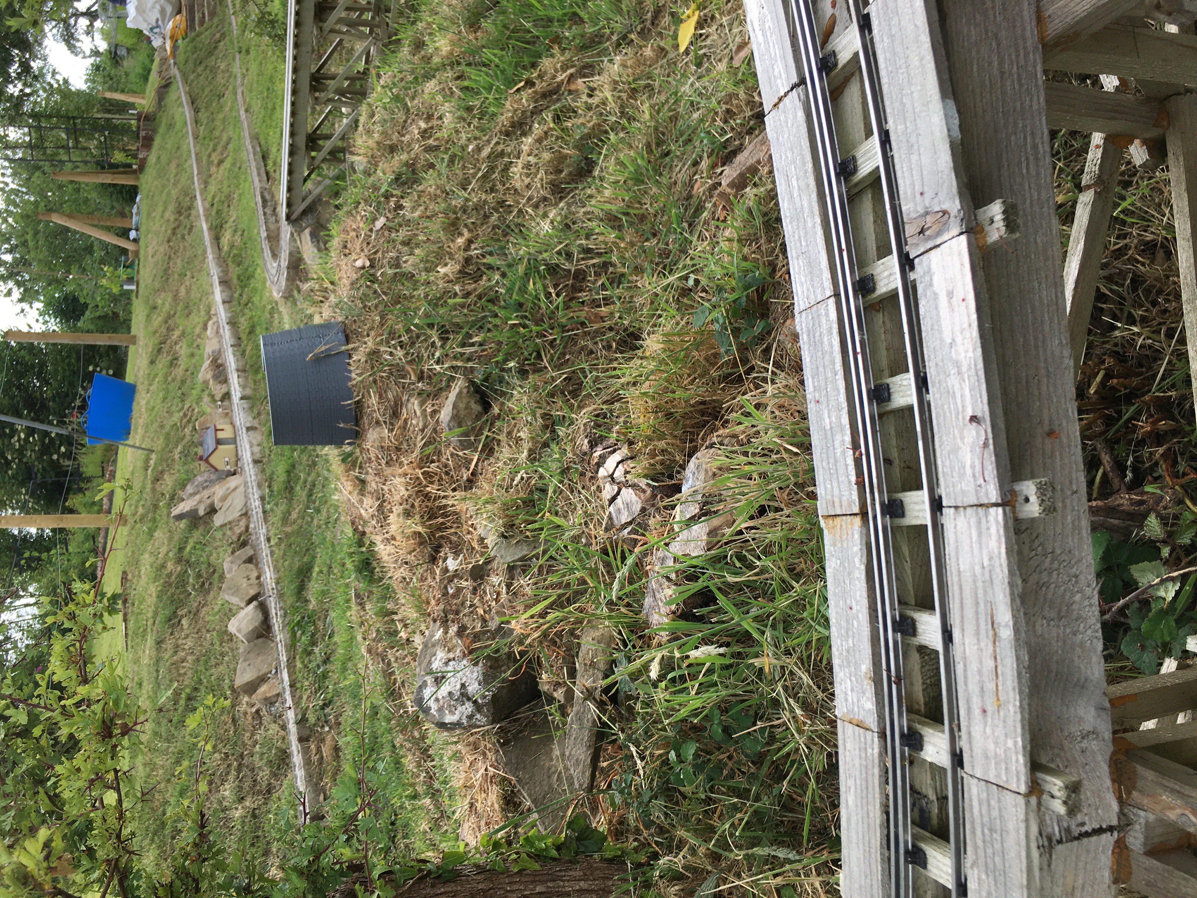

Dinah has been getting enthusiastic about planting around the railway, the result of this years Peterborough show, and garden railway visits. So we have been looking at the pile of rocks in the middle of the trestle viaduct:
Our first thoughts were about a pond in the middle, which could have included a stream with rocky waterfalls going under one of the trestles. We have reconsidered our ideas and now think that a castle on the pile of rocks might be more appropriate.

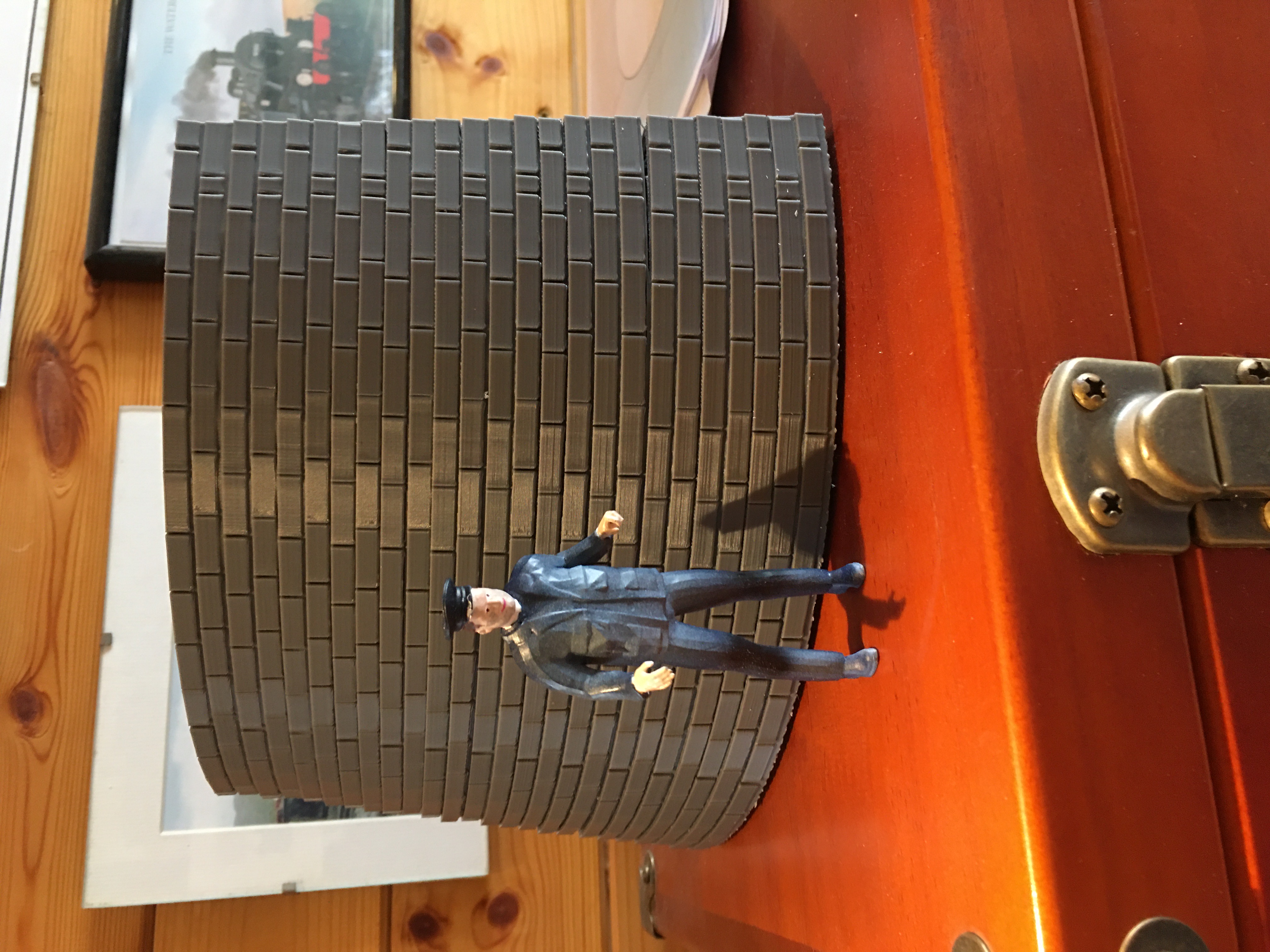

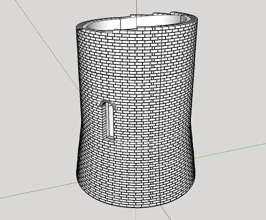

So the keep of the castle is designed and I have started to print it:
Screenshot 2023-06-08 at 15.36.54.png (119.09 KiB) Viewed 8821 times
The tower is about 300mm diameter at the base. You can see that the bottom section is "battered" (it is tapered - to a smaller diameter at the top). So that is printed in 4 parts - 1/4 at a time. The middle Layer has three identical parts and one unique section which has the door in it. The top layer is again in 4 parts, but only two are the same (mirror images of each other), and the other 2 are different - on higher and one lower. That top section is intended to look as though the mortar has decayed and stones have fallen off.
Another big building - each of the bottom tapered layers are taking 24 hours to print. Updates as this progresses.

The second section of retaining wall is now completed, and digging out for the third section started:
When the third section is complete I can start to make track again to take the railhead to the new passing place in the second section of wall.
