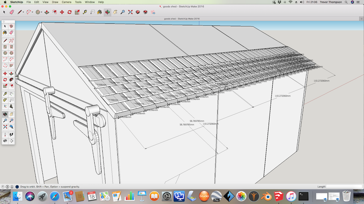

I am trying to make the roof with the slates printed into it. Here is the drawing so far:
The builders are currently making the new slated roof on the cottage and of course I have been watching them! So the bottom layer of slates on this roof (small ladies by the way) fit with joints on the joints in the three roof sections. Of course the next layer up which has wide ladies at each end (1.5 times the width of small ladies) make a slate straddle the joint in the roof panels. I am in the process of creating half slates for each side of this joint. I am hoping that the joints in every alternate layer will not be obvious.
The alternative would be to print individual slates and stick each one down . Can do that as I have created a stack of individual slates as a wagon load which split into individual slates. That is the reserve option. Its in reserve because I think I can line the slates up better the first way.

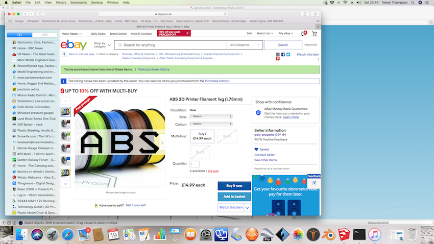

Where do you buy your'e filament from please.

I get my filament from eBay, and specifically this seller:
I have found it to be consistent and that all the colours I have bought actually work equally well.

Thanks guys. I can't find your seller though Trevor..

Its called PolyProps Ltd - its still there. I usually find it by looking for ABS printer filament and scrolling down until I see that picture with ABS splashed accross it.

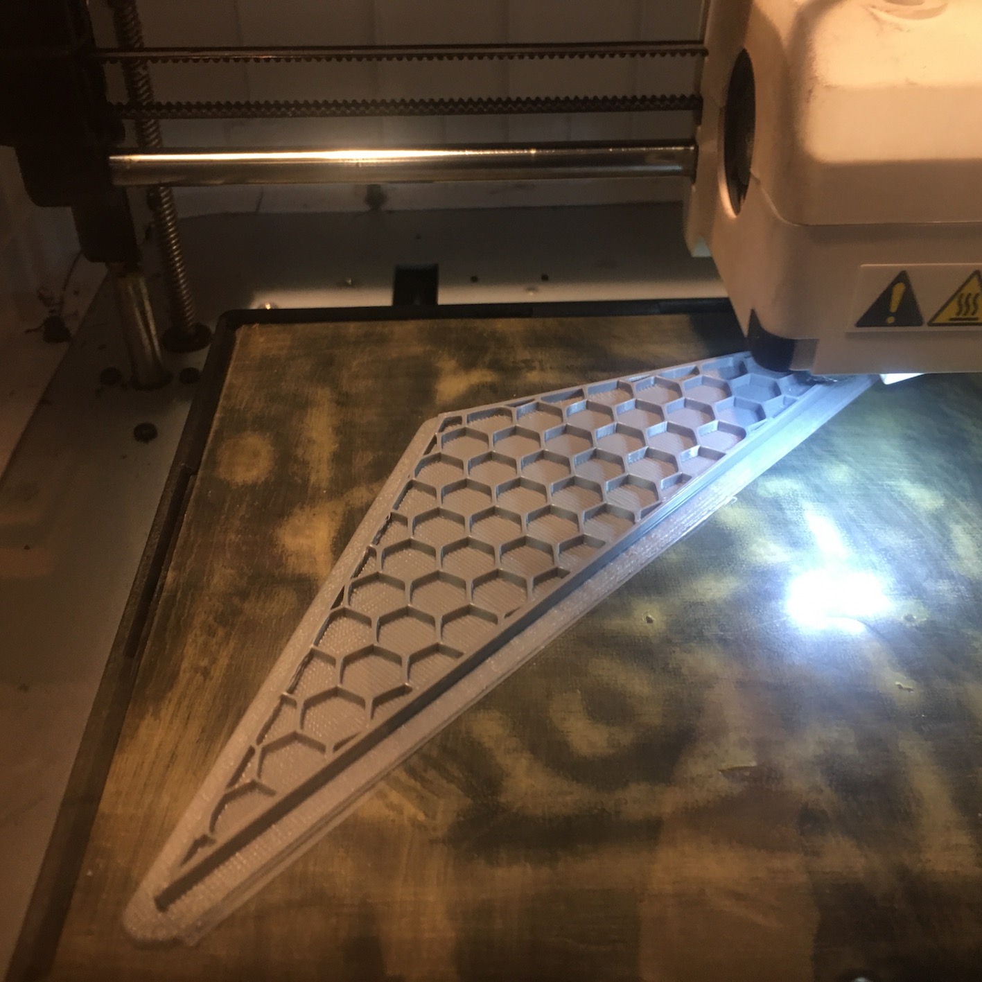

I have been printing the the sides and ends of the building. So far 3 side panels, and all 6 end panels have been printed. Just to show toy how much of these pieces are air - look at this:
That honeycomb is very open 10% infil - so I am not actually using that much filament. You cant do that with sheet material!
The biggest difficulty is minimising distortion as it cools and then while I glue the bits together - flat on a table and using clamps to hold everything down.

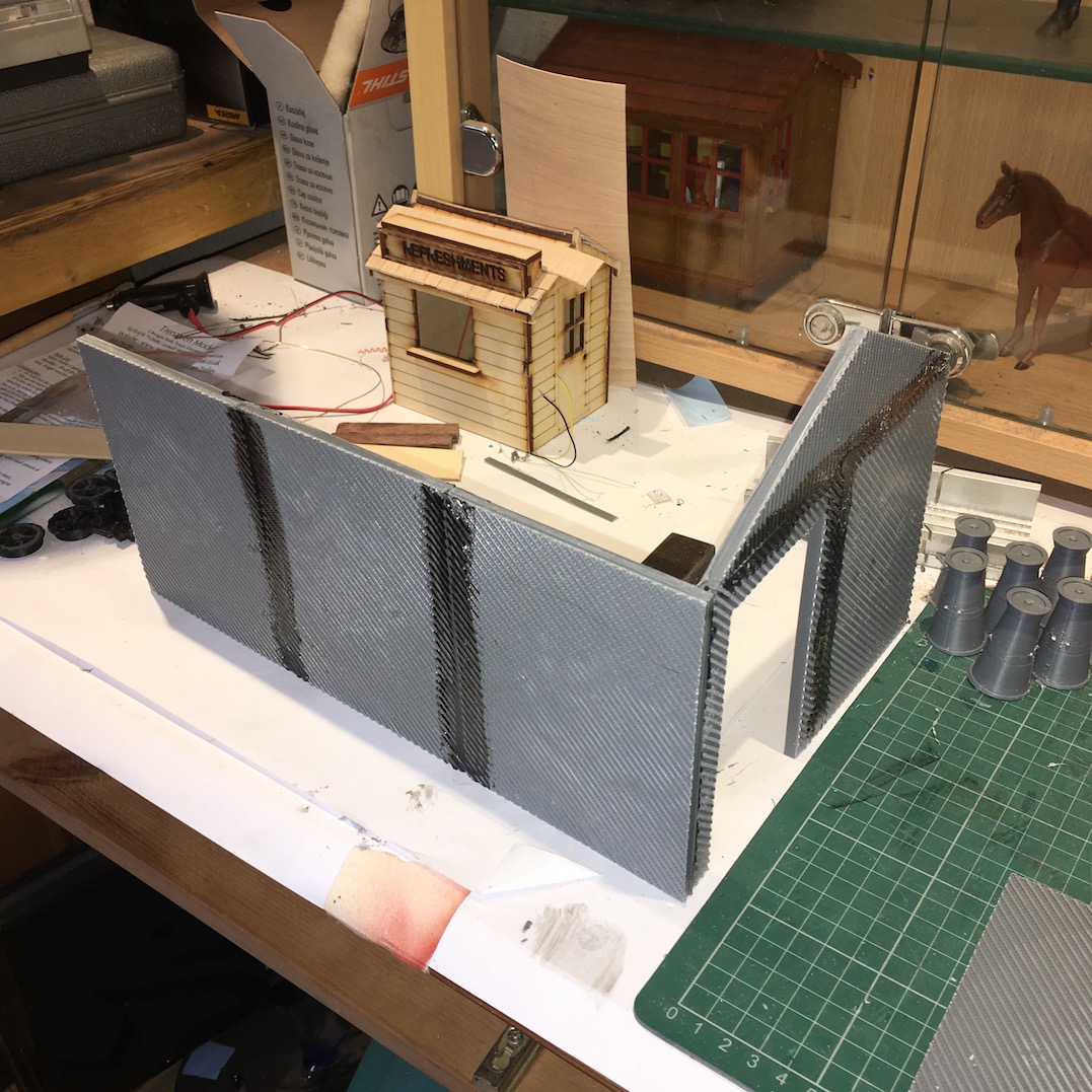

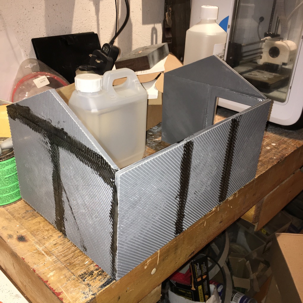

Re: 3 D Printing 16mm models
I now have all the components for the walls printed. Interestingly about Β£9 worth of filament and 36 hours printing time. So I think it would be difficult to make it from anything else at a lower cost. While this has been printing I have been working on the live steam Garratt (as you might already have seen) so the printing time isn't really relevant - not at 150 watts anyway.
To try to keep the wall flat when I bonded it together I used clamps:
And I now have two ends connected to one side:
There is some distortion in the building at the moment. I have probably been taking the prints off the bed before they have properly cooled. I think that can be corrected tomorrow when the final side is added.
