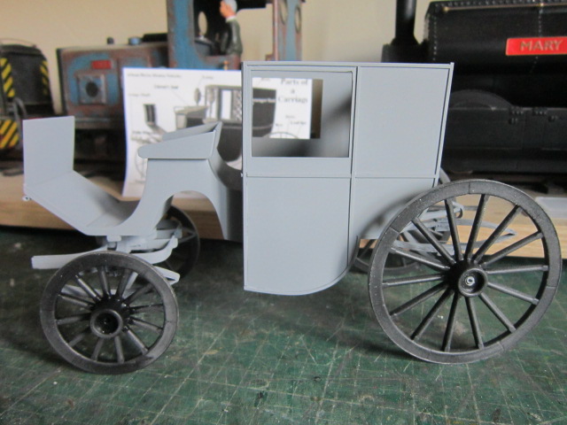

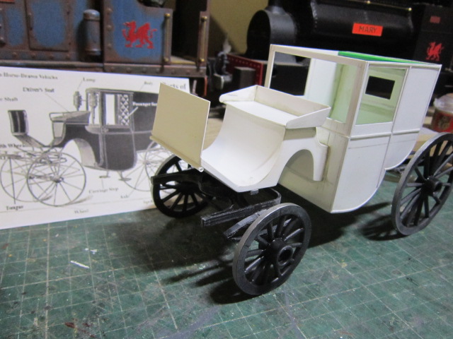

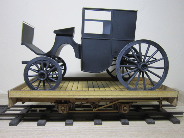

Somewhere in this thread I was talking about my latest build. Just to remind you, it is a Brougham carriage which will be mounted on a flat wagon (suitable kit on order from Jerry Irwin) and placed behind my horsebox.
Previously I showed it in basic construction but it has moved on, now having beading on the passenger panels, rear springs and axle fitted and wheels temporarily placed for photographic purposes......
I'm hoping tomorrow will be warm enough in the shed to allow me to spray the first primer coat.

That's coming on well Peter.
How did you do the beading around the curved bottom edges? I always find it difficult to get it to sit actually at the edge rather than slightly over or under.

The beading is Slater's .20 x .40 Microstrip which I carefully pull through my fingers at an angle so a curve is established before I apply it. I fix one end and allow it to set enough to hold before moving along its length, following the curve as I go.

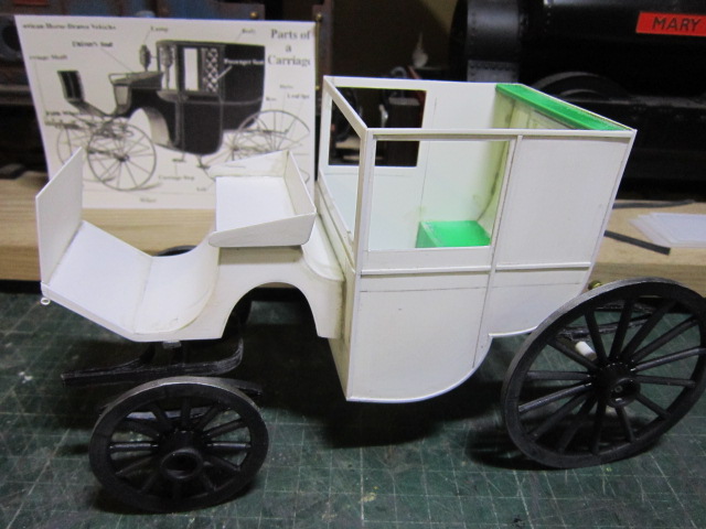

First coat of paint this morning. Plastic primer in two light coats, done in my shed and brought into the house to dry after about 20 minutes. No hurry this time as the temperature was OK .......

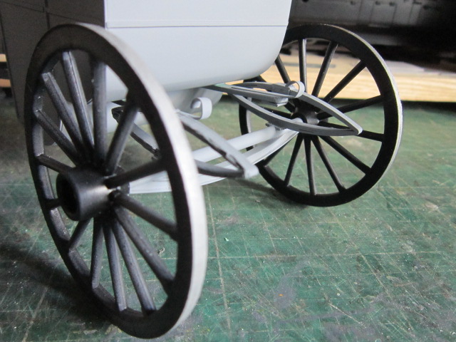

Are those curlicues above the springs made of metal or plastic? They look just right however you've formed them.

ge_rik wrote: Thu Feb 18, 2021 12:27 pm Are those curlicues above the springs made of metal or plastic? They look just right however you've formed them.
Well spotted Rik, they are so small and insignificant but I think important detail to include. Thin brass bar was used, twisted round small pointy-nose pliers (an engineering term!).

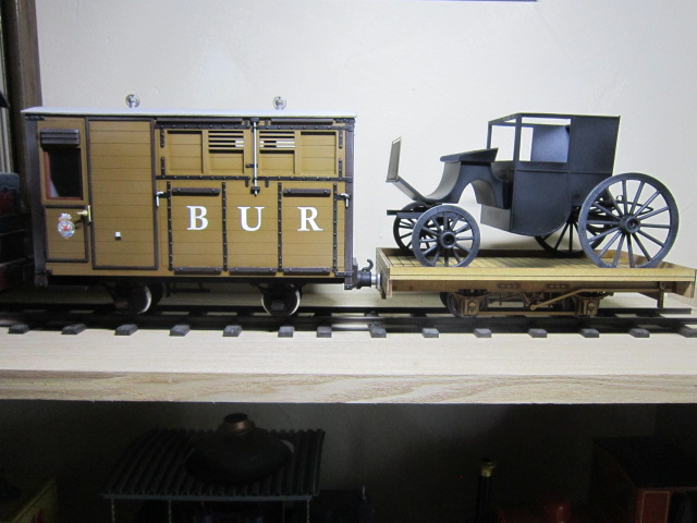

I had planned to scratch-build a flat wagon to carry the Brougham but, on reflection, I decided to ask Jerry Irwin whether he had anything suitable in his range. He did, although too short and narrow for the carriage to sit on. Never fear, Jerry to the rescue again with a redesigned deck to my dimensions and it is just right.....
Alongside the horsebox it is a perfect match.....
The kit arrived this morning and will be painted tomorrow, can't wait!

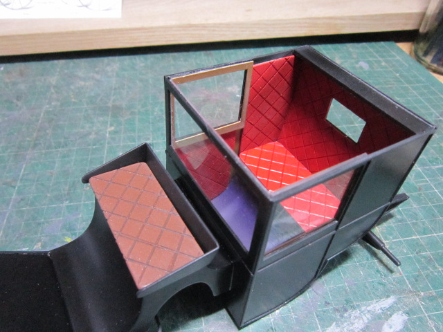

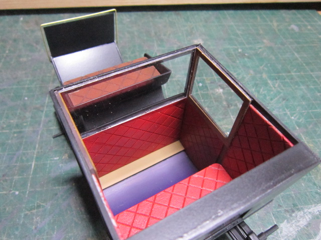

The carriage wagon is now being painted, although not finished yet. Meanwhile the interior upholstery has been installed, padded (effect) on the side walls and seat, and leather coloured seat for the coachman....
The glazing has also been fitted using canopy adhesive, which dries clear and leaves no marks.
Currently the roof section is being painted and will be permanently stuck when finished.

Very plush, Peter.
