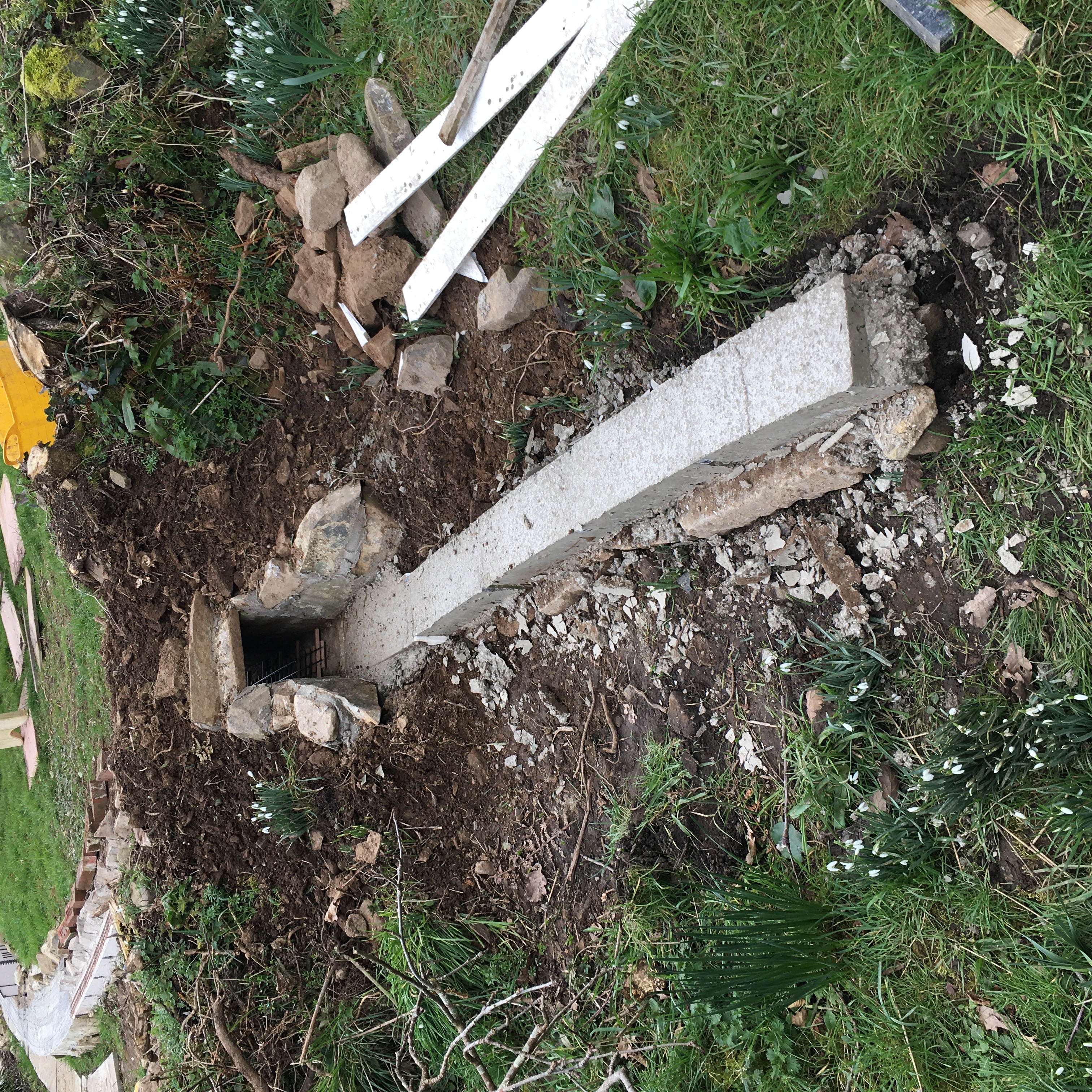

I managed to start to recover the tunnel before it got wet, and to select some rocks from the pile to start the cuttings leading to the down hill end of the tunnel:

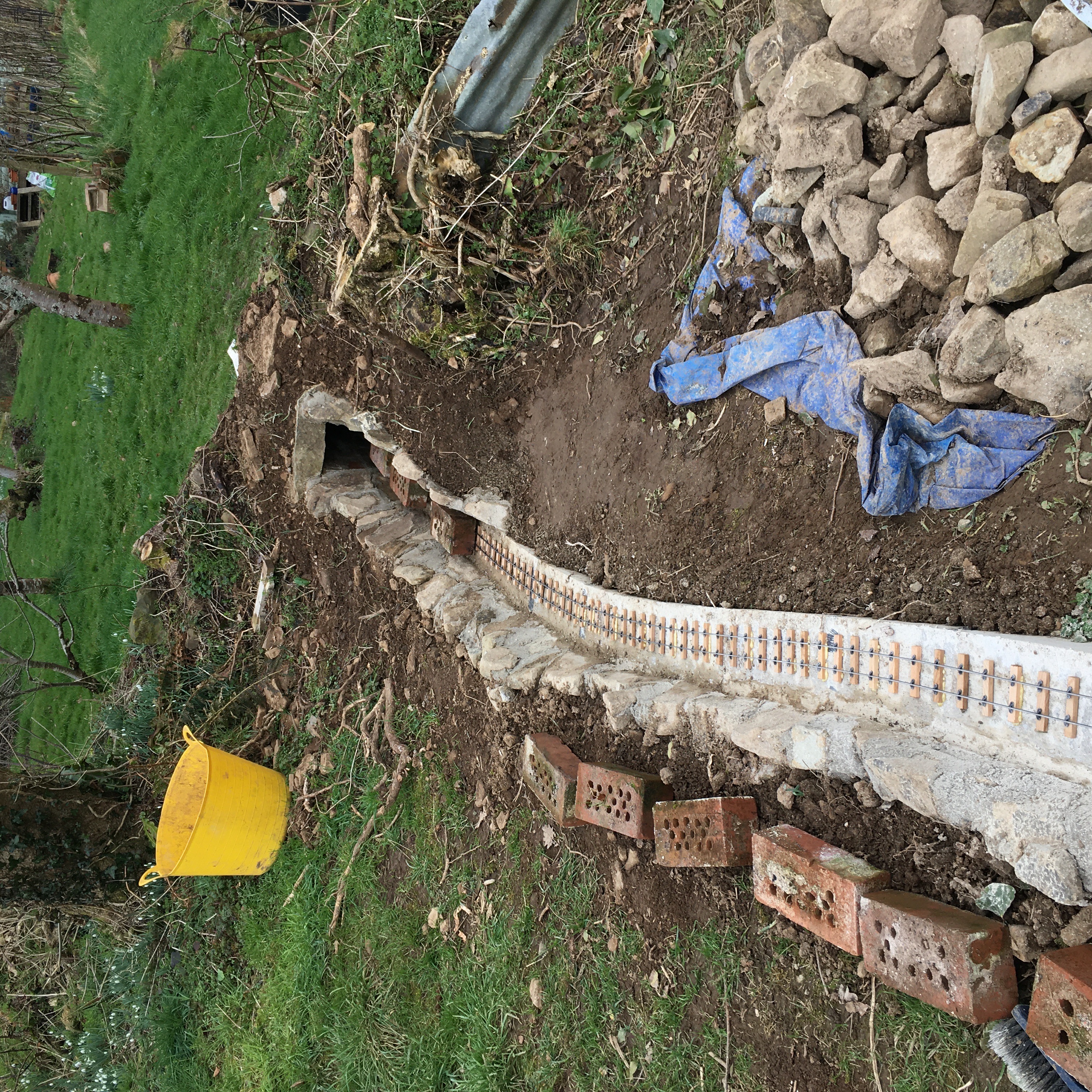

The track is now laid into the tunnel:
and ready to extend out of the tunnel:
The next section will involve concrete steps, and stainless angle laid into the concrete steps again - just like those crossings further down the line. As a technique it has been quite successful. Sturdy enough to take wheelbarrows, reliable and no bridge to obstruct the passage. As a detail I have added some long sleepers to the length of track which goes in the tunnel:

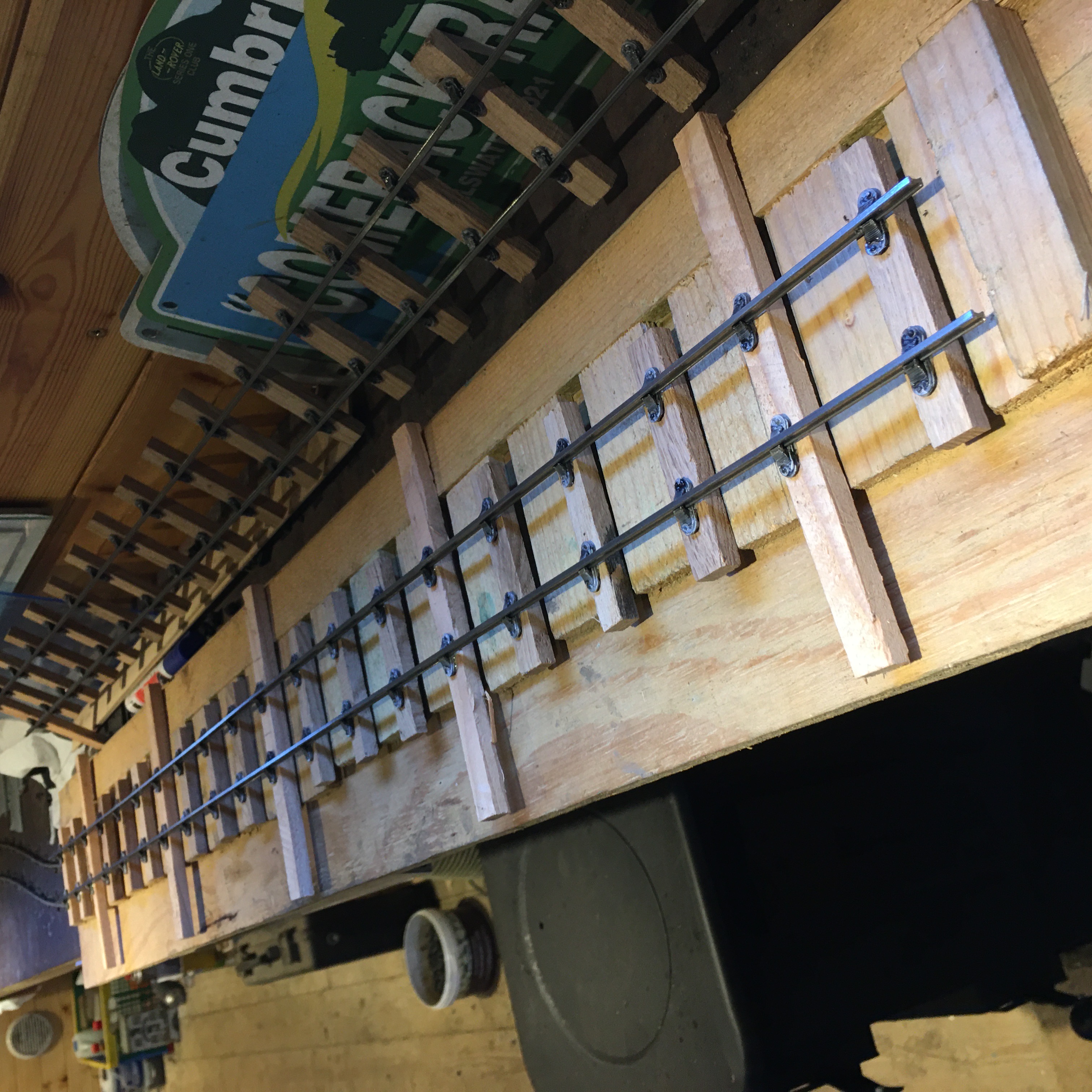

Every 4th sleeper is long enough to almost touch each side inside the tunnel. This is how it looks when laid:
The idea is that that track in the tunnel is not held in place or ballasted - it is just sitting there - and the long sleepers are to keep it sitting in the middle of the tunnel - rather than creep to one side. I am hoping that will be sufficient to hold it in place.

I would have thought a little ballast would not be a bad thing?
Though I suppose it could hold moisture?
Just thinking it might 'lift' when the rest of the track gets hot. It would then drop, when a loco passes over, but probably lift with just stock. Might this cause uncoupling?

You may well be correct. I just want to avoid problems with the ballast getting into the flange way. If it doesn't work I will have to think again.
The last set of track I ballasted has quite a few places where the flanges ride on the ballast and not the rail, and I need to clean that out when its a bit warmer. I want to avoid having that problem in the tunnel.
