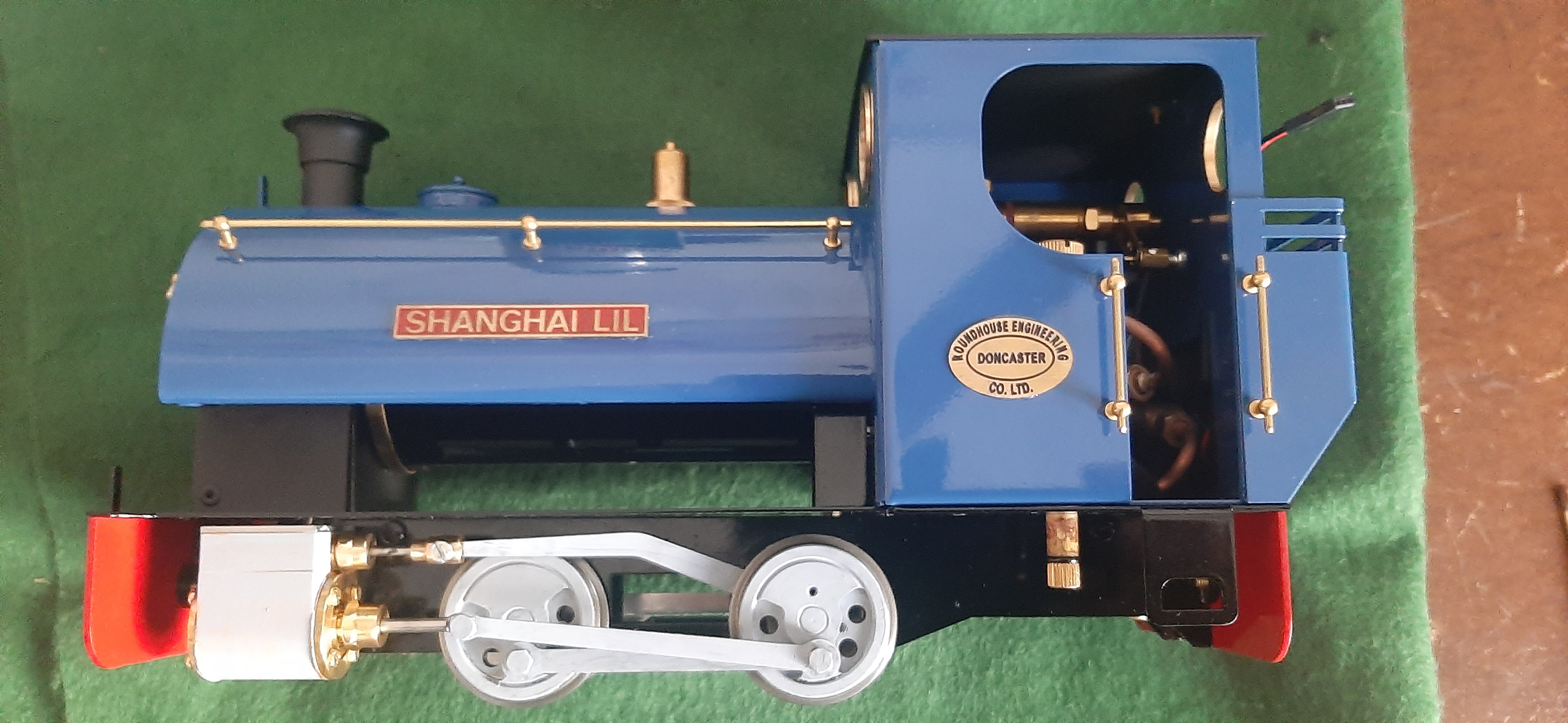

With the slight drop in temperature I bit the bullet and made a start on doing the paint job on my loco .
I prepared the surfaces to be painted using cotton buds soaked in IPA (Rubbing alcohol) to degrease the wheels ,cylinder blocks and motion rods.
I have just applied the etch primer to the surfaces using a paint brush . It says the primer can be painted over in 2 hours ,but I will leave it overnight in order for me to regain my composure! It was quite daunting slapping primer onto a new Roundhouse loco !

Thanks Aaron for your knowledgeable input and reference to cylinder block temperature.
Once I was happy with the primer I painted the wheels and cylinders with black engine block paint. It was a much harder job to do compared with applying the primer. I decided to ditch painting the motion rods with the red engine block paint and went for normal Humbrol satin enamel.It should be fine as the rods won't get as hot .
I have placed tool boxes towards the cab end of the loco as Roundhouse advised not to locate them near the smoke box as they might melt as they are white metal castings. Just waiting for the paintwork to cure before I can give it a run.

Posted: Fri Jul 24, 2026 2:48 pm
Very nice Chris, huge improvement!
Re: The Preseli Mountain Railway.
Posted: Fri Jul 24, 2026 4:10 pm
That is very nice Chris. I must say I was a bit dubious about that blue colour but now its finished the colour scheme really suits it. Well done.
