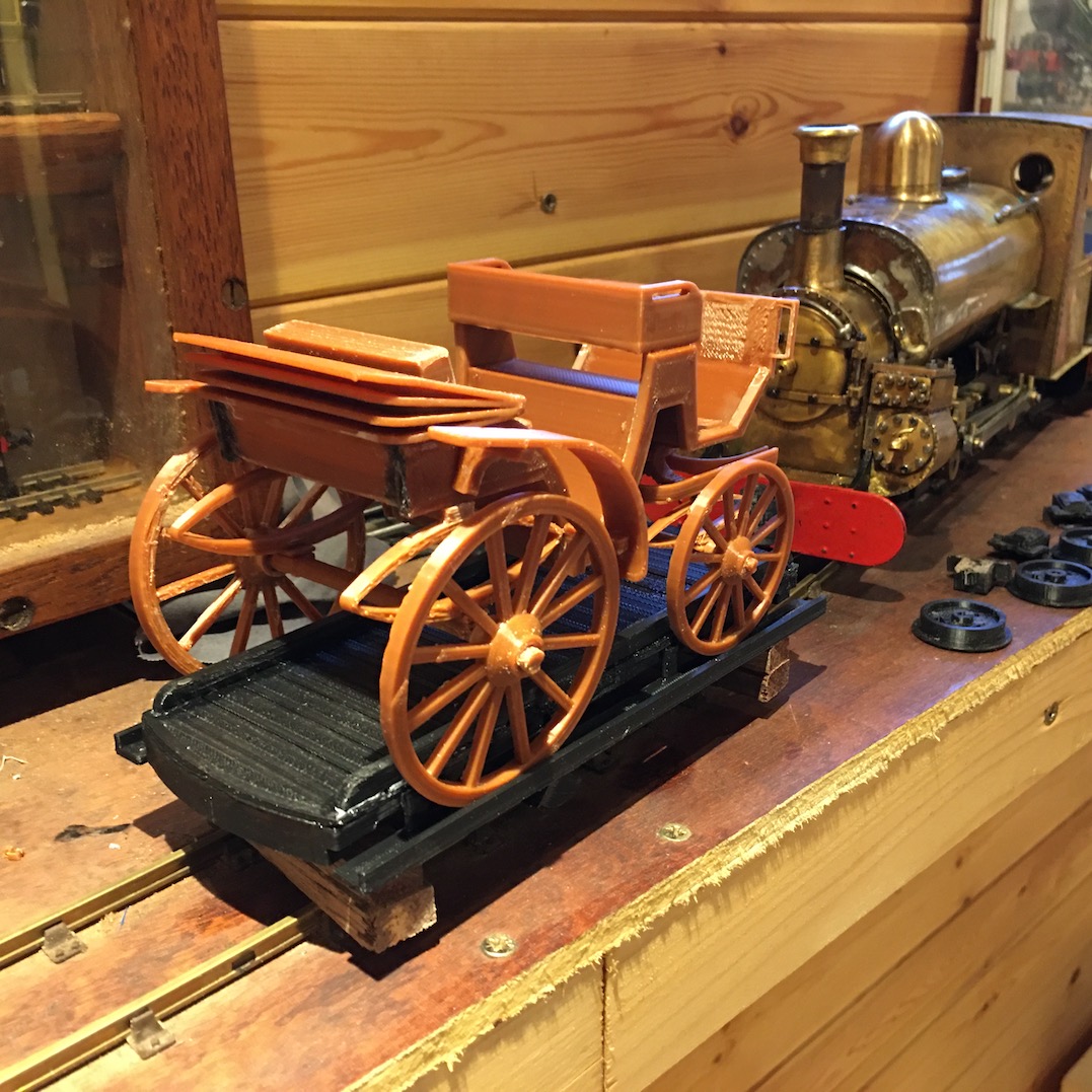

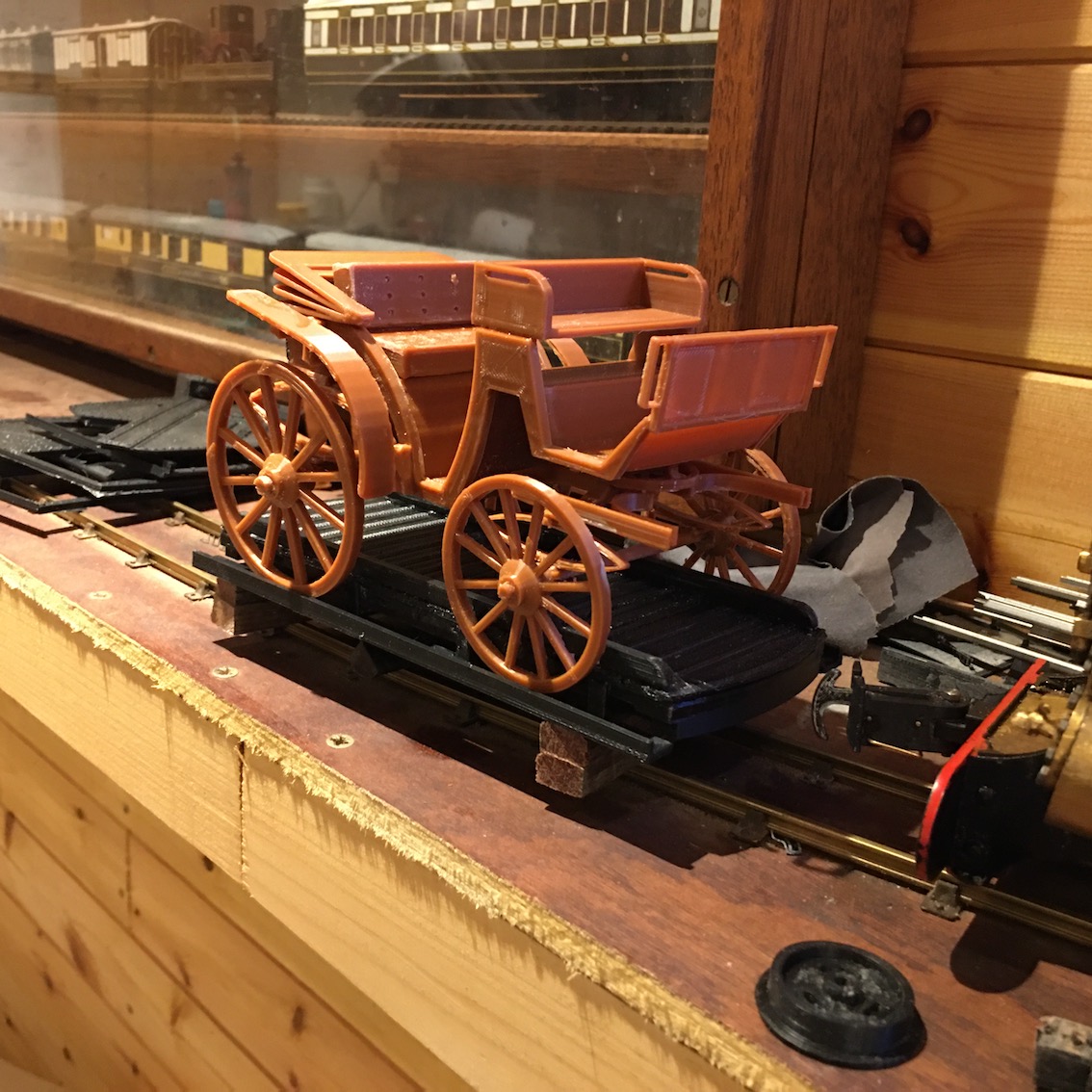

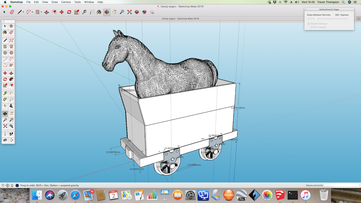

Let me provide an update on progress with a couple of things. Firstly the station building which is now finished:
and secondly the phaeton and carriage wagon:
I have finished all of the printing for the wagon, and I'm in the process of making stainless axles so I can add the wheels and axle boxes, which you can see in the first photo.
Lastly I am drawing up the Dandy wagon. It is interesting to see how a horse actually fits inside it!

That sandy wagon does look top-heavy! That horse is to scale and its 14 hands - which isn't that big a horse. Perhaps they used ponies to pull the slate wagons?

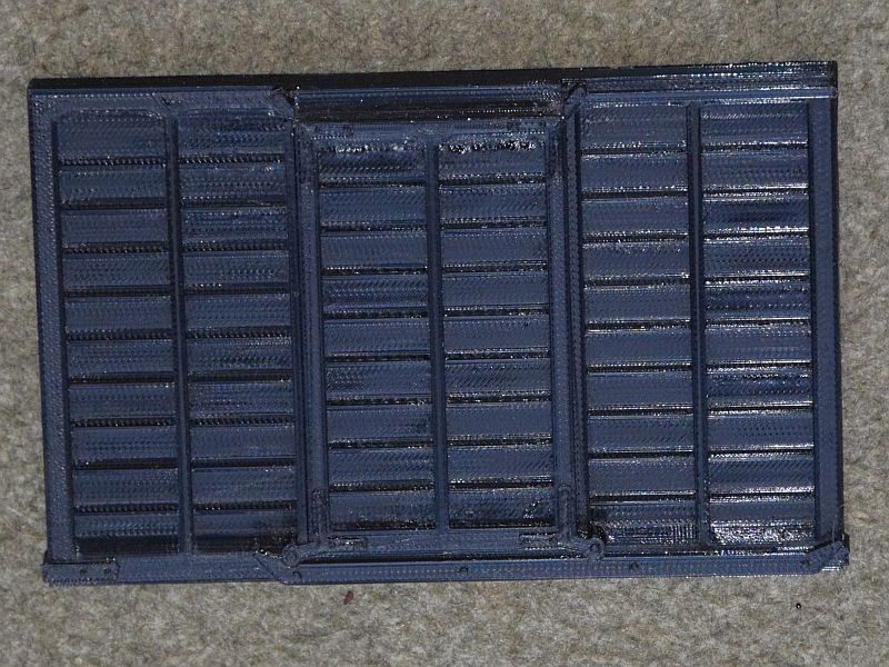

- Posts: 6028
Re: 3 D Printing 16mm models
Just out of interest I left a side printing overnight, using your stl and 0.1 layer height and this is the result this morning: ( I used black because that was the tag end of a reel that was already on the machine and I want to use it up)
Clearly not as good quality as yours but I don't know how much of that is due to slicer settings and how much is inherant difference between printers. I suspect a bit of both.
