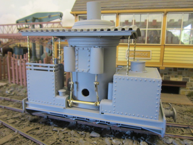

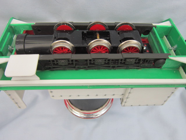

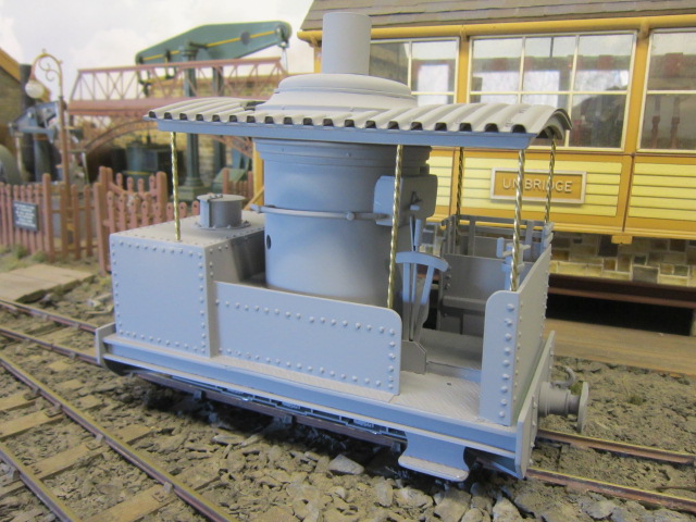

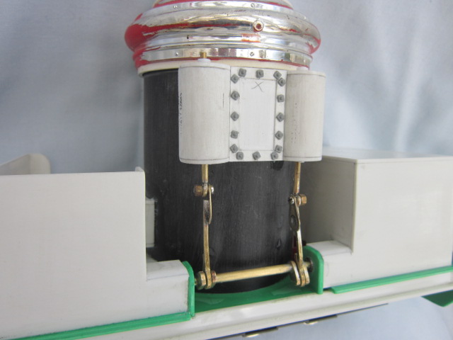

I have to admit it took a little longer and there are some pictures of the loco under construction....

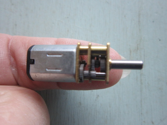

The pistons are attached to the crank-shaft, made from brass rod etc, and driven by a tiny motor with reduction gearbox.....
This will be powered, along with the chassis motor, through a Rx65C receiver giving proportional rotational speed with movement of the loco.

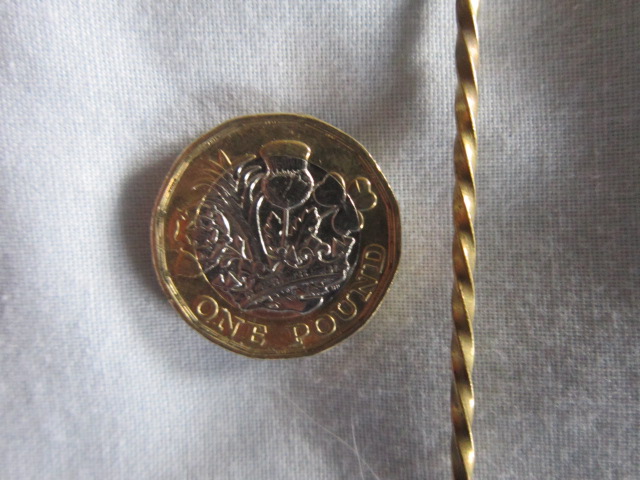

To add interest I have made twisted roof supports from square section brass bar, similar to that used on Showmans engines.....
I have no idea who Ted Polet is but have him to thank for inspiring me to build this loco.

Blimey! I blinked and in that time another masterpiece appeared.
Great looking interpretation of a fascinating prototype, Peter. I was wondering how you might animate the motion, and then I scrolled down further.
PS Was the curlycane effect achieved with a vice and a pair of mole grips or something more sophisticated?
Post by FWLR » Fri Feb 15, 2019 8:56 am
Hi Rik,
The easiest way to turn brass bar like Peter has done is.
Place one end of the bar in a vice, the other in a drill, (most drills now have a slow start) then start very slowly and keep it steady. It's surprising how easy it is....
Posts: 5688
Post by Peter Butler » Fri Feb 15, 2019 9:04 am
Rik and Rod...... the brass was turned as you both describe by securing one end in a vice and turning the other, however, I did each short section individually so used mole grips. I imagine longer lengths would be easier using a slow speed drill.
