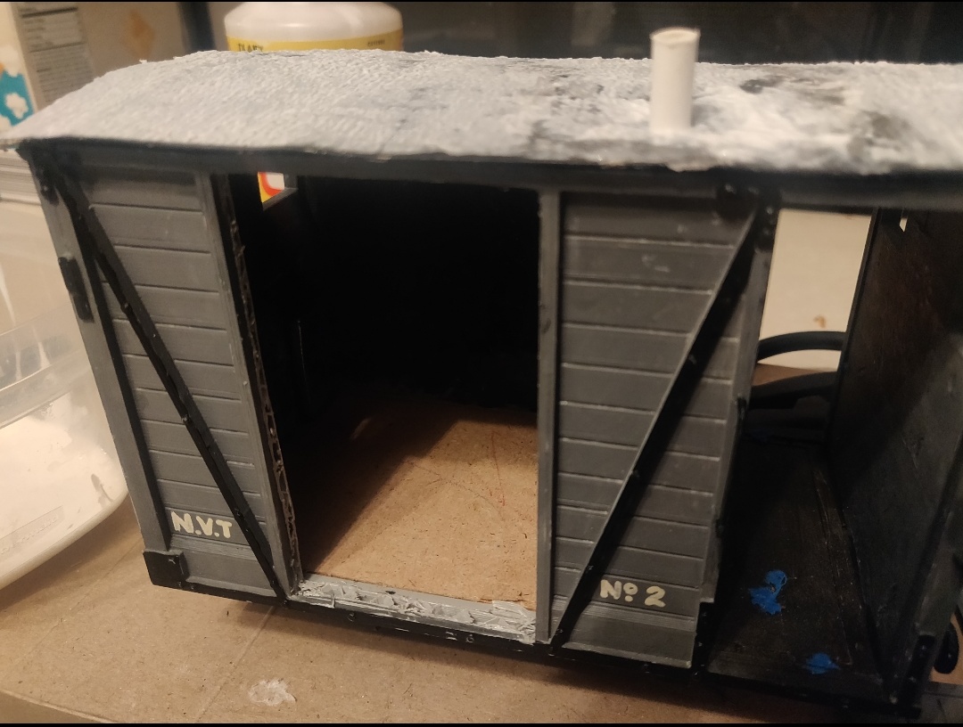

Thanks Rod, I appreciate the comment. You reminded me how much fun I had figuring out that door, so I decided to start adding a door to another piece of stock tonight:
The one thing that had been bugging me about my GVT brake van was that I had left the roof loose for interior access, which often allowed the roof to fall off or blow off in any amount of wind. I thought about fixing magnets on the roof and supports, which might have been the sensible thing to do, but eventually decided to glue the roof on and cut out the door on one side. I'm now working on modifying Rik's 3d models to separate the doors from the wall and add some kind of sliding mechanism to allow them to open and close. If I get anywhere on that I'll share it in the 3d models section, with proper attribution of course.
I also added a stovepipe while I was in there, and I suppose now that the doors open I'll need a stove and brakewheel as well! I'm still learning what a brakevan needs, but for the most part it seems to serve similar functions to a caboose. (Braking power/maintain coupler tension, crew rest, mobile office, shove platform/monitor train in motion, sometimes a bit of cargo?)

drewzero1 wrote: Wed Feb 12, 2025 8:50 am
Removable roof fixing always seems to be an issue. I have some held on by screws (because of a tendency to warp otherwise) but generally I try to make them a push fit, with a framework beneath to 'slot' into the van or carriage relying on friction to hold. If you can achieve a tight fit it will generally stay in place, but it's worth remembering not to try and pick them up by grasping the sides of the roof!
I think your summation of a brake van is pretty much correct - just a low end caboose! I think the Ffestiniog is the only British railway to have used a high viewing point though. And not as cosy as most caboose appear to be.

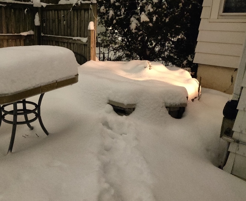

I had been hoping to sneak a bridge into a low spot on the NVT to take a photo for the quarterly contest, but I think we might need a really big bridge to get over all this snow!
There's a railway in there somewhere. After a week it's melted enough to see the top of the station and water tank, but that's about it!

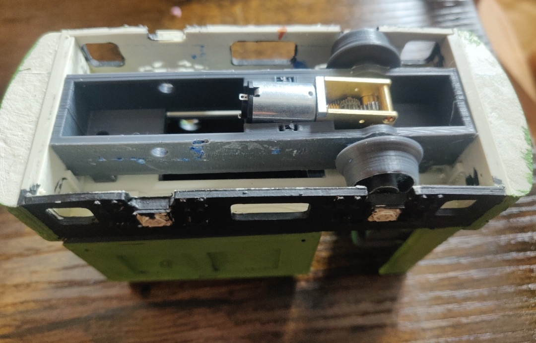

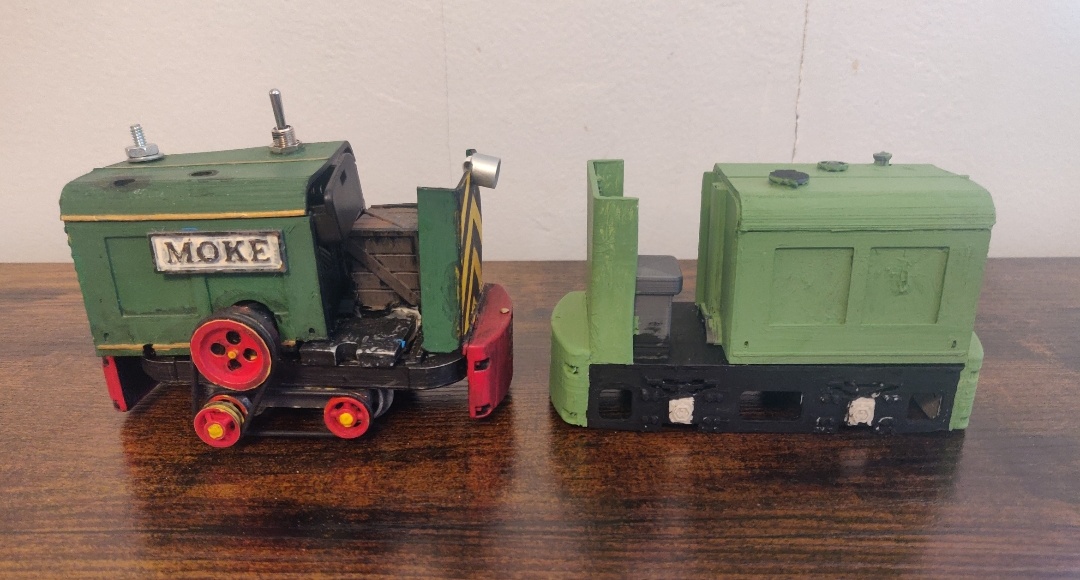

So while I wait for the big melt I've been working on a tough little critter for the kids. The little diesel 'Moke' used a hood and cab as pieces from a full kit, and the shell has never quite fit right over the relatively large salvaged motor and gearbox. I decided it was time for a twin that followed the full design as a unit. (Rod, I think I spotted one of these on your railway as well?)
Never content to leave a kit unmodified, I designed a simple two-wheel-drive chassis around an N20 motor with dual shaft gearbox, which should hold up better to kid hands than my hodgepodge belt system. The standard size should allow swapping the drive unit if I end up wanting to use a different voltage or gear ratio. There's probably just enough room in there for a belt or chain to convert it to 4WD eventually.
Since taking this picture I have switched to larger 20mm (less flanges) wheels, added traction tires to the drive wheels, and reversed the chassis to put the drive wheels under the hood (where the weights are). All it needs now is a battery that fits under the hood, and a switch to make it go. In testing with a 2S battery it is slower than Moke but can pull a bit harder thanks to the weights and tires.
