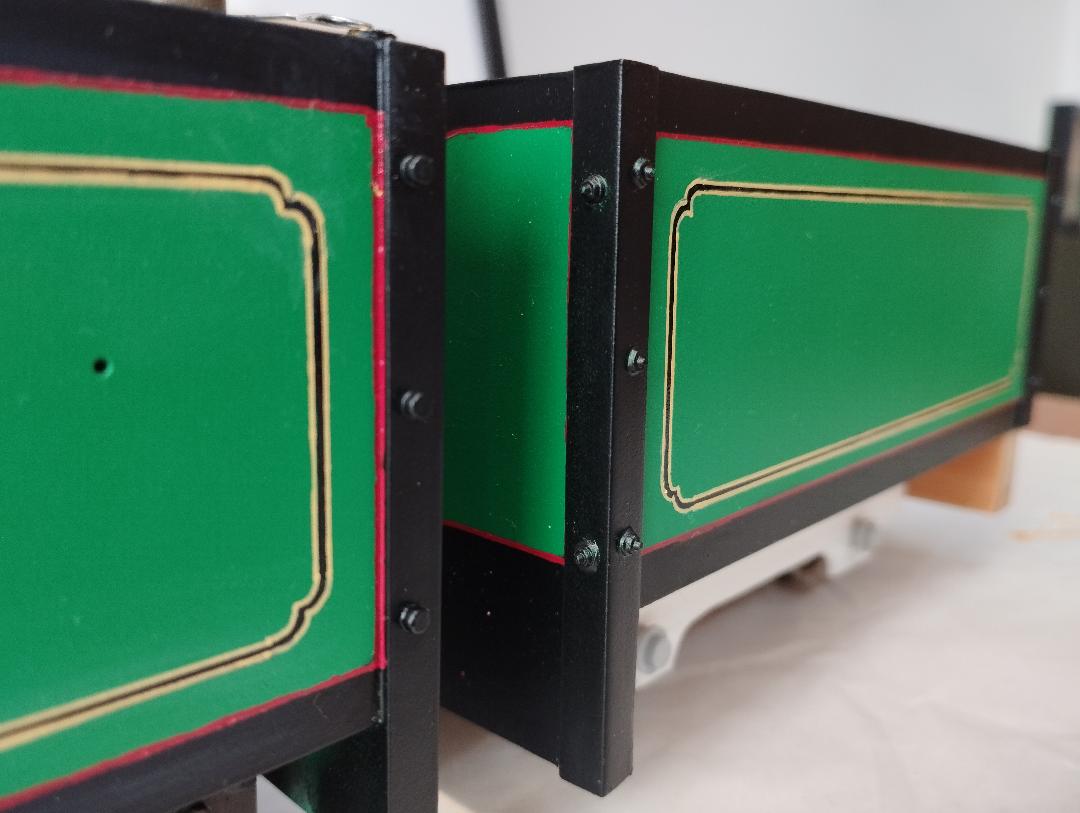

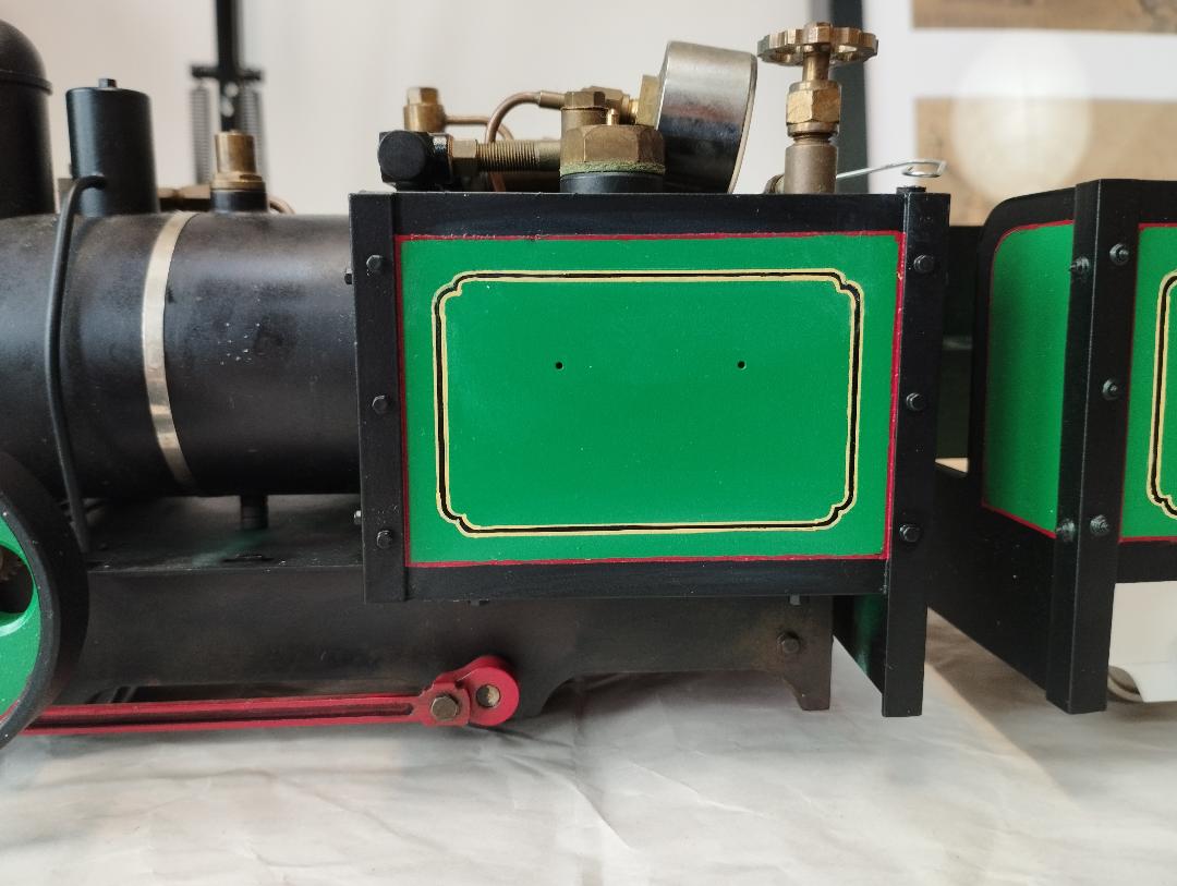

Hello again!
The Regner project made a decent step forward over the Christmas Holidays with the completion (well, nearly) of the lining:
It doesn't bear close inspection, but (to my eye anyway!) it looks very acceptable from a usual viewing distance - and it didn't cost hundreds of pounds!
The inner lining (indeed the whole livery) was inspired by "Earl of Merioneth", but with the more ornate corners that feature on the England locos, as a practice run for lining "Palmerston". All of the panels are the same height, so I made a stencil for each end of the black line, used that at each end, then connected the two with horizontal lines. That went OK, but the template wasn't quite as accurate as I'd have liked, so some of those horizontal lines aren't, if you see what I mean - I'll make full templates for each panel on Palmerston.
The cream lines were added after, with the corners done freehand - a LOT of wiping off was involved, but I got the hang of it eventually!
The next task is to finish the tender, paint the underframe and add detail, but there's no hurry because I can't finish it until it's warm and dry enough to spray paint outside again - I hope to have it ready to pull the first passenger train of the season though...
PS I haven't forgotten I said I do a lining video - I'll give it a go over the coming weeks...

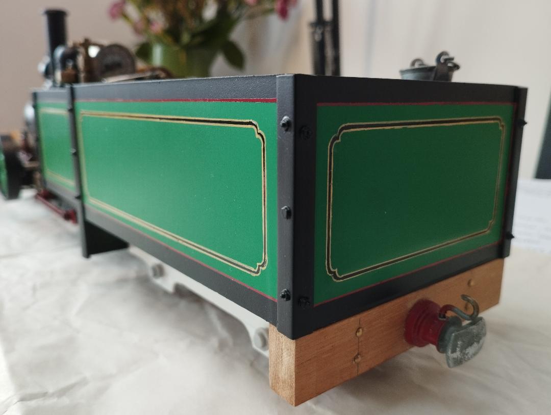

Evening all,
This project rumbles on slowly - as I type this the varnish is drying on the loco and tender, which are sitting in front of me on the kitchen table.
Here's the tender a few days ago, with the painting completed, a proper coal space added (a late addition, I was just planning to have coal against the water tank), plus seats and floorboards:
After the varnish has properly hardened I'll add some weathering, a few additional details, couple up the tender and hope the bloomin' thing runs nicely!
