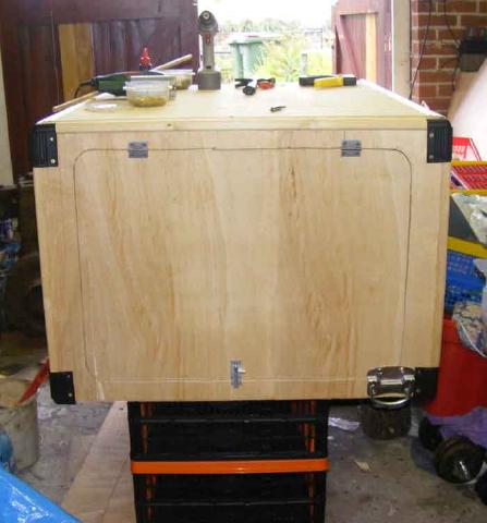

Today has seen the last of the joinery done on the "box" which will eventually (by 20th October!) become Flagg Fluorspar.
Pictures at the bottom of:
http://www.mdlr.co.uk/ff02.html
Also, last week a Box of Delights arrived from Trenarren Models - lotsa detailing "bits" which are getting assembled and primed in between times.
As you can see, adding PA speaker corners and pine angle over all the joints has made the whole assembly much more presentable.
Next job: stain the exterior (and the interior of the flaps which will be open when trains are running) with a dark green garden furniture stain and paint the interior sky blue.

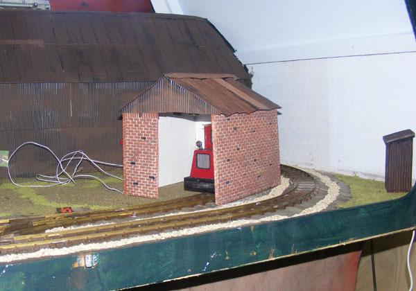

Any road up................. I've been making progress on the loco repair shop - the walls were from a sheet of AnDel Models brickwork: they've now been trimmed to size, glued together and painted.............

MDLR
Post by MDLR » Wed Dec 12, 2012 12:56 am
hussra:77828 wrote:Ooh, those look nice, will be interested to see what you make of these.
I'm making a loco repair shop! The roof framing will be made from coffee stirrers, covered with corrugated iron (in plastic).

MDLR
Post by MDLR » Wed Dec 12, 2012 11:46 am
Mr. Bond of the DVLR:77846 wrote:Could you go over how you painted the brick work please?
OK - the panel is cast in "mortar colour".
The first job is to paint the whole surface with brick colour - I've got a sample tin of masonry paint which is right. I kept the 1/2" paint brush almost parallel with the surface and "lost" much of the paint off the brush before starting, so I only painted the faces of the bricks and the paint didn't go into the mortar joints.
After that, I picked out the black bricks with acrylic and then washed over the whole lot with a very dilute black acrylic - the brick colour is very bright and "loud" until you tone it down with a wash.

MDLR
Post by MDLR » Fri Mar 29, 2013 11:09 pm
................ and here it is completed! It's only been plonked in position and will need a hole drilling in the baseboard for the wire for the lighting and properly "planting" with greenery to hide the gap.
