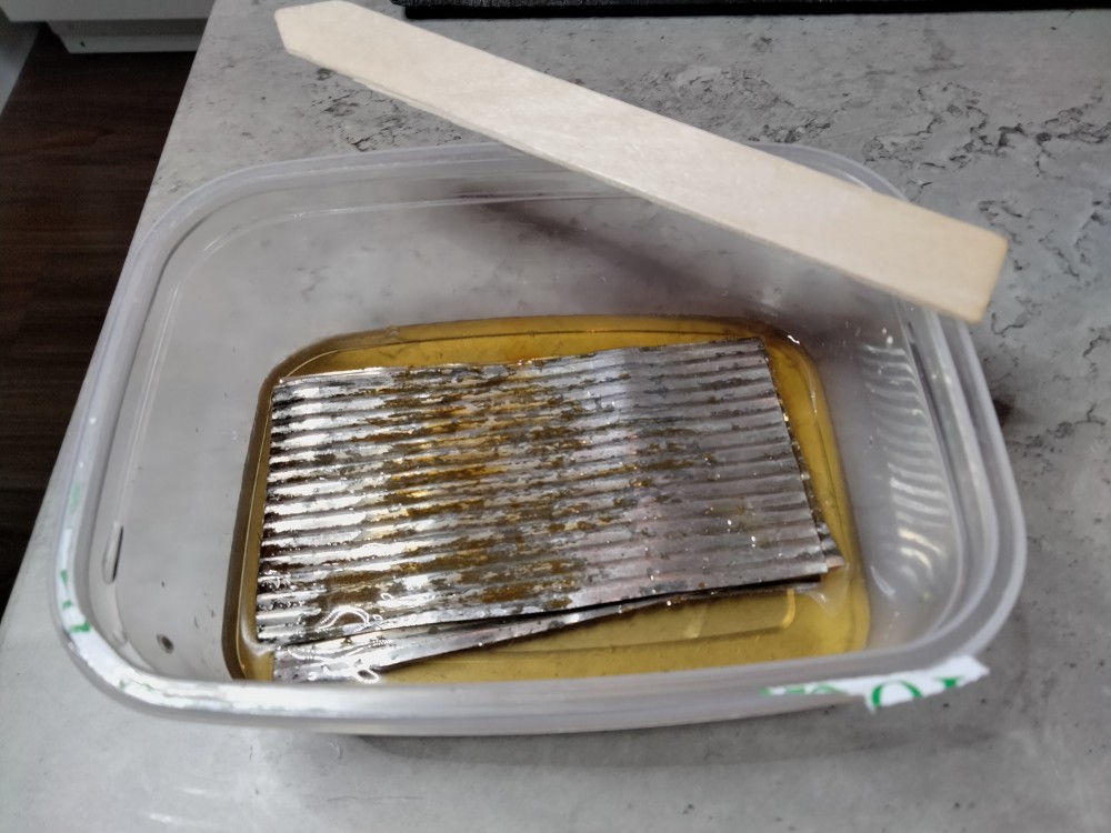

Continuing with low-cost and no-cost materials. I am doing the corrugated roof out of tincans (Heinz beans to be precise) :) Cut the cans up, straighten them somewhat under weight and now soaking them in a mixture of peroxide + white vinegar + salt. Just after 5 minutes the natural rust starts building up :idea:

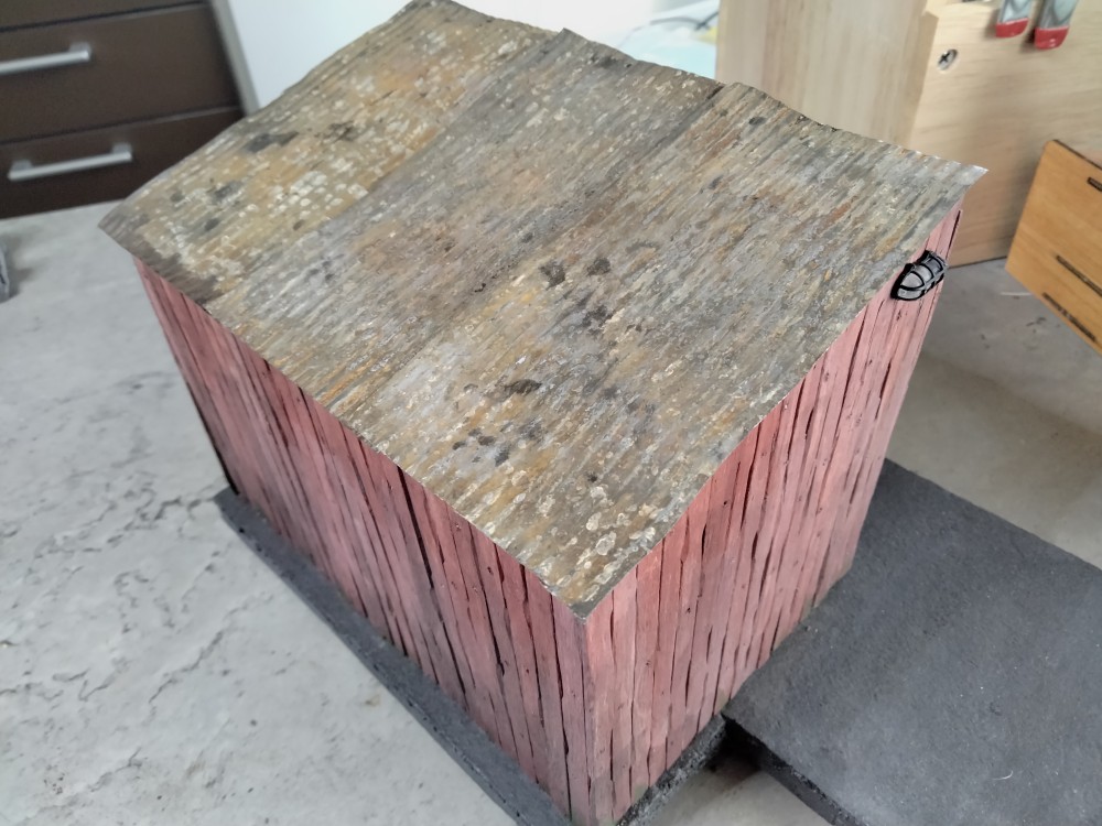

I think rust looks now good. There is no weathering done on the roof, only natural rust. It will probably looki even better with time outside 8)

The roof sheets really capture the natural weathering appearance of corrugated metal, very good.
Nice touch to have the outside light too, you really know how to look after your employees.

Love the tin can roof. It looks perfect. Also amazing how much that bulkhead light adds - one tiny detail that really switches you into seeing everything else in scale terms.

Now ready! Hopefully this will get some life when I start to build my small balcony layout :salute:
