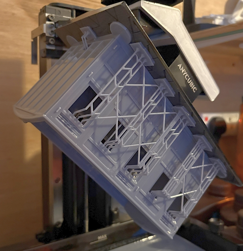

In the meantime, I did manage to put a sneaky print of the body of one of the All Thirds on over night and it is currently dripping:

Does the build plate tilt on your printer? I wish mine did, it would help catch the drips after printing.

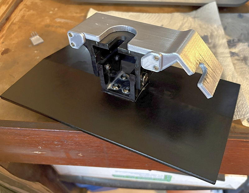

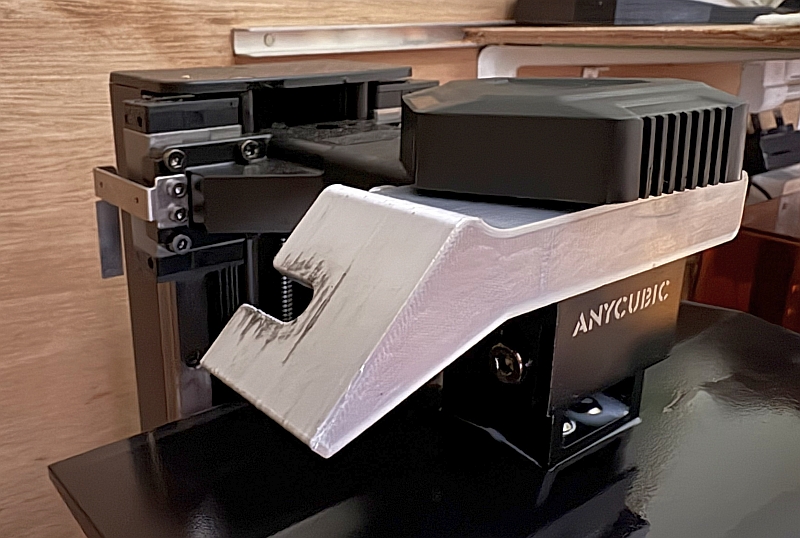

ge_rik wrote: Fri Mar 13, 2026 7:36 am Does the build plate tilt on your printer? I wish mine did, it would help catch the drips after printing.
No, not as such. The silvery coloured bit is a printed part which is clamped around the plate mount bracket and gives the angle.
So the pic below shows how it sits it is whilst printing. Once the print is finished, I simply loosen the big knurled knob, slide it forward and relocate it on to the slot in the angled bit. You can't really see but it is also slightly angled forward so that the resin runs to the bottom RH corner and improves the amount that drips. The stl for it came from Thingiverse. Just do a search for your machine and look for "drip bracket" or similar. you'll probably find there are half a dozen variants by different people and its just a case of looking until you find one you like. I think i printed a couple of others before I found this one.

Thanks. That looks handy.

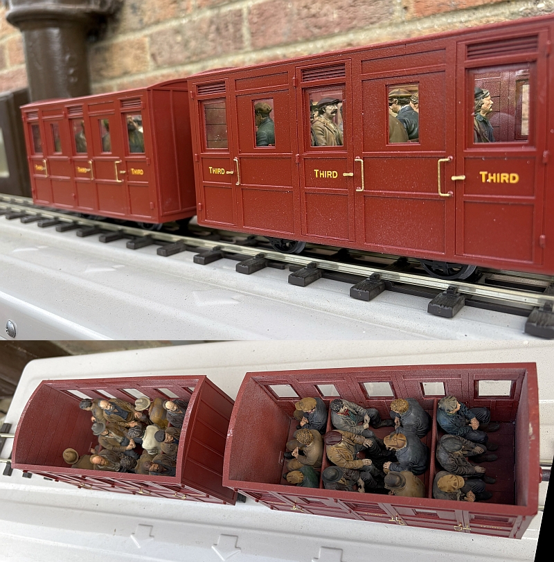

Ok, the world trundles on and some modelling has been squeezed in. The two All-3rd's are now virtually complete, just need the couplings attaching to their mountings and the buffer heads painting. I've assumed that a train that transports slate quarry workers would have a film of grey dust everywhere inside, not sure if I've quite achieved that but it won't be seen with the lid on anyway.

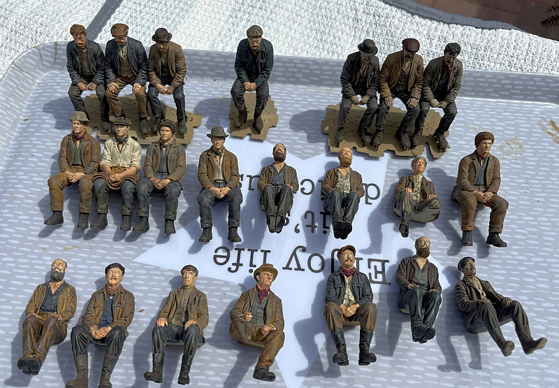

Also, there are a full load of passengers now printed. The first 4 are painted, as below, and only another 20 to go...! I promise to try to do a better job on those scary eyes next time! They still need a coat of matt varnish to even things out.

Rik, I think its more apprehension about being squashed into that coach for the rest of their lives!
As for my painting skills, that is all really down to Durley's excellent painting tutorial a few months ago. Just follow that and it all just happens. My only variations from his printed words are some slight variations in jacket colour, etc.

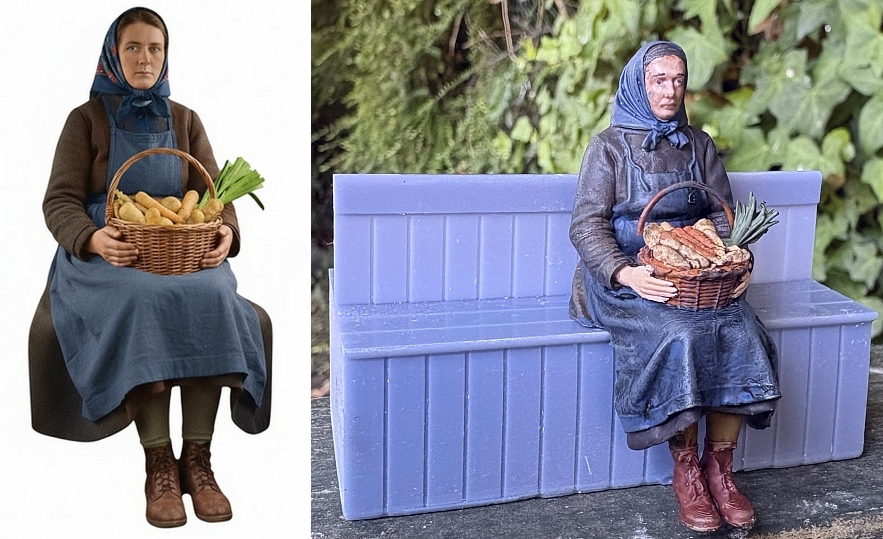

I did the 1st Class passengers for the Composite some months ago but apart from them and the loco crew, I've just made my first real attempt to vary from "workman" figures. I asked Gemini to create a quarryman's wife travelling by train with a basket of vegetables. That looked Ok so I asked for appropriate colours for the clothing. Then Meshy did me a 3d figure stl. An hour or so on the printer and I was all set to test my painting with no more than Durley's general guidelines and Gemini's colours to work from.
I'm not totally happy with outcome but it looks better in real life than in this photo.

Thanks Aaron. I tried the pin idea but didn't get anywhere, if there was enough paint on the pin to get it to stick to the eyeball, it flooded!
However, I now have a train load of quarrymen passengers. I was going somewhat crazy by the end so the detail is a bit iffy on some of them, but it won't be seen when in the coaches.
