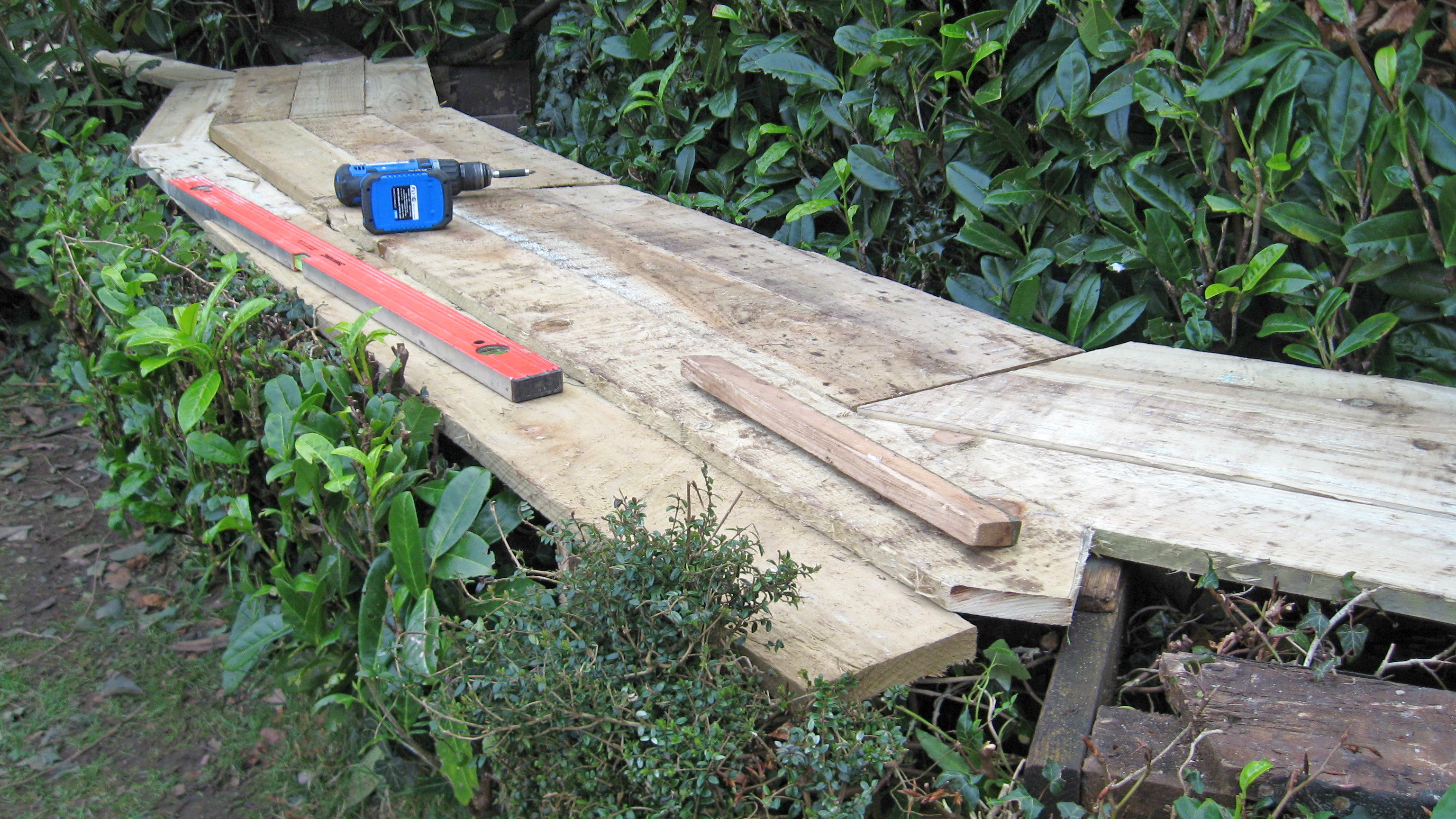

The treated 6"x1" boards for the baseboards have arrived. Just checking I've got enough and also allowing them to dry out before cutting, fixing and covering in felt (tar paper to our colonial readership).

Hopefully, should be able to start fixing them in place during the coming week - weather permitting.
I was surprised how water-logged the planks were. They are stored outside at the fencing supplier.

Rik,
If that is pine planking I suggest that you cut it and fix it in place while it is wet.
Down here we get treated pine that is classified as "wet cut" and if it is left out in the sun it will warp terribly.
I have had i length clamped down to a board to get it back into shape for 3 weeks.
For treated timber it is recommended that galvanised screws are used as a minimum, preferably using treated timber screws is the best.
Untreated screws will rust away in a short period of time (less than 5 years) in my experience.

Thanks Graeme
I've decided to use stainless steel screws all round. The old steel ones were, as you suggest, very rusted though I did manage to remove around 90% of them.
See below for the latest update.

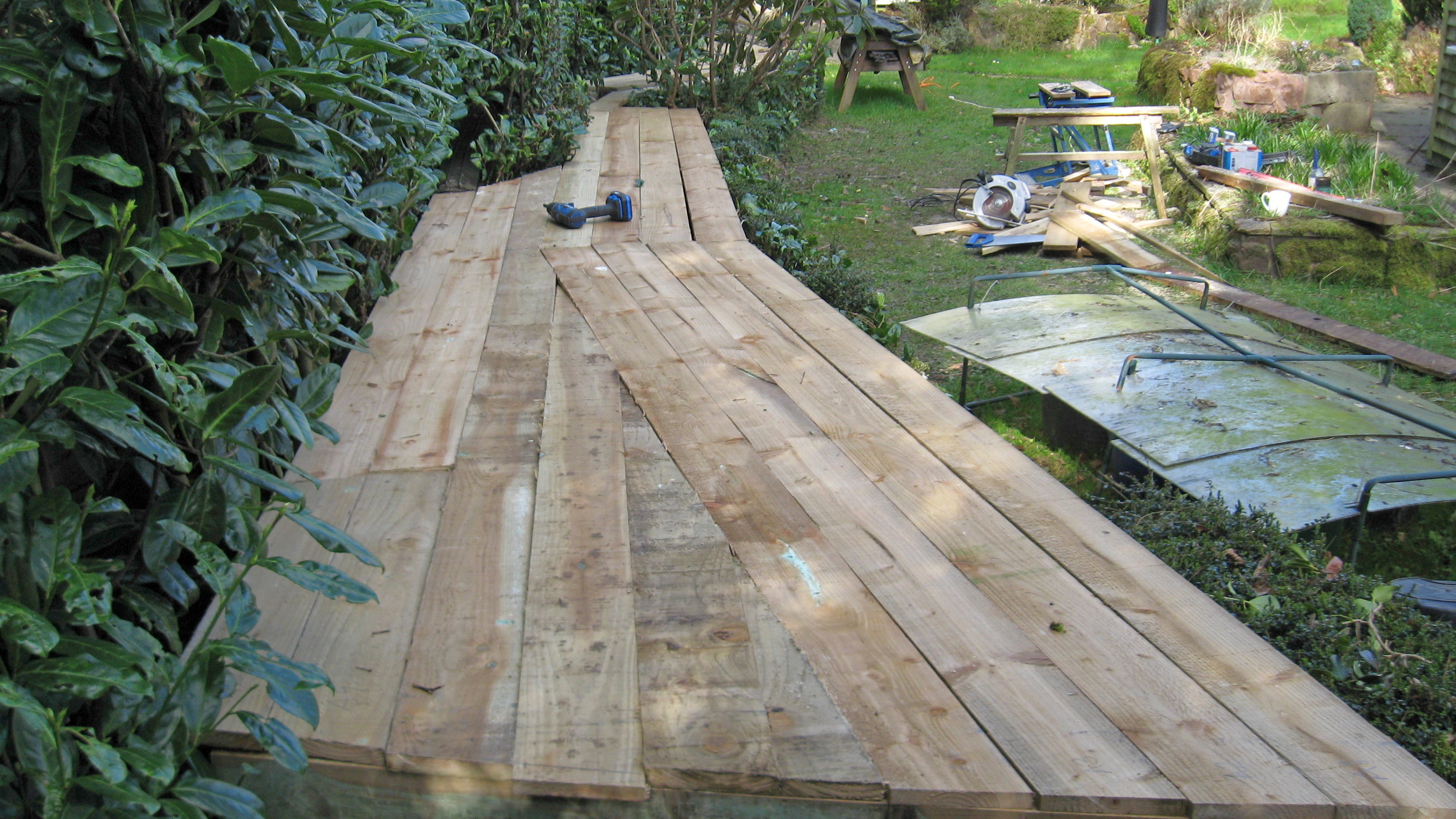

Latest progress
I've now cut all the boards and this afternoon will start fixing them into place.
The copper mine sidings will now be an inch above the main line in the foreground.
The station area at Beeston Market is now slightly wider in the middle section.
Once the boards are fixed into place, I'll cover them in good quality roofing felt (tar paper) and seal all joints with bituminous adhesive.

Always nice to see construction photos.
I use stainless steel screws on my railway.
Martin

Gone for the top shelf option well done.
I still wonder about using the tar paper, never used it but then again I use painted fibre cement sheeting for my bench work.

Sorry I've come in a bit late. You possibly already know that when you cut a treated pine board that the cut surface is left largely unprotected, but some readers may not know that.
Are you treating the cut ends with a wood preservative before fixing them down? If not the boards will rot from the ends and likely start to lift as they rot around the screws.
Paint on wood preservatives are available here in Oz in brush on and spray can forms and I would imagine that there is something equivalent available in the UK.

Hi Graeme
Yes. I spotted that the main areas of rot on the old baseboard were around the ends which had been cut - especially those which had been cut on the diagonal. I've been soaking every cut end in preservative - mostly twice, just to be sure.

ge_rik wrote: Wed Mar 12, 2025 7:25 am Yes. I spotted that the main areas of rot on the old baseboard were around the ends which had been cut -
I noticed that as well, which prompted the question. I don't think it would be possible to add too much wood preservative.

When I was doing a renovation I was told by my builder that for decking you should never paint underneath.
The reason is that way the wood can "breathe" evidently painting can trap water inside and can increase the speed of rot as the wood can't "season".

Posted: Tue Mar 18, 2025 8:14 am
by Old Man Aaron
Very good. :study: :thumbleft:
I quite like the stepped level for the copper mine. A detail rarely modelled and will set the yard apart.

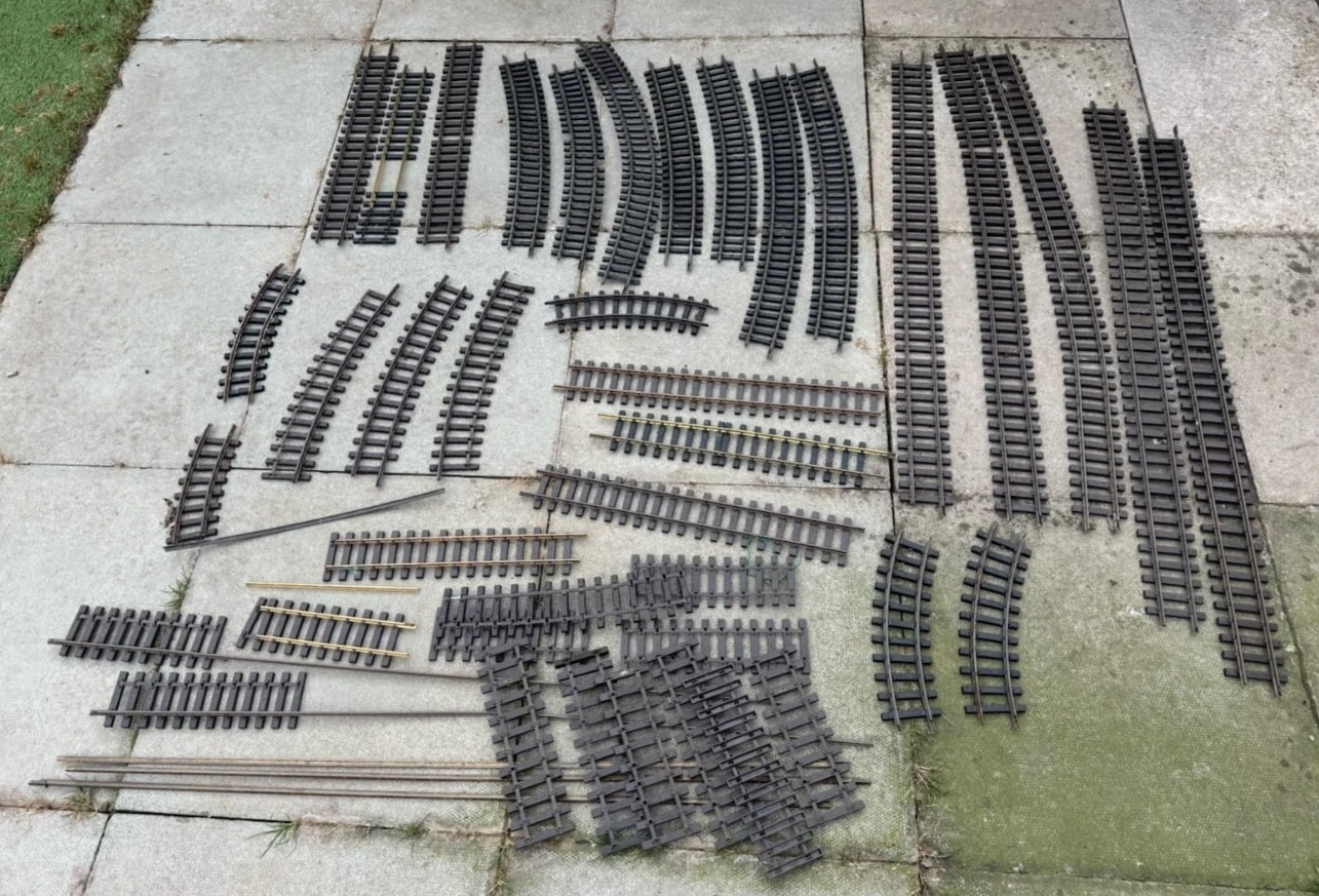

Would you travel 375 miles to pick up some secondhand track? I just did.
I needed around 5m of track to finish off the relaying. I was on the point of giving up finding some reasonably priced secondhand G gauge track on eBay when I changed my search terms for one last look. On the last page was a listing with a very reasonable starting price, but collection only from just outside London. There were no bidders and only an hour and a half until the auction ended. I placed an optmistic bid and then had to go out for the evening. When I returned, I discovered that not only had I won the auction, I got it for the starting price!
I calculated that, even when adding the cost of fuel to go and collect them, it was worth it. Do you agree?
£10.08 for:
5 x LGB 1200mm straights
2 x LGB 1200mm straights with badly damaged sleeper strips
4 x LGB 600mm straights
3 x LGB 450mm straights
1 x LGB 300mm straight
3 x Aristo large rad curves
4 x Aristo Med rad curves
3 x LGB R3 curves
4 x Bachmann R2 curves
BTW Six LGB 1200mm straights (in slightly better condition) I was watching went for £113 (plus p&p) just after I got mine.
