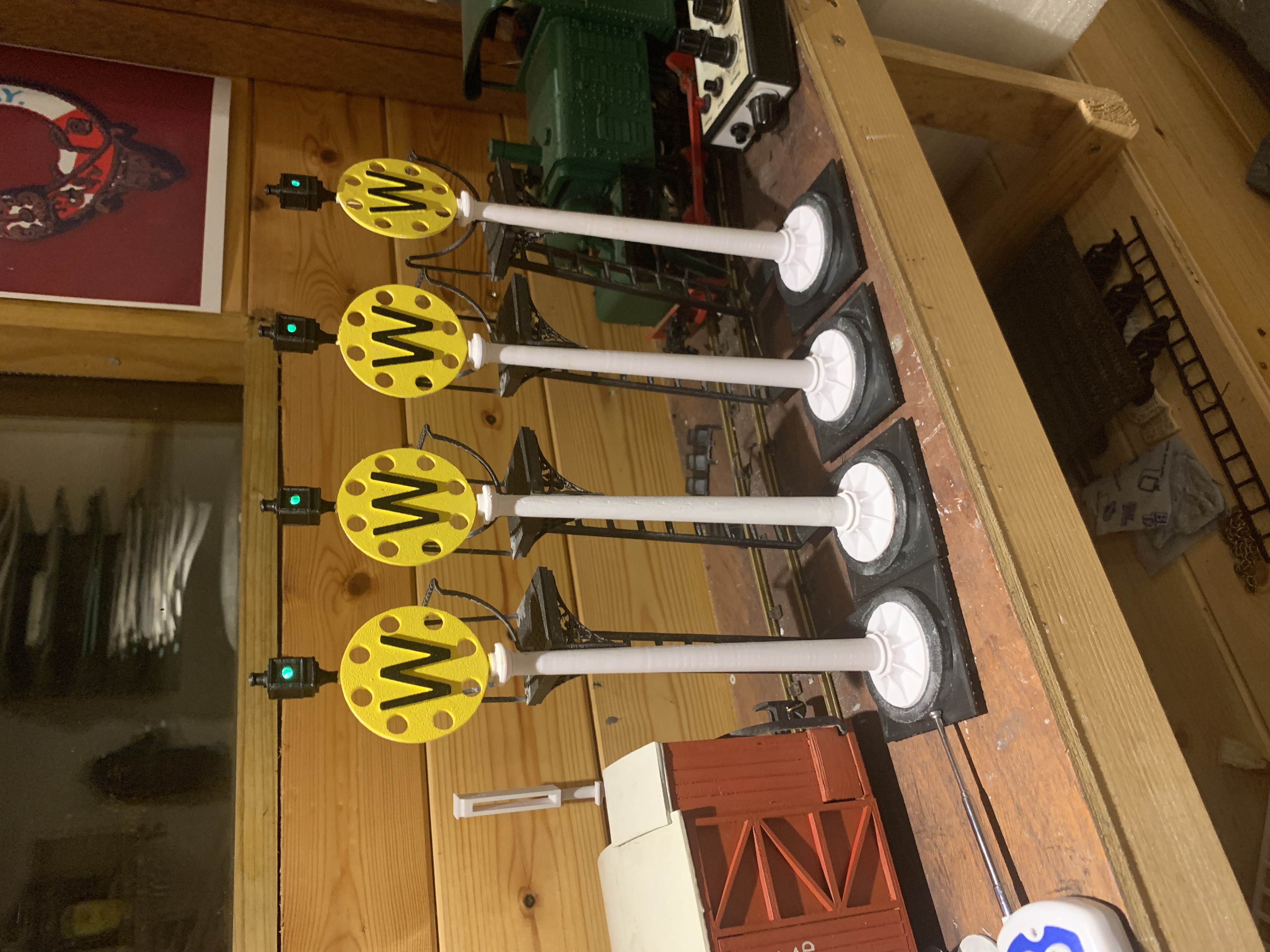

Here are photos of the "caution" signals I made to go alongside the steps where the footpath crosses the railway. These don't move, and are intended as fixed "caution" signals with "W" written across them to indicate that the driver should sound a whistle. The green light indicates "caution" (well it did in 1880):
These are really an indulgence because I can find no evidence of yellow discs with a "W" from the 1880's, but it is something which was done in the early preservation era, so why not?
You might also notice that the two types of signal are slightly different - because after printing the 10 disc signals I found a drawing of these signals and modified the drawing to more accurately reflect the prototype. The handrail, the footplate, and the footplate brackets are different. Also the base of the column has the correct webs and ornamentation. I have not implemented the scalloping on the column itself.

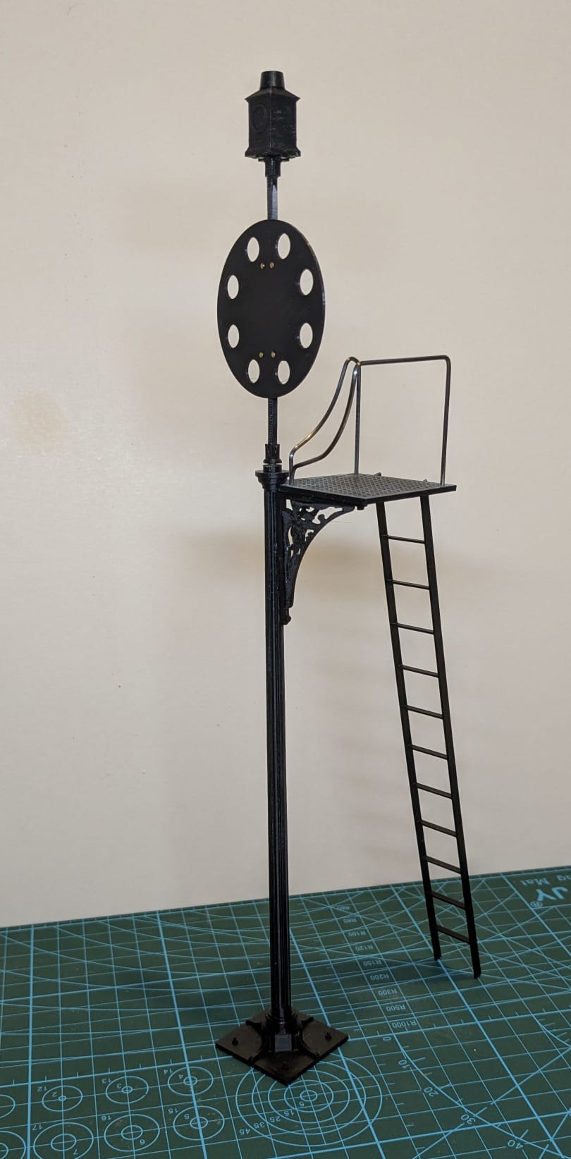

This is the full signal. Roughly assembled as it's awaiting the weather to warm up so I can spray it in my, unheated, workshop. The black PET-G masks some of the details, plus there's things like the lamp lenses already printed for fitting after painting.
Not happy with the ladder yet. It should have round rungs 1mm dia which aren't easy to print, or more accurately getting supports off has too much collateral damage. I'll probably have another try at that when painting time is closer.
The column is hollow with brass tube bearings top and bottom to allow it to become practical in time. Not quite sure whether I'll use servos, steppers or ordinary motors. It's lead me into Arduino territory for control, so that's a new thing to learn. I quite like the idea of making it wirelessly controlled with either Bluetooth or WiFi.

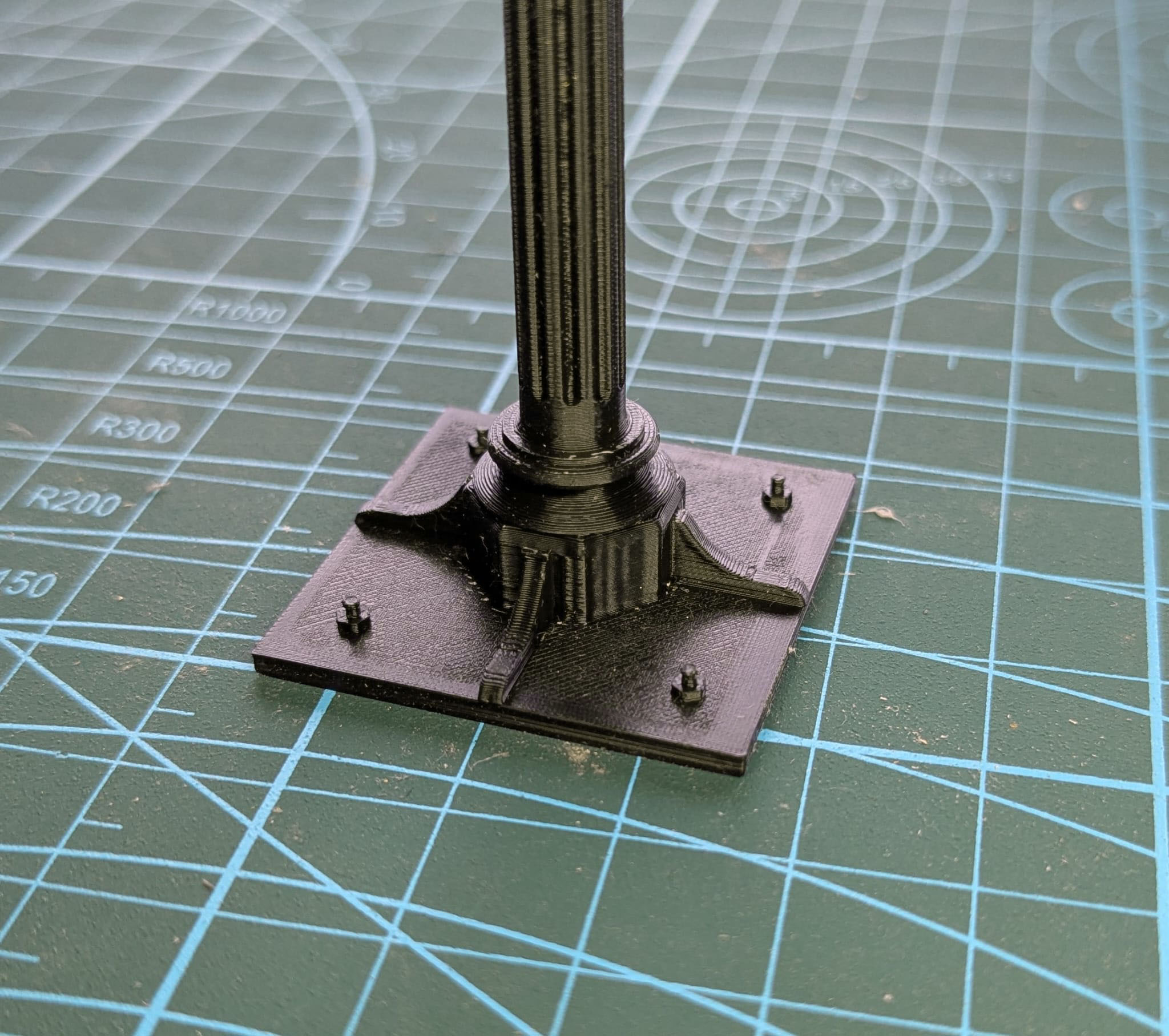

As a result of your comments on the fluting I have had a go with it. Drawing the fluting was straight forward, but getting a quality print from it is a different matter!
A photo to illustrate:

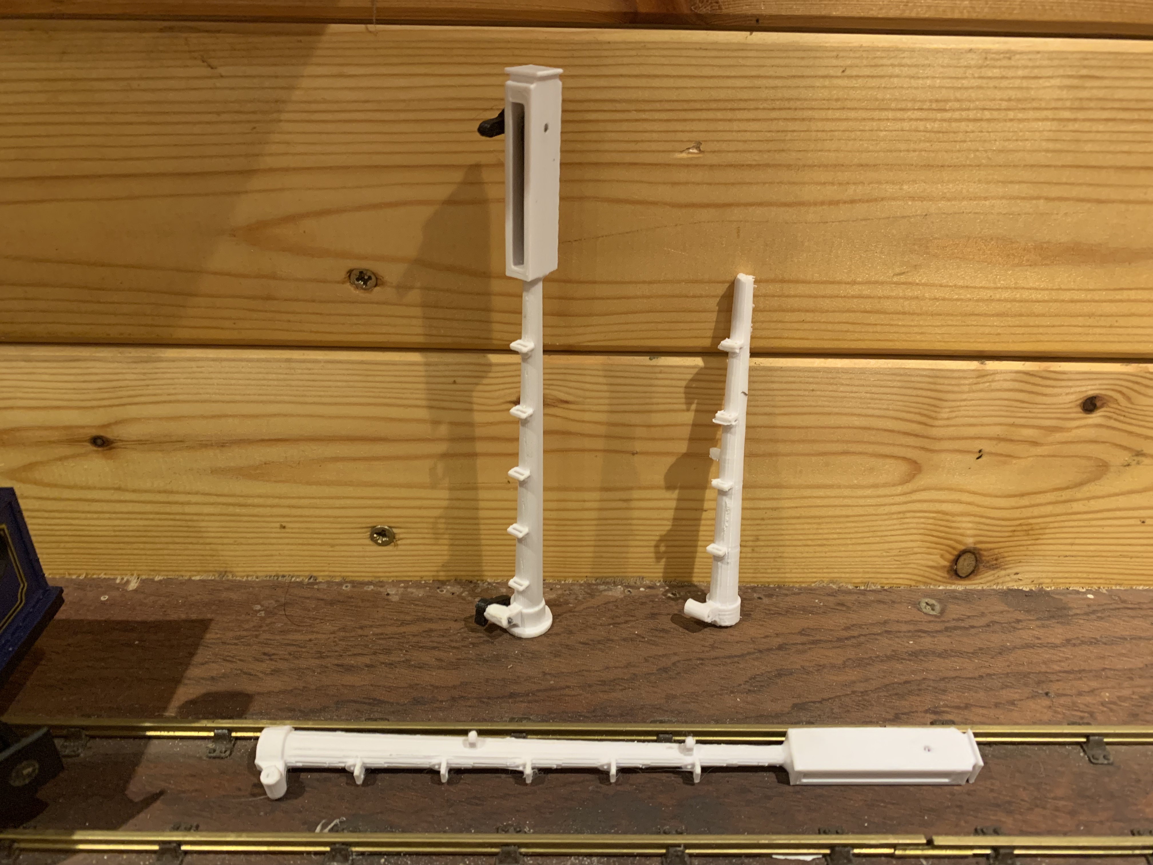

In the background is the point indicator with no fluting. It was printed on its side with the steps uppermost. It required some cleaning up with a file - but it is quite satisfactory for use. In the foreground is the fluted version of the point indicator, again printed on its side. The bottom would be OK, when the remains of the supports have been filed away, the sides are crisp, but the fluting has disappeared on the top - lost in the difference in height for each print layer.
In the background on the right is the fluted version printed upright. The fluting is just about visible, but as the column rises it gets lost in the flexibility of the column.
I have found that printing columns upright is possible, up to a point, but at a height of about 180mm the print falls off the bed whatever base I add to it. In the same way the taller it gets the more flexible it becomes and the definition deteriorates. Printing a square column becomes oval as it gets taller.
I suppose it might work if I added buttresses attached at various heights, to prevent the column flexing, which could be removed afterwards like supports.

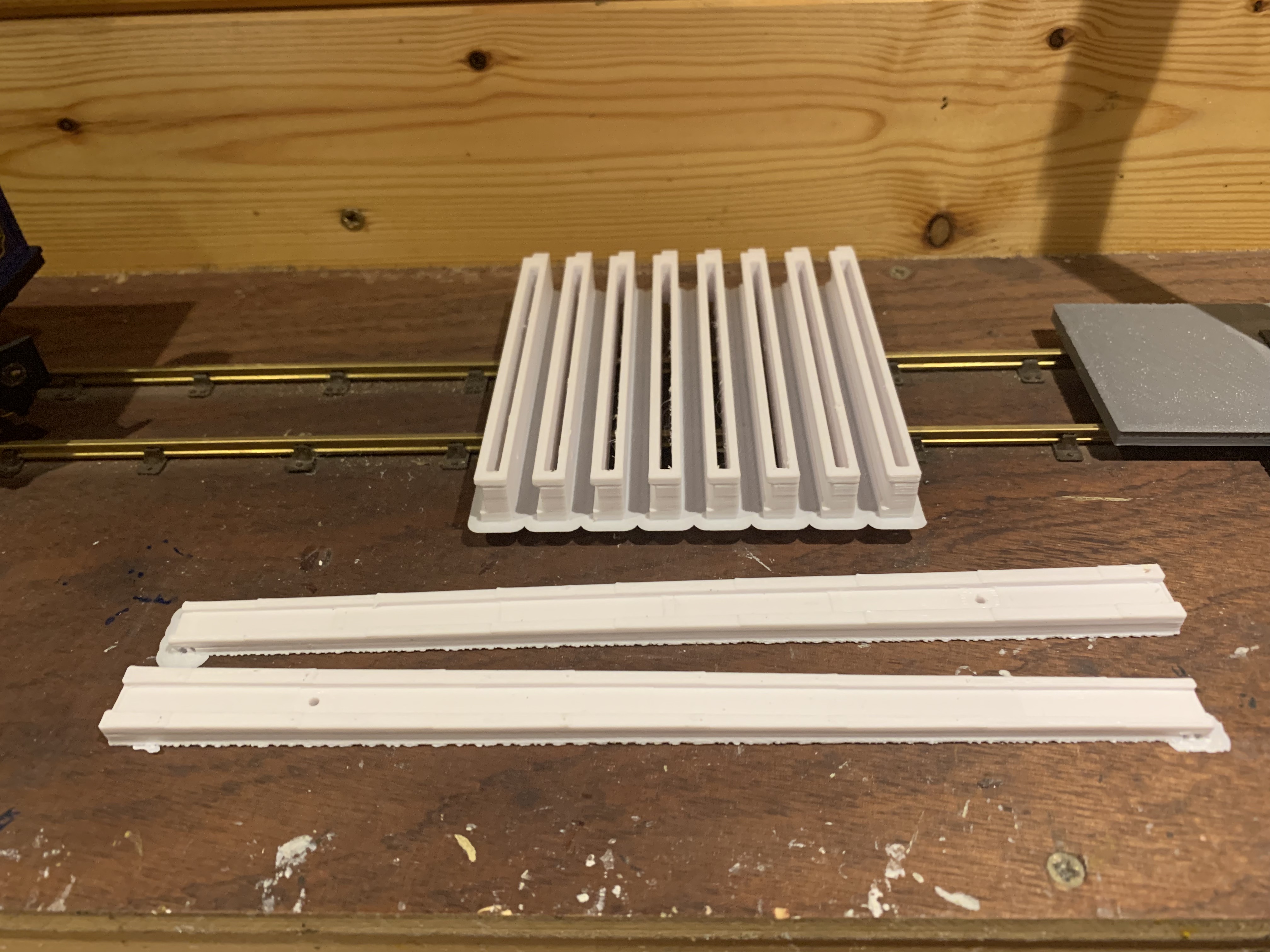

I have printed the tapered rectangular columns flat on the bed in two halves. The upper face is the inside face, which has a half of the wire duct in it. The halves are at the front in the photo. At the back are the sockets that the arms fit into, again printed in halves but this time with the slot for the arm vertical and the wire duct on one side. I tapered the ends of the slot to avoid having to add supports.

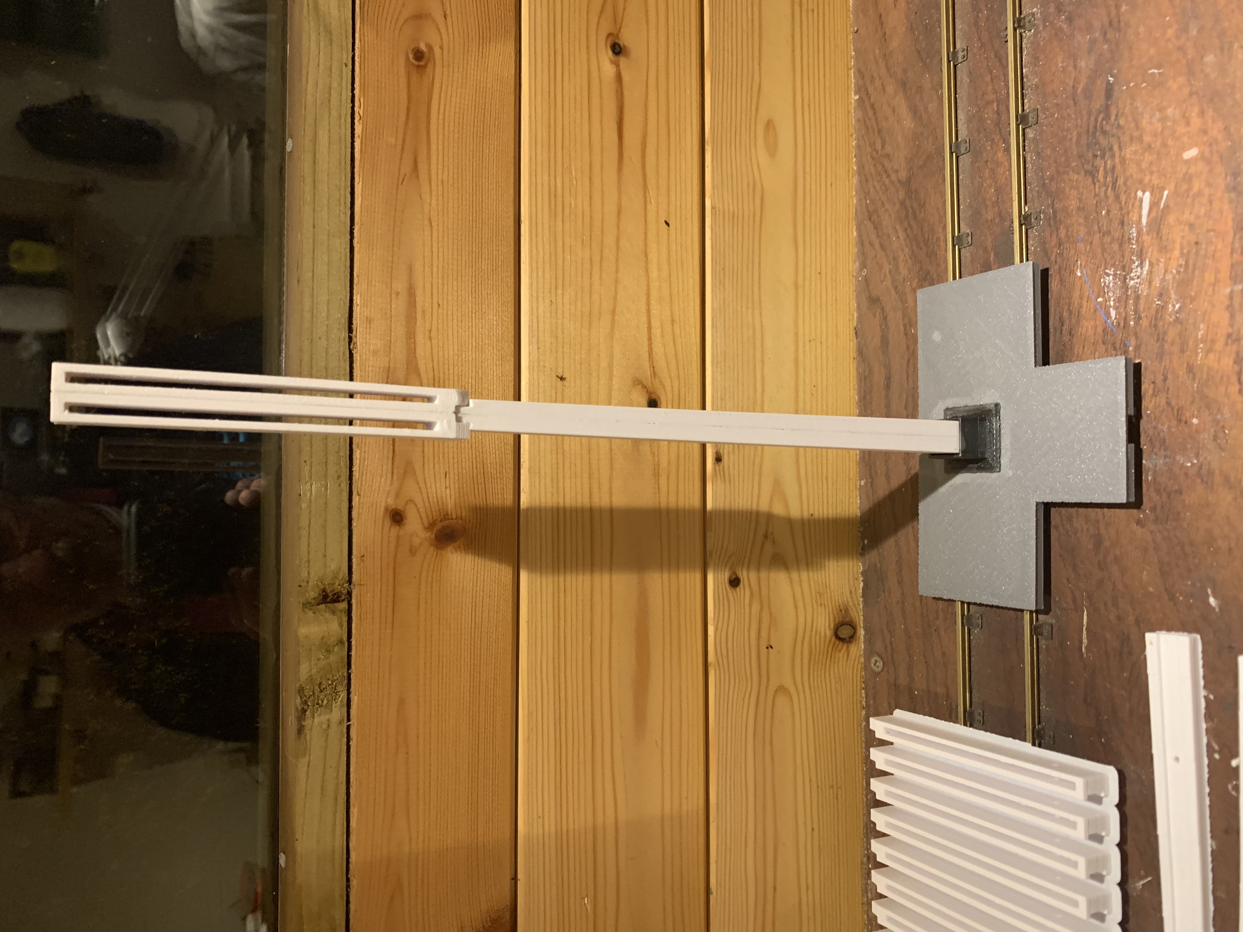

Finally the first signal so far:
The four pieces that make the assembly have been cleaned up and bonded together.I have added a non prototypical socket to reinforce the bond between the column and the base. The base has a slot in it on its underside to continue the wire duct towards the camera. That section of the base nearest the camera is to take the servo/battery box which will attach to the end of the base extension.

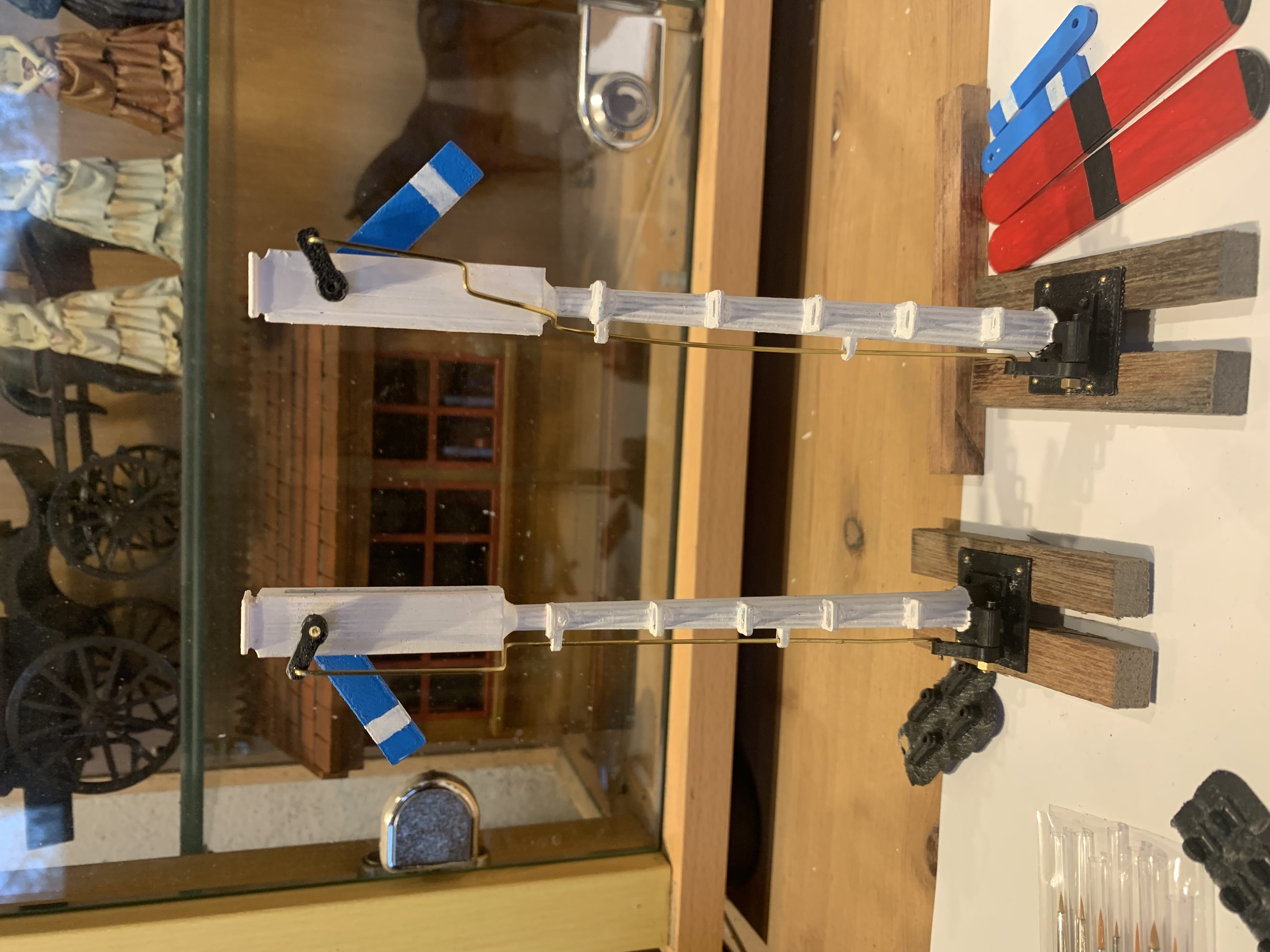

I have made a bit more progress on the signals, in that I have the first two point indicators ready to go out onto the railway. They will be attached to the points I have rebuilt for the lower terminus. They work, but the way they connect to the point needs fine tuning:
That will have to wait until it stops raining!
