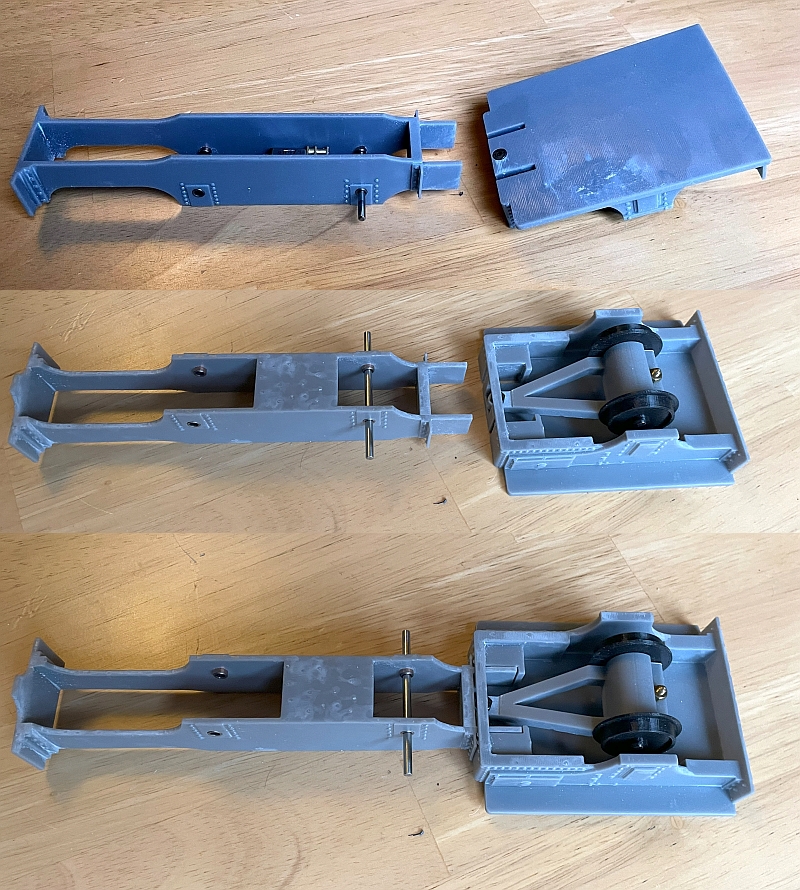

Making progress!

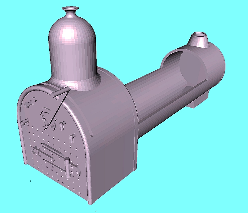

The whole chassis is too long to fit in my printer, so I've split it at the front of the firebox which not only solves that problem but it will give me a self contained 0-4-0 working chassis, plus the cheating pony truck for the unpowered rear (fixed) axle. Should make setting things up much simpler.
I've built a pony truck very much along the lines that Graeme suggested which, subject to actual track trials, seems to be fine ( Thanks as always Graeme).
So this composite picture shows from top to bottom, the top side of the 2 chassis parts, an under view of the same thing and finally an underside view showing how they will be glued together. If you look carefully the motor is just visible in the first view, sitting on a shelf at the bottom of the frames. This shelf also acts as a spacer and gives the motor an gearbox some protection from track grot.

I've actually also printed the complete 'smokebox/lower half of boiler/firebox with dome', all as one piece. It only finished printing a couple of hours before we came away for a week so I didn't have time to do more than UV cure it, but at a quick look it seemed OK. Proper piccy of it next week with luck, but this is in slicer

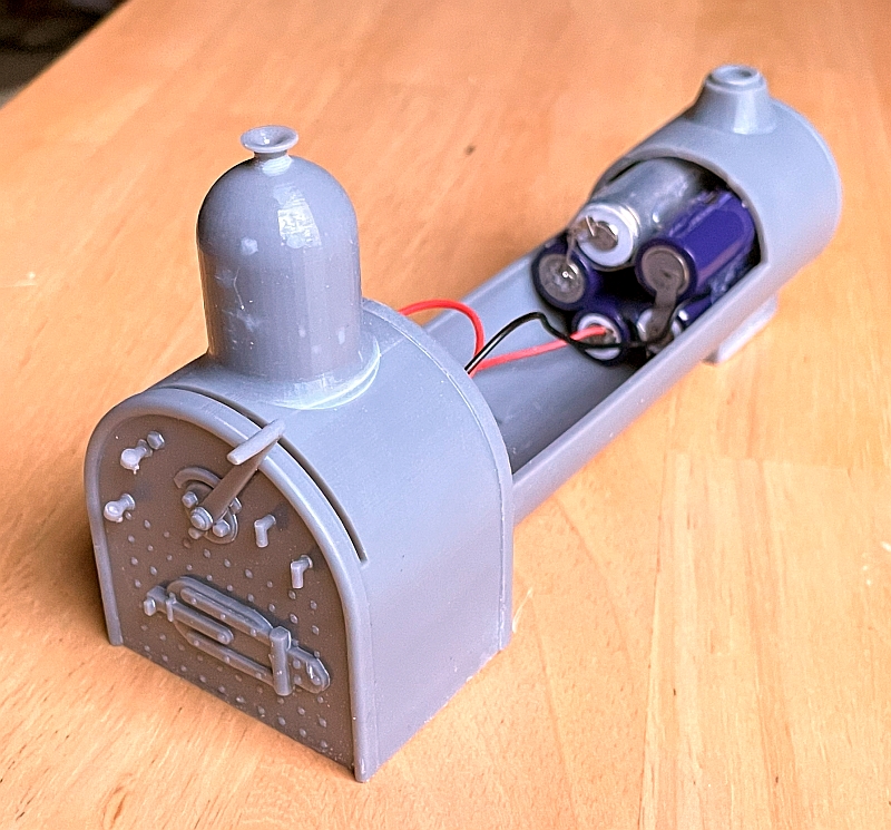

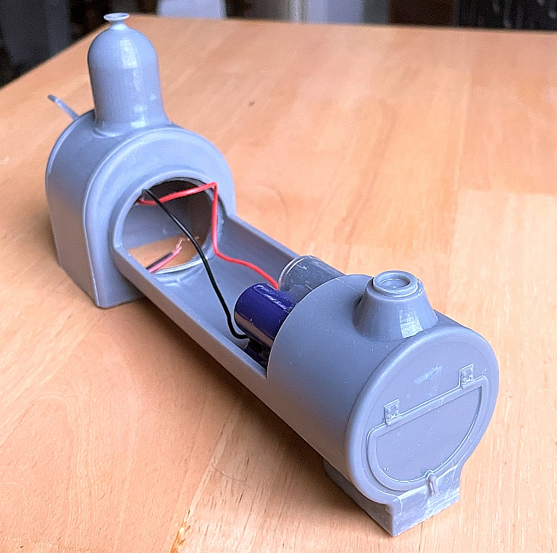

Re: What is it? An F&B 0-4-2
As promised, the firebox/boiler/smokebox print. So far so good.....
The batteries are just to check for fit atm. The slot in the top of the firebox is to locate the bottom of the cab front sheet. I thought it easier to do it like this than try to get a curve on the bottom of the front sheet that exactly fitted the top of the firebox.
The slot is an excellent idea! I will have to remember that...

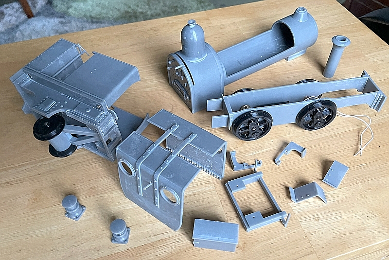

OK, all the main parts and some of the smaller ones are now printed and ready to be put together. The only large part to be done is the saddle tank.

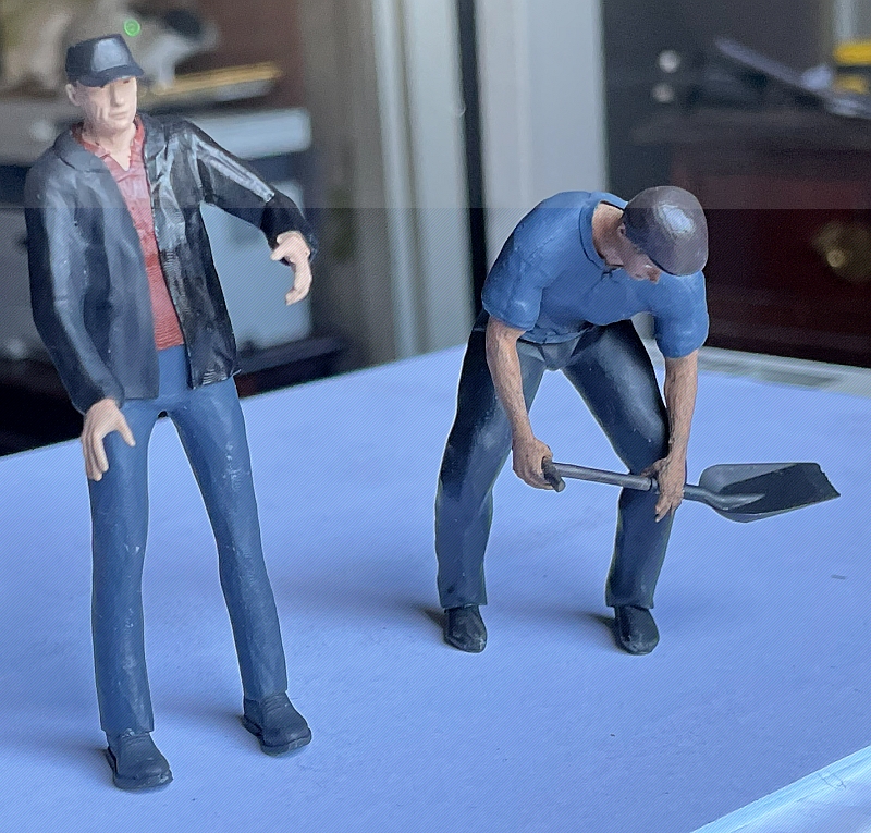

Just in case anyone was wondering, I haven't shunted this project into the breakers yard. It's just that for the last couple of months the weather has been too awful, cold or wet or both, to be able to get out in the garage to paint the large kit of bits that are sitting on the bench.
However as you may have guessed from other threads, I have managed to produce a crew ready for the future - both created in MPFB2.
