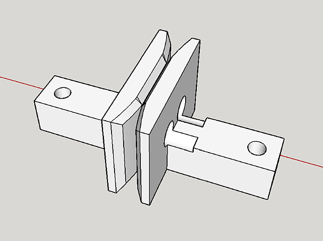

For your suggested 2-magnet version, perhaps creating a slight groove between the two magnets would allow for a minature "crow-bar" to slip in and prise them apart?

3 minutes of fame wrote: Fri Jun 23, 2023 8:00 am If there's enough interest, I'll redraw them to take a pair of 3mm magnets, so that they become bidirectional.
Strength wise, I can pick up the 4 coach train and dangle it from the couplings. That's about 1Kg, so more holding force than I'll ever need on my little railway.

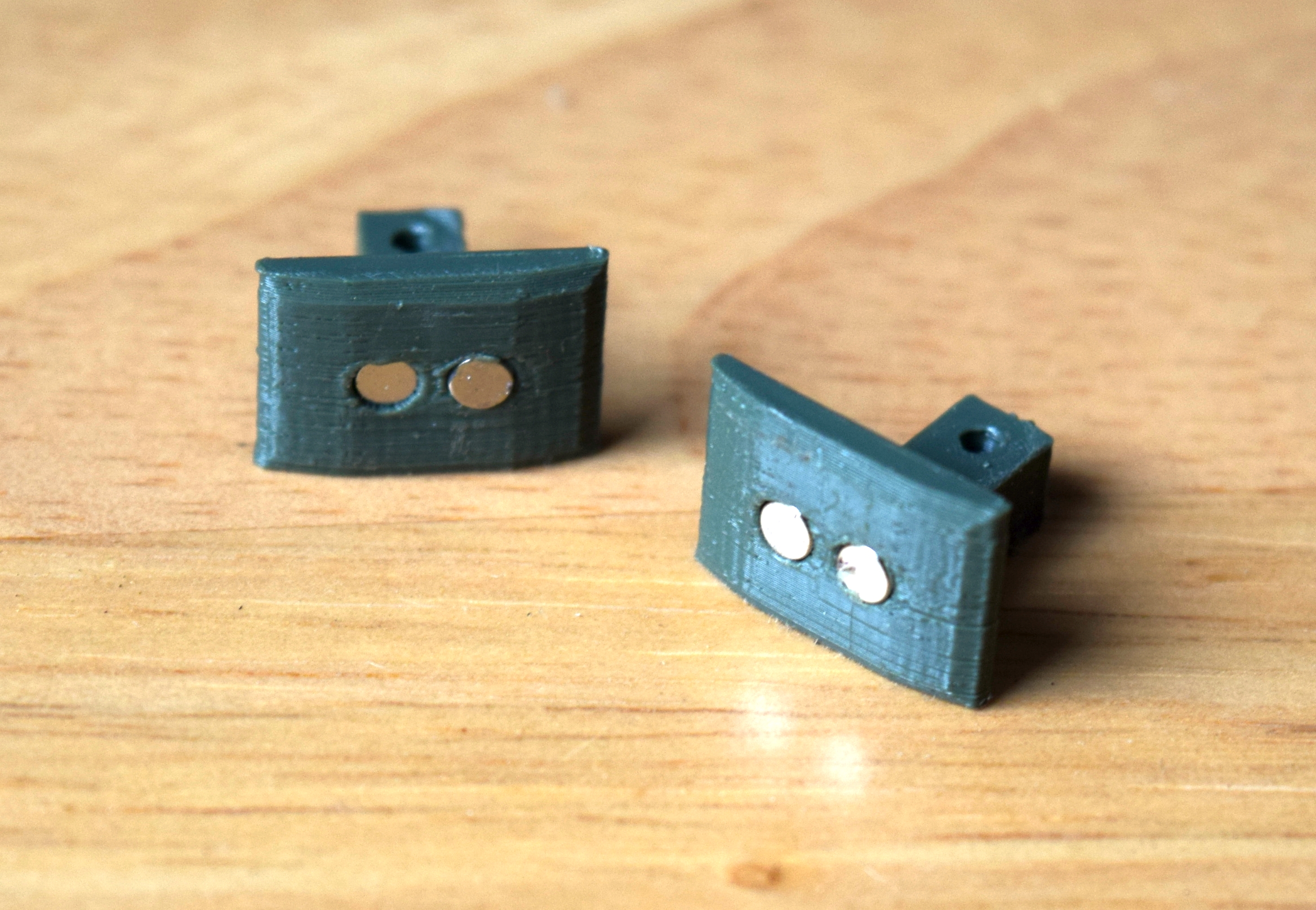

Just to pass the time, I had a play with your stl of the buffer head and modified it to take a pair 3mm x2mm magnets.
Then,
Point1: its a 'mare trying to get the little blighters to go in the holes instead of the second one sticking to the first one and/or the pliers,tweezers, etc!!
Point 2 : it is obviously essential to get the the pairs the same way round each time and the little so-and-so's always want to be awkward....!
However, finally....:
The separation force appears to be in the region of 250g. Slightly crude measuring regime of hanging the pair of couplings beneath a digital luggage scale and pulling vertically downwards until they separate. Did it half a dozen times with a result between 240g and 260g each time.
So I guess your train would part between the 1st and 2nd coach!
Separation of these isn't a problem, simply push a small screwdriver into the joint between the two faces and twist, but that might not work for stronger magnets.

I've got some 4 x3mm magnets on order to see if they work better and are small enough not to distort the buffer head too badly.

Can I suggest you get the magnets such that they just protrude, and make full contact. That will significantly improve the holding force.
It's probably easier to fit all North magnets using superglue first, and then do the South magnet once the North magnet glue has dried. Closing up the holes by about 0.01mm will help with the interference fit.

I'm afraid that the maths of mechanics is way beyond me ( like a lot of things :dontknow: ), but I understand what you are saying in principle. Soooo.. having printed half a dozen heads, and mindful of comment about keeping the magnet faces slightly proud, I can confirm that you are correct! Still a bit of a lashup, because I didn't want to go and start modifying perfectly good vehicles without good reason. However a few paperclips allowed me to use the pin holes to fix the magnetic heads on a temporary basis and as you will see, a 4 wagon train weighing in at 2.5Kg, seems to be fine. I haven't messed about with different wheelbases, bogies, etc, and at 4Kg the couplings didn't want to know, but no way will I ever need that kind of grunt! :D
The 3d prints are the same as the pics I posted the other day.
Apologies for the quality, same old problem of camera in one hand and controller in the other!

I've actually attached two stl's, one for the 2x3mm magnet version and one for a 2x4mm magnet version. Both use your standard 5mm square mounting peg.
I must stress that I haven't actually tried the 4mm version yet. I had it drawn and test printed ready for when the magnets arrive but since the 3mm version seems to be adequate I don't think I'll take it any further at this stage, unless I get any problem with weakness.
Actually, I lied when I said that my test train used the same prints as my prototypes. I had forgotten that I put a small reinforcing rib at the back, "just in case"!
I mentioned yesterday that keeping the pairs of magnets the right way round whilst mounting them was a bit of a 'mare but I've now discovered the easy way to do it.
1) Put a pair of magnets into one buffer head and mark it for future reference.
2) Offer two more magnets to the face and they will both ping on to the front of the mounted ones.
3) Press another buffer head on to the front and squeeze the two together to force the 2nd pair of magnets into their holes in the 2nd one.
4) Carefully twist them apart and apply glue. Then repeat for as many as you wish
