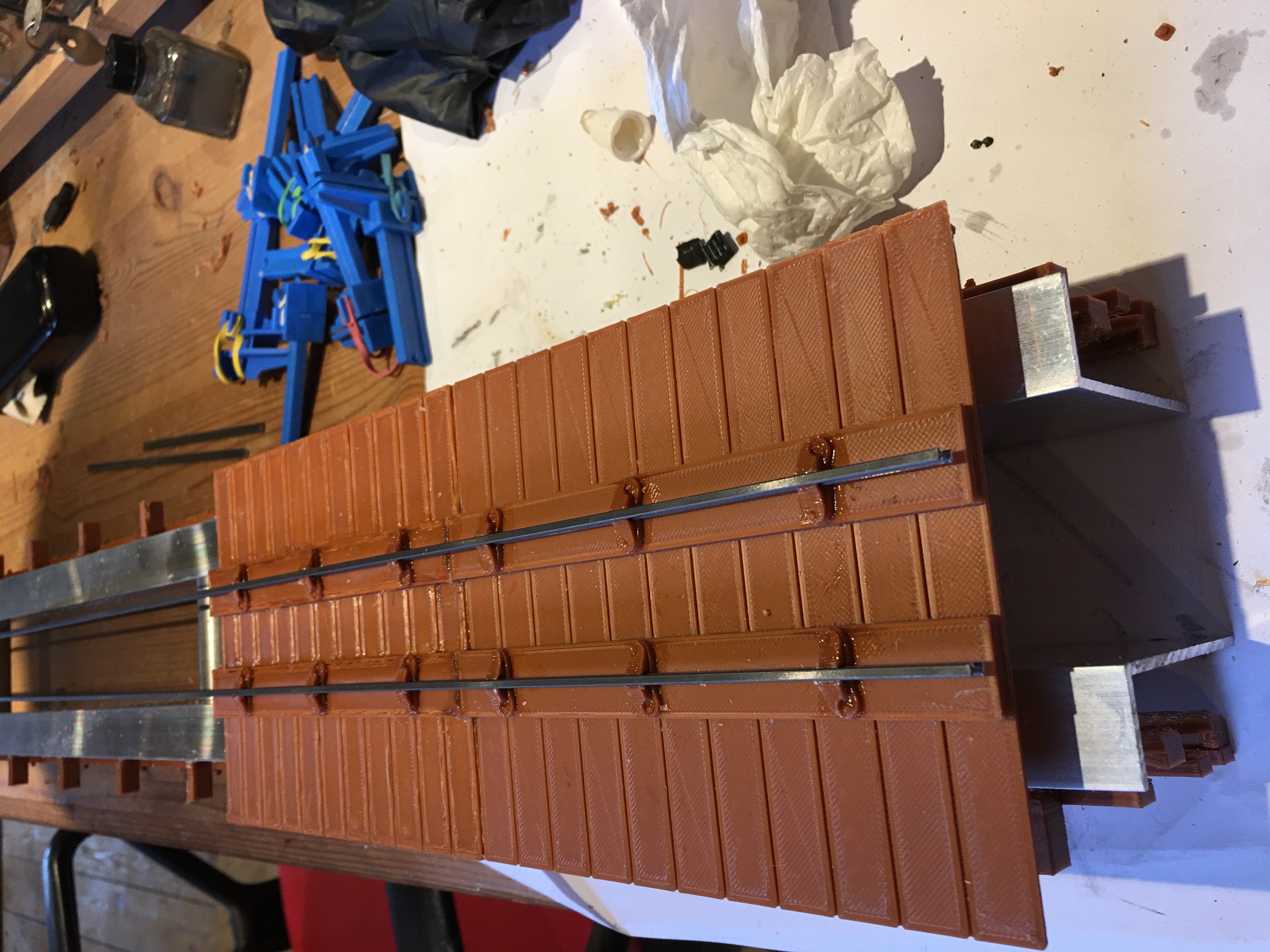

Both sides are covered in the lattice work. I have some deck printed. The rail fits in the chairs and it the deck fits in place. Rolling stock flanges miss the chairs as well:
However. The gauge is a bit tight. 31.25mm instead of 32mm. I think the deck would be better if it were a bit thicker as well. So I have modified the design and will start printing again. It will take a while as each piece of deck takes 8 hours to print. I think I will wait until I have 4 lengths ready before fixing it into position.

Trevor Thompson wrote: Thu Mar 09, 2023 12:11 pm I have some deck printed.
That really looks the part!
Deck, sleepers and chairs all printed together?

Yes printed in one piece. Had a bit of a problem with the printer - messed up the slicer settings and made the layer height too high, so the layers were not bonded properly on one section. The other section parted from the bed - part of the same problem. All sorted now. So starting the deck again wasn't really a problem. If you want the stl file for the chairs I can add it to the forum.
