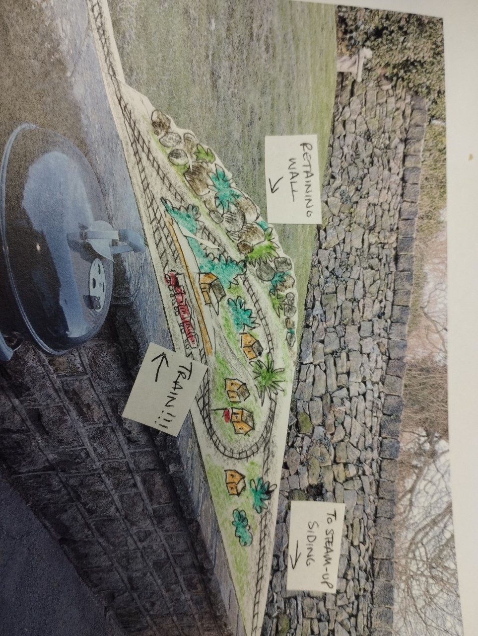

Here's the sort of thing I (and maybe others) had in mind, where a low wall buys you enough flat space in front of it to get a loop in - although that's going to need to be about 6 feet, to get a pretty minimum (2'6" radius) loop, plus some clearance, and you will lose lawn...
Cunning plan.jpg (379.16 KiB) Viewed 35188 times
Hope that makes sense?!
You can't beat a little lunchtime layout planning... Luckily for me, work is a Medical Library, where we lend the students crayons to colour in pictures of the digestive system or whatever. At least I think that's what they do with 'em???
PS I needed to work on my perspective a little more, that "flat" loop still looks like it's sloping up the garden!

Cheers Andrew, this is brilliant! Really appreciated. You really brought it to life.
You should become a children's book illustrator! Nice little side hustle for your lunch breaks!

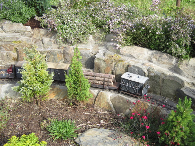

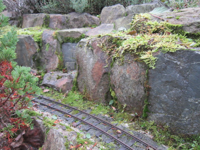

That is a perfect example of what can be achieved in sloping ground. Some negotiation may be required dependant on what other users may require of the space, but if it is shared then you might have a section to call your own? At the moment it appears to be mainly grass, so the railway would certainly add to the decorative aspect of the garden.
The 'retaining wall' would also be an attractive area to display planting, as well as being a support to higher ground....
This video of my line shows how the stone performs that duty and adds to the enhancement of the garden....
https://www.youtube.com/watch?v=hHGDJmKpnIQ

Using Andrew's very solid drawing I was finally able to conceptualise the station area, loop, and siding. I'm going to flatten the ground there and go with the retaining wall behind.
