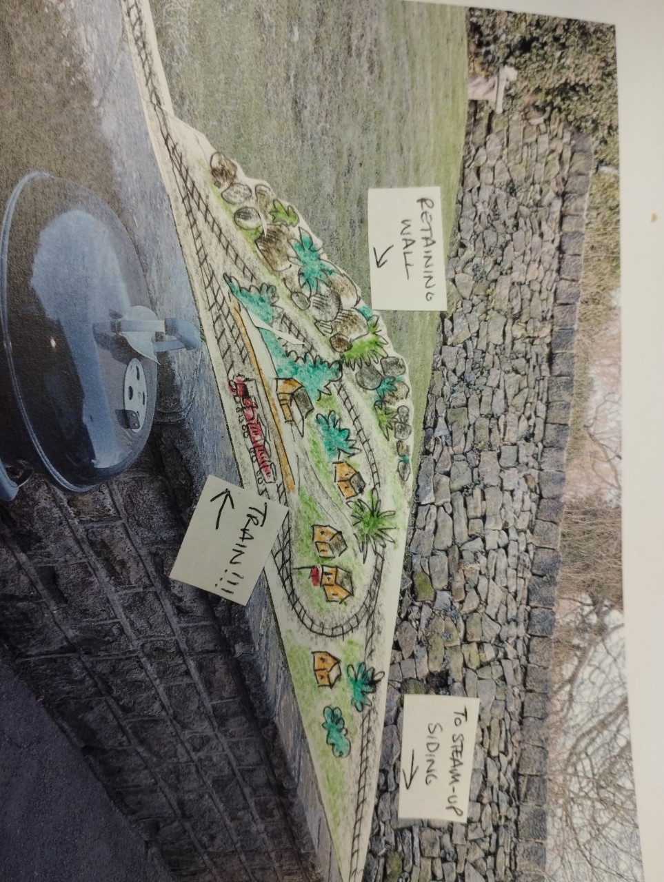

Here's the sort of thing I (and maybe others) had in mind, where a low wall buys you enough flat space in front of it to get a loop in - although that's going to need to be about 6 feet, to get a pretty minimum (2'6" radius) loop, plus some clearance, and you will lose lawn...
Hope that makes sense?!
You can't beat a little lunchtime layout planning... Luckily for me, work is a Medical Library, where we lend the students crayons to colour in pictures of the digestive system or whatever. At least I think that's what they do with 'em???
PS I needed to work on my perspective a little more, that "flat" loop still looks like it's sloping up the garden!

Cheers Andrew, this is brilliant! Really appreciated. You really brought it to life.
You should become a children's book illustrator! Nice little side hustle for your lunch breaks!

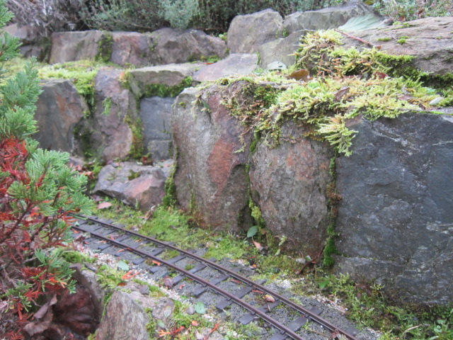

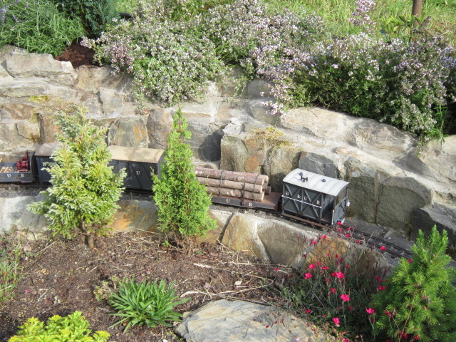

That is a perfect example of what can be achieved in sloping ground. Some negotiation may be required dependant on what other users may require of the space, but if it is shared then you might have a section to call your own? At the moment it appears to be mainly grass, so the railway would certainly add to the decorative aspect of the garden.
The 'retaining wall' would also be an attractive area to display planting, as well as being a support to higher ground....
This video of my line shows how the stone performs that duty and adds to the enhancement of the garden....
https://www.youtube.com/watch?v=hHGDJmKpnIQ

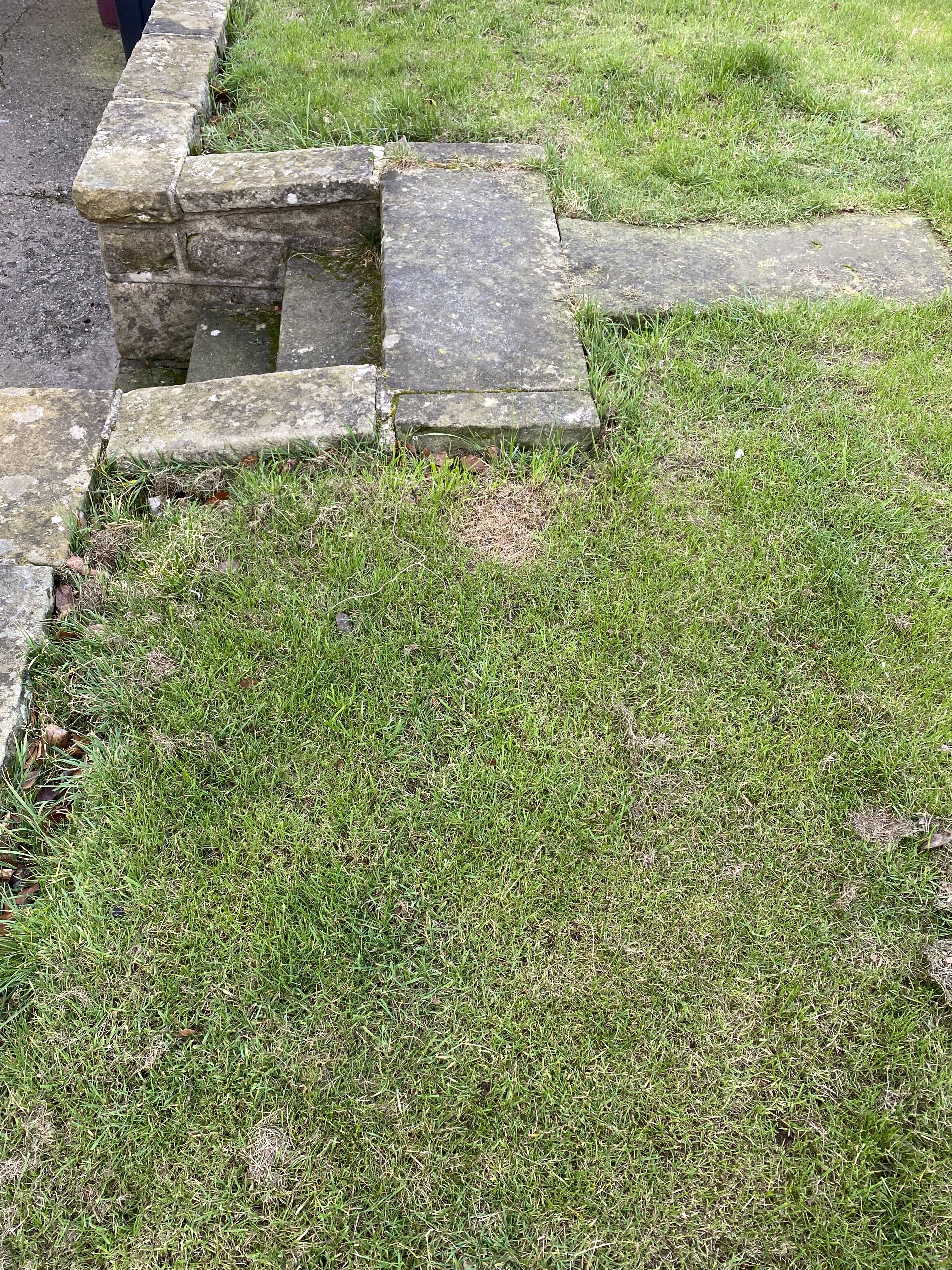

Hi everyone,
Quick update on this...
Using Andrew's very solid drawing I was finally able to conceptualise the station area, loop, and siding. I'm going to flatten the ground there and go with the retaining wall behind.
But still gradients are not my friend...
In the middle, there are the steps.
I can:
1) Get a removable bridge - which I know nothing about. Would that just slot into place each time?
2) Go around the steps - but this involves a climb at 8.6% or 1:11.5 gradient. I'm guessing that's too steep? And if descent would be an issue, potentially a train is descending into a tight turn, close to what amounts to a cliff edge (wall)... so I'm guessing this isn't the best idea.
It's only 46" and a rise of 4" ...looks puny but perhaps not so at 16mm scale!
Thoughts welcome!

Keep it 'flat'..
I will leave it to others, to show engineering solutions bridging gaps.
If you really have to have a gradient, then aim for 1:40 to 1:50..
You can get away with up-to 1:24,but that is going to put a strain on things, and would need to be a straight approach and slope. - Add a curve on/into a gradient, and it will really cause problems.

Regarding bridging gaps I did find a lift out bridge more of an inconvenience as compared to a lift up bridge.ashover wrote: Tue Feb 14, 2023 8:52 amThanks Simon. I think Peter is right.SimonWood wrote: Mon Feb 13, 2023 9:16 pm That’s a great garden with a lot of potential! Whatever you do is going to look great in it, I think.
That said, I’d be inclined to agree with Peter. The wall is really just at a perfect height, almost made for the purpose, dog-boning the ends will give you good running options, and if you don’t want a removable bridge I would have thought you could push the railway back to the top of the steps at that point to cross on the level.
I think I will loop into the grass rather than onto the paved area Phil.
A couple more questions:
For a removable bridge - are these easy to attach/detach? I'm guessing I wouldn't use rail joiners?
For the wall - do you think I should run on the wall itself, on top of felt-covered wood - or alongside the wall? In theory I could create a gravel bed alongside the wall or use boards on top of log roll- something like that?
Thanks again everyone!

I've had no real problems with a lift out bridge, apart from the fact that the raised timber approaches tend to swell when they get wet and lifting gets a bit fraught sometimes! The secret is to have very rigid fixings and some sort of locating pin/hole arrangement which can't moved in relation to each other. 16mm track/wheel standards are crude enough that it can cope with minor misalignments.

There may be space for the track to remain level and deviate around the steps in a cutting, or even a tunnel if the top step is raised?

Would need to be a tunnel under the top step- but that's very deep. I'm going to proceed with the bridgePeter Butler wrote: Wed Feb 22, 2023 1:17 pm There may be space for the track to remain level and deviate around the steps in a cutting, or even a tunnel if the top step is raised?

Thanks for the responses everyone, and for the useful links, Graeme- much obliged.
I'll go with the bridge idea. That seems the most straightforward- literally.

You can always start simple, with a plank braced with 2x1, and then create something more elaborate later, when you've got things up and running...

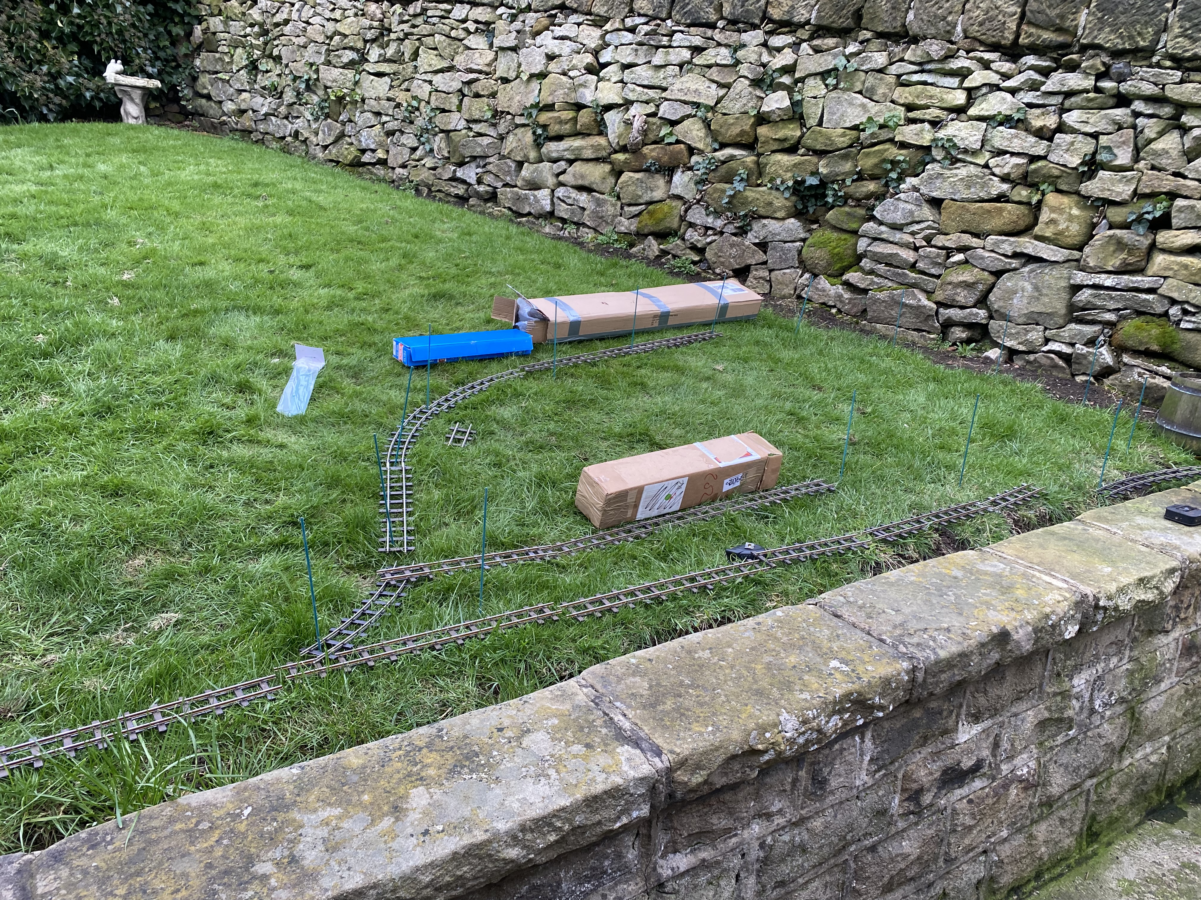

Update: we have track!
Most of the straights anyway. I need a lot of set-track curves and points… 6 in total.
Coming from the 00 world…. I can’t believe the cost of points. It’s looking like £450 just in those?
If anyone has any they’d like to offload I’d certainly appreciate being able to shave the cost a bit!

How adept are you at cutting/grinding/soldering brass.ashover wrote: Fri Apr 07, 2023 10:01 am Update: we have track!
If it's no problem then I have some plans to make your own points.
I do not use set track I use flexible track because it allows me to make curves of any size radius.

Thanks Graeme - I’d certainly be open to learning. I do have a soldering iron at least!

Agree with Graeme on both counts, plus its cheaper to buy flexitrack than set track and cheaper ( and more satisfying) to build your own pointwork.
Building points is nowhere near as difficult as some folks make it out to be, just get some track gauges and go steady and don't expect to do it in a couple of hours.
