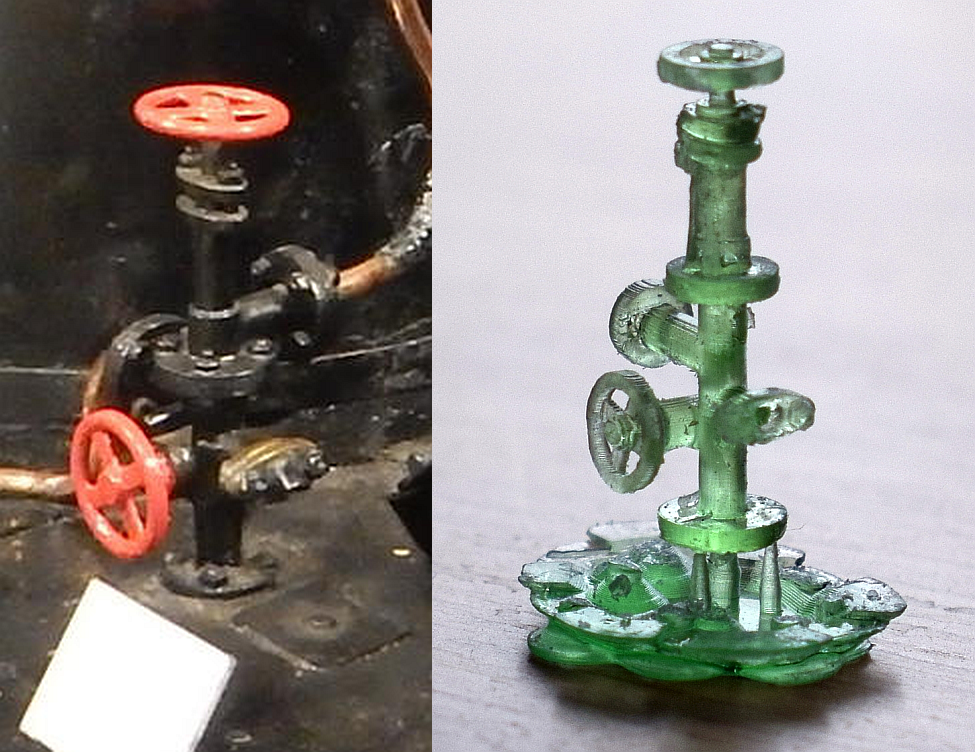

I must admit to being a bit chuffed (!) with this resin printed injector for the DW. It needs a bit more cleaning up but hopefully that will be easier to see once it has some grey primer on it:

Wow! How tall is it?

With the base removed ( obviously!), its 18mm top to bottom.

Very nice!

I redid the injector because I realised that I had missed one of the connections, and also the handwheels looked a bit small. Then:
