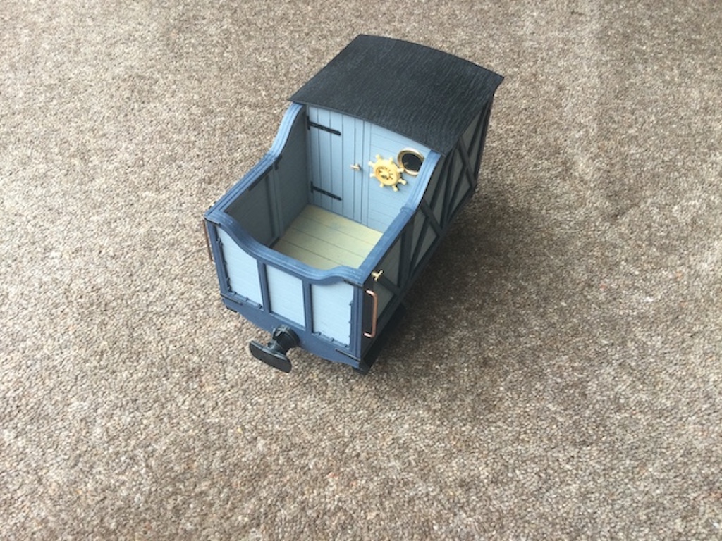

Next a Spooner Brakevan from Sixteen Mills. Having seen the one made by Peter B it was an easy choice for something from their stand at Llangollen.
spoon 1.jpeg (370.1 KiB) Viewed 8815 times
spoon 2.jpeg (484.65 KiB) Viewed 8815 times
spoon 3.jpeg (458.33 KiB) Viewed 8815 times
spoon 4.jpeg (458.08 KiB) Viewed 8815 times
A pleasure to build. The basic structure was glued together with wood glue, omitting the overlays. The chassis members were glued to one another in place but not to the body and the steps assembled as separate pieces. Each section and the overlays were then sealed with MDF primer and allowed to dry then primed in grey with rattle cans. I had not decided on a colour scheme and checking what acrylic airbrush colours I had thought light blue for the body and dark blue for the overlays might look good. I attempted to airbrush the overlays but kept having clogging problems, the paint probably being too old and so resorted to brush painting them. Trying the dark blue overlays on the grey primer gave me the final colour scheme! The overlays were fixed with canopy glue, as were the corner strapping, hinges etc. The side door handles are brass ones from Brandbright, the guards compartment door handle a white metal one. The ship's wheel was not included in the kit and I sourced a Mantua one. The portholes are included with the kit. A guard awaits painting. I did wonder about giving him an anchor to throw out when needing an emergency stop but have not gone that far (yet).

I do like that Phil, the colour choice is excellent and beautifully done. I agree that the kits from Dave Mills are so well designed and fit together perfectly, he offers an interesting and varied selection too.
No connection other than a very satisfied customer, I attach a link to his 16mm site...
http://sixteenmills.co.uk/
