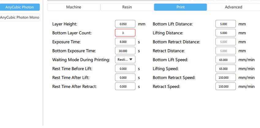

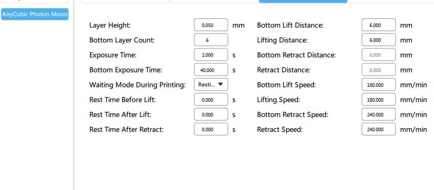

- -steves-
- Posts: 2473
Re: Printing thin resin sheets - PROBLEM SOLVED
I had a look at my settings which I print any colour in and never get bad results. One is the Photon S, the other is a Photon Mono. Speed difference is massive, but both work perfectly. I am surprised by how slow you had to lift away to get it to work.

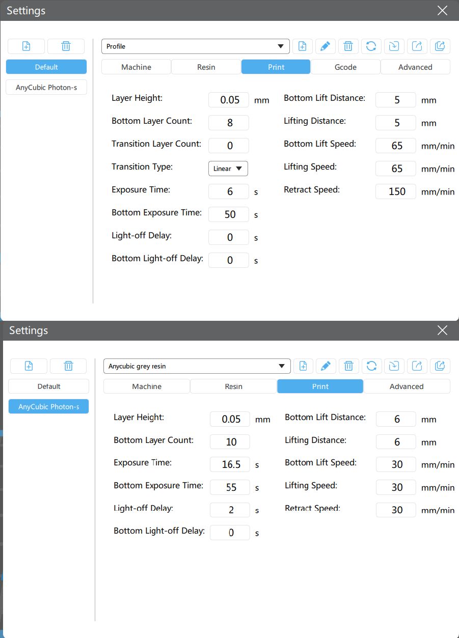

- Posts: 6041
Top are the default settings that Chitubox decided on when I first got my Photon-S and won't print my bolts on the sheet.
Bottom are the settings I got from somebody on a Photon forum, that has worked. That isn't to say that there isn't something somewhere in between
Richard could be right about me getting confused between mm/sec and mm/min though!

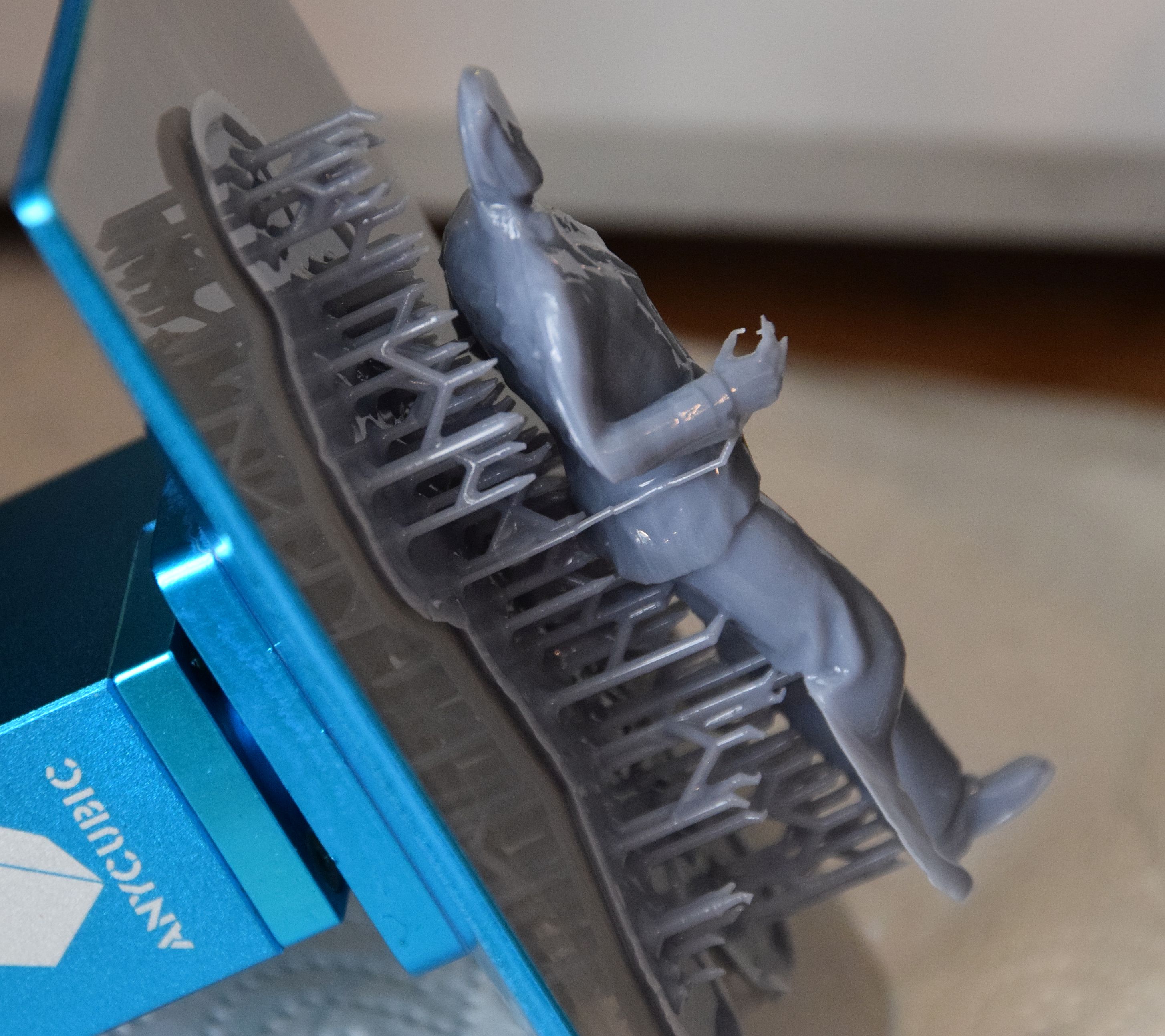

- Posts: 6041
Re: Printing thin resin sheets - NEW PROBLEM
Actually this isn't about thin sheets, but it does follow on.
Yesterday evening I tried printing a driver for the wee beastie. I used the same settings that worked for the flat sheet but did increase the lift times a little. What I got was a complete disaster! Basically the model pulled awy from the supports so I ended up with a flattened misshapen head and one leg degenerated into a flat sheet.
Sooo... this morning I copied Steve's settings from the screenshot above... and this time, this is what I've just taken off:
Which is, give or take, the same as I got yesterday. I don't understand it, because I've printed plenty of figures, flat sheets, and small parts in the past, using the default settings which are effectively the same as Steve's, and never had anything like these problems.
The only thing I can think of is that it is duff resin, but as I said above, it's a new bottle and the problems started with the old bottle. Anyway, I've just ordered a bottle of the Anycubic clear green, which is what came with the machine originally and I'll see if that is any better.
- Posts: 1192
- Location: South West Wales
I have had similar problems printing figures in the past - not necessarily with the same resin but similar problems.
Let me explain what I think might be happening:
When you look at the planes which would be printed at each layer there are large flat areas which are being printed at perhaps the point where the figure has parted from the supports. To begin with it is printing only the middle of the body. The middle of the body has stuck to the supports and then as you go up the layers the area being printed at one time gets bigger and bigger, until by the time we get to the head and leg it is the whole longitudinal cross section of the figure which is being printed at once. The force holding the layer just printed to the bottom of the tank is now overcoming the force holding it to the supports.
What I did when I had this issue was I tilted the figure at say 30 degrees so that the head was significantly higher then the feet. When it is printed like this the maximum area being printed at any one time is much less - as it is taking a slice across the figure at 30 degrees. That now means that the "stiction" force between the printed plane and the tank bottom is much less.
I sometimes use thicker supports for the parts further from the plate as well.
- Posts: 6041
Thanks Trevor, that does make a lot of sense and I'll look into it. Instinct is to try to get it as flat as poss on the bed so that the print time is cut down, but it's a false economy if I have to print several copies to get one good one.
However, this afternoon I switched from the grey resin to some black but changed nothing else, and as far as I can see it has printed perfectly. I've had my suspicions about this bottle of grey for several days and I'm more than ever suspicious now. It's only a week old and has a Use By date in 2024.
It's the driver I've been struggling with and he is still on his supports, but I've got his mate on the printer now, should be done by bedtime and then we'll know...
Re supports, I normally use the "Heavy" ones, only occasionally going to Light for things like fingers, if necessary.

- Posts: 6041
Well, I've now printed 4 figures using the Anycubic Black and all have come out perfectly, so I have to put all of my problems down to the grey resin. A relief in one way that it isn't my drawing or the machine, but an absolute pain having to throw away nearly a litre of resin. It isn't worth messing about with it anymore after all the problems with the riveted sheets and the figures, plus the fact that it didn't cure properly either. I've had a sheet with missing rivets sitting on the window cill facing the afternoon sun ( what there is of it) for 5 days and the surface is still tacky.philipy wrote: Sun Jan 30, 2022 4:56 pm
