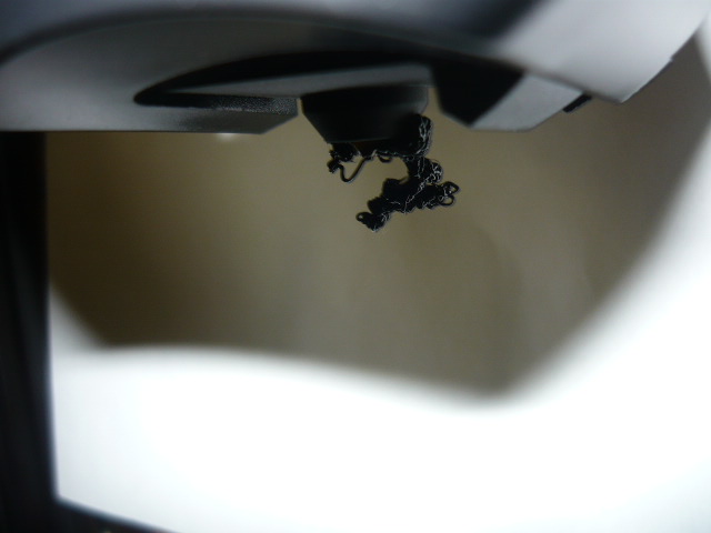

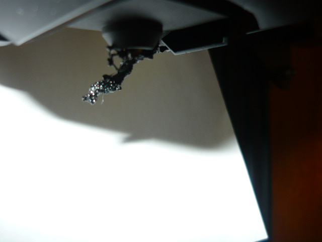

Posted: Fri Oct 15, 2021 12:20 am
by GAP
As requested a few pictures of the nozzle with the PLA build up.
This is after about 5 passes after the start of the print. there was nothing on the plate except for one pass down the side.
Out of over 20 attempts I have managed to print 3 items successfully so lack repeatability is a major issue here.
This is another attempt it started out as a brim then curled up and tangled the nozzle

Posted: Fri Oct 15, 2021 6:14 am
Looking at the split on the LH side of the leg of the T on the last picture made me wonder about the print speed you are using? If it is too fast, particularly on the first layer, it may not have time to 'stick' either to the bed or itself?
My software suggests a default speed of 50mm/sec but I find 60mm/sec seems to work well.
