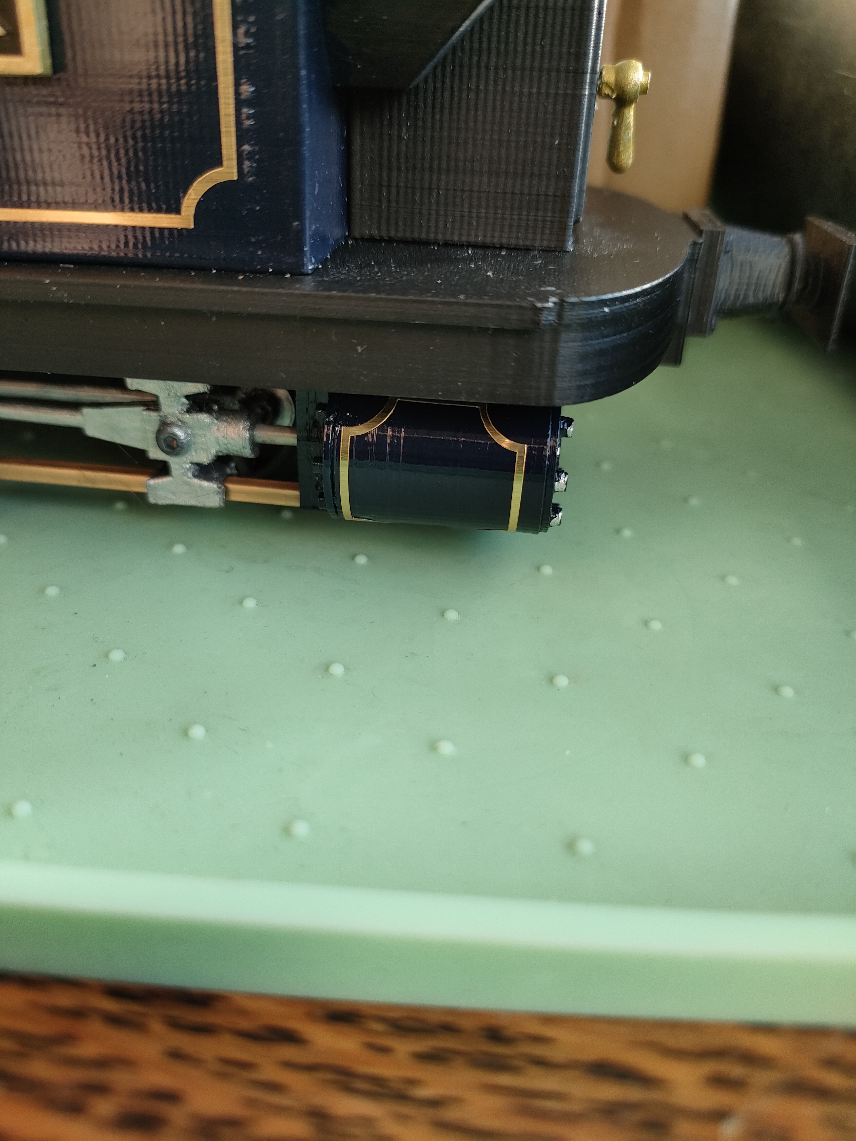

Yes, it can cut any shape that can be designed in CAD. I can cut down to about 0.5mm lines, but they are a little difficult to put on things and to "weed" (pick out the bits you don't want)
-steves-
Posts: 2473
Re: Mountaineer
Post by -steves- » Thu Feb 24, 2022 4:05 pm
Ok, I think I have gone too far now, these lines are 0.75mm wide, I agree, the design us a little long, I will know for next time.

That looks Ok to me Steve, but am I correct in thinking this would only really work for one-colour lining? I realise that in theory you could cut say, a white line and two matching outer black lines, but I can't imagine even trying to get them all lined up!
-steves-
Posts: 2473
Re: Mountaineer
Post by -steves- » Thu Feb 24, 2022 7:00 pm
philipy wrote: Thu Feb 24, 2022 6:09 pm That looks Ok to me Steve, but am I correct in thinking this would only really work for one-colour lining? I realise that in theory you could cut say, a white line and two matching outer black lines, but I can't imagine even trying to get them all lined up!
Yes and no. It's far easier to do single colour lines that's for sure. If you wanted say a red line next to a white line, you could CAD them up next to each other to ensure correct sizing, then separate them for printing, then put them on the same transfer tape (with very careful positioning) and put them on the model as one. That is one of the things my wife wants to try next. :thumbup:
If you wanted a gold line with a black line inside it, again, same theory, but just put the black line on a wider gold line and on the transfer tape. again, goes on the model as one. :thumbup:
