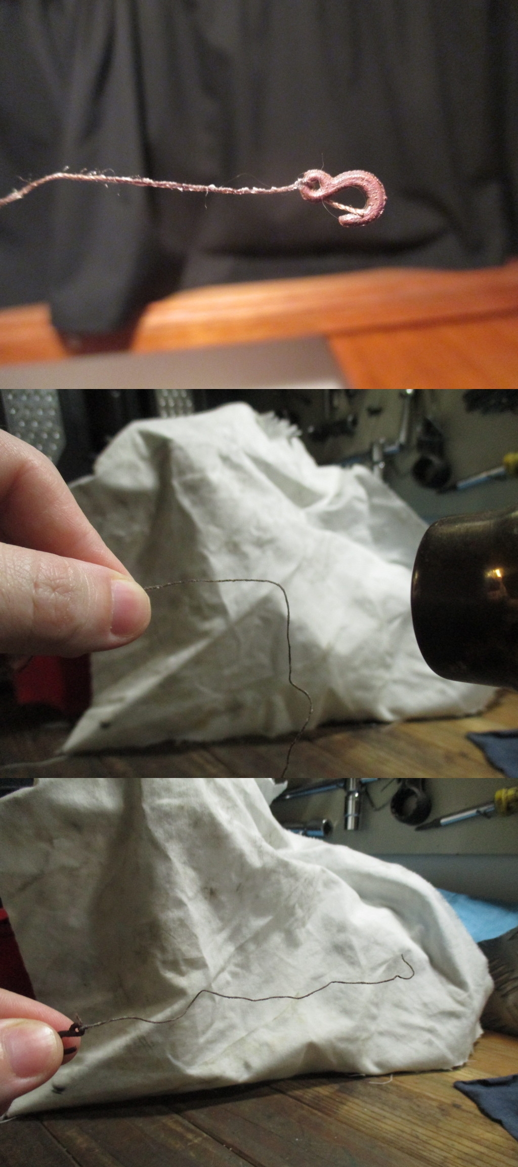

Mills lashed the cane onto the trucks with either cable or chain. Kinda stumbled bottom-backwards into getting a great result, here. Experimentation paid off..
Coarse thread was cut to 7½" lengths (next batch will have 8½") and tied onto Binnie hooks - which were prepped and painted to match the rest of the metalwork. They're a little big for this job, but they work well with the split pins I'm using for anchor points.
Superglue was soaked into the thread to stiffen it up, but the fuzziness remained. This was burned off with a heat gun. (candle was too intense and focused, just burns the thread) The heat gun had an interesting effect in that it melted the superglue, allowing the thread to droop under it's own weight.
This drooping and re-solidifying effect made for a very convincing beat-up old cable, which is still flexible enough to wrap around things.

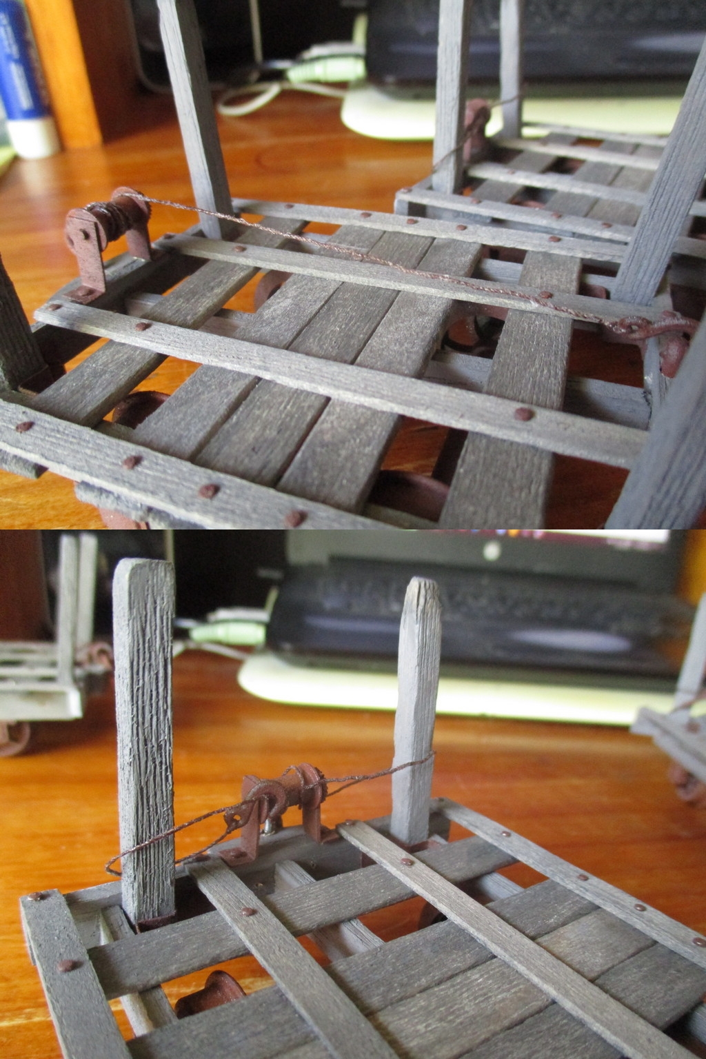

An 0.8mm hole was drilled in each winch barrel, and the "cable" superglued into place with a fine-tipped applicator. A couple of cables were made to look neatly reset after unloading, but most were just more-or-less secured by wrapping around a stanchion or two, as there's no time for tidy when unloading.
Trucks must be unloaded quickly to keep the mill fed, any patch-ups made in the truck shop, then returned to the empty yard ASAP for re-deployment to the fields.

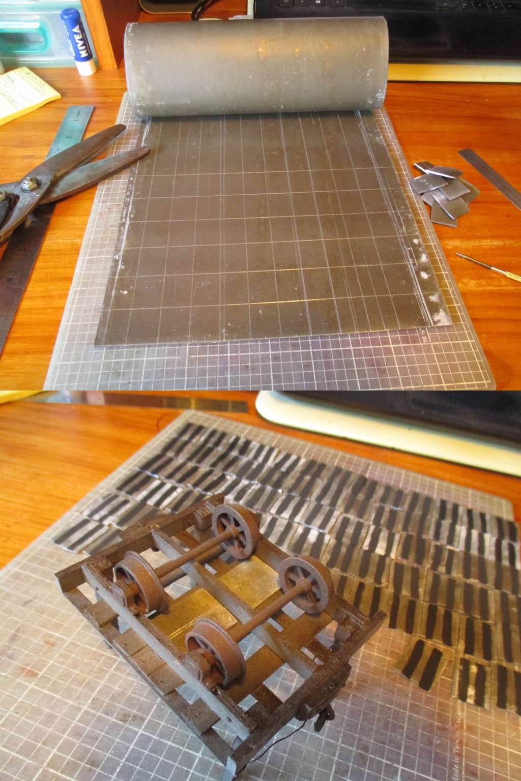

The trucks at this stage weigh 40g, which although I've not tested them, I feel is a bit too light. Full-size wholestick trucks are very light and prone to derailment at the best of times, particularly when being pushed around curves. As I'd like to pull long rakes, I don't want these too heavy, so only 15g of lead flashing was added.
Pre-painted the pieces where they might be seen through any gaps in the planks - another lesson learned from mistakes in my early trucks, many years back.
Conversely, those old trucks were weighted to 270g each,
to allow them to negotiate a terrible S-bend imposed by a tree on my first garden line.

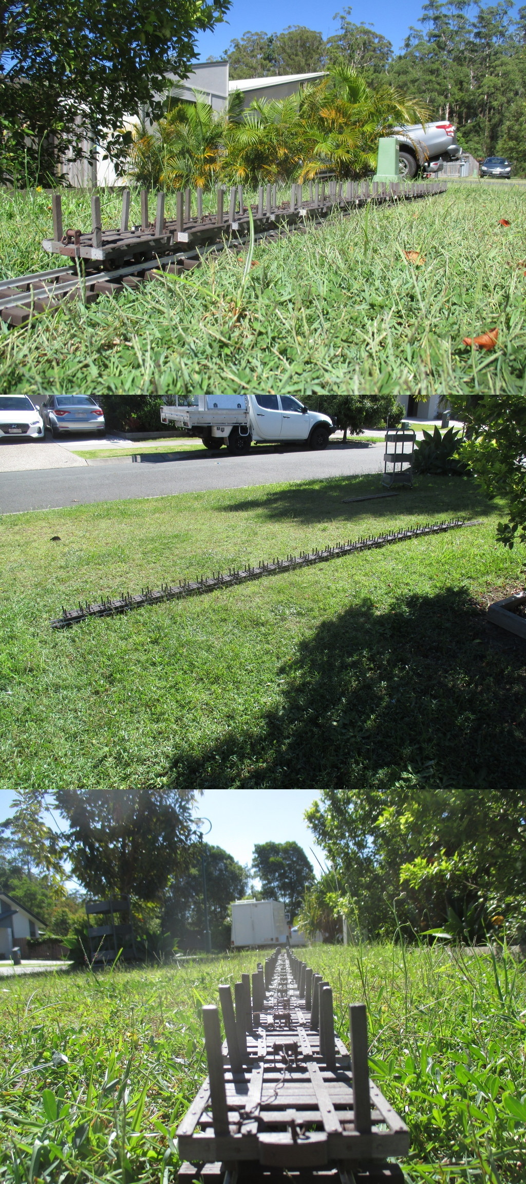

Apologies for the very poor lighting in this ex-works shot - who'd have thought that pulling up most of your garden line and replacing it with a carport would make ex-works shots difficult to do?
Had to plonk 4m of track on the front lawn for these shots.
I'm extremely happy with how the rake has turned out, and am looking forward to hanging them behind one of my Fowlers. Even more-so to having four times as many trucks - but that's a job for future Aaron,

Just a word of caution though, seriously, you need to be very careful with heating the superglue on the cables, heated superglue is nasty and gives off cyanide gas.

Thanks again, good to know about the superglue. Lucky I had the garage door open to keep the heat gun from cooking me.

If you want to defuzz cord, when I went through a ship modelling phase many years ago I found rubbing yellow wood glue into the cord used for model ship rigging would glue down any standing fibres. I never found the need to burn off any remaining fuzz.
My method was to cut a length of cord, clamp one end, tension it with one hand and run a bead of glue along it. Then run a thumb and forefinger along the cord to rub in the glue and press down any loose fibres.
The wood glue doesn't dry instantly like CA, so it can be draped in position before it dries. I found it was it easy to coil it up and drape it over belaying pins, but if it was hung with a weight on it, it dried dead straight and didn't need excessive tension to stay that way on a model.
I used the technique again recently when I was rigging the brake handles on one of the log bogie pairs.
