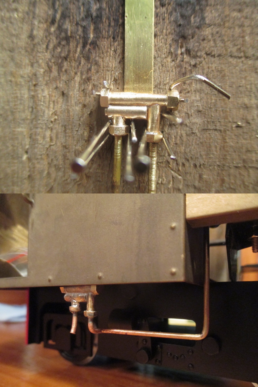

I'm guessing that any problems one might have making these small items, really comes down to soldering.
To go with the injector above, cutting the various pieces of K&S tube should be fairly straight forward ( I use a jewellers piecing saw, an aquired taste! ) Filing the "U" shapes to fit, always working on a length of tube before cutting off (easier to hold). I have several pieces of small steel hex bar that are tapped which allow me to insert small brass turnings, and by setting the hex on the grinder rest I can grind any size hex I want by eye ( I hate wasting proper nuts when not actually required, just me I guess).
It then comes down to soldering the bits together. I have to say I find soldering easy and very satisfying. The flux I use is pictured below, it's the consistency of water and of course is acid. I imagine it to be nothing special and that equivalent brands are available. Basically where ever it goes solder will follow once the metal is brought up to heat. I use and adjustable electric iron on small items, and electronic resin cored solder(about 1mm diam.).
So then holding it all together! the un-glazed back of an old bathroom tile is my favoured "hearth", I assembled the pieces in place, then touch the areas with the flux on a brush, which of course may move things around, but gets the flux onto mating surfaces. Using the iron pushing down GENTLY on one large piece brings things up to heat, then a gentle touch with the solder runs the solder in. Tweezers can bring errant parts together again, but I feel the secret is holding one larger part to the table with the iron an assembling the others around it. As usual cleanliness is key with soldering though I don't clean anything, just find the flux sufficient, using old or second hand brass would be a different matter.
Good luck, hope this helps.

The injector is SOFT soldered together in one go, using the tiniest amount of solder. (actually too much in this case!). I silver solder most of my boat fittings as strength is generally a requirement.

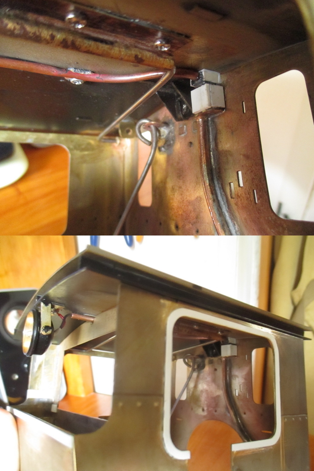

Darrell's fine work on his Eric build, was the push I needed to do better than my past shameful practice of gluing wires into cabs. This conduit isn't perfect, but close enough for a first go using tube bending coils. Wet rags were needed to protect the styrene overlays when soldering the conduit into place.
For connectors, wire was soldered to 1mm x 5mm magnets - themselves attached to a stack of larger, more powerful magnets, to reduce the de-magnetising effect of the soldering iron's heat. A second, undamaged small magnet was them glued to the soldered one with JB Weld. The wire was then fed down the tube, and the magnets JB Welded into a styrene box, to keep them electrically isolated from the cab structure.
I found the the roof support strut was a pain in the backside to use, so now was the time to fix that. It was shortened, and one of the larger magnets was glued into the front RH corner of the cab. This allows the hook to be swung into/out of place with a single movement and is now far quicker and easier to use.
Mating faces of the headlight bracket were cleaned to bare metal before assembly, and the positive wire soldered to the bracket. Another conduit/magnet connector was made for the negative wire.
Bench tested successfully, and I think this cab is ready for priming..

Injectors were made over two days, and I'm surprised to say they came out very well. The parts were a bit fiddly to prod into place, but sewing pins came in handy once again, holding the parts against the plank. A quick blast with the mapp torch kept the pieces hot for a good few seconds, affording enough time to touch the soft solder where needed. A couple of pins got caught in the solder, but were easily removed.
Thanks for the advice and encouragement, probably wouldn't have been game to try that, otherwise.

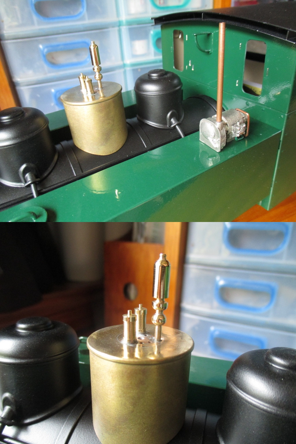

The whistle represents a standard Queensland Govt. Railways fitting - perhaps pilfered by a former QGR crewman upon leaving for the canefields, or simply found lying around at Bundaberg Foundry, whom were contracted to overhaul locos for QGR. Turned with mainly the parting tool and files, then polished before parting off.
The hole in the dome's top needed to be enlarged, then bored a little further. A plug was then made to fit, with 2mm holes for the dummy whistle and safety valves, along with several 0.9mm holes for steam to issue from the actual safety valve hidden within.
Generator was detailed in the usual way. The dummy safeties are just generic-looking things that resemble most canefield prototypes. The original whistle mount on the cab front was left alone as the prototypes usually were, when their whistles were re-located to the dome.

Lonsdaler wrote: Mon Mar 14, 2022 10:01 am that was one of the details that particularly impressed me.
And me! A lovely touch...
The whole loco's looking fantastic...
