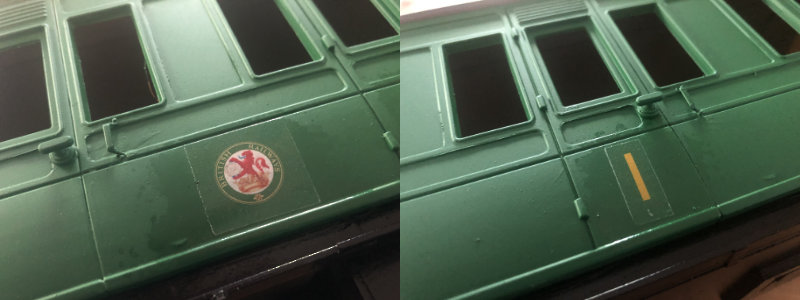

The first two coaches of the 2021 Modernisation Plan now have a couple of coats of Agreeable Green — malachite — possibly not accurate but then neither are the coaches.
I’ve read that the Southern and then the Southern Region often re-varnished older coaches, rather than repainting them, so a variety of greens could be seen well into the BR era. That’s my excuse. They’d probably be so grubby you wouldn’t be able to tell anyway.
DIY inkjet transfers (on white decal paper) can be a bit of a faff, as you need to match the background on which they’ll be applied. Middle picture shows varied Photoshop swatch samples, based on a scan of the painted background colour (plasticard off-cut, top picture, right), from my cheapo HP printer/scanner. ‘Scan 2’ (middle picture, far right) seemed a reasonable match.
Bottom pic shows the printed A5 ‘page’ of the required items, using the background green chosen. I’ll need to touch up all the white edges after application.
You can get decals with transparent backgrounds professionally printed to order, of course, but unfortunately they’re rather expensive.

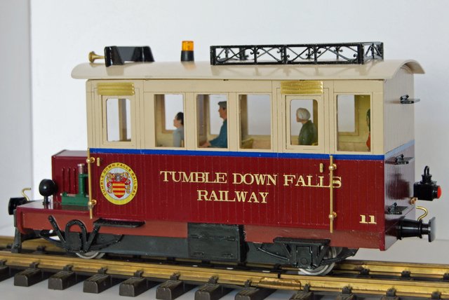

I use a guy in USA called Stan Cederleaf for my decals. Waterslide on a clear background, but due to his equipment it prints white. Provide your own design or have him design for you. At around $60.00 for a A4 sheet not cheap, but he will fill the sheet and they are very good. This is an example:

The splodgy mess around the transfers is a protective coat of Humbrol Clear I put on after they had dried. The following day I could paint over it as necessary. I suppose I should have printed them to the width of the panel and door
The decals / transfers worked out fine. Colour match wasn’t too bad and, of course, there were scruffy white edges but I hadn’t trimmed them too tightly and there was plenty of space to tidy up with a small paint brush.
With the whole coach then spray varnished, I think they look OK. But after all that, these livery details are quite small and restrained — outside, I don’t suppose they’ll be particularly noticeable (as you can see in the picture below).

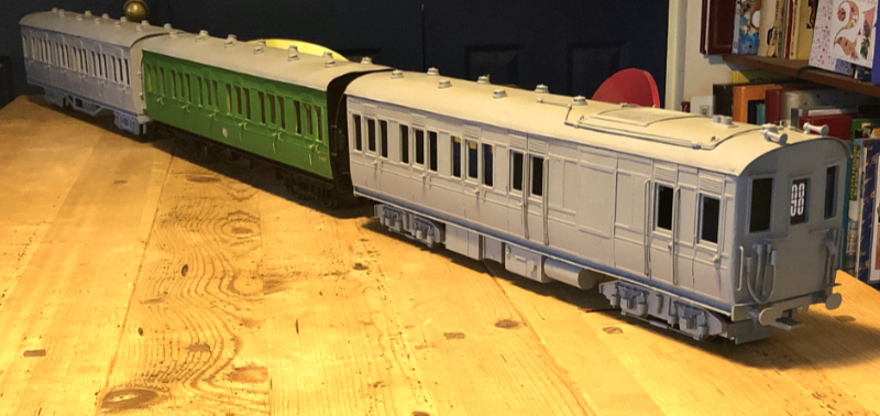

It’s been a while but two more coaches from the 2021 Modernisation Plan are almost ready for the paint shop.
Fun-scale, freelance Coach 3 (above, left) has a cab at one end, to be part of a new, tank engine powered, ‘push-pull’ set.
The cab design however, is not too different from Coach 4 (next to it and below) the even more freelance, proto-Thumper, early DEMU power car, so both can run together as a dodgy multiple unit, at least for now — possibly even with additional coaches between them (we just won’t pay too much attention to the ‘wrong’ end).
Sadly, the G-bits site no longer appears to be functioning, so the power car has two motor blocks from Ince Loco Works, found online. I hope they’ll be able to cope with the coaches, which are fairly hefty. Control will be either Deltang or Loco Remote, I don’t know which right now.
There’s still 52 quadruple (back-to-back) and double seat units to complete for the four coaches — and the passengers haven’t even made it out of the box yet. There’s also a plan, kind of, to print appropriate seat moquettes as DIY decals… we’ll see.
And for those not familiar with them, ‘Thumper’ became the popular name for first generation, late 1950s, BR Southern Region, diesel-electric multiple units, as a consequence of the immensely satisfying racket made by their low-revving, 4-cylinder English Electric diesels. I thought I might experiment with placing one of those Bluetooth speakers (that deliver lots of ‘enhanced’ or ‘extra’ bass) inside the ‘engine compartment’, to play heavy Thumper audio when it, eventually, trundles about. It’ll freak out the cat, though.
It’s quite long
Even longer! (Four won’t fit on the table)
Not too sure about that typeface for the numbers. Might have to look at that again. A bit of tidying up to do too (spot the shirt button).
