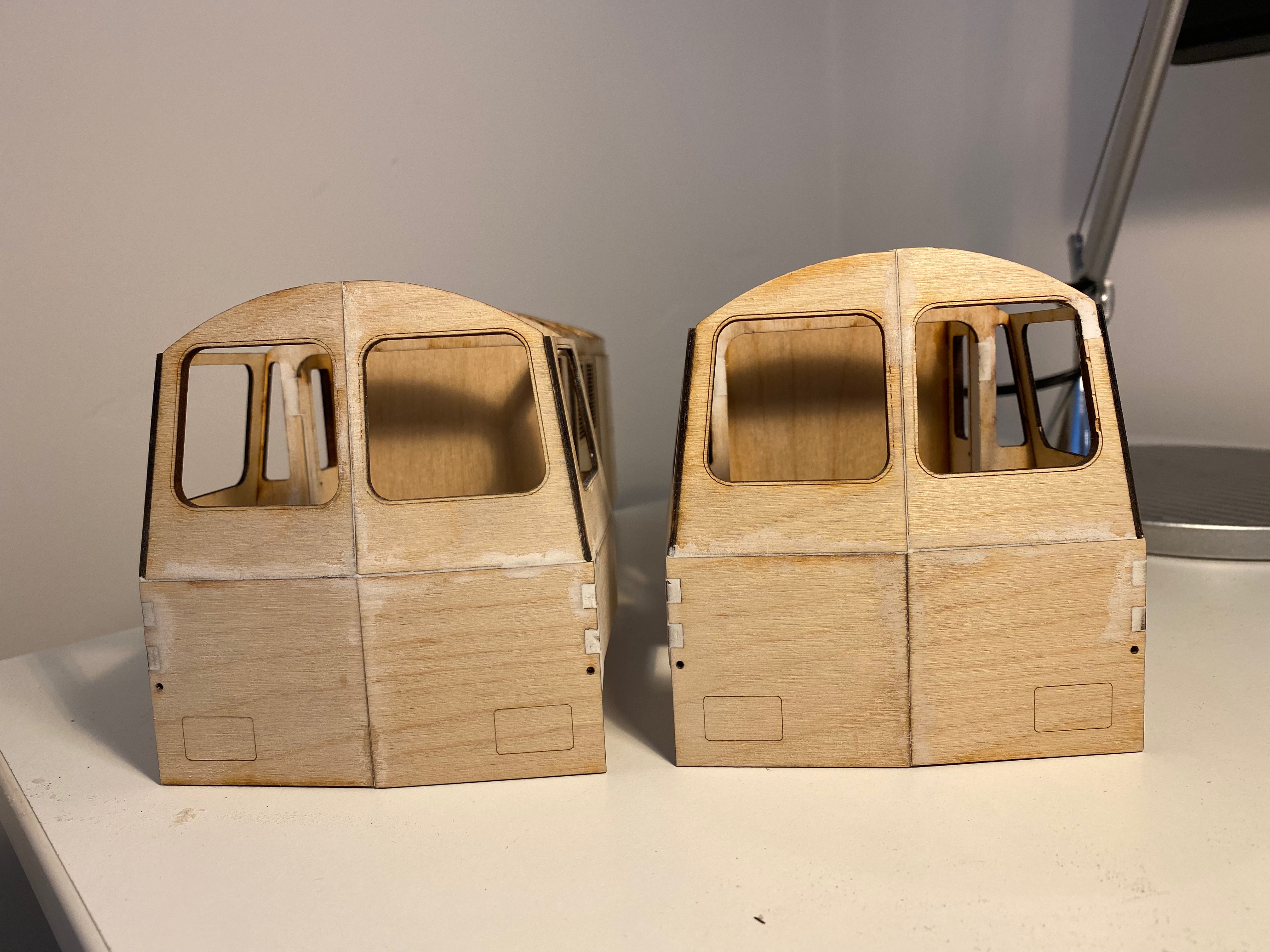

A chamfer needs to be created on many of the cab pieces to achieve the desired angle of the front. I think I've made a satisfactory job of putting this together and I'll use filler to hide the gaps..
Speaking of filler here are the two cab fronts after some filler and a light sanding. I think I'll probably give the entire locomotive a coat of primer and then touch up any gaps as required.

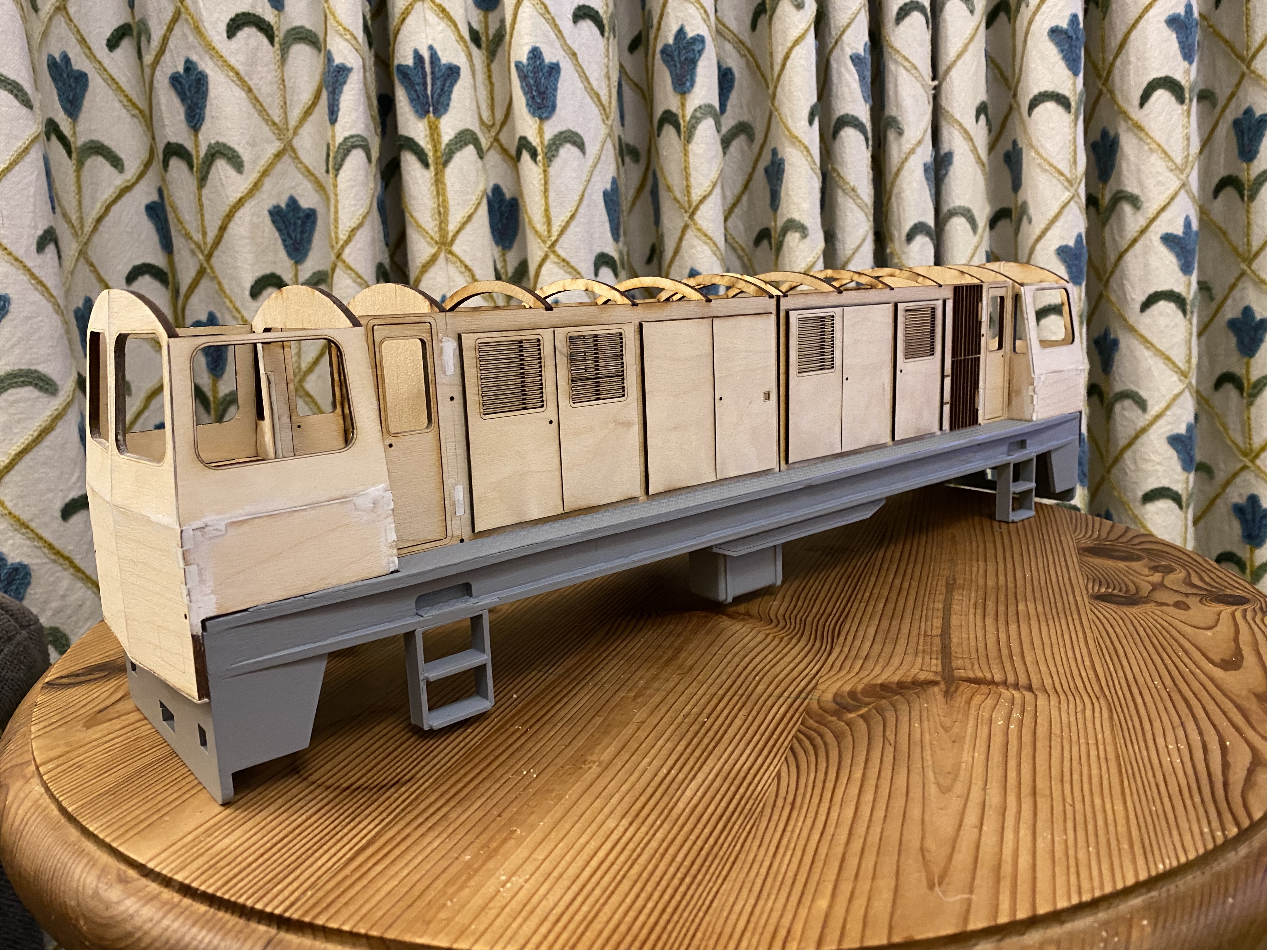

I've now fitted the side panels to the locomotive. It's starting to really come together. The main chassis has been lightly sanded. I've tidied up the 3D printed parts with some model filler so they can now be attached. Currently pondering whether to fit the roof before the primer goes on, I figure it might be easier to access without the roof in-place.

georgesheppard wrote: Mon May 03, 2021 3:12 pmI've now fitted the side panels to the locomotive.
Something odd with those doors. The two with vents at the right hand end should be in positions 5 and 6, not 5 and 7.
The little vent on door 4 is for the exhaust from the cab heater.
The two sides are not mirror images of each other.

TonyW wrote: Mon May 03, 2021 4:14 pm
It seems this is incorrect in the kit unless I’m missing something.

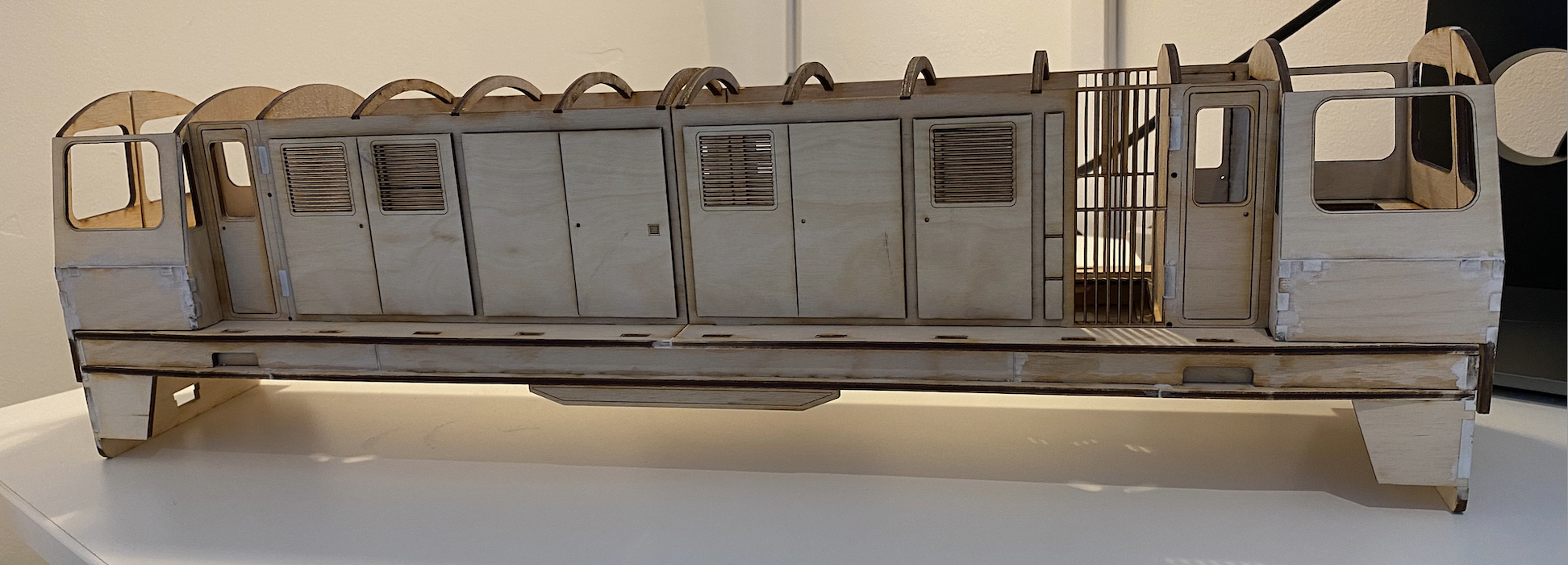

Side by side from the instructions
Side by side on photos.
The incorrect panels are a double and a single, if they weren’t firmly affixed by super glue I could probably cut the double panel in half and use the blank door in place of the door with the grill. I’m more concerned about damaging the panels than it being totally correct, so my model will have to keep the incorrect panel arrangement.

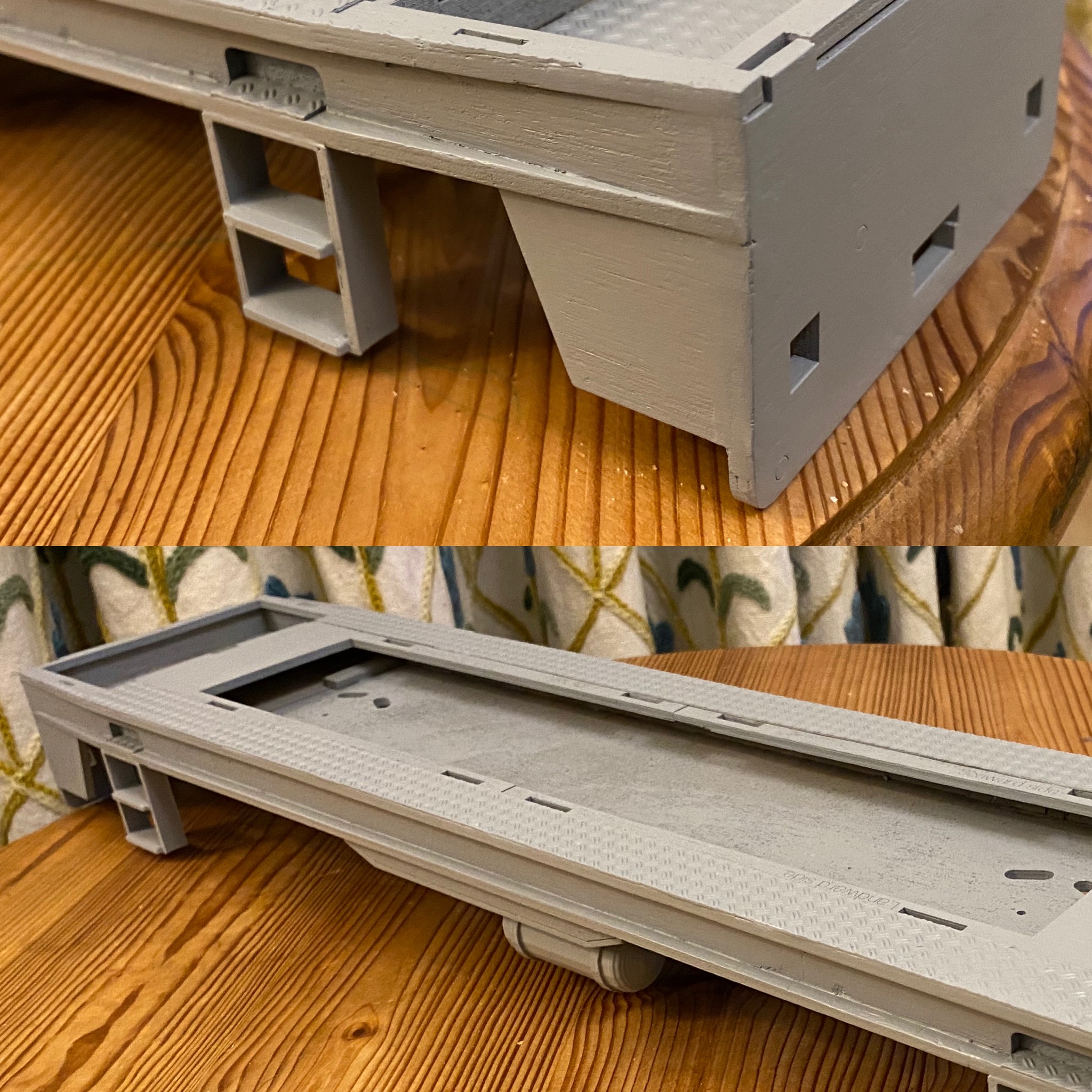

I managed to make a little more progress yesterday evening. I covered up some of the chassis joins with cross patterned plasticard. I don’t think this is accurate to the actual loco, further googling leads me to believe the pattern is straight lines.
I think it looks good though!

I did exactly the same with mine, and I think it looks good too!

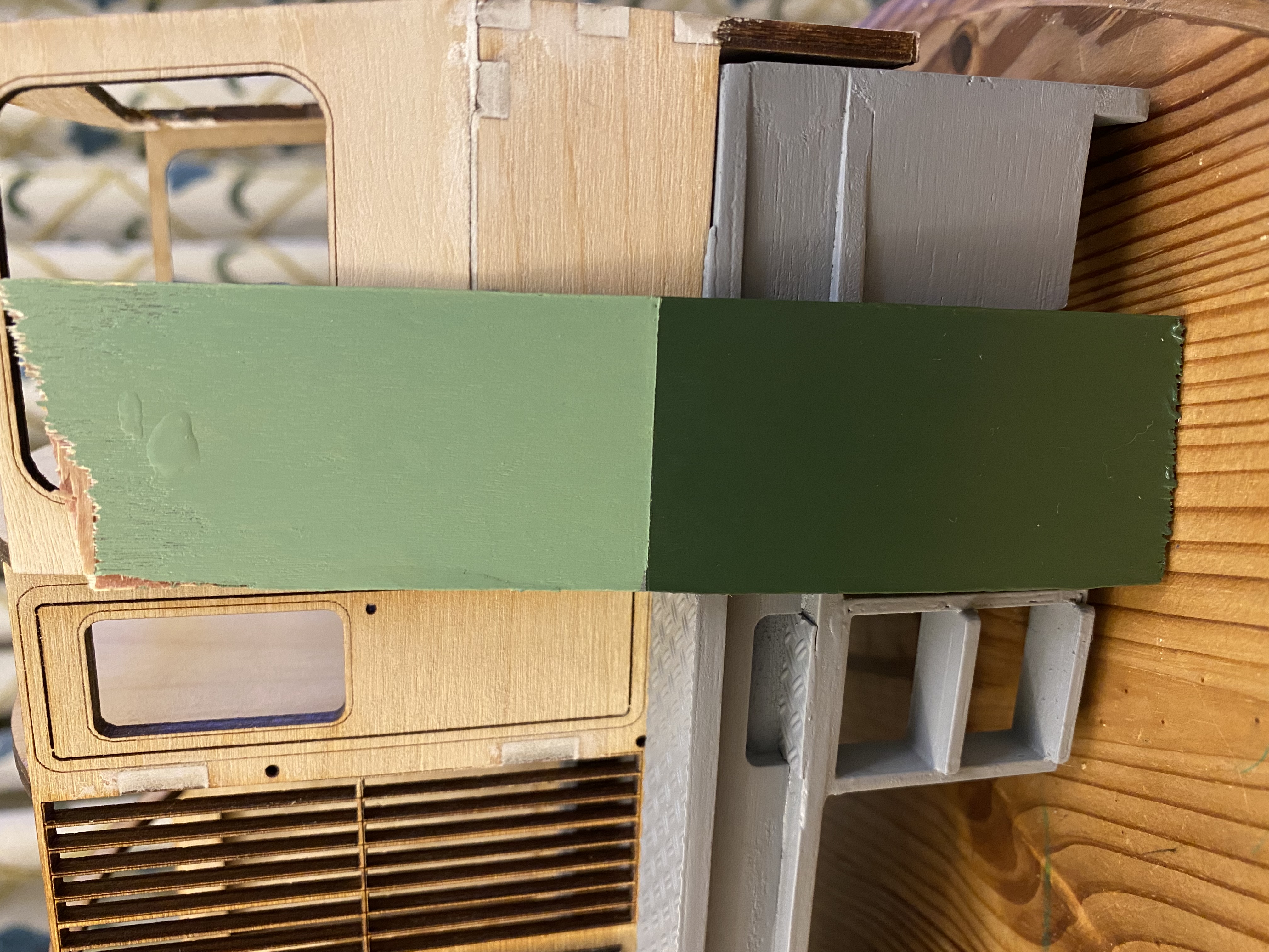

Thanks for the insight Max! I sprayed another piece of balsa-wood with the Vauxhall paints I purchased and I think the colour match is looking pretty good!
Photo of sprayed paint on the left, railmatch online colours on the right.
Re: Yatton Models - Vale of Ffestiniog
Posted: Sun May 16, 2021 3:47 pm
by TonyW
georgesheppard wrote: Sun May 16, 2021 3:38 pm... I think the colour match is looking pretty good!
So do I.
