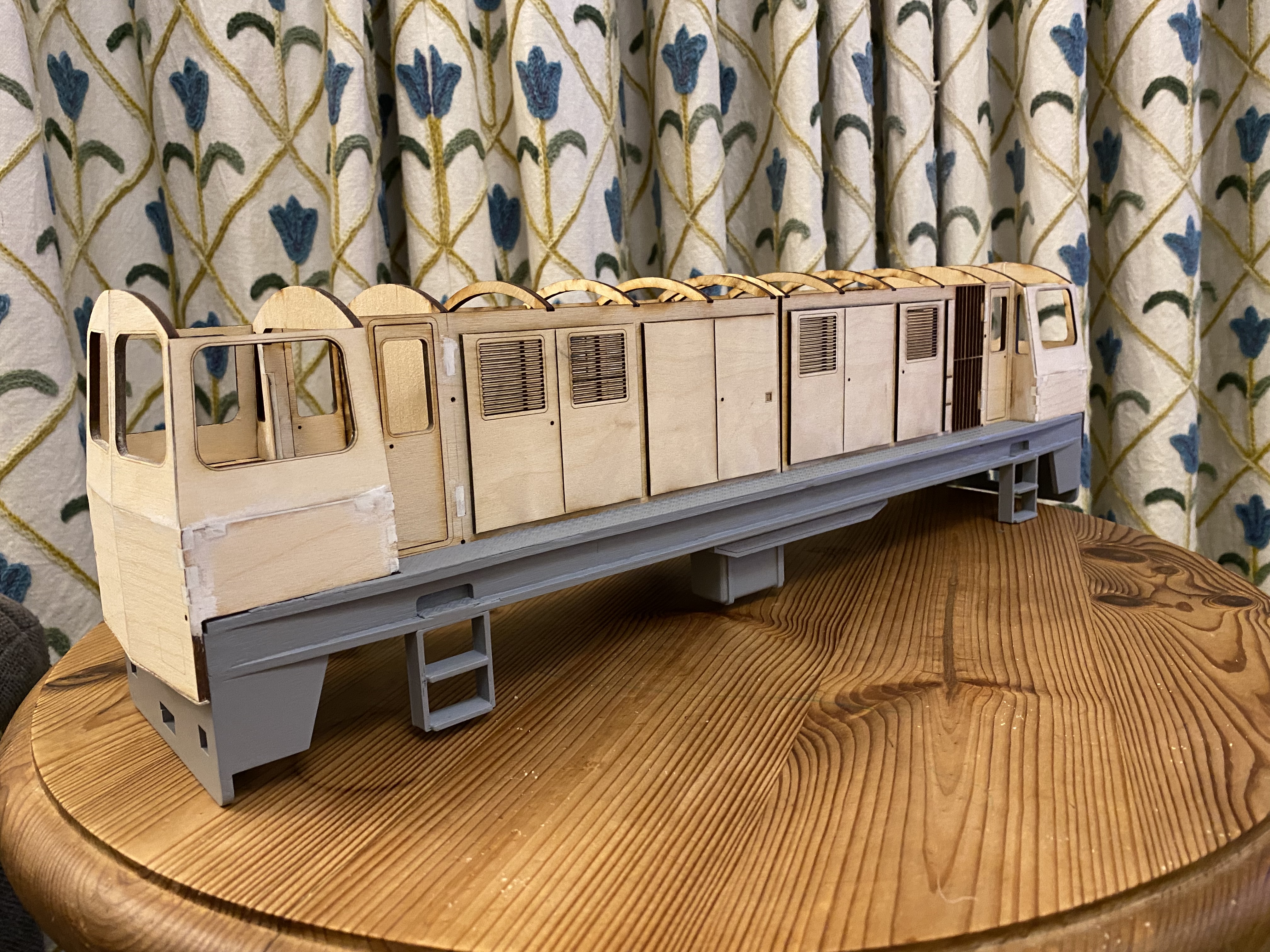

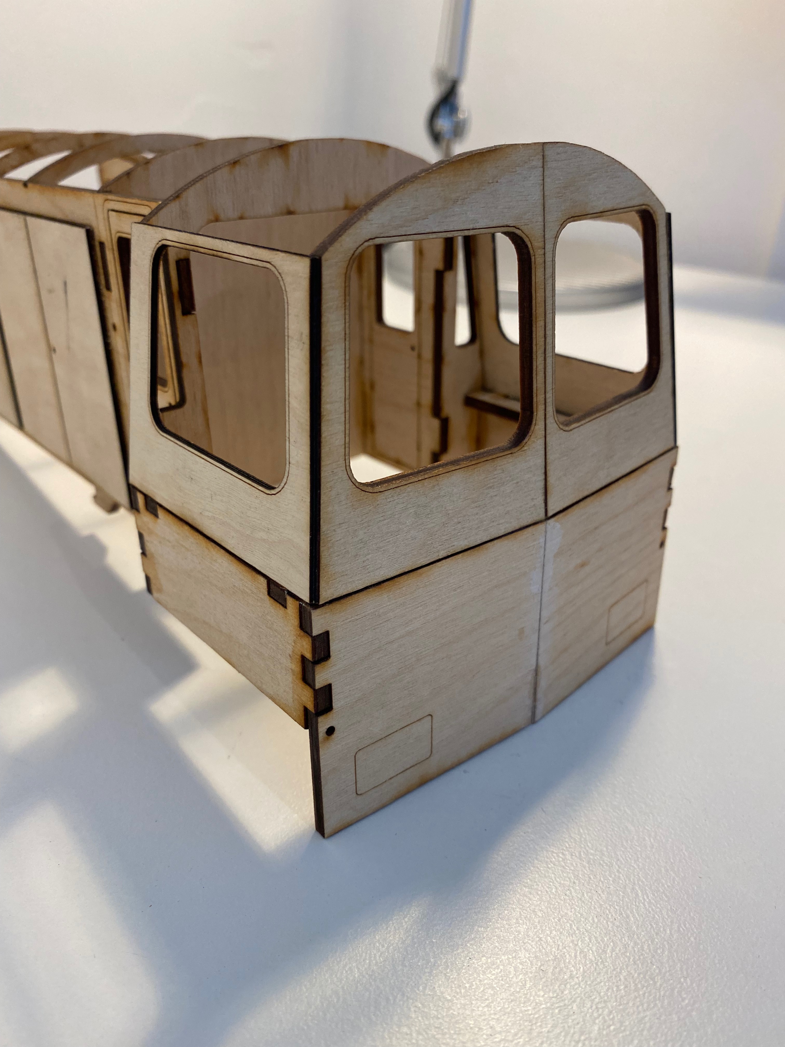

I must admit, the more I get into the build of this locomotive the more I'm enjoying putting the kit together. There are a few more annoyances (to me!) about the design of the kit but generally it goes together pretty well. I managed to get a good amount of time to work on this over the last couple of days. Both the cab ends are now constructed, filled and have had a first pass of sanding.
A chamfer needs to be created on many of the cab pieces to achieve the desired angle of the front. I think I've made a satisfactory job of putting this together and I'll use filler to hide the gaps..
Speaking of filler here are the two cab fronts after some filler and a light sanding. I think I'll probably give the entire locomotive a coat of primer and then touch up any gaps as required.

I've now fitted the side panels to the locomotive. It's starting to really come together. The main chassis has been lightly sanded. I've tidied up the 3D printed parts with some model filler so they can now be attached. Currently pondering whether to fit the roof before the primer goes on, I figure it might be easier to access without the roof in-place.

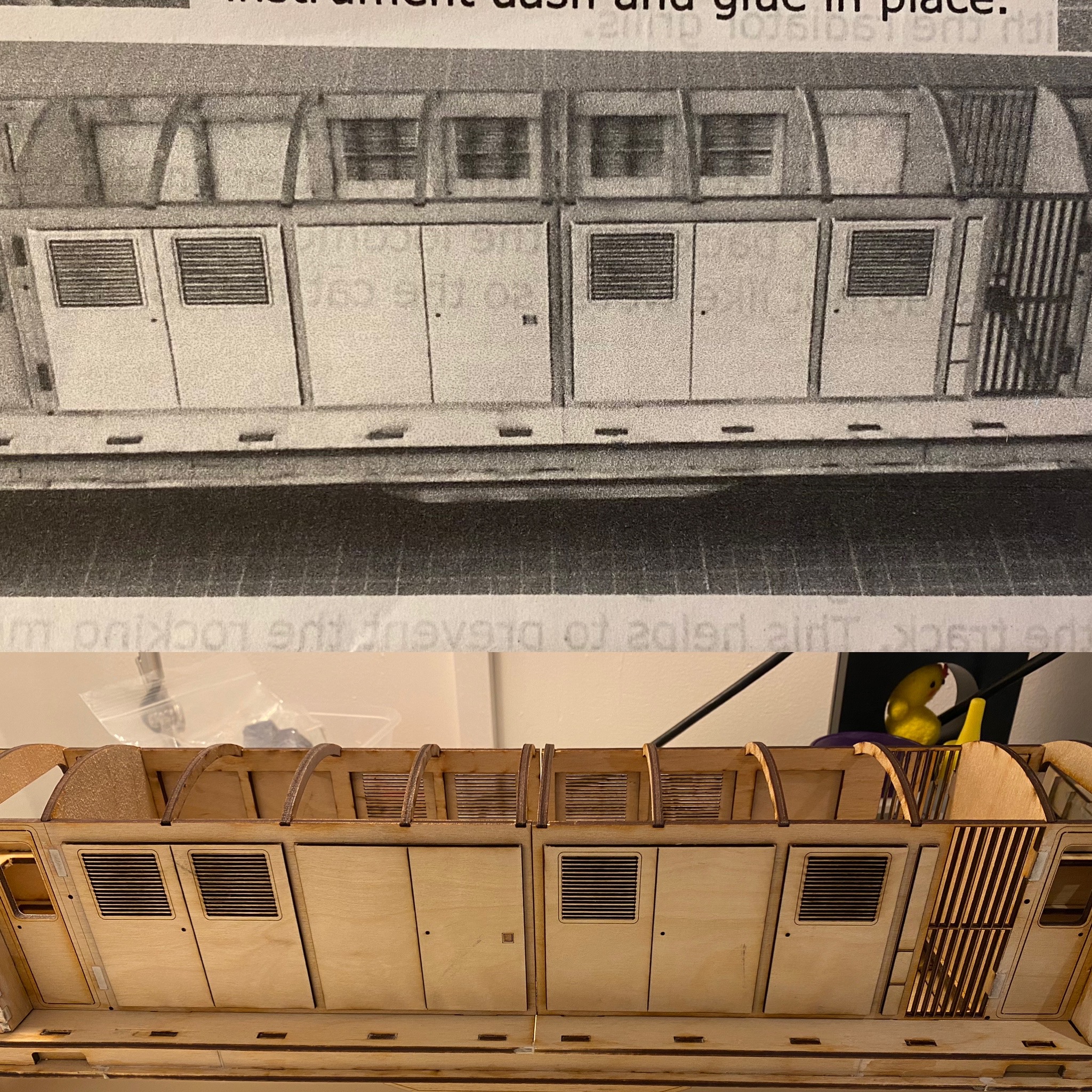

Something odd with those doors. The two with vents at the right hand end should be in positions 5 and 6, not 5 and 7.
The little vent on door 4 is for the exhaust from the cab heater.
The two sides are not mirror images of each other.

It seems this is incorrect in the kit unless I’m missing something.TonyW wrote: Mon May 03, 2021 4:14 pmSomething odd with those doors. The two with vents at the right hand end should be in positions 5 and 6, not 5 and 7.
Side by side from the instructions
Side by side on photos.
The incorrect panels are a double and a single, if they weren’t firmly affixed by super glue I could probably cut the double panel in half and use the blank door in place of the door with the grill. I’m more concerned about damaging the panels than it being totally correct, so my model will have to keep the incorrect panel arrangement.

The problem with a lot of mechanical subject matter that is modeled is that it evolves over time and its working life, sometimes in just minor details, sometimes in more radical ways.Take this loco in it's original form as Imported from SA, before it's evolution into a "Western" mini me we are more familiar with. It would seem to bare no relation to it's original guise now except they are both diesel locos with two bogies.
Researching subjects can be problematic. If you do not have access to the research material used in the development of this product you cannot be sure if at some point the doors were arranged as seen in the kit and not as seen in more widely accessible published pictures. Some research material can be misleading when seen in isolation. I'm sure the maker or the Ffestiniog railway can nail it for you. If not then somebody might have needed a visit to Specsavers. Max

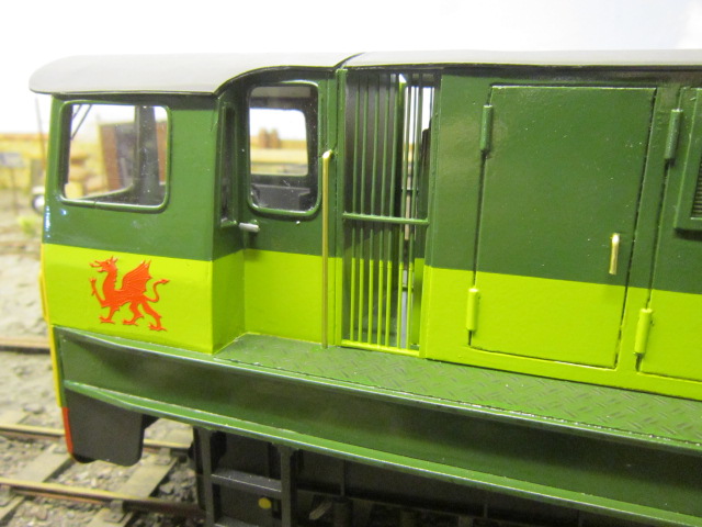

And then there was this:
The doors lift off their hinges and can easily be swapped around. Quite why somebody thought the fuel tank needed a vented door is a mystery to me.

Precisely my point. And it seems as the doors are configured in the model it appears, at least on that side of the loco. The other we can glimpse in the instruction sheet but does it match the other side of the loco as pictured at that point ? It can be a problem when the widely accepted published detailing/configuration of a prototype does not match the way it is depicted in a scale representation. As they say the devil is in the detail.TonyW wrote: Tue May 04, 2021 10:19 am And then there was this:
Trust me research can be a real nightmare when producing models of, for example, racing cars of any era. There, a specific subject could be altered in appearance not just between races but actual testing and practice sessions.......and your buyer is very well aware of all the variations and when and how they manifested themselves. So you have to be extra careful when verifying your research material and stating what and when you model offering is depicting. The model railway world is so much simpler. Max

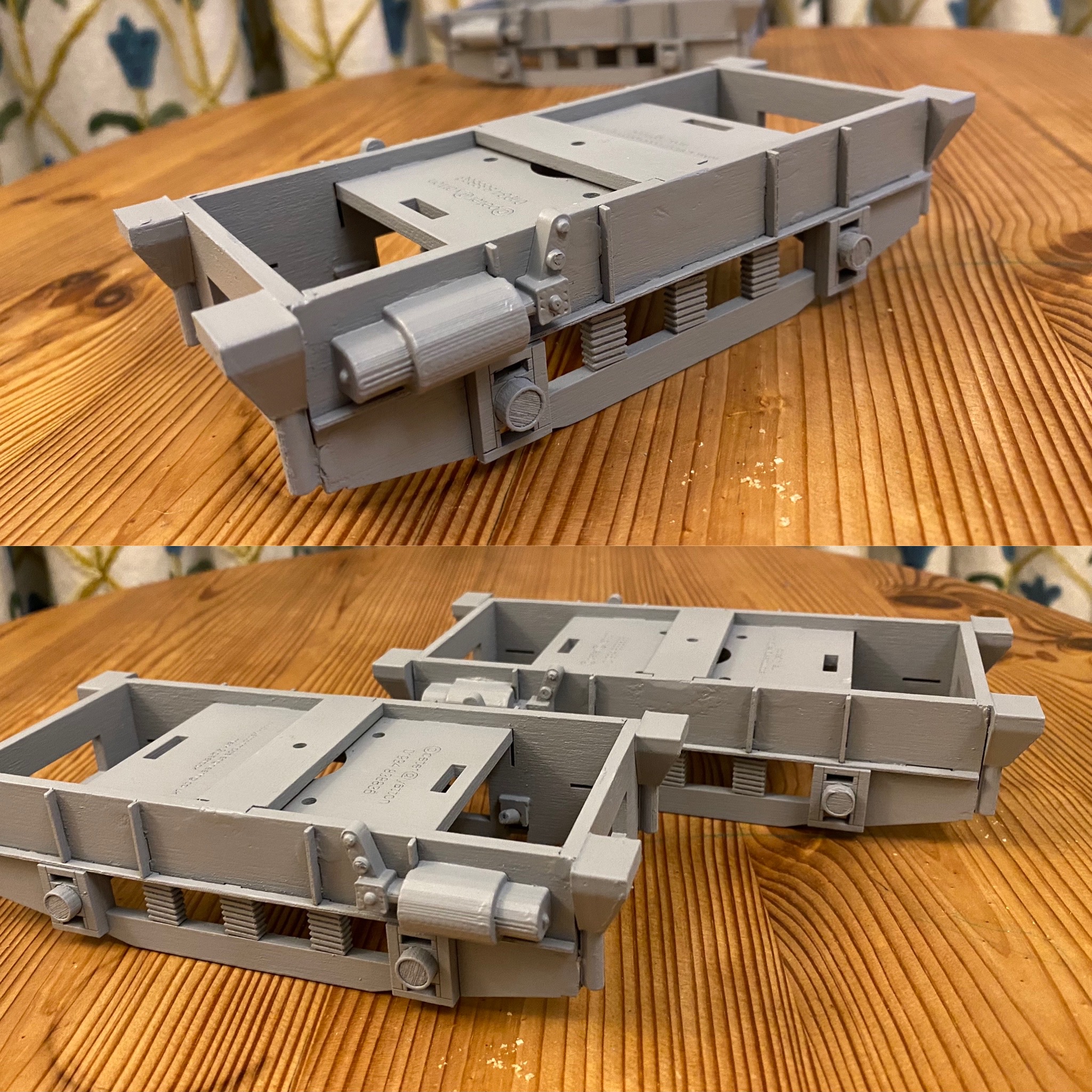

Today I found some time to get the bogies and chassis primed. After the first coat extensive additional filling was required. I’m quite happy with the finish now. I could tidy up further but I have to keep reminding myself no one will generally be looking at it only a few cm away!
