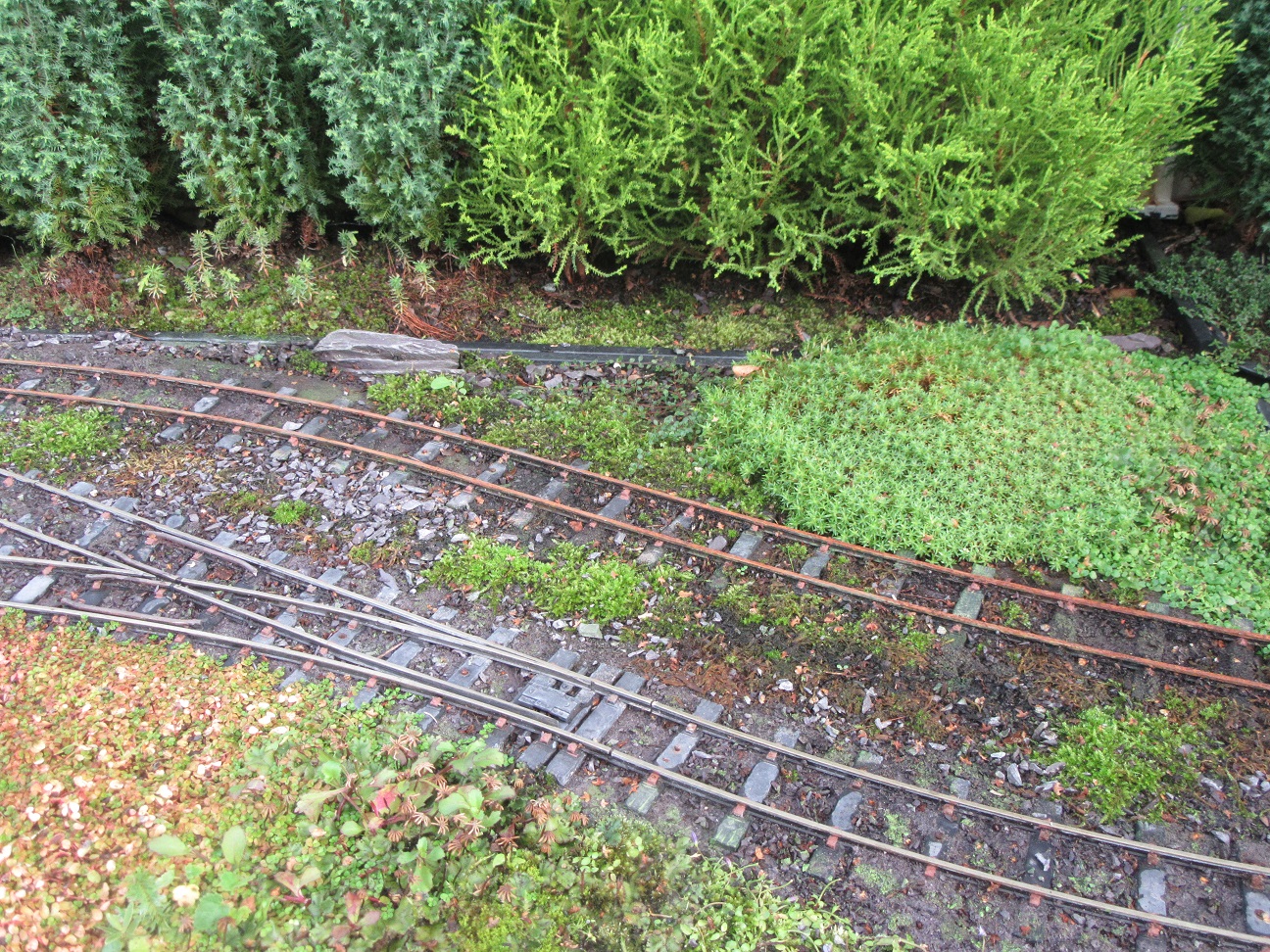

Here are a couple more photos of the vegetation

Impressive....

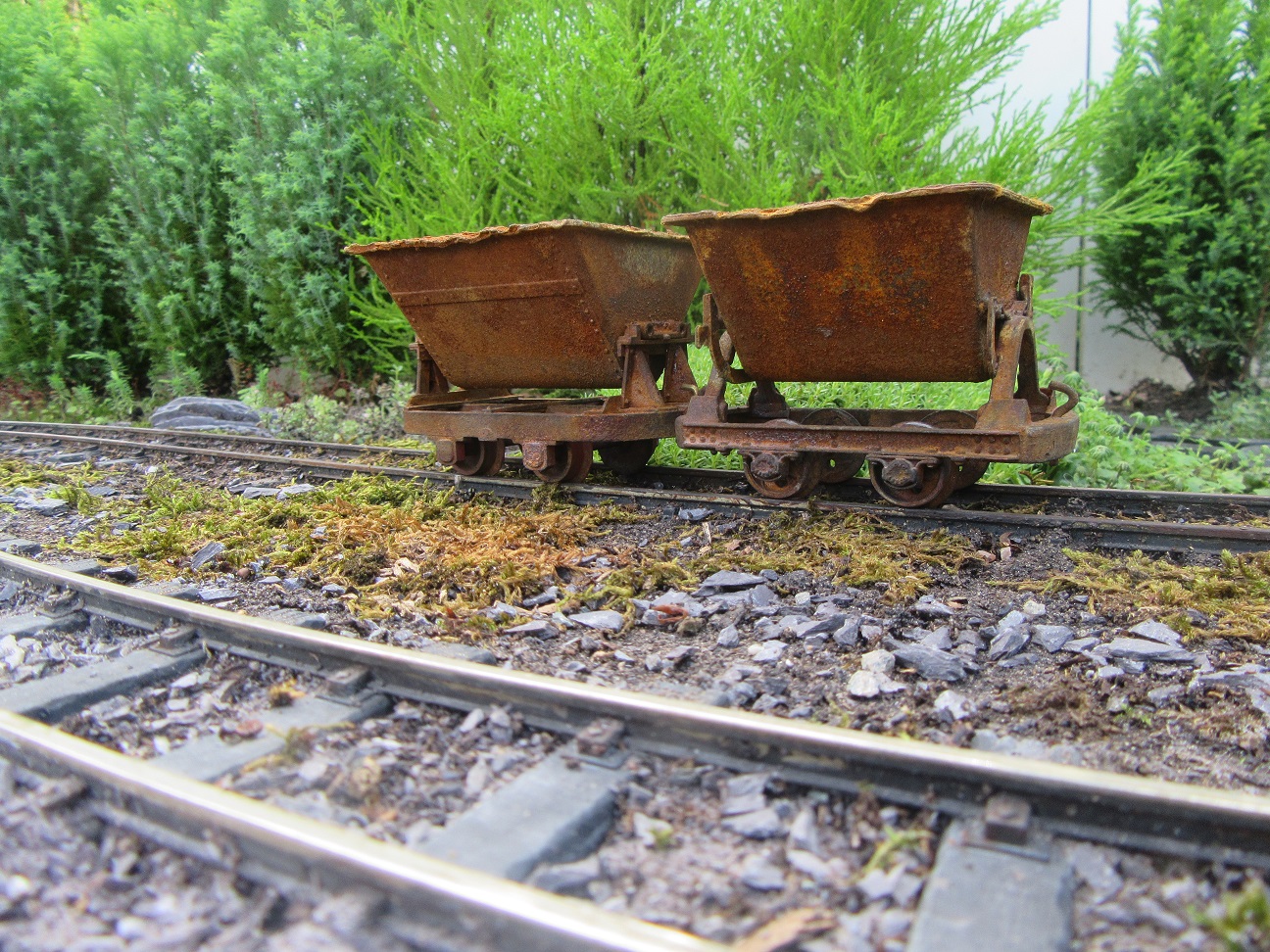

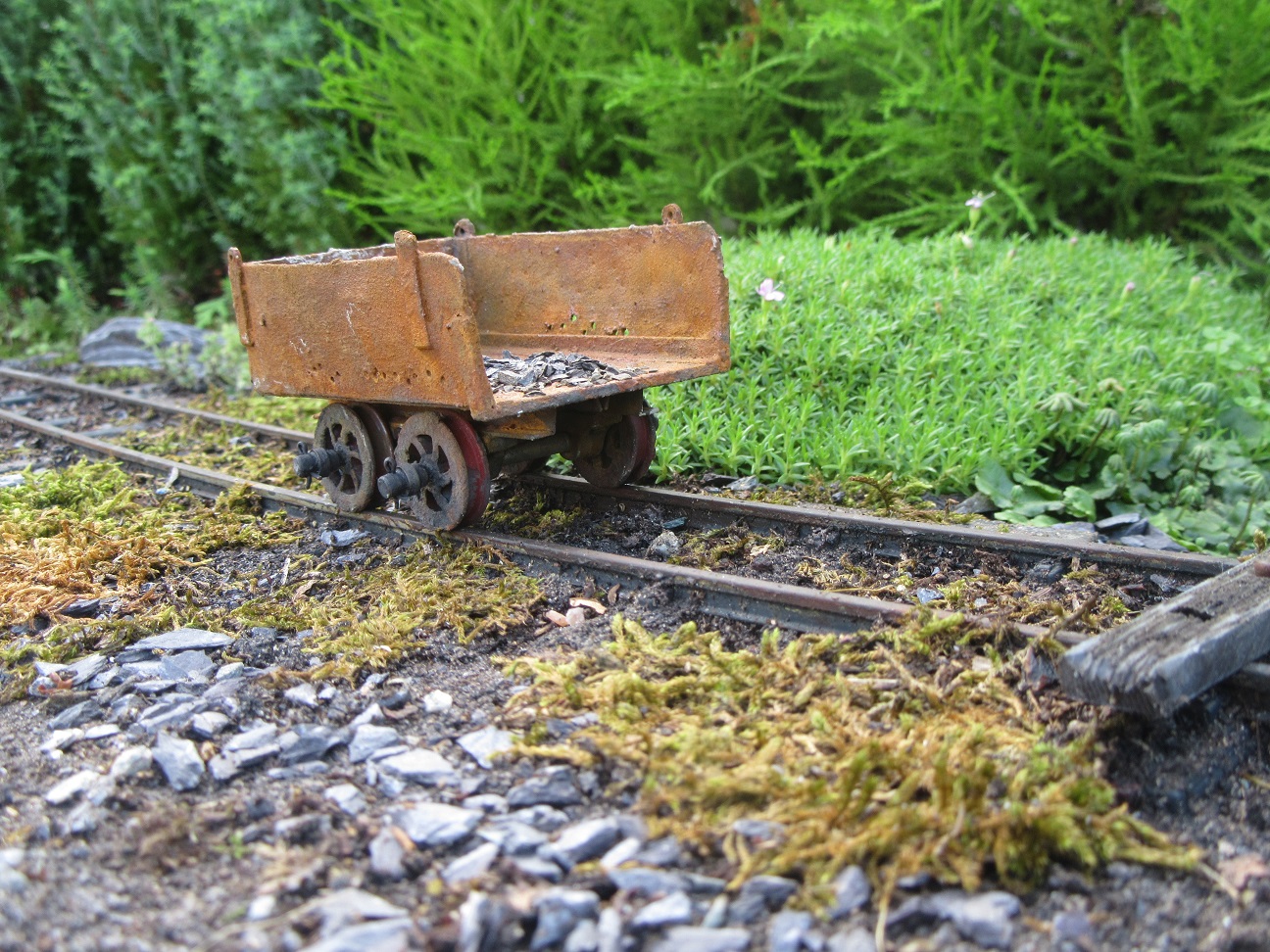

some more rusty wagons. Hard to believe these are plastic or shiny brass kits. I just love rust powder.

They are fantastically weathered. You just wouldn't believe they are plastic like you say, in fact I thought they were metal....

They really do look fantastic... I've got a trio of wagons rusting at the moment, but I've always stuggled to get that beautiful orange, ending up with a rather darker shade of rust.steveh99 wrote: Tue May 11, 2021 8:23 am Hard to believe these are plastic or shiny brass kits. I just love rust powder.
Love the plants too, especially those fern-like ones...

Thanks for the nice comments guys, I wanted to go for something different and didn't want to make another Hambleden or lose its scenic qualities.
I will run the live steam locos with their slomos so no high speed running involved, but also have a couple of RC battery locos to fit the Welsh slate scene, with slate wagons and Quarrymans coaches etc.
The orange rust effect comes from washing the rust powder with copper sulphate solution. This activates the rusting effect within hours rather than days. If it's too orange, I tone it down with dilute washes of matt black or dark brown. I often leave the stock outside in the rain which I think improves the overall rusty effect.
The pictures were taken during lockdown last year. The layout has fared well over the winter and I will try to take some updated photos very soon. The whole layout and plants are ageing well, spreading into one another, covering the baseboard joins and generally look much better than when first planted.
My three favourites are the Thyme which is very tough and spreads well: Arenaria Balearica which has tiny leaves, spreads well amongst the other plants and has masses of tiny white flowers, although these are a little overscale: Finally, various varieties of Leptinella which is what produces all the fern like leaves. There are many others which perhaps I will detail some other time.

Brilliant, thank you! I'll head down to my nearest Copper Sulphate vendor soon... I'm using vinegar to activate the powder, but it only seems to have a limited effect.steveh99 wrote: Tue May 11, 2021 6:13 pm The orange rust effect comes from washing the rust powder with copper sulphate solution. This activates the rusting effect within hours rather than days. If it's too orange, I tone it down with dilute washes of matt black or dark brown. I often leave the stock outside in the rain which I think improves the overall rusty effect.

I get mine from Amazon, you can get a large bag of crystals for about Β£6 I don't find vinegar acidic enough, although I am told drain unblocker works better.

I've successfully used Scenic Rust, but it's quite expensive. This is presumably a lot cheaper (and is probably what they use).Andrew wrote: Wed May 12, 2021 7:56 amBrilliant, thank you! I'll head down to my nearest Copper Sulphate vendor soon... I'm using vinegar to activate the powder, but it only seems to have a limited effect.steveh99 wrote: Tue May 11, 2021 6:13 pm The orange rust effect comes from washing the rust powder with copper sulphate solution. This activates the rusting effect within hours rather than days. If it's too orange, I tone it down with dilute washes of matt black or dark brown. I often leave the stock outside in the rain which I think improves the overall rusty effect.
