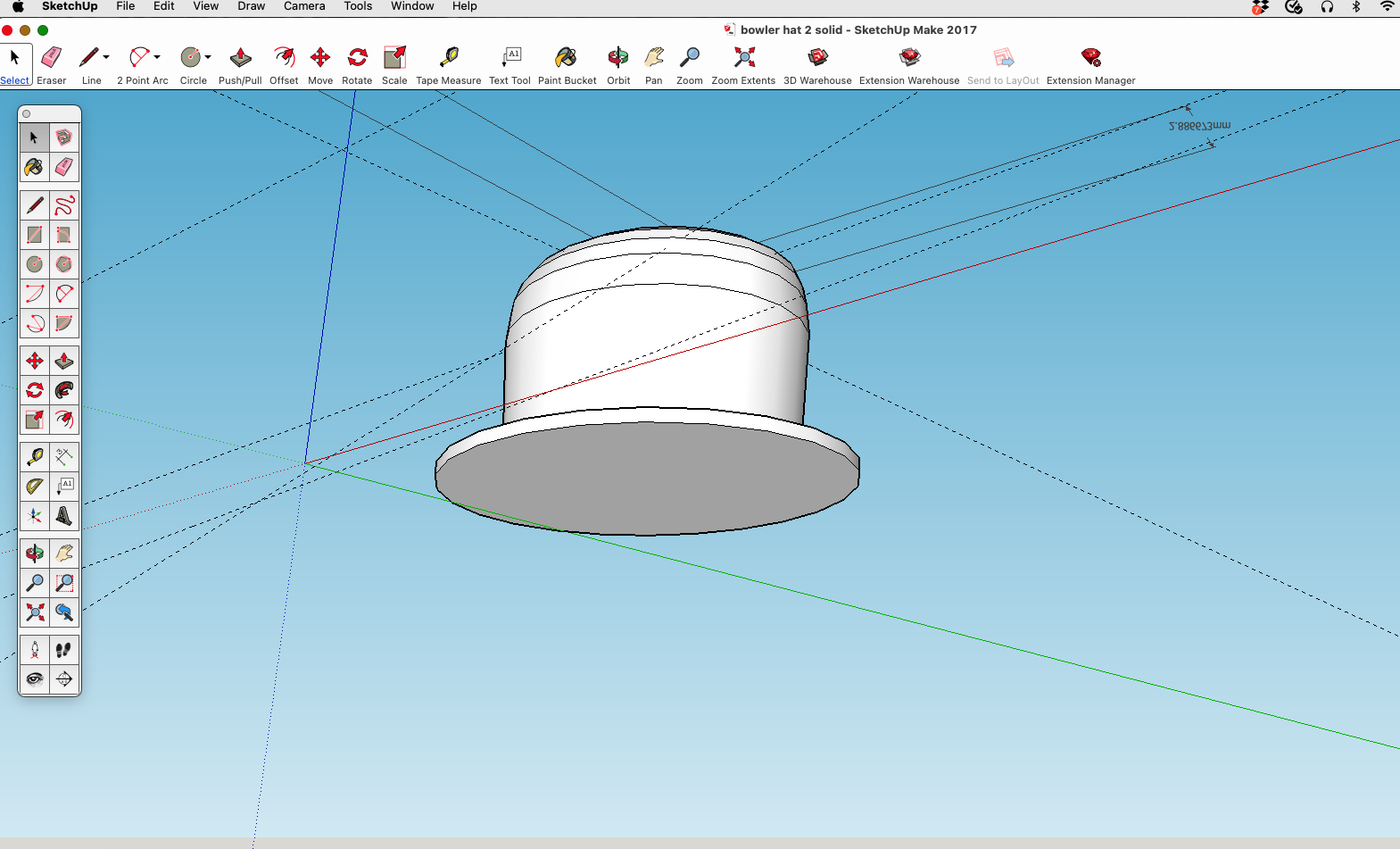

Firstly a solid bowler hat created in sketchup:

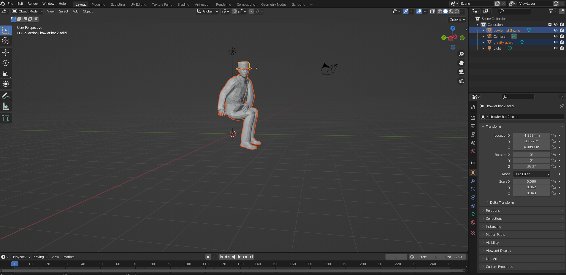

Now I have created a figure for my gravity slate train in MakeHuman, exported it,imported it into Blender and posed it. Then I imported the STL file for the hat. much scaling and moving has placed the hat into the correct place on his head:

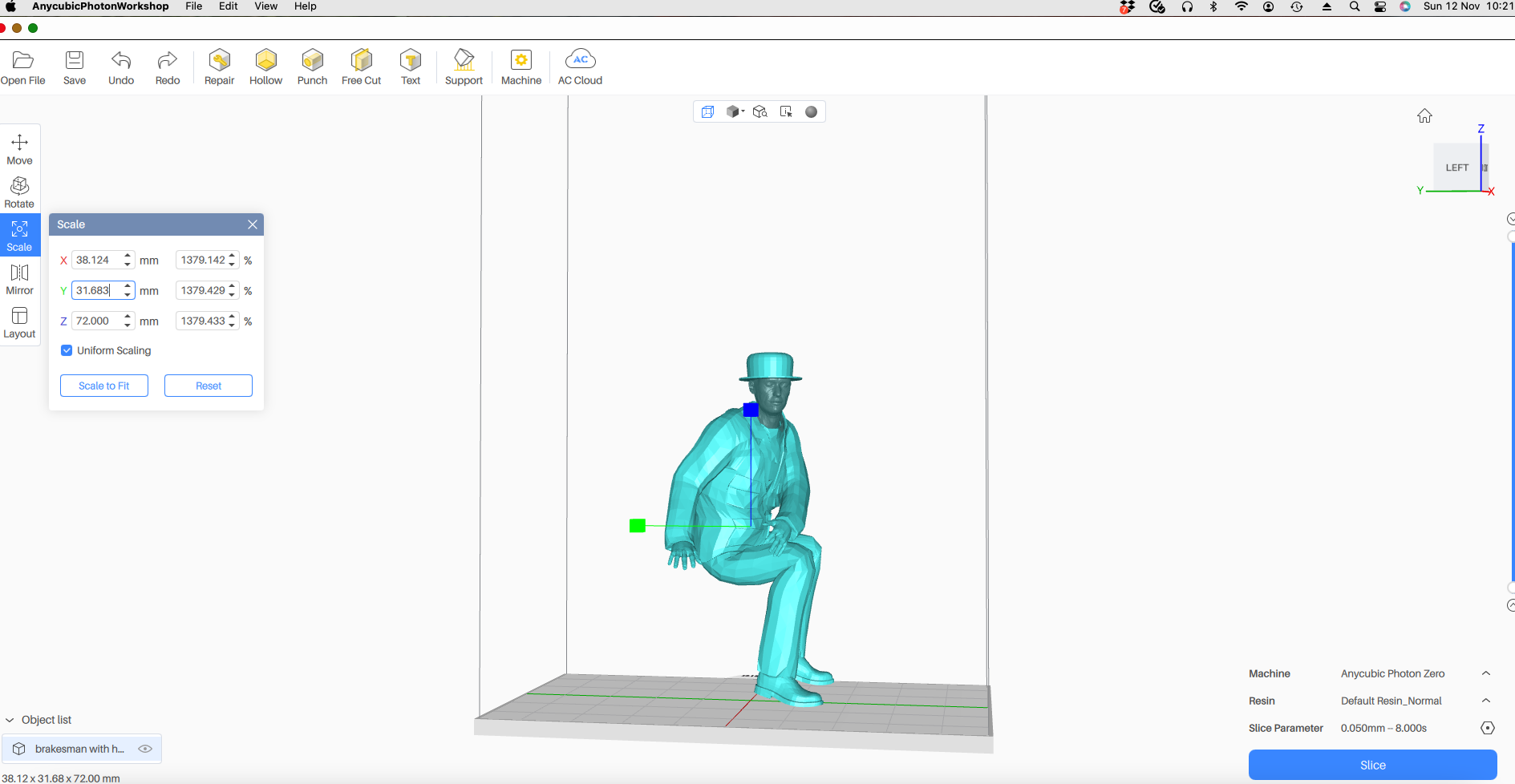

With both hat and figure selected I exported the stl file. I loaded the combined stl file into Anycubic's latest slicer. The slicer can repair stl files:

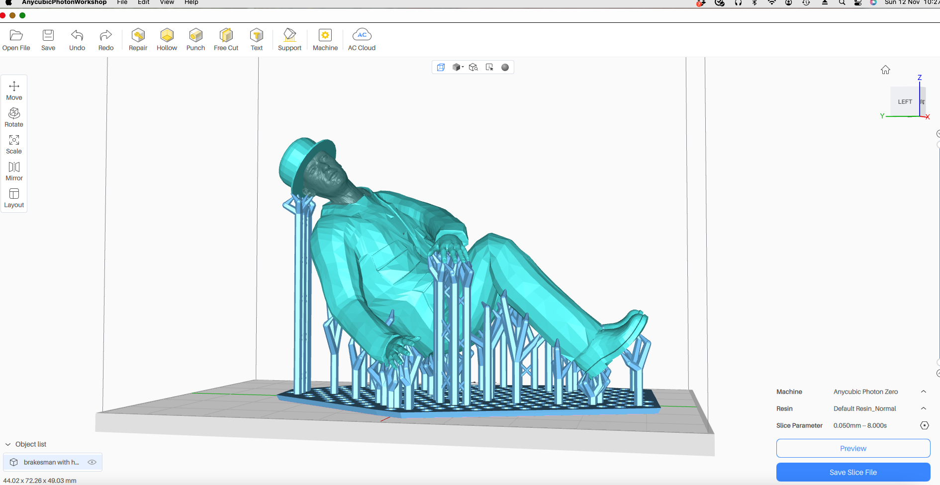

Prepared for printing:
It has just come out of the printer - picture to follow>
PS I have been having difficulty repairing these figures in Meshmixer. I am sure it can do it - but I can't make it do it! I am getting much better results using the repair function in Anycubic slicing software - and automatically.
