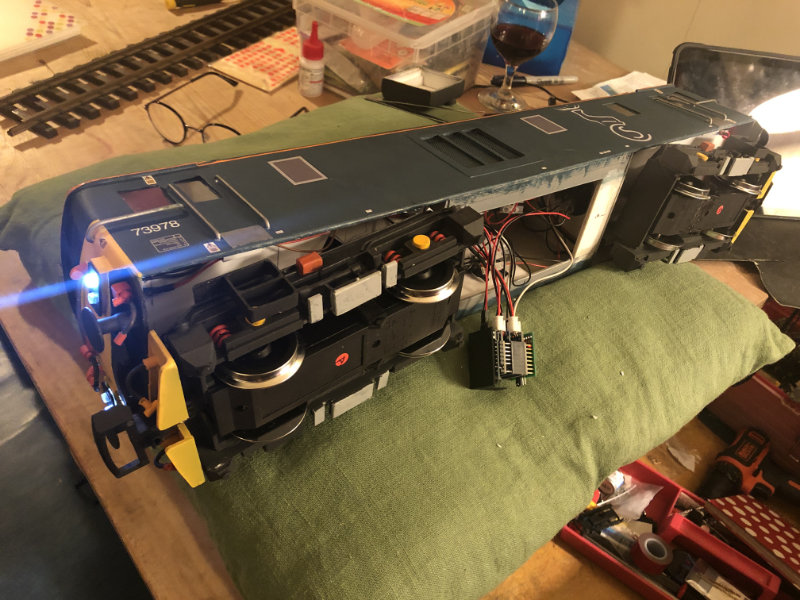

Oh deary me. Rule 17B (amended): Make sure all wires are cut, oh, twice as long as you think they’ll need to be. I didn’t do a separate chassis and bolt-on bodywork: the bogies are just attached to screw-in, rigid ‘floors’ at each end. I was feeling pretty smug about this, until it came to fiddling with the wiring. Next time...
That’s it though. A couple of minor repairs and it’s done.
And – it goes!

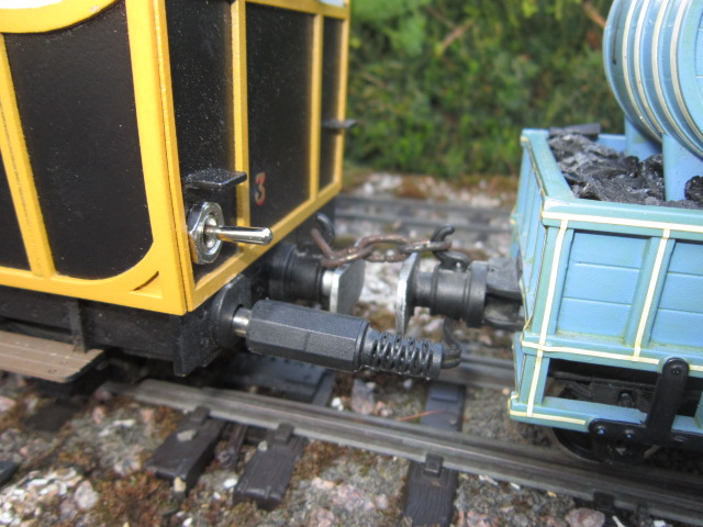

Thought for the day: It’s crossed my mind (and not specifically related to this loco really) to do, say, a battery-powered R/C goods van or brake coach (or both). You could then just build simpler, unpowered and much less expensive ‘locomotives’. Hmmm... [strokes chin, stares into distance]

BertieB wrote: Sun Feb 28, 2021 10:33 am ..... a battery-powered R/C goods van or brake coach (or both).
Here's one (or two) I made earlier......
In my case these were needed to power motorised locomotive models which were previously track powered having no internal space for battery packs. Each wagon houses a rechargeable power pack and Deltang receiver. There are on/off/charge switches and power input plug on the underside and output socket on the end facing the loco. Each locomotive has a trailing lead and plug. The system works very well
