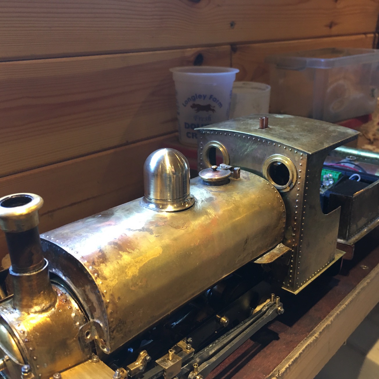

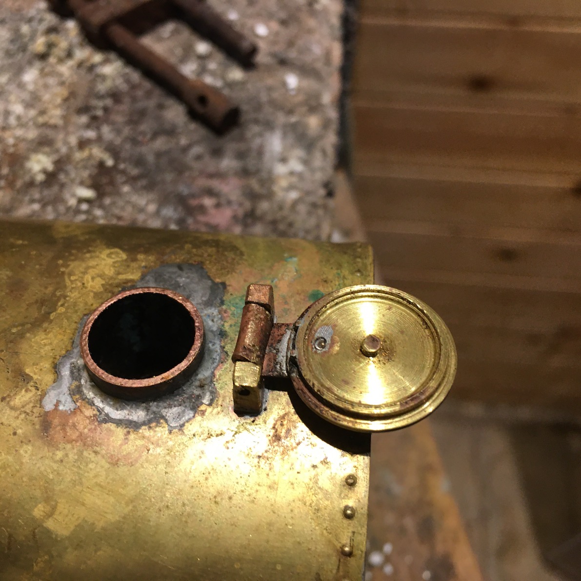

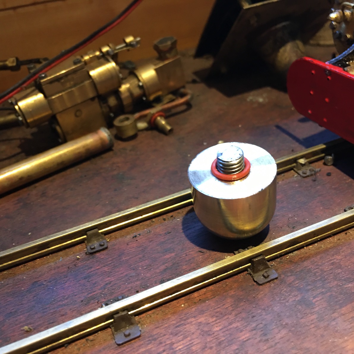

I have been working on the water tank. Adding the details. I didn't make the water tank to the drawing - I actually made it so that it had a bottom and would hold water if I decide to fit an axle driven water pump. The cam to drive it is already there so it might happen. The underside of the tank:
Firstly the filler lid :
I shortened the filler valve so it didn't poke out of the hole.
and the dome. This is my home made ball turning tool, which I used to make it:
As the tank might hold water and the real tank filler already has a filler valve poking through it, I made the dome in two parts, so the top part can unscrew to fill the real tank. So the lower section soldered to the tank:
and the top section with a length of M8 studding in it (the studding was used to hold the dome in the chuck far enough away from the chuck to allow the ball attachment to work) In the background you can see the weir pump from K1 awaiting modification.:
and finally the water tank back on the loco:
Handrails and dummy injectors yet to be made.

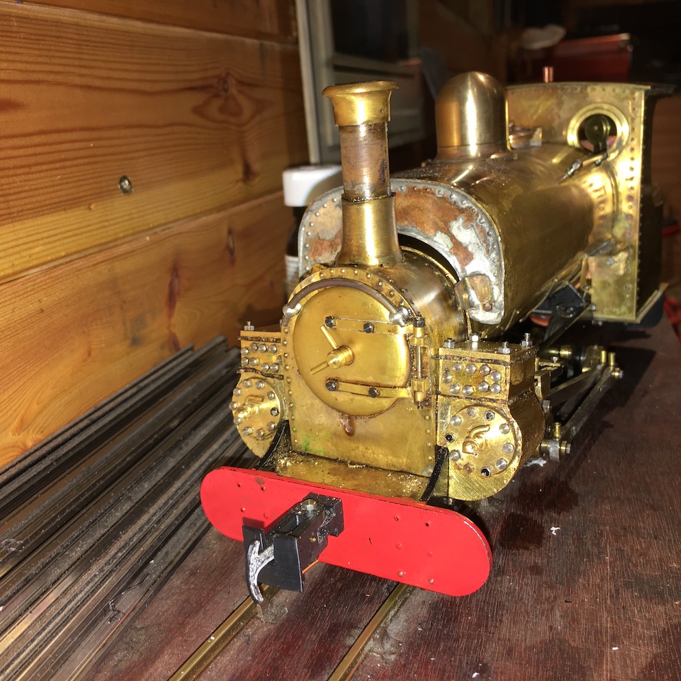

Todays progress is limited. I spent most of it repeatedly dismantling the burner and cleaning the jet!
Anyway I have fitted the 3 d printed couplings with a view to running outside with a train in tow:
I wondered if the problem with the jet was the rubber hose which connects tender to loco. I replaced it. No change. So I now think it is the new gas which I got from screwfix. I emptied the tank and cleaned the jet yet again. So need to get a gas canister from a different source to check if that makes a difference.
As an aside I can confirm that the rubber hose takes the full gas pressure even with a blocked jet, and with a propane/butane mix.
Anyone else had problems with dirt in gas?

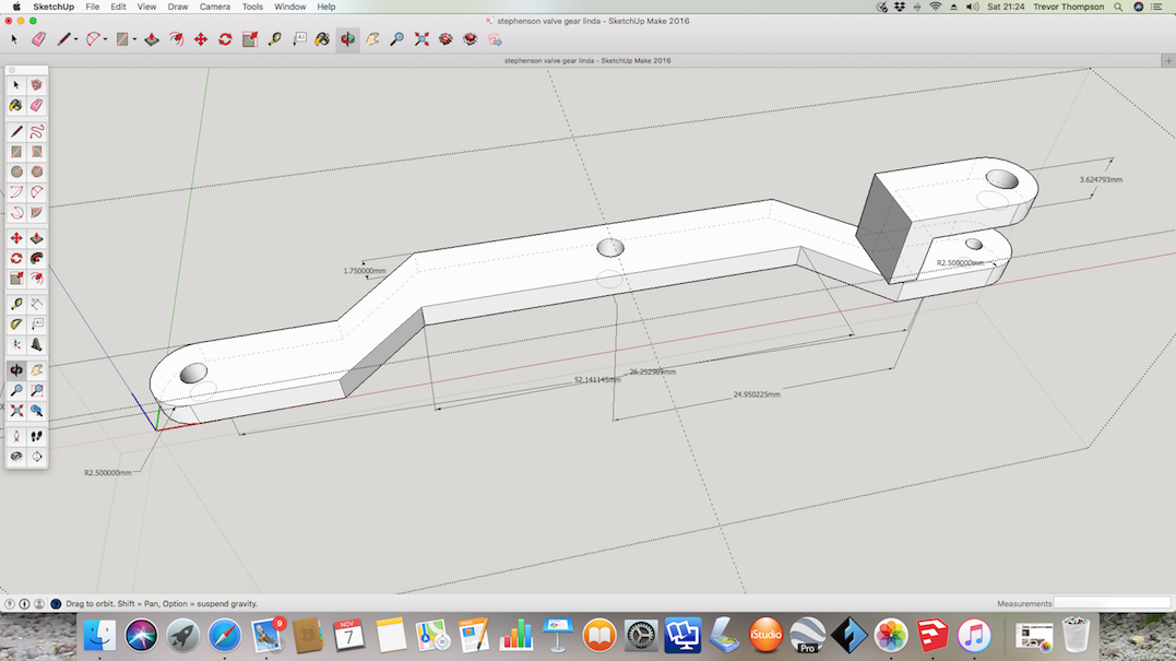

some drawings for the valve gear as requested:
stephenson valve gear linda.jpg (310.07 KiB) Viewed 20202 times
Firstly a general arrangement to name all of the parts and show where they fit together. This is for one cylinder of course. The same things are repeated for the other cylinder and the eccentrics are 90 displaced from this set.
Individual component drawings follow

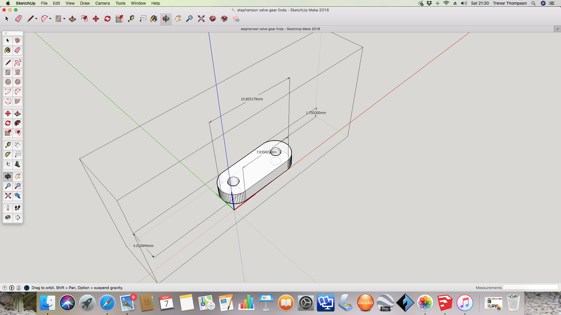

Expansion link:
expansion link.png (451.63 KiB) Viewed 20206 times

Re: 16mm scale "Linda"
Posted: Sat Nov 07, 2020 9:23 pm
by Trevor Thompson

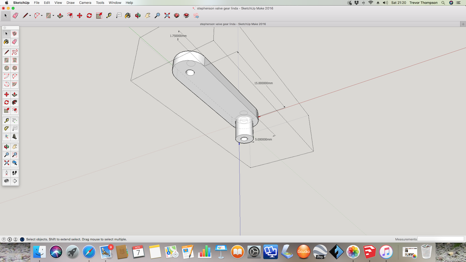

lifting link:
lifting link.png (464.39 KiB) Viewed 20207 times
and lifting arm:
lifting arm.png (437.83 KiB) Viewed 20207 times

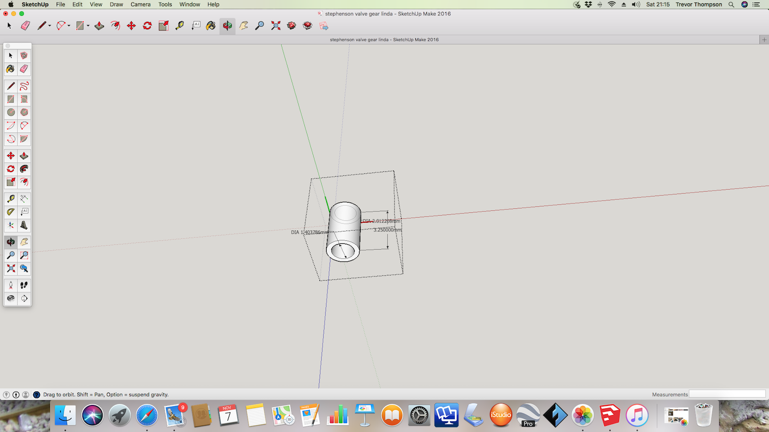

link block hanger:
link block hanger.png (464 KiB) Viewed 20206 times

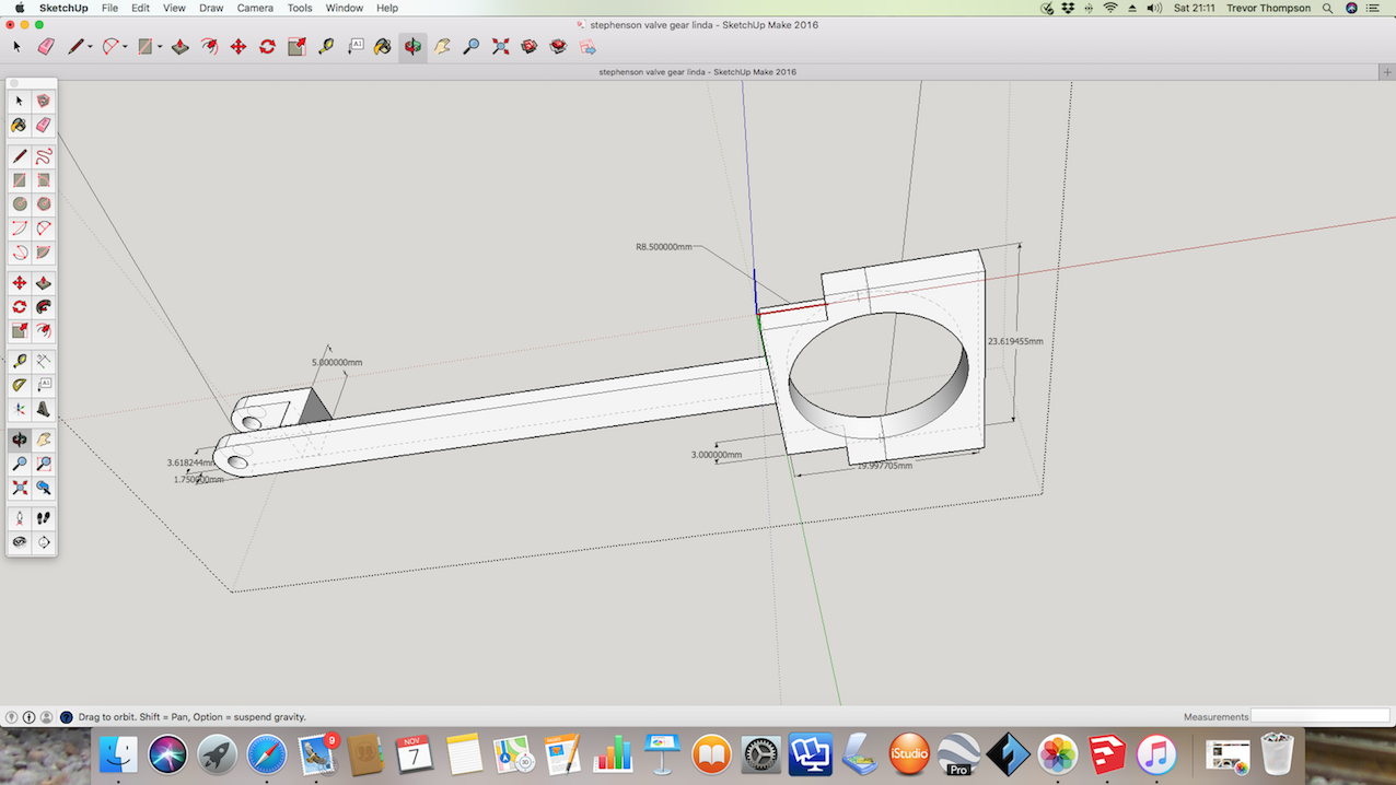

and extension rod:
extension rod.png (389.05 KiB) Viewed 20206 times

Some notes on the valve gear. All the pivot points are tapped 10BA and pivot on 10BA bolts. Where possible lock with a 10 BA nut. The only exception to that is the rocker arm where both ends are tapped 8BA. Each end will move if it isn't pinned. The outer end is permanent - the inner can be dismantled. I use 10 BA bolts with 11BA heads throughout.
I hope that the dimensions are readable. Having drawn it in sketch I then had difficulty exporting it without catching loads of unwanted dimensions - which is why I ended up with screenshots. If the original sketch file is of use I can post that as well.

Trevor Thompson wrote: Sat Nov 07, 2020 9:41 pm ...I hope that the dimensions are readable...
Thank you for posting details of your gear.
With the exception of extension rod, which is a bit challenging (but still usable) all of the drawings attached are perfect.
One immediate question is about eccentric.
I am assuming that 3mm dia hole for axle is not quite what it is in reality? :scratch:
I will have more deatiled look at it and come back if I have any questions.
BTW - I am assuming that steam and exhaust ports in your design are as per Charles of K. B. ?
Posted: Sun Nov 08, 2020 10:43 am
by Trevor Thompson
Yes the hole in the eccentric might be wrong. I did that from memory (but measured the critical bits).
The rest of the engine is as per the drawings.
